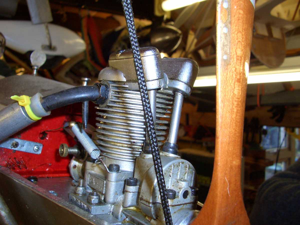

The system that I use on my engine does away with the rigid throttle linkage.
I have rigged up a light spring to hold the throttle closed.
A piece of fine trace wire connects the throttle linkage to the servo. Now, the servo can pull the throttle open against the spring. The spring returns the throttle towards the closed position.
I use this system on several models and it functions very well. One advantage is that the throttle servo is largely isolated from vibration. Another advantage is that the control run can be a little tortuous. No special fitting is needed on the throttle arm, so you can work tight to the bulkhead.

Great idea bobeagle Ive a box of springs

10 Apr 2014 20:07 - 10 Apr 2014 20:13 #65 by bogbeagle
Replied by bogbeagle on topic Flair Etrich Taube 1910
Quorneng wrote: A very sound way of doing things.
Most, if not all, motor vehicles use exactly the same system. Pull on, spring return but don't you then need a separate mechanism to actually cut the motor?
No, I rig all my engines so that there is no physical stop, limiting the rotation of the carb' barrel.
When I flip the "engine cut" switch on the transmitter, the barrel rotates to a position where the engine cuts. Go to 36 seconds.
