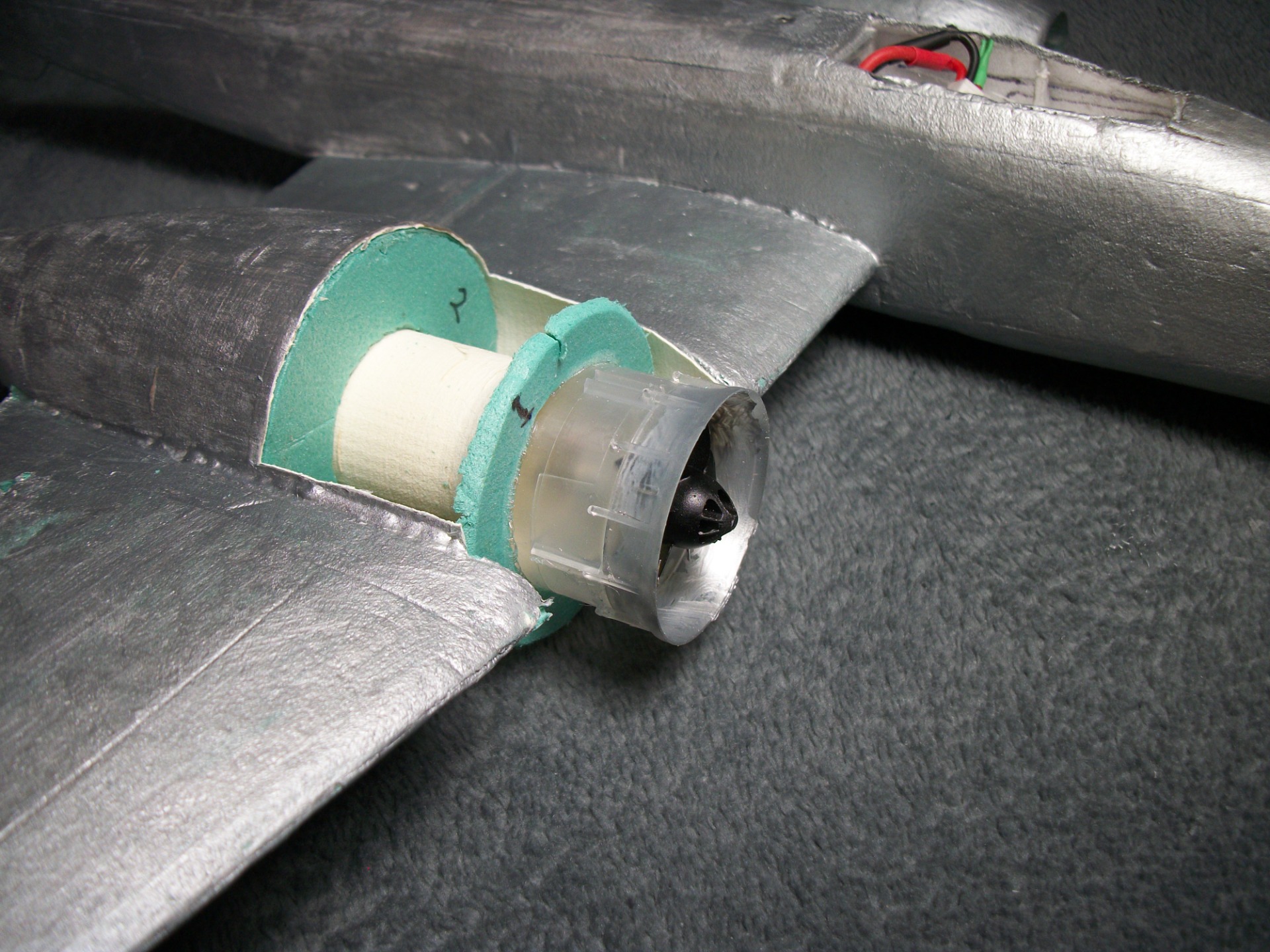

One nacelle is LW-PLA printed whilst the other is 2mm Depron plank covered. The printed nacelle meets the EDF with a sharp edge. Not ideal foe  EDF airflow entry, particularly on a slow flier.
It alloys me so just in case the Meteor might need a major wing rebuild I printed out a new front nacelle part with a proper rounded leading edge.
The picture makes the new nacelle look a bigger diameter but it is only a modification of the original CAD file so it should fit. It weighs just 0.1g more.
Still waiting for the parallel/serial connector bits to connect the batteries but otherwise it is ready to go..

The problem is it definitely wants to turn to the right suggesting the right EDF is not creating the same static thrust.
The right EDF uses a printed cowling rather than the Depron planked one on the left. The planking gives a rather better radius entry lip rather than the sharp "edge" of the printing nacelle.
To avoid disturbing the EDF and its wiring I decided to cut back the front of the printed nacelle and replace it with planking in the same style as the other one with the hope it would then match its static thrust.
The first two of 22 planks.
If it proves to make no difference I may have "adjust" the thrust somehow, however as the EDFs are coupled in series using a single ESC the option of using two channels for differential thrust is not available.
