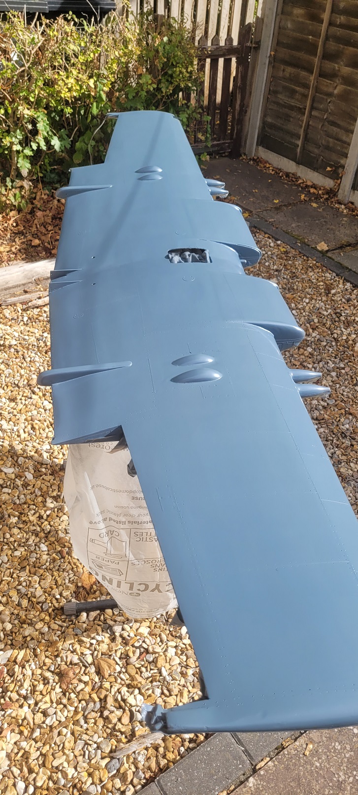

28 Sep 2026 12:38 #203
by Ralpharr2001
Replied by Ralpharr2001 on topic Fairey Firefly MK5 from Vance Mosher plan
Thanks BB. Some are ok but some are a bit deep and are not covered properly by the paint.
I've put the top coat on, Dark Sea Grey, and the rivets show up nicely but some are a bit over done. Most of these will be covered by the black and white Korean stripes. So hopefully they will patch up with a bit of sanding and then covered with the black and white paint. If they don't then they are staying. I don't have the patience to flat the wing again and repaint it!
