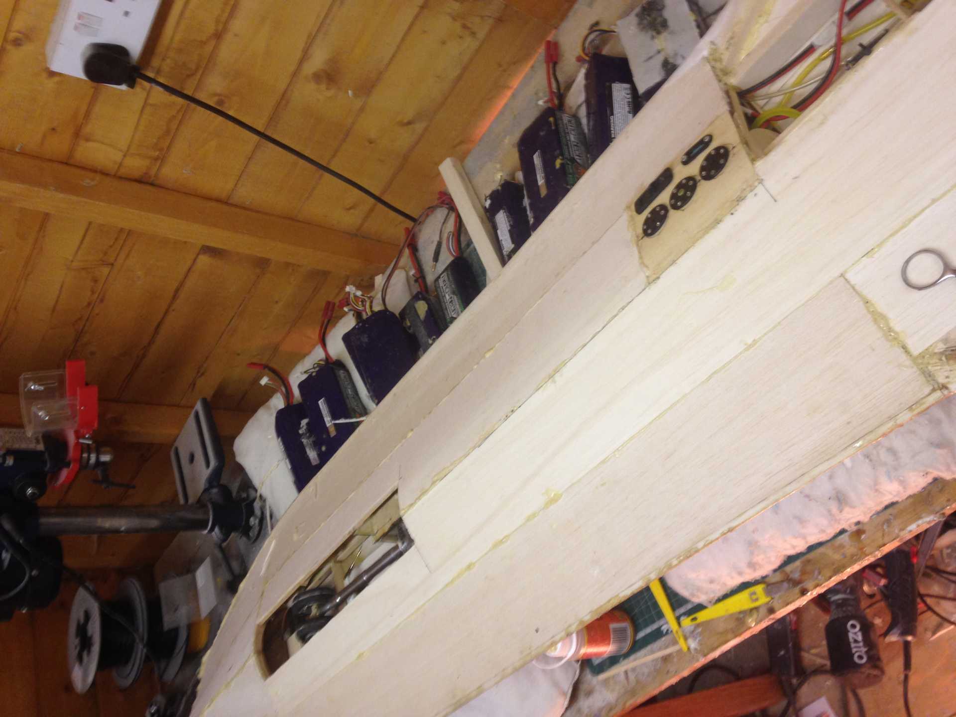

I am making progress with the working service

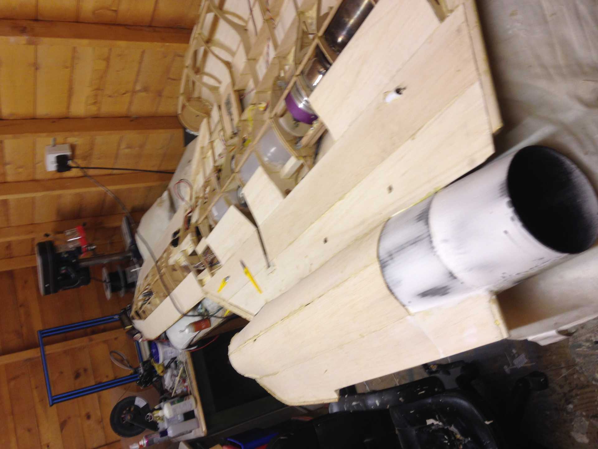

Also, the nose wheel doors, and turbine intake
Made with pro skin, then mesh, then 3D print
Next is the inspection door(central) to access receiver, battery etc.
Thanks: Klipkopwildlife, Quorneng, old fart, boz

I can hear you saying "there is a rag on the turbine ",
Don't worry, I've put it there purposely, when I paint it, it stops the paint getting on the turbine, i can reach it from above

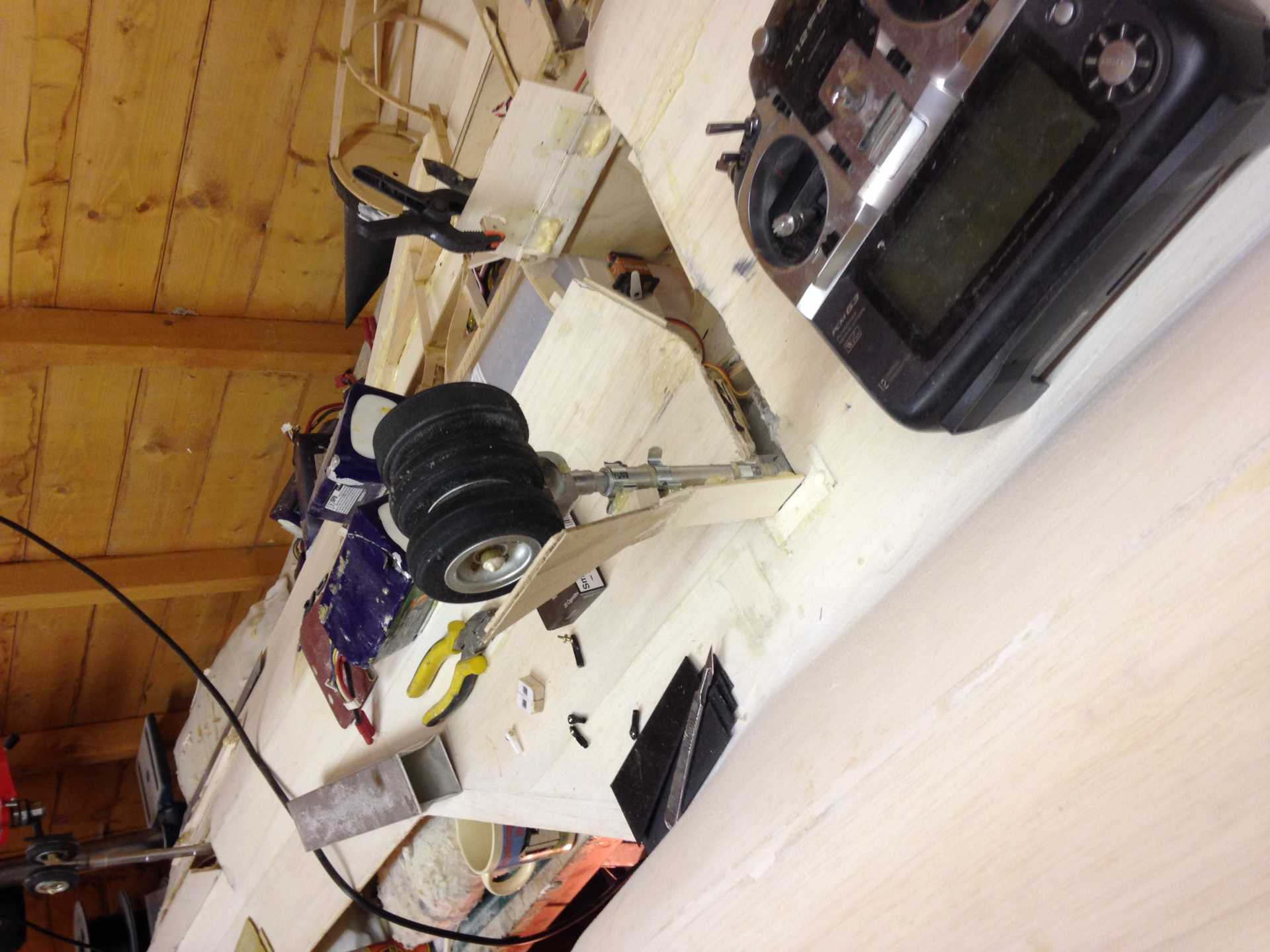

Today i worked on the retract doors
Thanks: Klipkopwildlife, old fart, boz

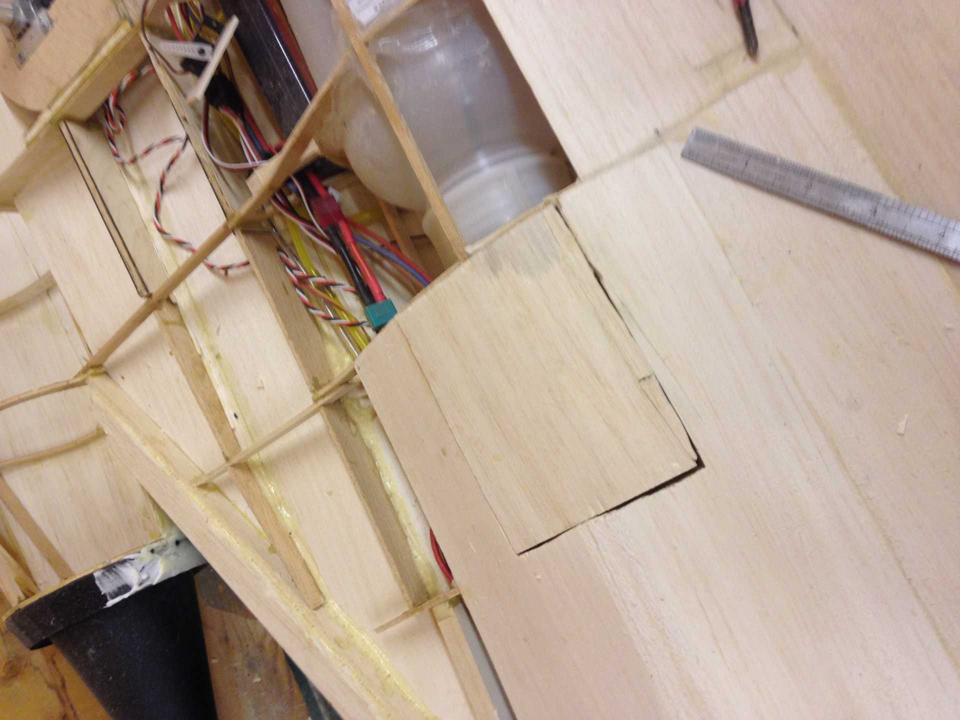

Inspection hatch
