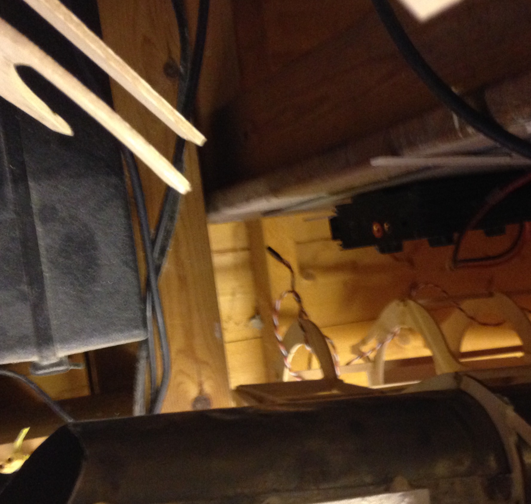

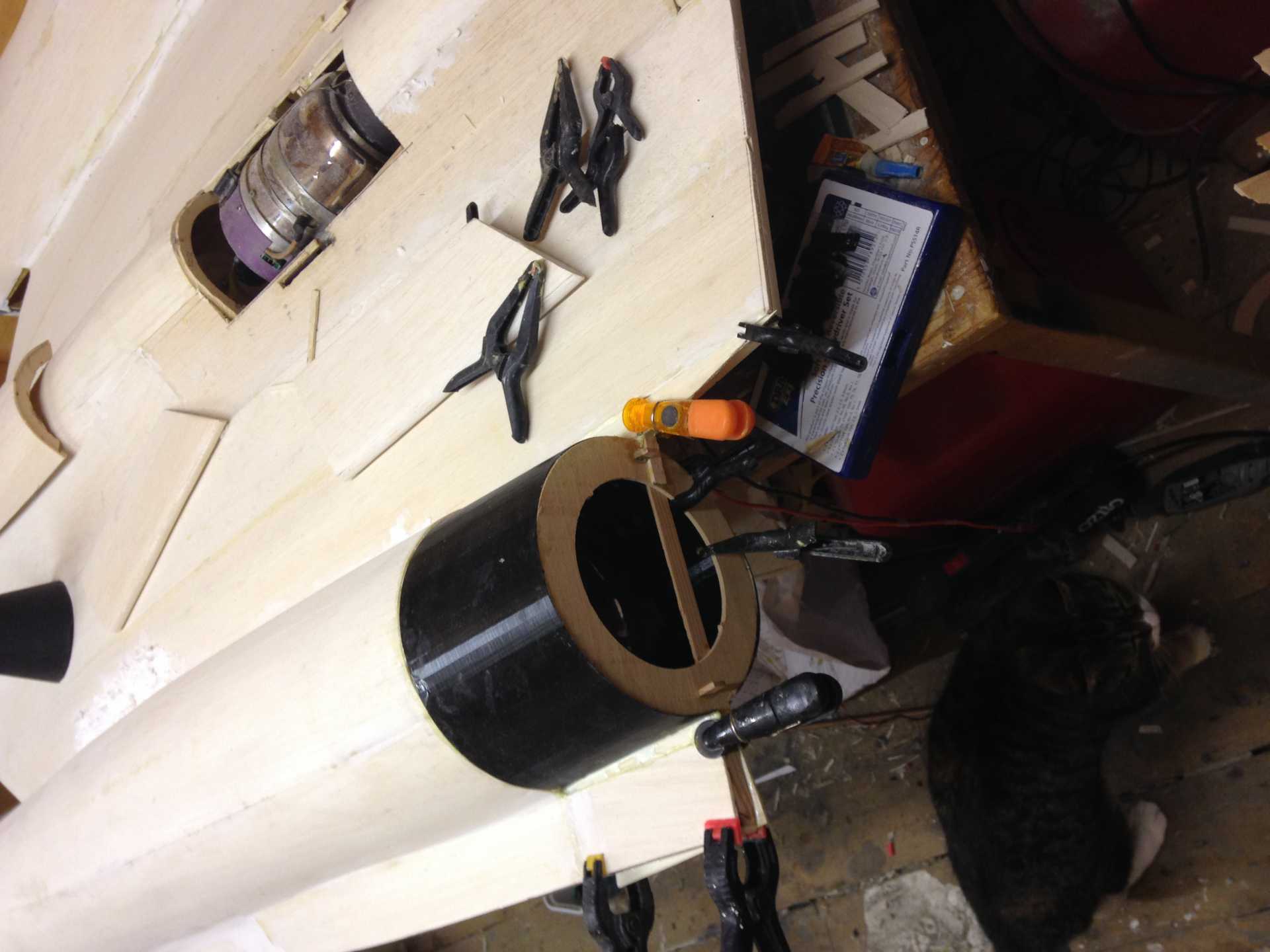

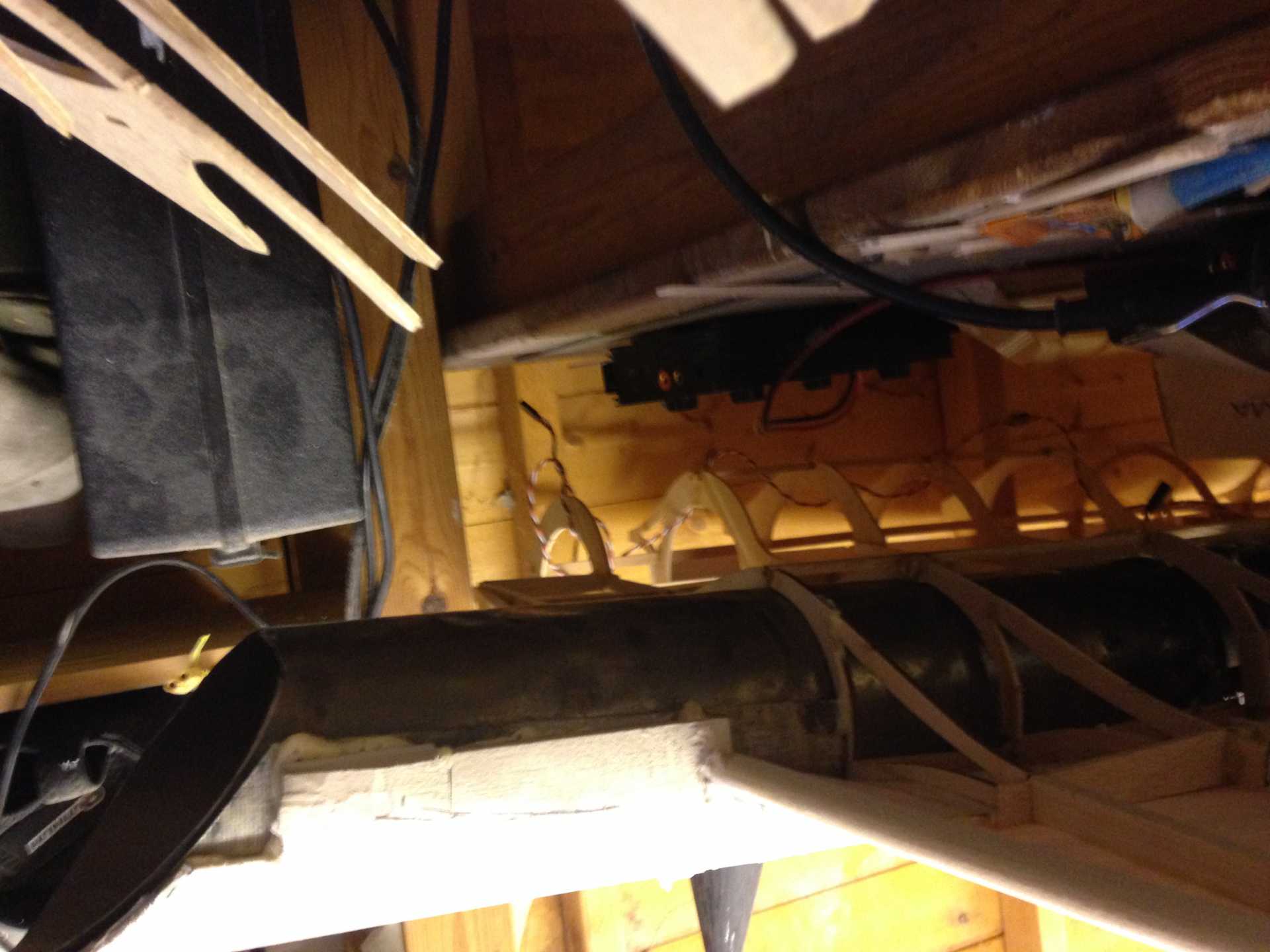

01 Oct 2017 23:54 #86 by bond007mas
Replied by bond007mas on topic SR71 1:10 SINGLE TURBINE
Front former fits perfectly
My 3D buddy is now designing my nose cone
Fitted l/h rear engine mount, I am producing now in 3D other side, after that has finished I've got the outer engine mount for both side
I have cut down thrust tube to fit, the thrust tube has heat protection, it goes, thrust tube, air, fibre glass sheet, air, balsa
I've fitted nicelles cones, it lookes more like an SR71 now
Check fin alignment, then remove
It was a busy weekend
Thanks: Klipkopwildlife, Quorneng, old fart, boz
  • bond007mas
01 Oct 2017 23:58 #87 by bond007mas
Believe me, it's central, the photo isn't great
  • bond007mas
02 Oct 2017 13:43 #88 by bond007mas
Pic upside down
Thanks: Klipkopwildlife, Quorneng, old fart, boz, Squirrelnet

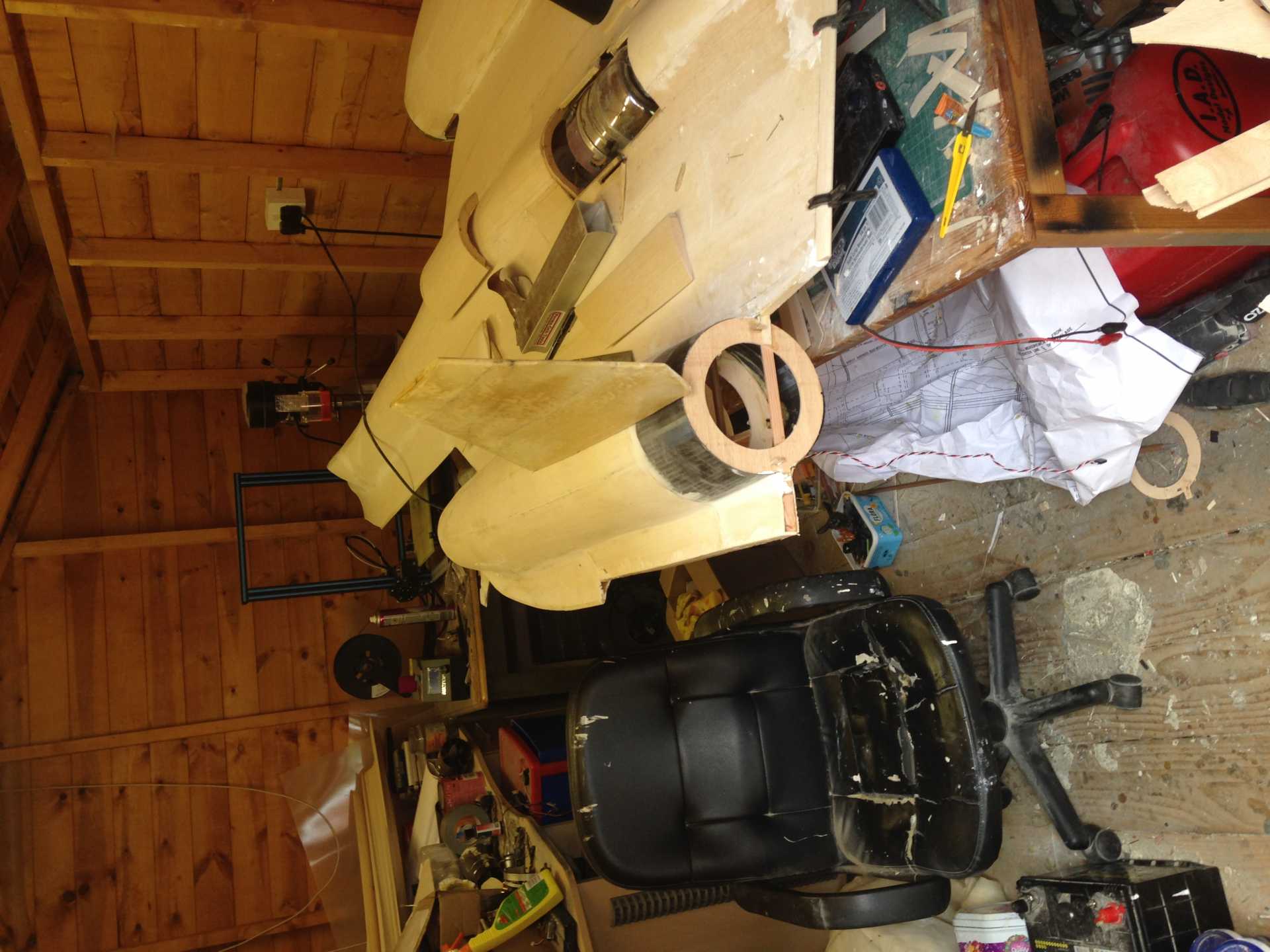

  • bond007mas
04 Oct 2017 23:37 #89 by bond007mas
Spent all day on my SR
Brother came round to turn it round
So got working on it
On the winglet it came very close to not fitting, so had to use thin ply on both sides
I have the 3D inner engine for the R/H side, now printing outer engine R/H, to get quality it takes 36 hours
