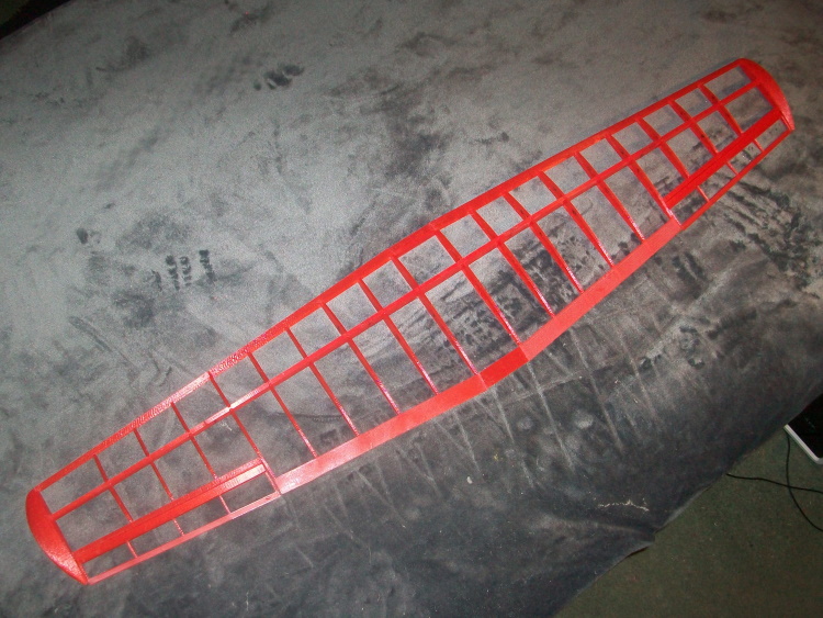

15 Jun 2020 23:52 - 15 Jun 2020 23:53 #54 by Quorneng
Replied by Quorneng on topic A printed plane or not as the case may be!
Ailerons printed.
May look simple but a bit of a challenge to provide adequate torsional stiffness and keep the weight down. Each weighs 2.4 g.
Aileron servos next.

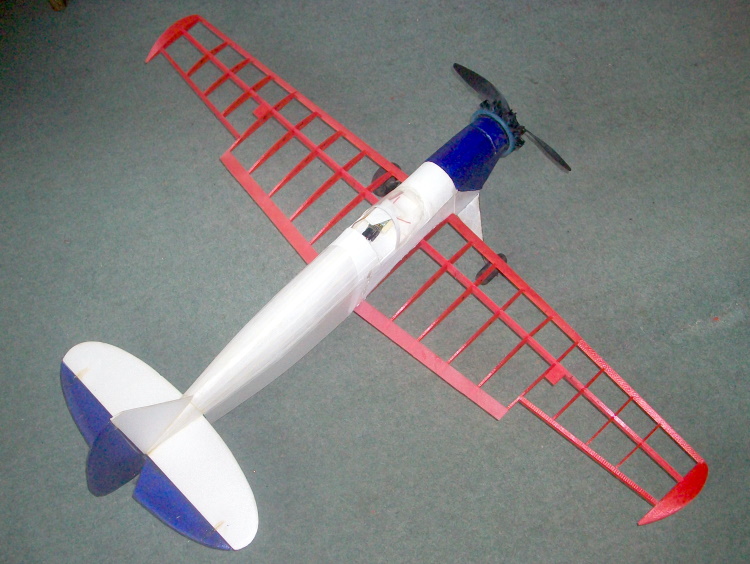

16 Jun 2020 14:34 #55 by Quorneng
The tapered wing in place.
It almost looks delicate compared to the 'brutal' silver plank.
It also looks like it won't be too far from the Depron wing's weight either.:P

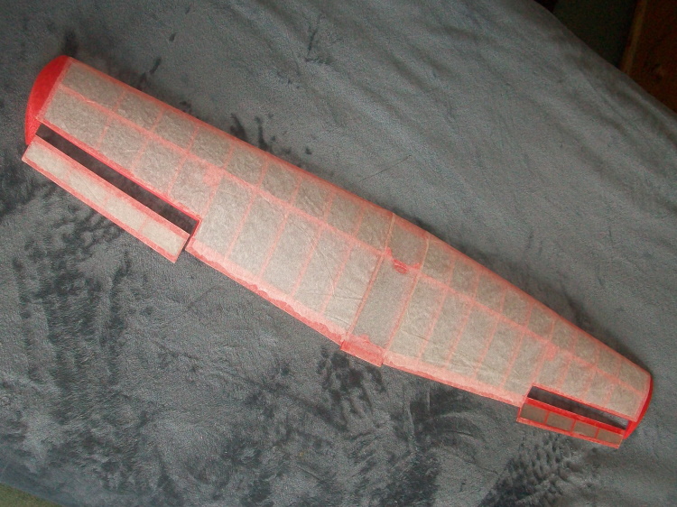

20 Jun 2020 19:00 #57 by Quorneng
I found some true ModelSpan tissue. It is very old and rather yellowed. I was trying to think when I must have bought it. I last made some tissue covered planes rubber powered over 30 years ago although I can't remember buying it at the time. :woohoo:
Anyway I made a start on covering the tapered printed wing.
Only the upper surface so far as there is still an aileron servo to be installed.
The ailerons have tissue on both sides, the darker one has had a coat of EzeDope.

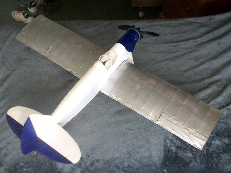

22 Jun 2020 23:52 #60 by Quorneng
With the 'taper wing' on hold until a servo arrives I wondered if I could revert to my original intention to create an all printed plane but using a tissue covering.
I had in mind something like this which I refer to as my 'Light Tractor' as it is under 250 g.
It has a span of 40", uses a 24 g 1300kV Blue Wonder outrunner driving a 7x6 from an 850 mAh 3s. Apart from balsa spar flanges and a 'fishing rod' tail boom it is all Depron. It has a spectacular performance.
The challenge would be, using the same servos, motor and battery, to keep a printed & tissue equivalent to under 250 g.
Really just a printing exercise as it would be unlikely to have a better performance however one advantage of these super light printed structures is they don't use much filament! :P
