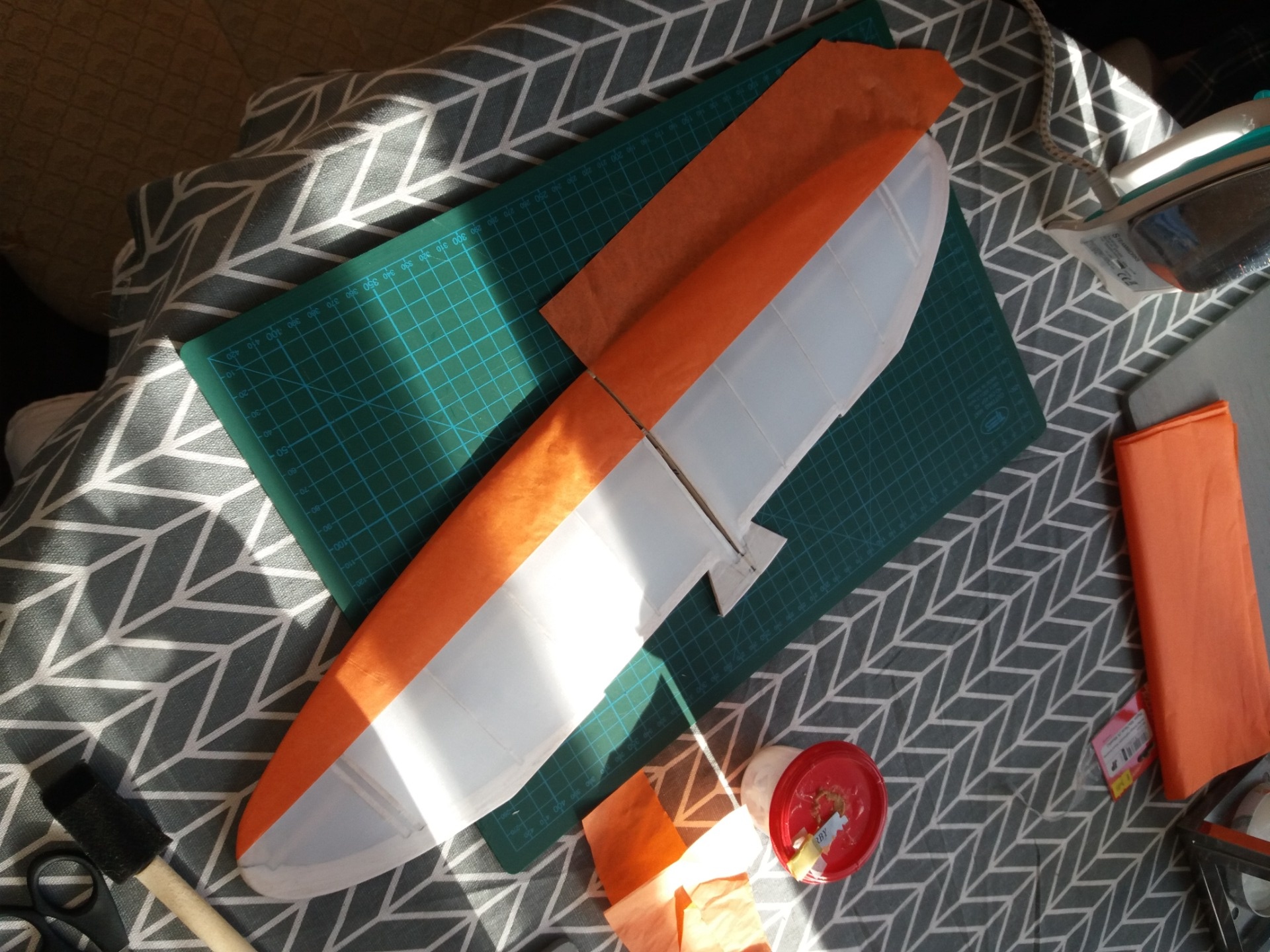

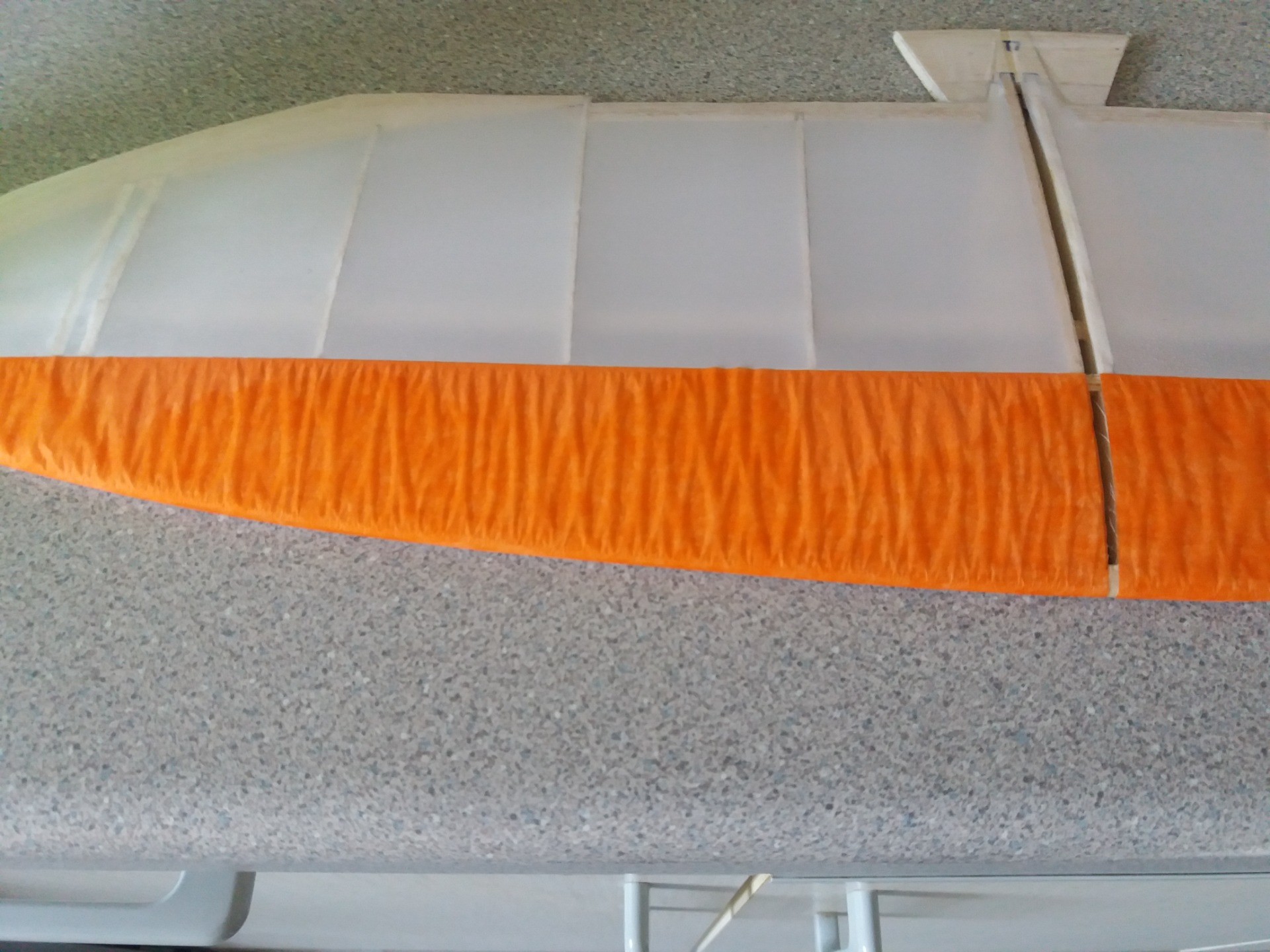

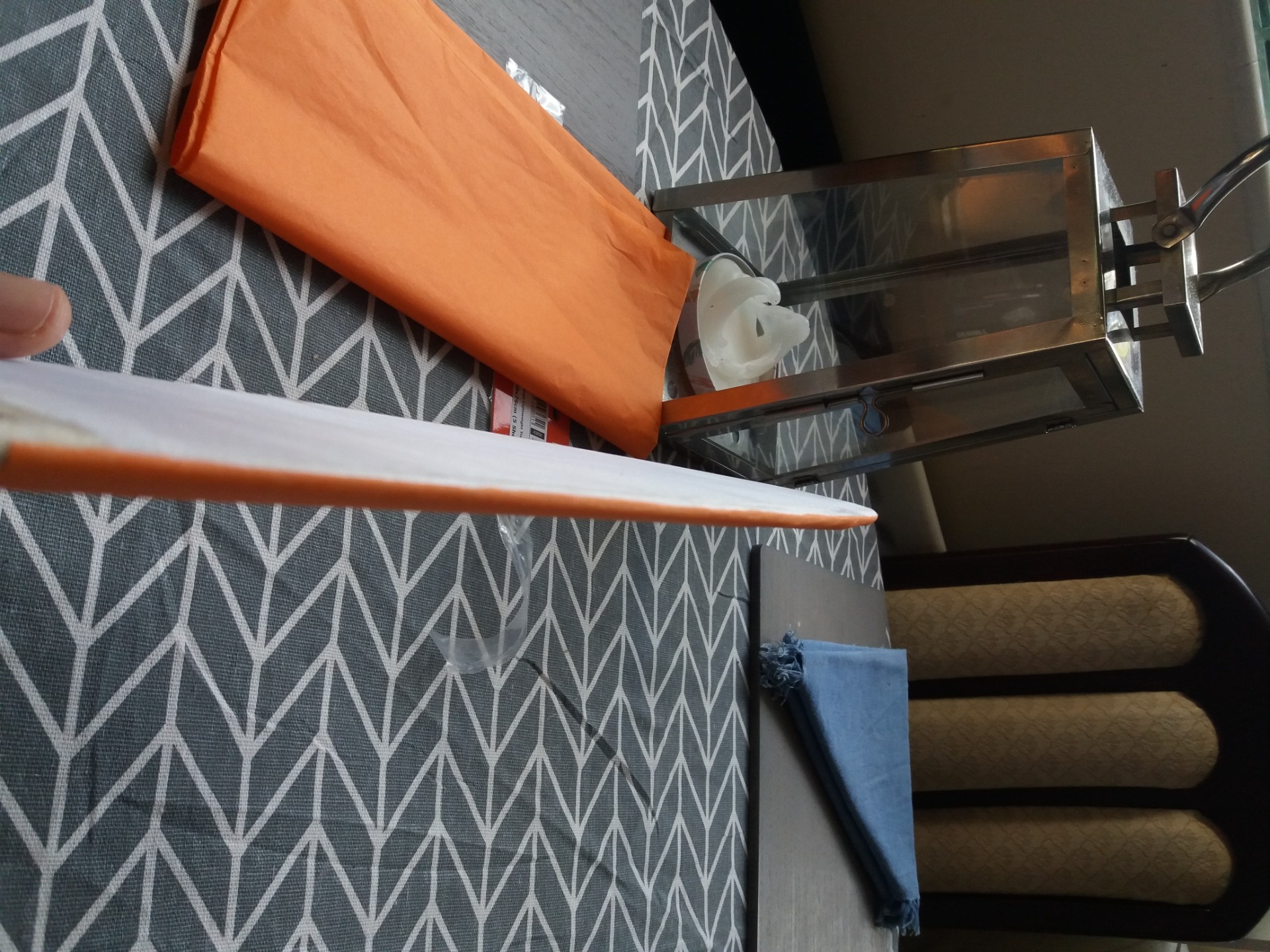

Thought I'd give the balsa bashing a rest and do a little covering.
To save a bit of weight,unlike my last few builds this one will not be double covered, the white of the colour scheme ( keil Kraft house colours of white, orange and black) will be the plain polyester silk with just the other 2 colours being done in tissue.
Tail has had the silk ironed on and heat shrunk, needs doping next.
You maybe able to make out the single sided razor blade I use to trim, this material is wonderful apart from its tendency to fray if not cut with something really sharp, it also blunts blades quickly ( I buy these blades in packs of 100 for about £4.)
  • paul d
12 Nov 2020 17:05 #34 by paul d
Replied by paul d on topic Winter build
Right pay attention at the back :) A little more work on the Tail plane, after giving the silk a coat of 50/50 shrinking dope I made a start on the tissue, the orange I'm using has no wet strength so I put it on dry and rather than using pritt stick to attach it I gave the outline a very thin line of diluted covergrip ( used neat it tends to bleed through and you end up with a shiny line) and ironed it on.
The scheme I'm using calls for the orange on the upper surfaces only so I took care to trim the leading edge carefully.
next up was water shrinking, I am always amazed the way the wrinkles disappear once dry.
After a few hours drying in a warm place I gave it a coat of dope and added the black trim ( a strip of 1/8th wide tissue).
once it's had overnight to properly cure I'll give it all a final coat of very thin dope 75/25 to blend it all in.
As normal apologies for the picture orientation, I've given up trying to get my dumb arse phone to cooperate!!

Very, very impressive Paul. Just love your work. How did you get such a straight line on the leading edge?
  • paul d
13 Nov 2020 14:14 #40 by paul d
Ralpharr2001 wrote: Very, very impressive Paul. Just love your work. How did you get such a straight line on the leading edge?
Cheers Ralph, start with a fresh razor blade and took a deep breath!
Seriously though holding your breath really does help, try it.
