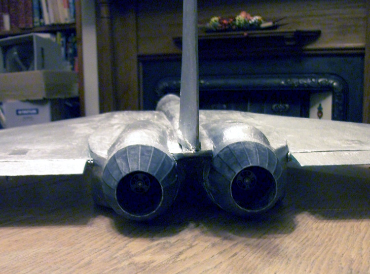

At long last a test run of the pair of 12 blade 40mm EDFs!
The are beautifully balanced and can run a very low P.M.
Together they are taking 36A  delivering 511W. Probably more power than it is likely to need but is does shut the door smartly enough!

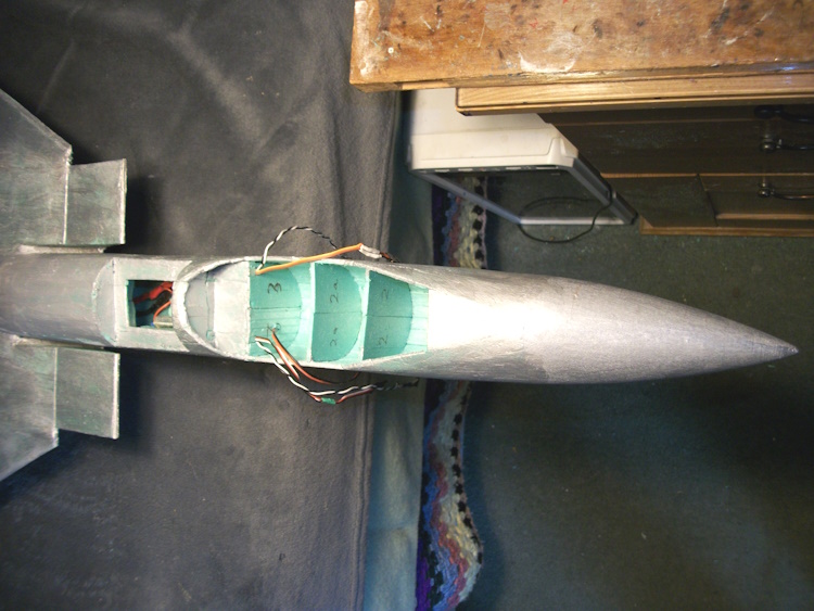

Having proved that everything still works time to consider where things need to go.
I decided a 4s at 511W was more than I would ever need so down to a 1500mAh 3s.reducing the power to 242W. Should be adequate as the FX108 only weighs just over one pound ready to go!.
An approximation of the CG suggested even the lighter battery needs to go behind the cockpit allowing the Rx to go forward in the cockpit area and so be well clear of the ESCs.
The leads for the Rx brought forward to the cockpit area.
The battery compartment is just behind.
Slowly getting there!

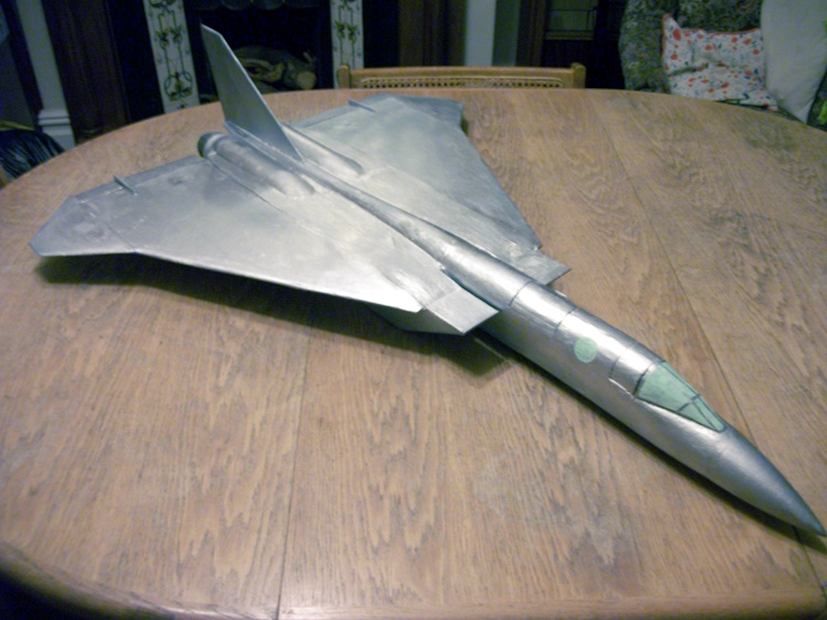

08 Feb 2025 12:55 - 08 Feb 2025 12:57 #35 by Quorneng
Replied by Quorneng on topic A plane to go with my Depron XB70 Valkyrie
A better picture of the XF108 Rapier.
The silver is basically an undercoat. I have ordered some acrylic silver spray to give a more "metallic" finish. I will then paint the cockpit glass detail and the jet pipes but that's about it.
With a 1500mAh 3s it weighs 462g (16.3oz). This will give a power loading of 237 W/lb which should be adequate even for an EDF!

11 Feb 2025 21:02 - 11 Feb 2025 21:03 #39 by Quorneng
The XF108Rapier is now complete.
Silver spat, cockpit glass and tail cones painted.
Now I have to pluck up the courage to fly it.
Last edit: 11 Feb 2025 21:03 by Quorneng.

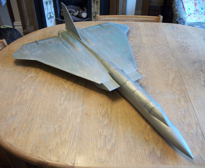

06 Mar 2025 10:18 - 06 Mar 2025 10:19 #44 by Quorneng
All fixed from yesterday's hard landing.
A bit too gusty today.for a proper maiden.
