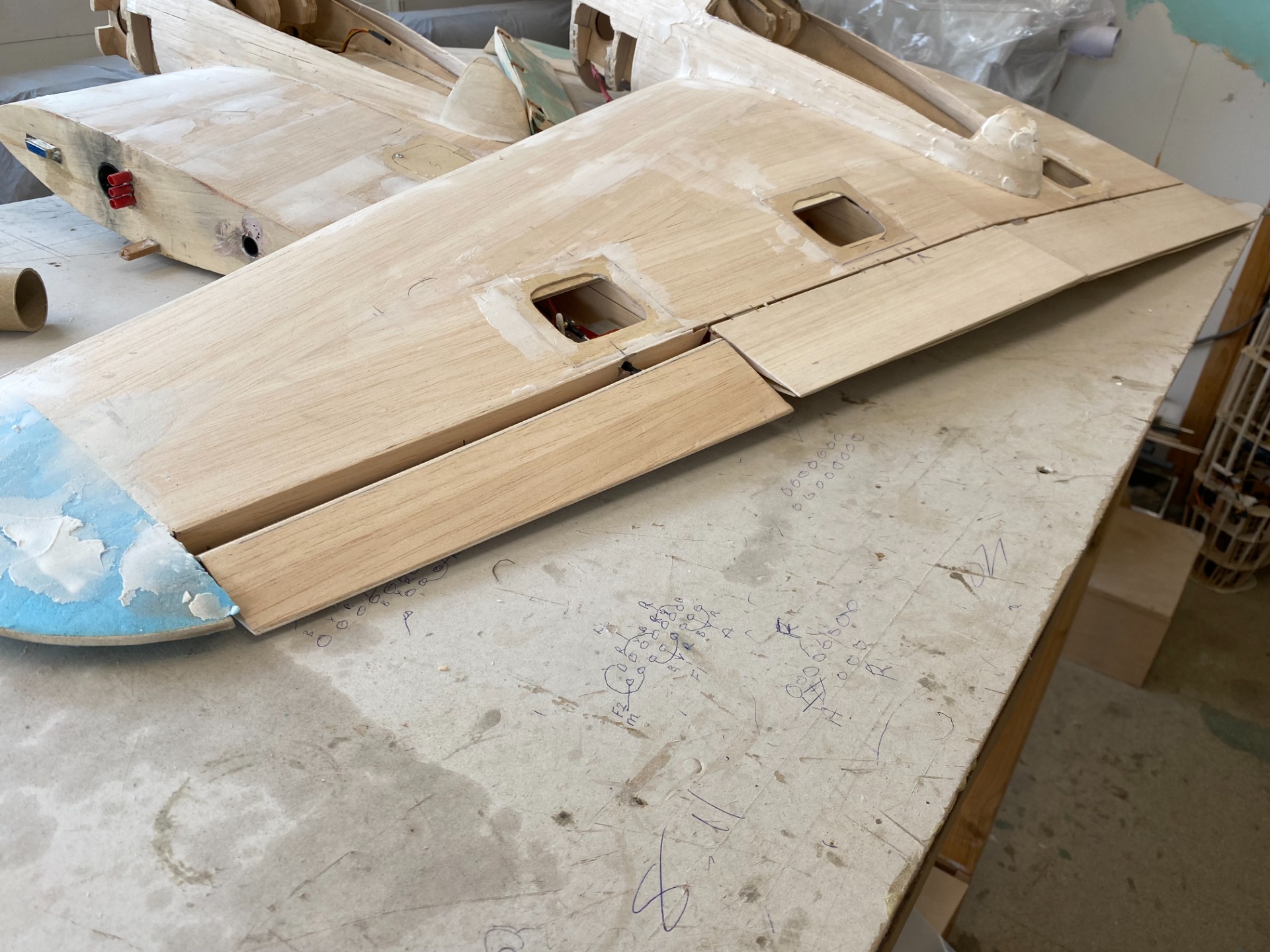

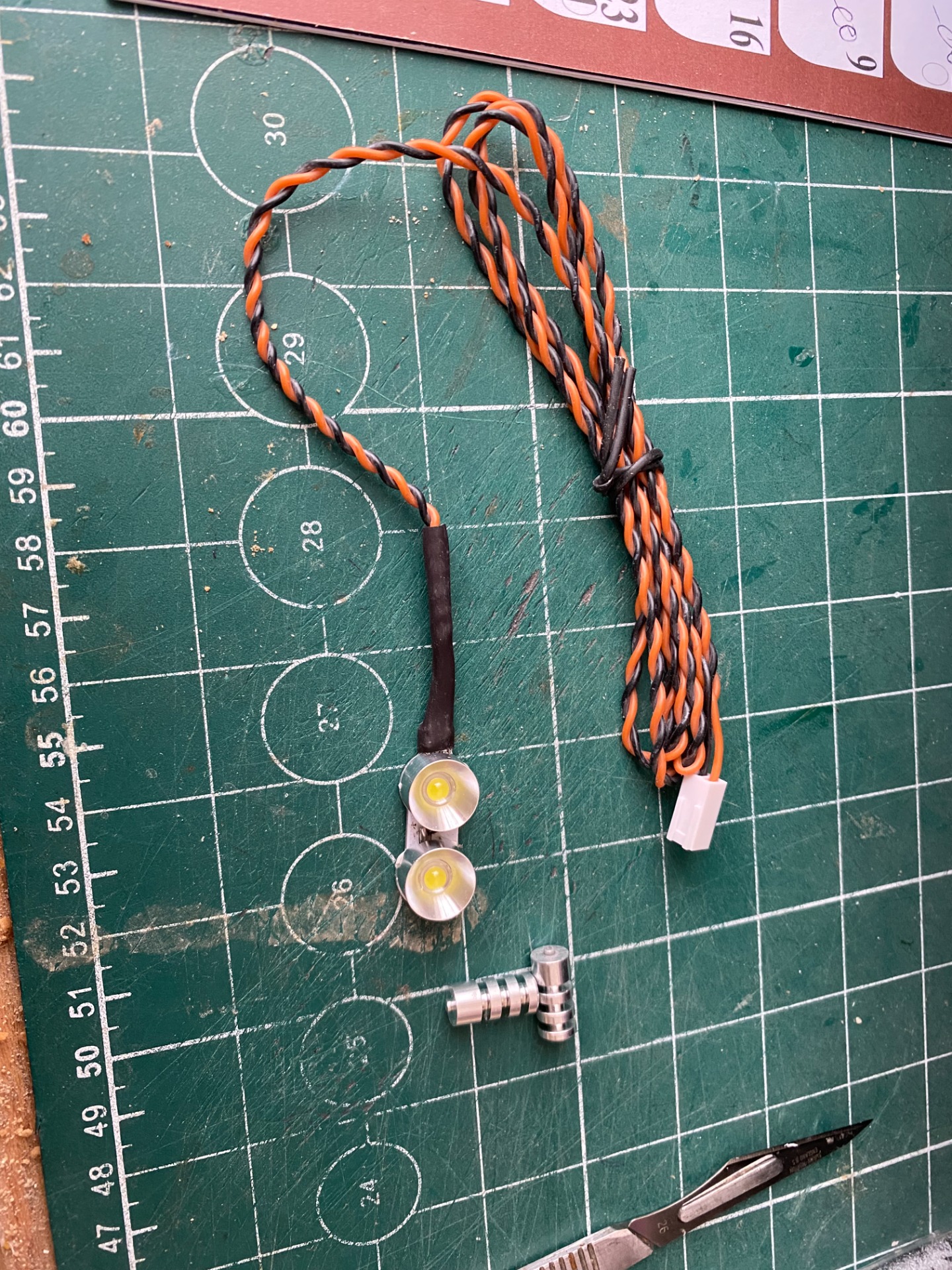

The landing light i ordered turned up so around 2am i went to the shed and fit it

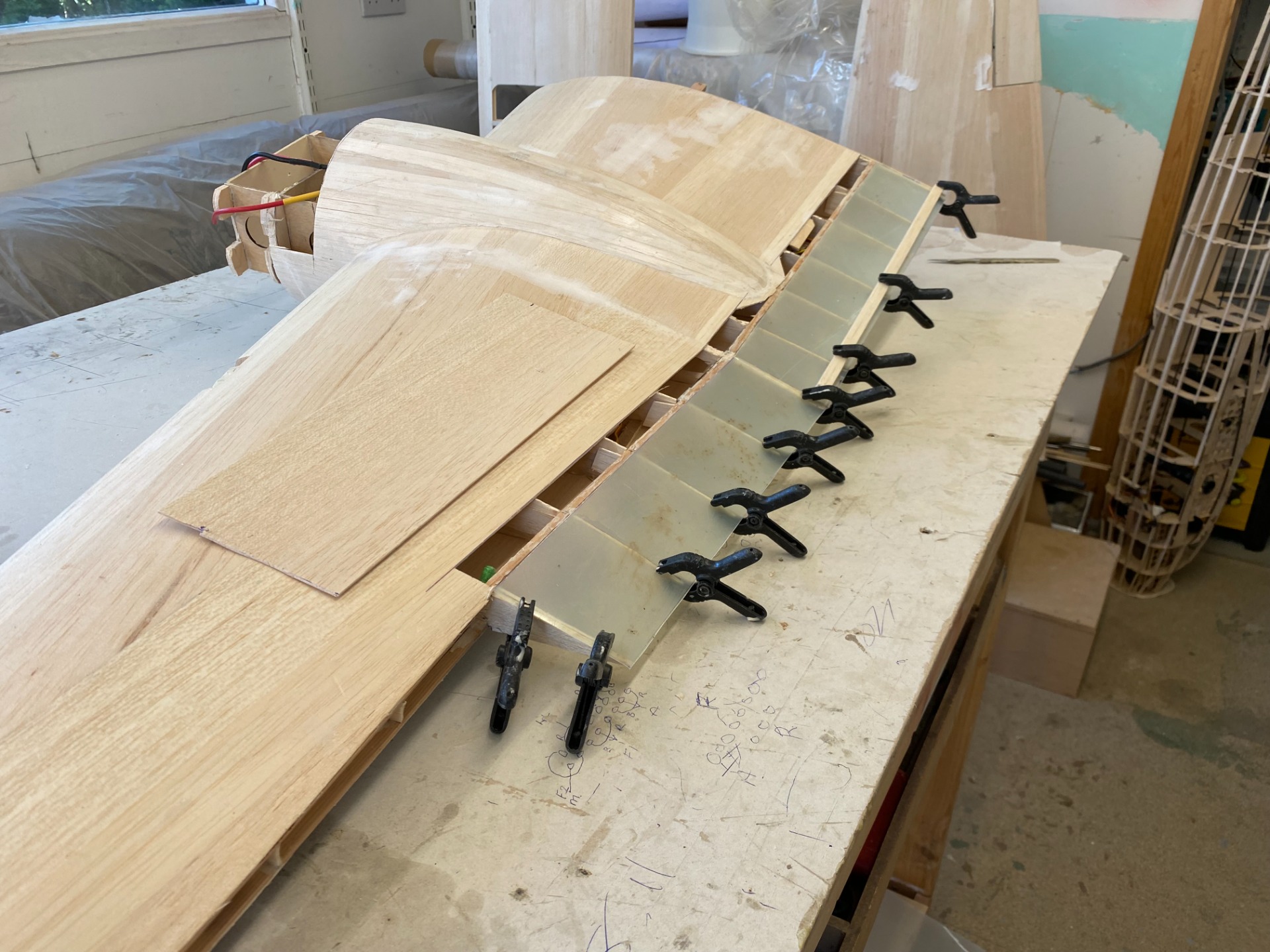

I spent 11 hours yesterday fitting the aileron and making the 2 flaps and fitting them, with the servos
Today i was going to do the other wing as i had already a while ago done the aileron and fit one of the flaps so just needed to hinge and connect to the servo, only to find that the flaps was for the other wing     that i spent all day yesterday making new flaps for
I was so pissed off that i decided the wing was not good enough on the trailing edge so i took my frustration out on it and ripped all the rear of the wing off and did it all again
And started 2 new flaps
Much happier with the wing now

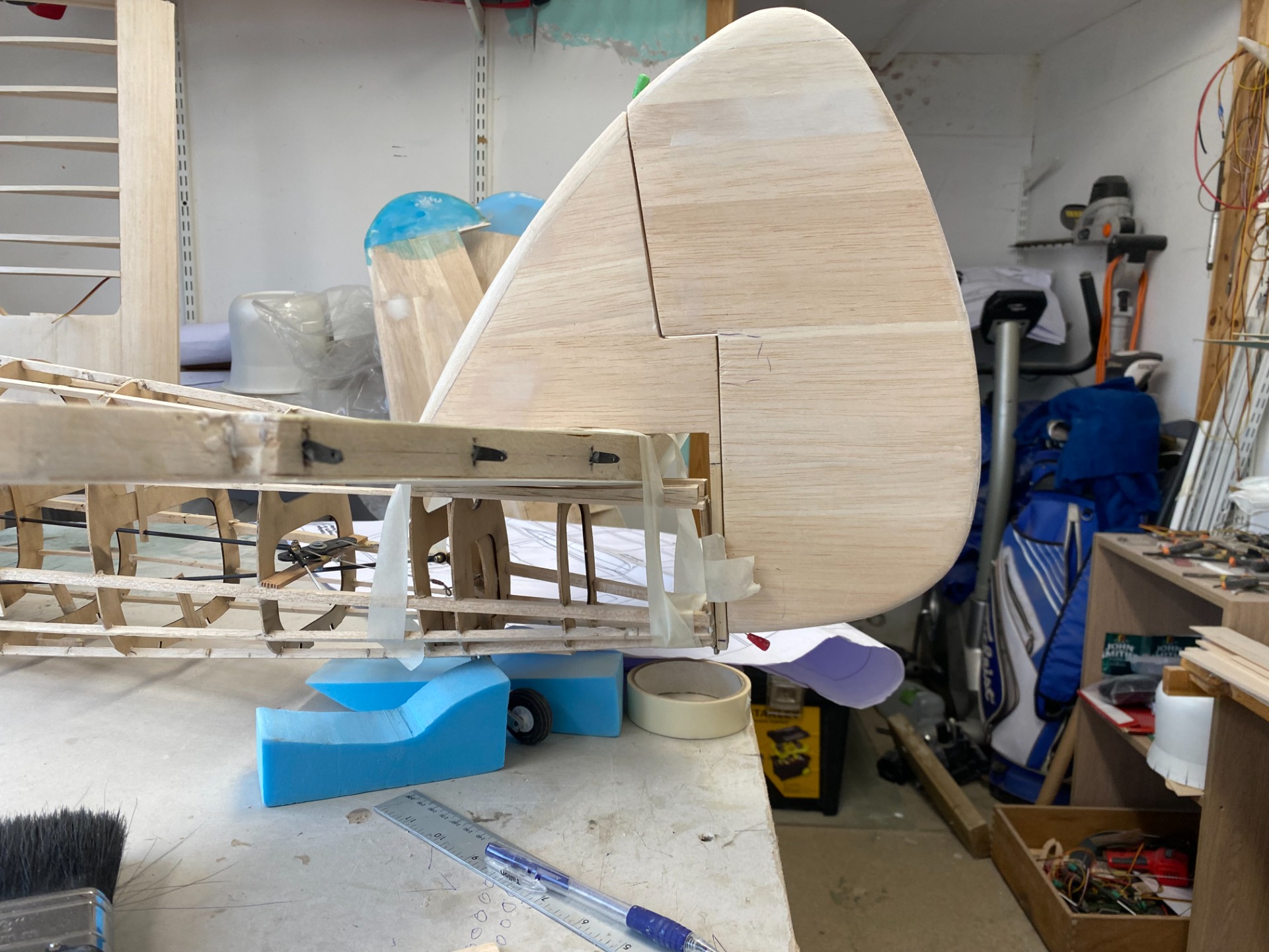

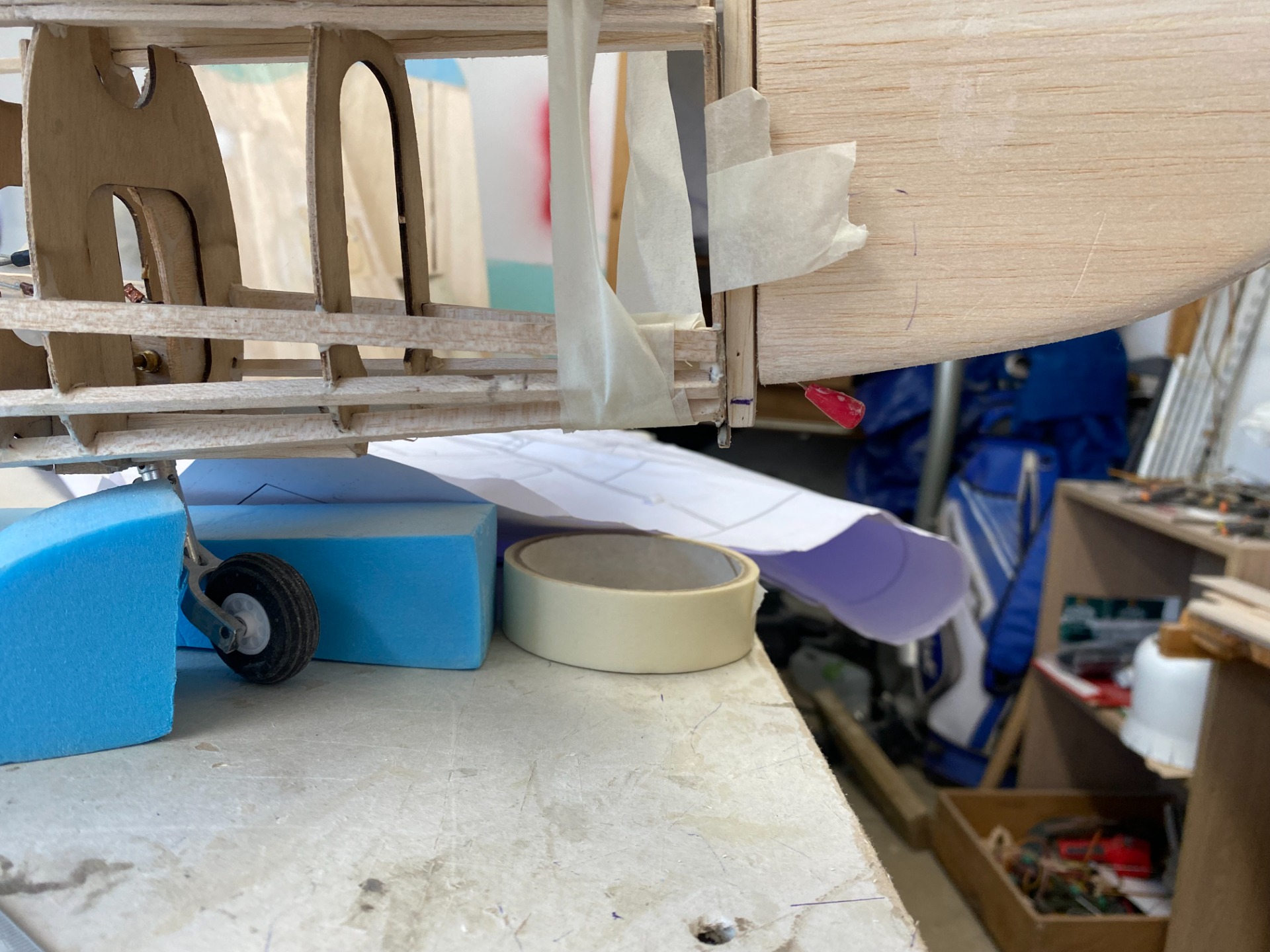

This dammed plan   built everything to the plan and the rudder is 2mm short to the bottom of the fuselage

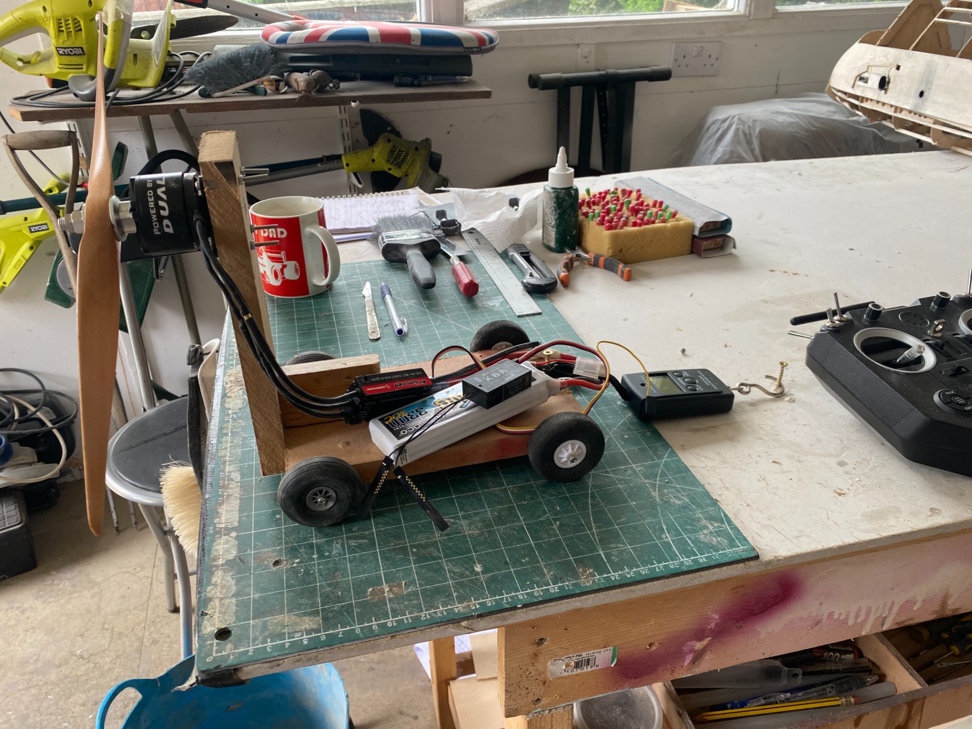

18 Jun 2026 18:41 #127 by THE BLACKBIRD
Thought i would make a rig to test the motor ESC on, not getting on to well as you have to calibrate the radio to the ESC, with it producing bleeps, only i cannot hear the bleeding bleeps   iv tried loads of times to do it but nothing works
Sometimes i hate this hobby
Thanks: Klipkopwildlife, Quorneng, jon.in.swansea
19 Jun 2026 10:08 #128 by Klipkopwildlife
Replied by Klipkopwildlife on topic A nice sized Bristol Beaufighter
Check on the other models you have in the TX and see if the throttle channel is normal or reversed, then make this one the same. As you know, I struggled with that TX, I think it's unnecessarily complex.

19 Jun 2026 10:24 #129 by Quorneng
Replied by Quorneng on topic A nice sized Bristol Beaufighter
BB
Remember you can run an ESC using just a servo tester so avoiding the radio altogether. Simple, I do it regularly to test a motor before installation.
The knob on the  servo tester sends a full min to max range signal so it will always run an ESC.
Of course you will have to calibrate the ESC with the radio before you actually fly.
19 Jun 2026 10:28 #130 by Eric
You need to plug a battery into the deans, of course, or the speed controller won't 'wake up'!
19 Jun 2026 10:39 #131 by Quorneng
Of course!
I was only showing the servo tester to ESC connection.
19 Jun 2026 12:22 #132 by THE BLACKBIRD
I sorted the ESC problem, simple really i just had to listen more closely
When the Tx said DISHARMED

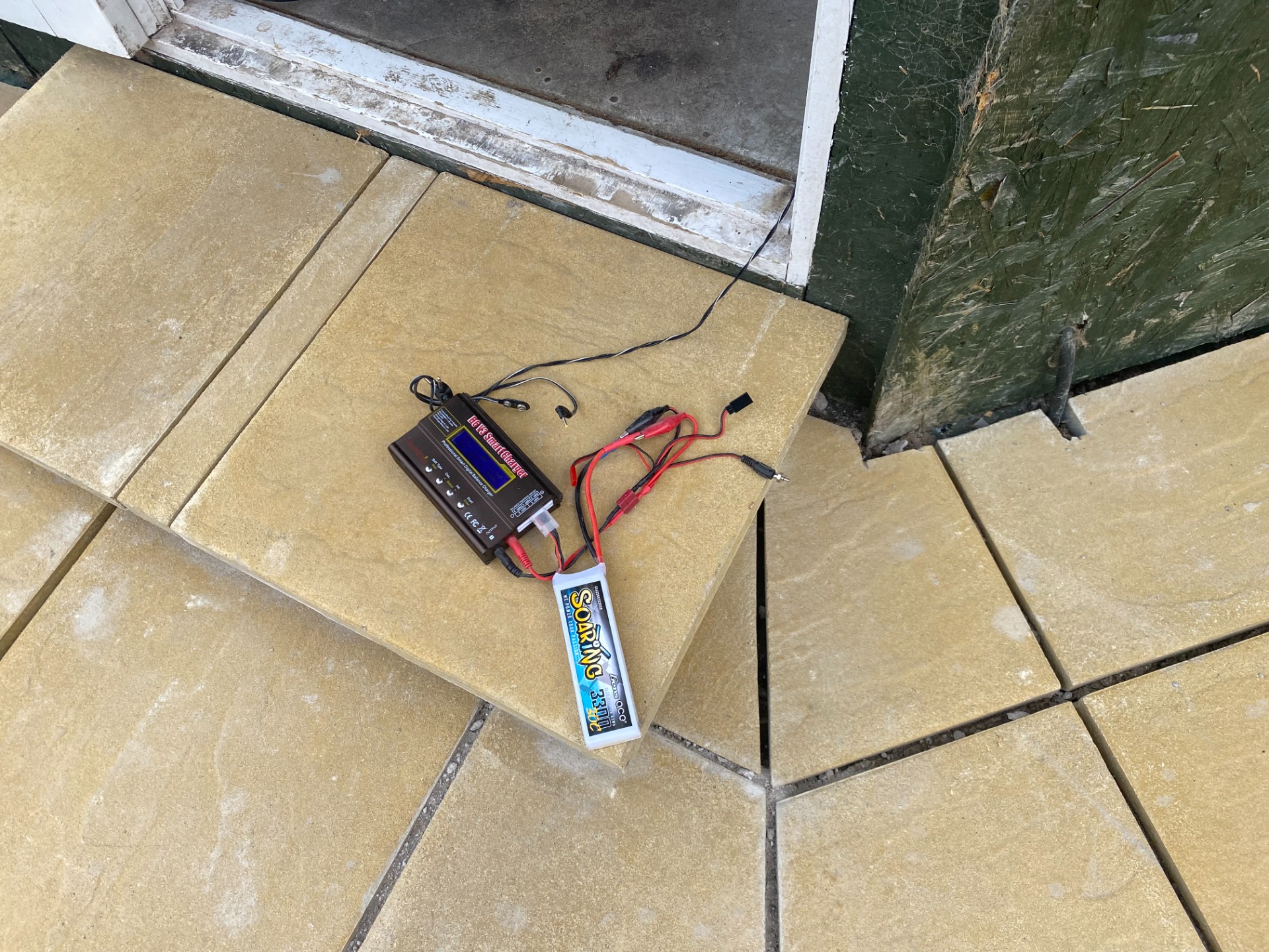

The step into the shed will make a good lipo charging place i think

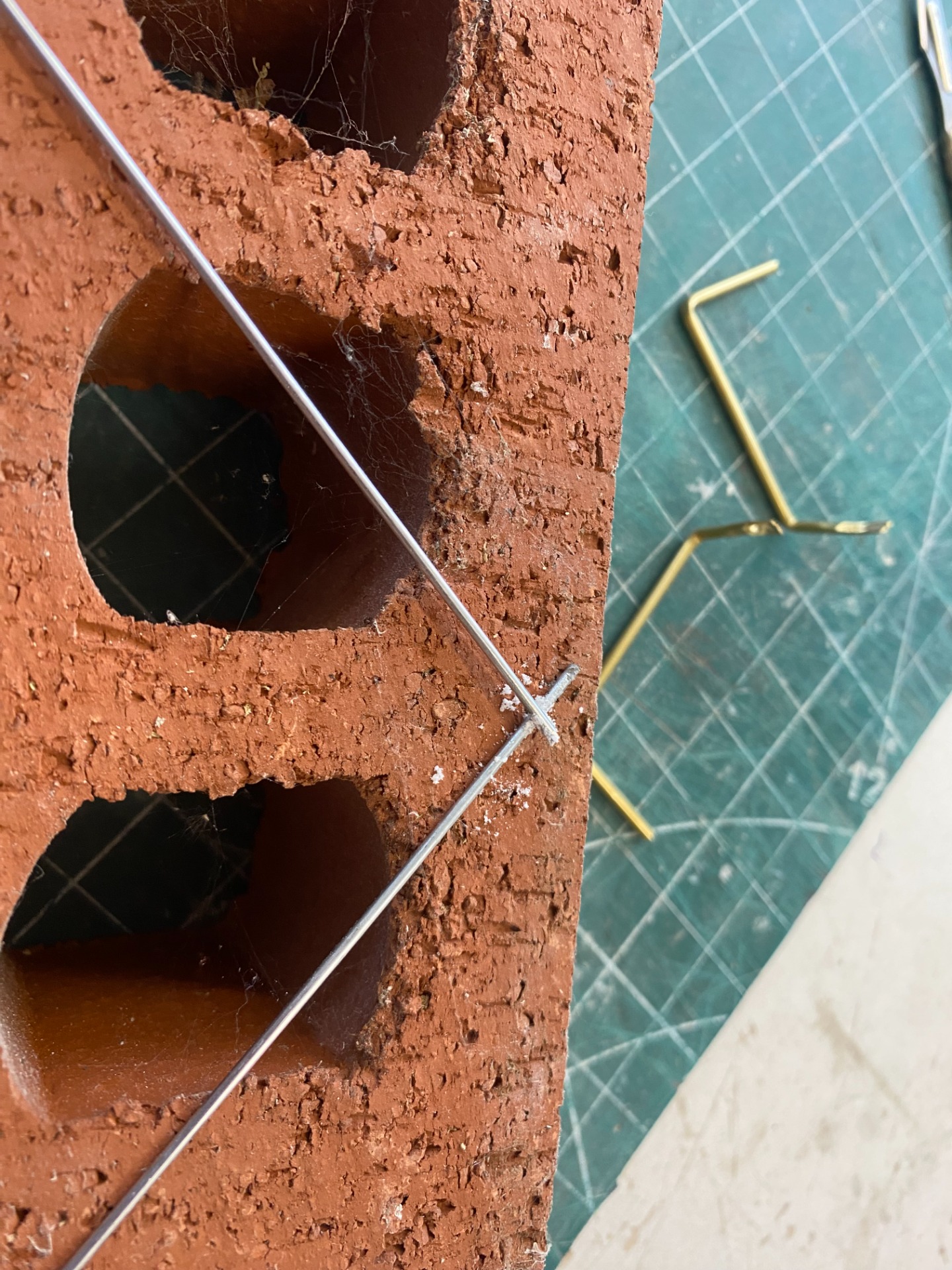

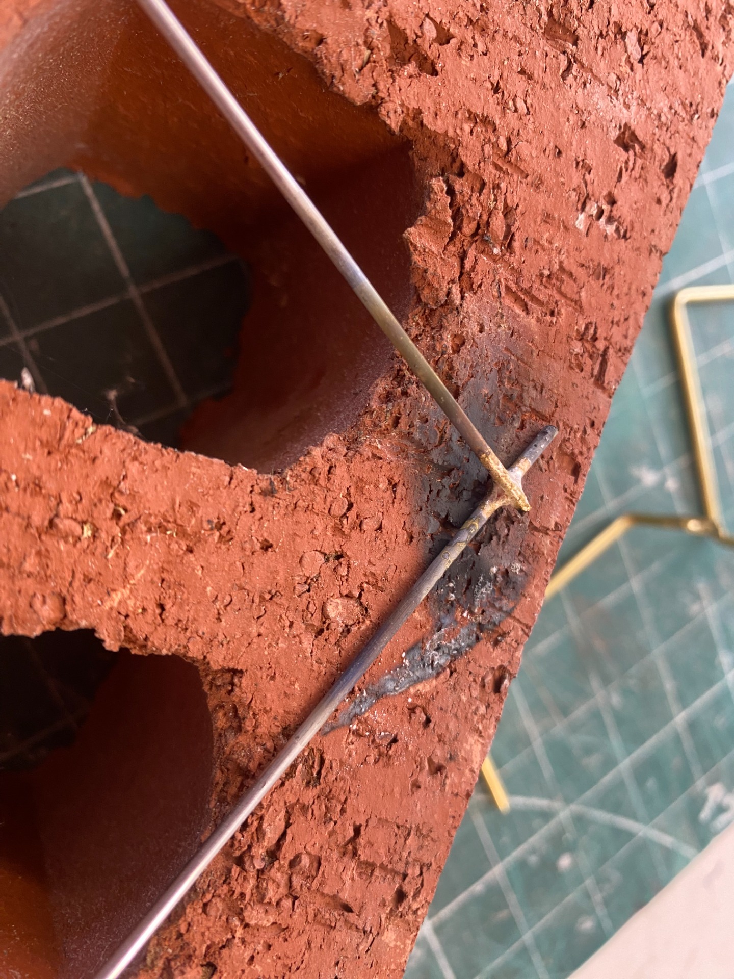

The original model had 2 pushrods to the elevators because of the dihedral on the tailplane so iv come up with something else
A bit of silver soldering
The attached a 3mm carbon tube pushrod to the servo

You've put the brass? torque rods on back to front!
Seriously - the two tubes will be very weak at the 90' bends, and you have no adjustment for surface travel, other than at the servo end.
