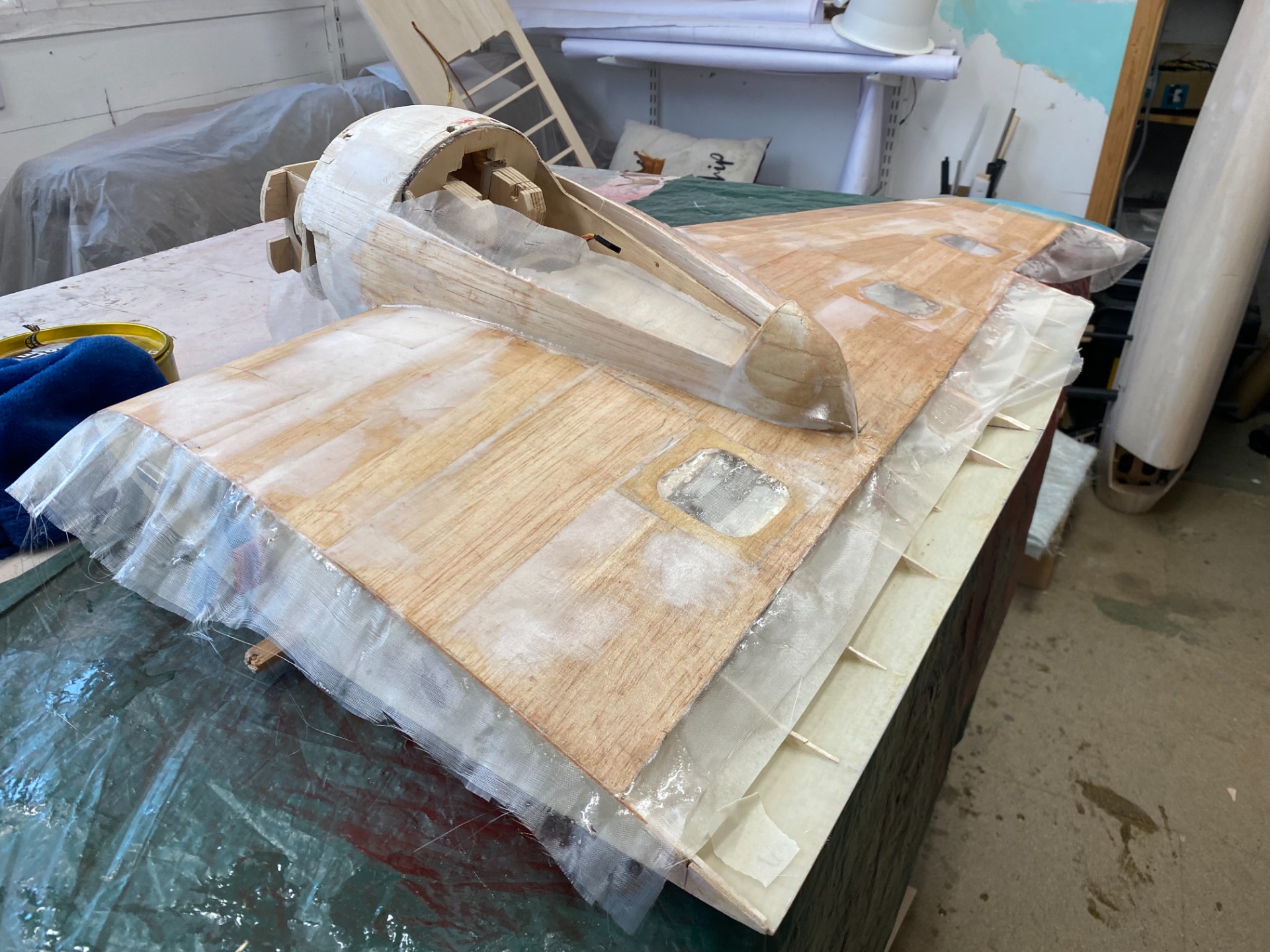

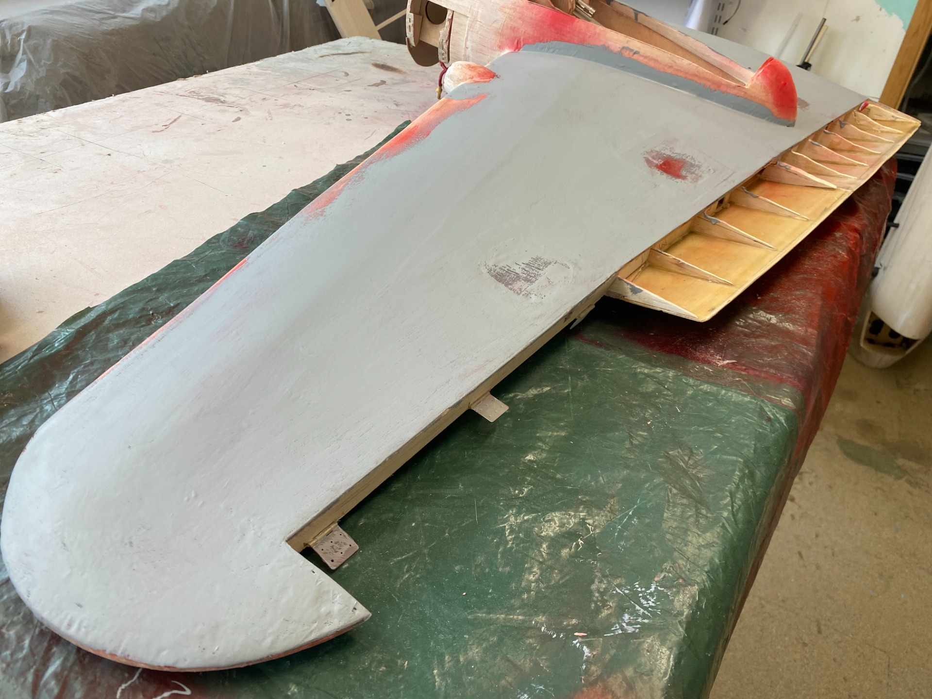

04 Jul 2026 22:32 #166 by THE BLACKBIRD
I started the day with the intention of doing nothing at all but by 2 pm i was bored stiff, so i trimmed the edges of the wing i glassed and gave it a light sanding with the intension of putting a second coat of resin on it, but changed my mind and brushed a thick coat of primer filler on it
Then i glassed the underside of the other wing
05 Jul 2026 09:27 #167 by THE BLACKBIRD
i was going to put a second coat of resin on the wing after i lightly sanded it but it looked to have filled the 18oz cloth with the first one so i brushed a coat of primer filler on it, supposed to spray it on but i get a thicker coat with brushing it, i sand most of it off anyway just covers up my crap building quicker
The i glassed the underside of the other wing

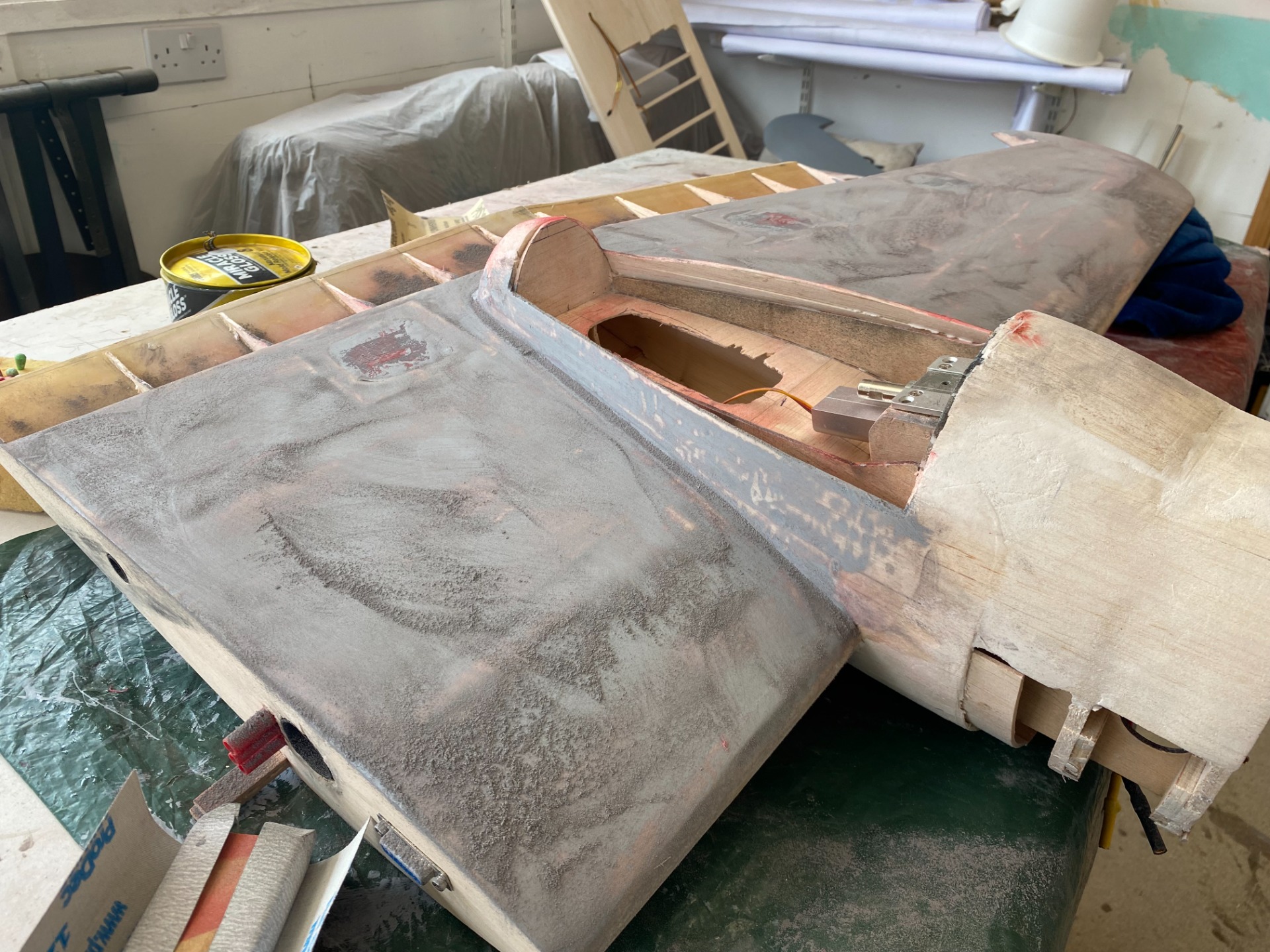

05 Jul 2026 20:16 #170 by THE BLACKBIRD
I trimmed the fibre glass of the edges of the wing i glassed yesterday and a light sanding the i brushed on a coat of primer filler
Then i glass the top of the first wing
The i sanded down the one i had primed
Then glassed the fuselage wing fairings

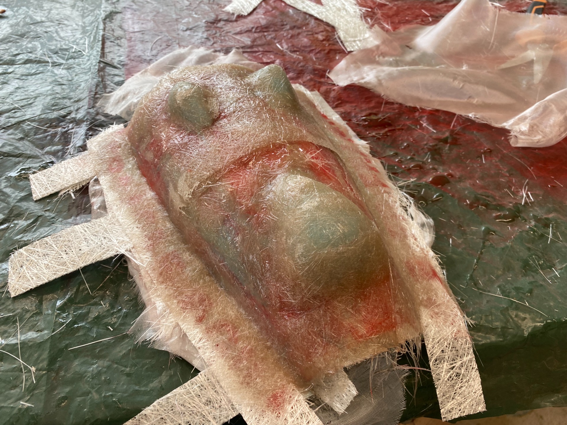

Then i glassed the nose and retract plugs for the moulds
They are outside as the polyurethane resin i did them with stinks, they can stay there till morning

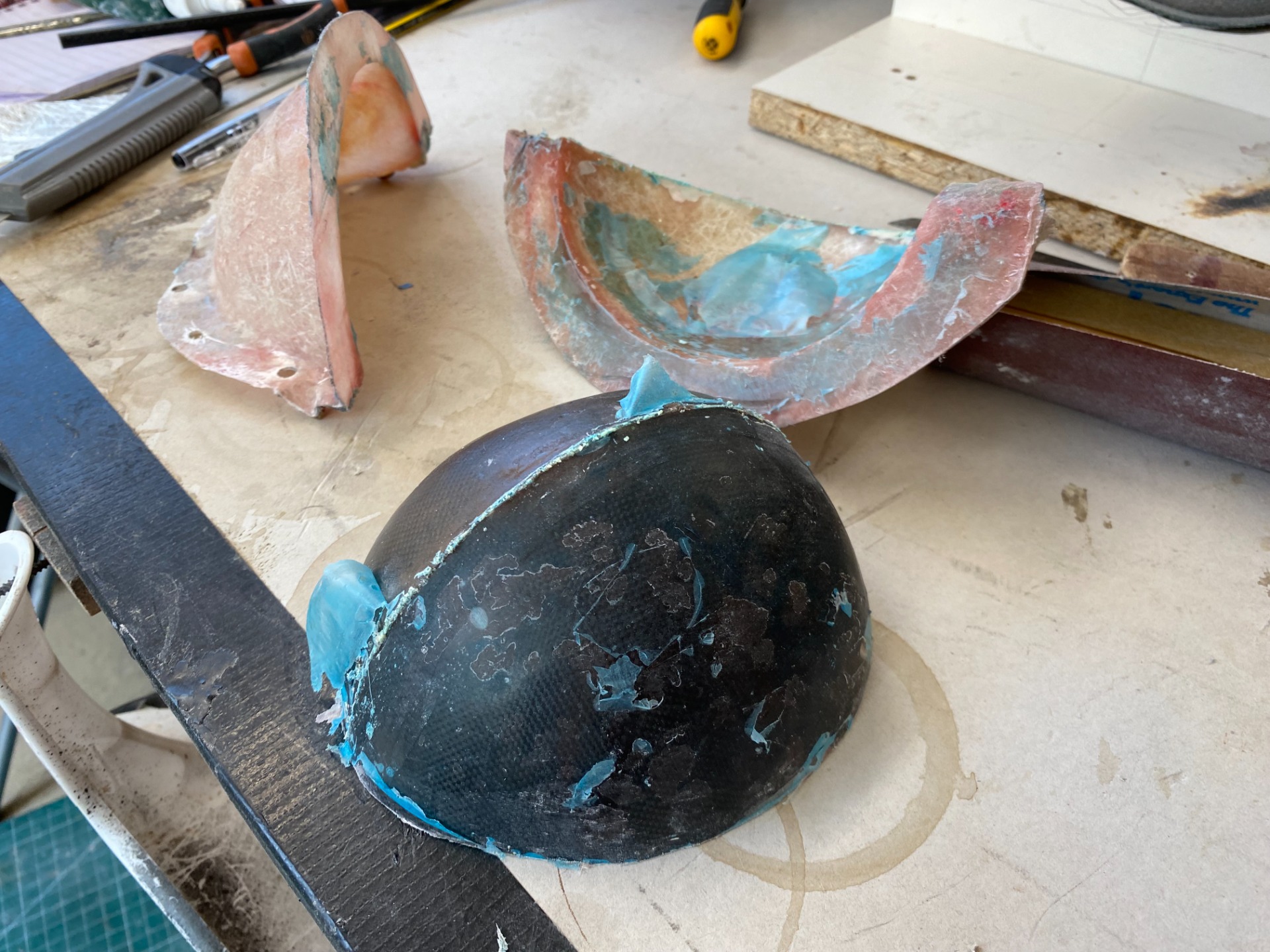

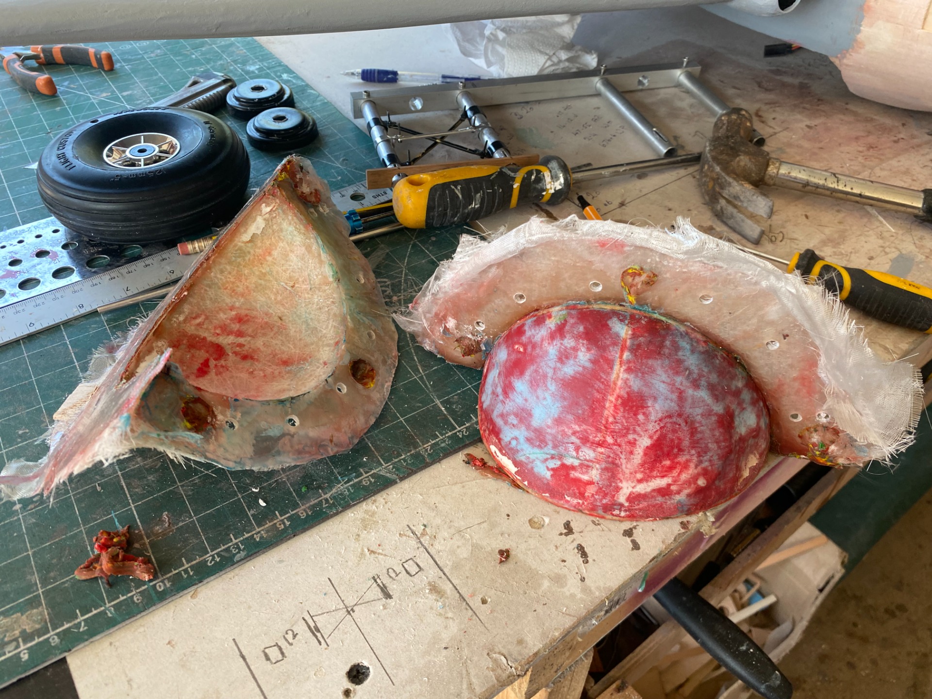

06 Jul 2026 19:48 #171 by THE BLACKBIRD
I need a break from this i seem to have been building it forever
Just been sanding and knocking the moulds off the plugs, had to use a hammer and wedges
Not good
06 Jul 2026 22:41 #172 by Eric
Did you forget the release agent?
07 Jul 2026 10:28 #173 by THE BLACKBIRD
I used a release agent 2 coats of it
07 Jul 2026 11:00 #174 by Quorneng
Replied by Quorneng on topic A nice sized Bristol Beaufighter
In the days when I was involved using glass fibre moulds it was expected that it took a good number of layups using release agents before any mould would release reliably. It was considered that with use the release agent would "permeate" into the mould surface to ensure an easy release.
We originally made our own set of canoe moulds. They were a disaster!
First time we hired, at some expense, a set of well used commercial moulds our own hand laid up canoe shells simply popped out and that was using just a release wax rather than a paint on release agent!

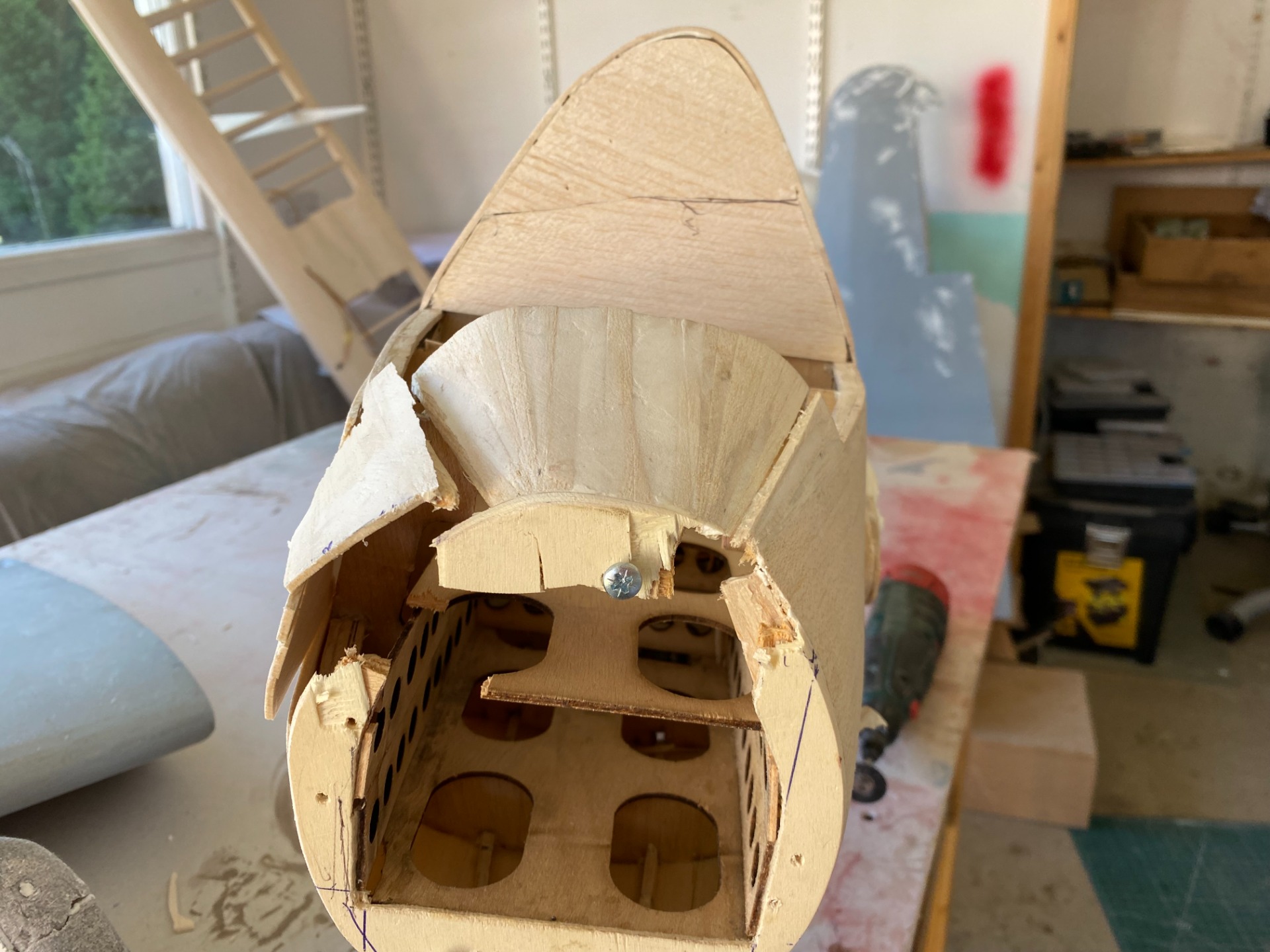

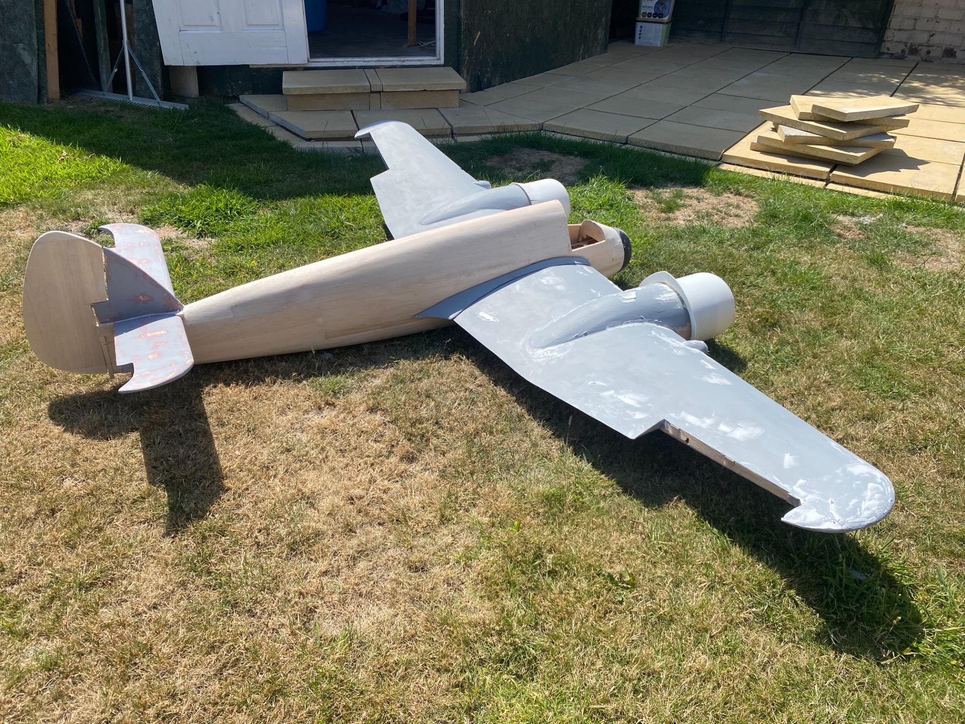

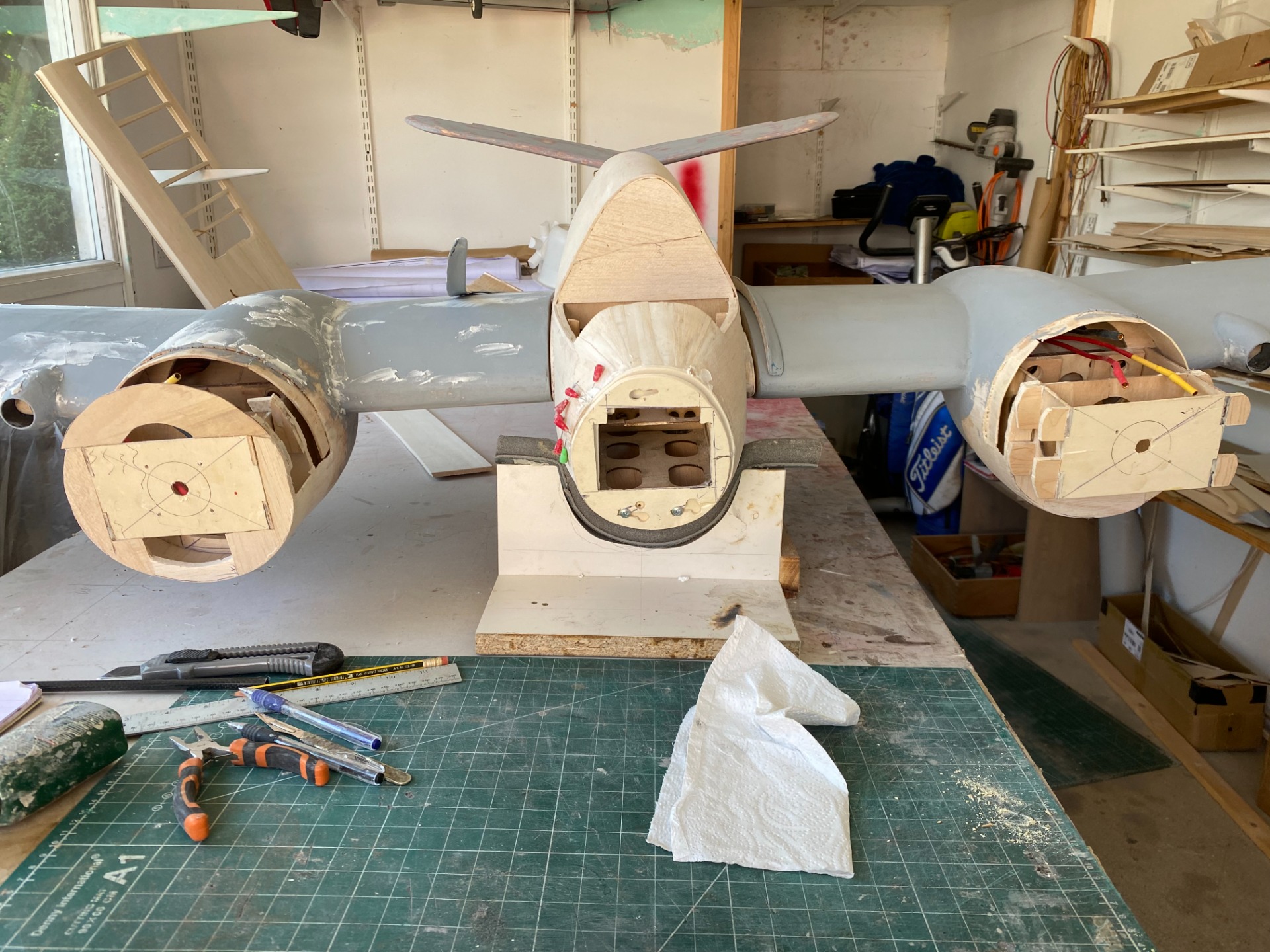

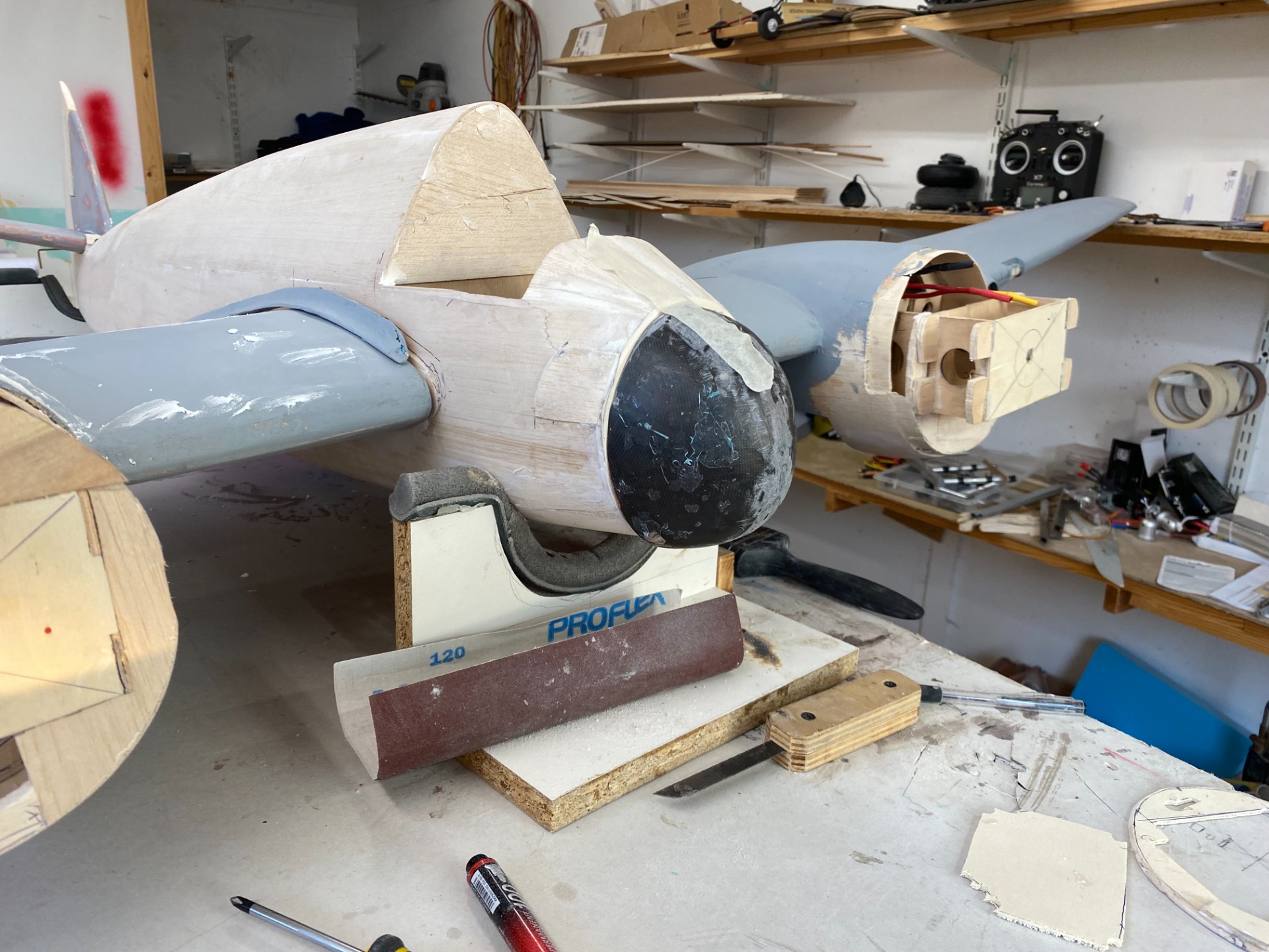

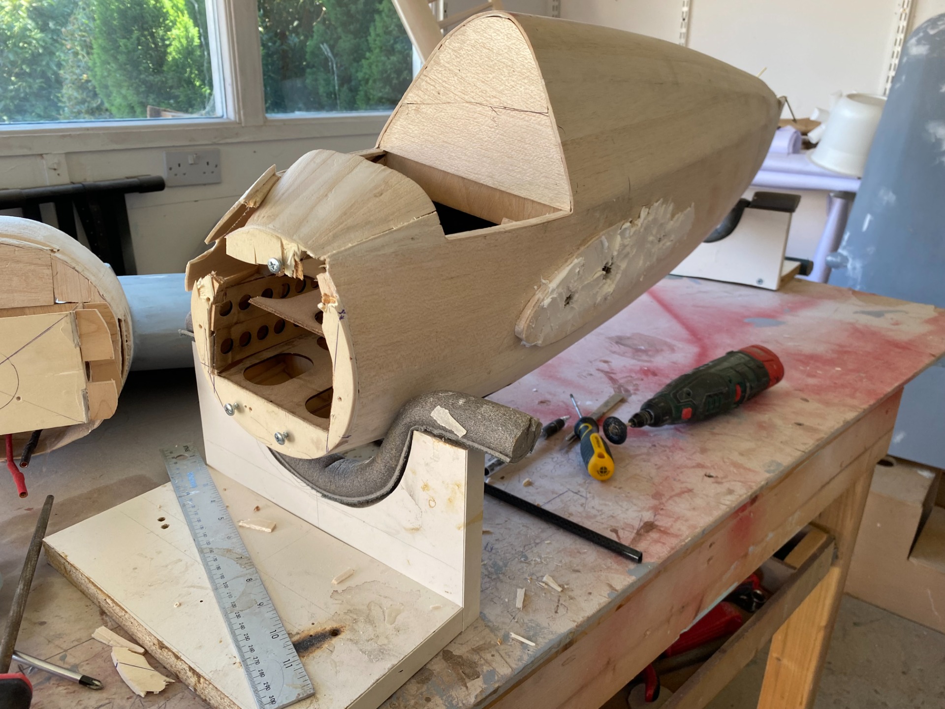

10 Jul 2026 20:49 #177 by THE BLACKBIRD
I got it back together but as is nearly always the case not quite as it was and the mould for the nose cone was made from the original nose, anyway iv been working on the nose cone
I have some adjustments to make on it to get it to fit as i want
Iv also fixed the tail plane and fin on the fuselage but now need to have a different hinging for the elevators as i broke one of them

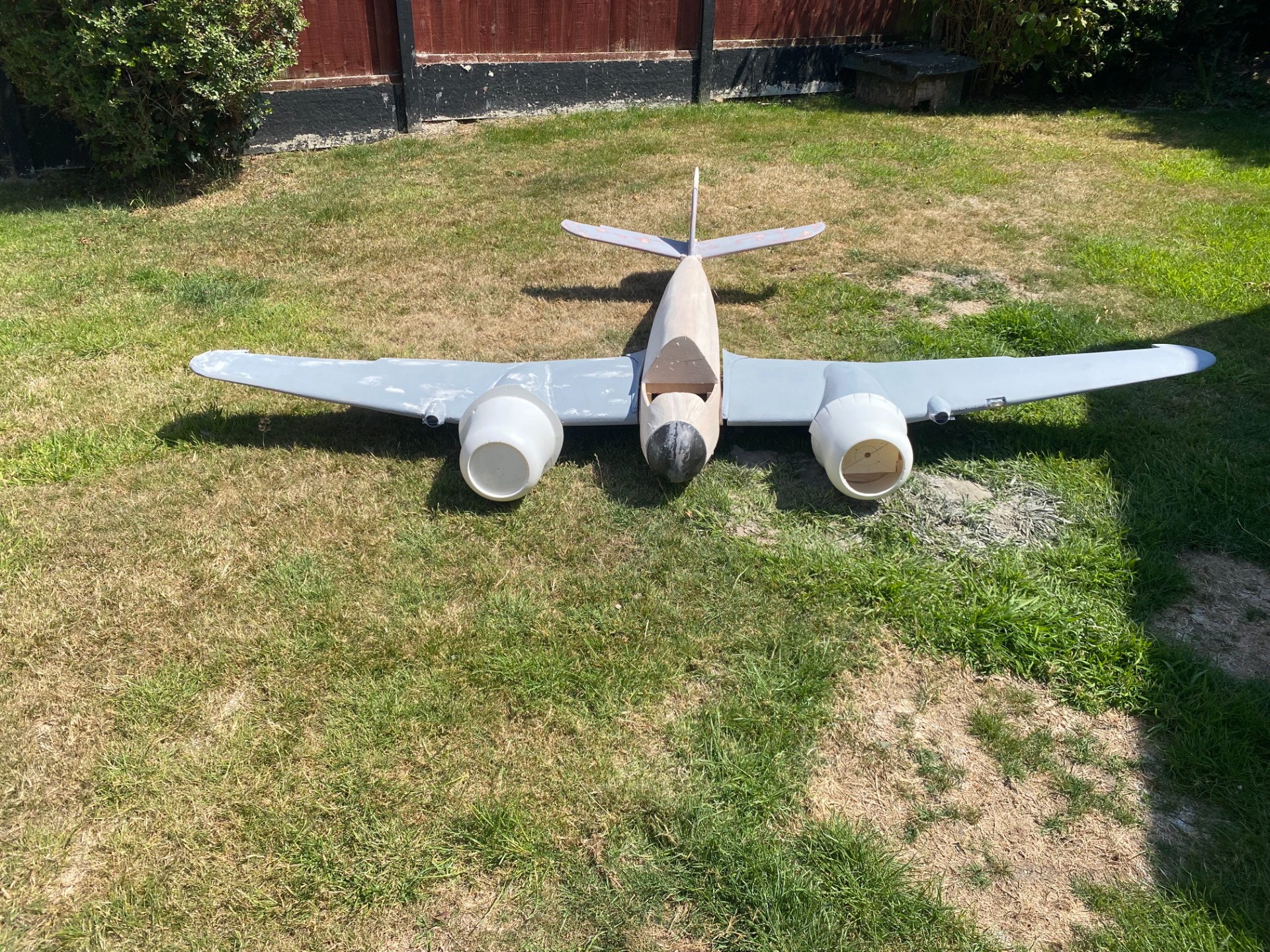

11 Jul 2026 10:55 #178 by Klipkopwildlife
Replied by Klipkopwildlife on topic A nice sized Bristol Beaufighter
That is a BIG model!

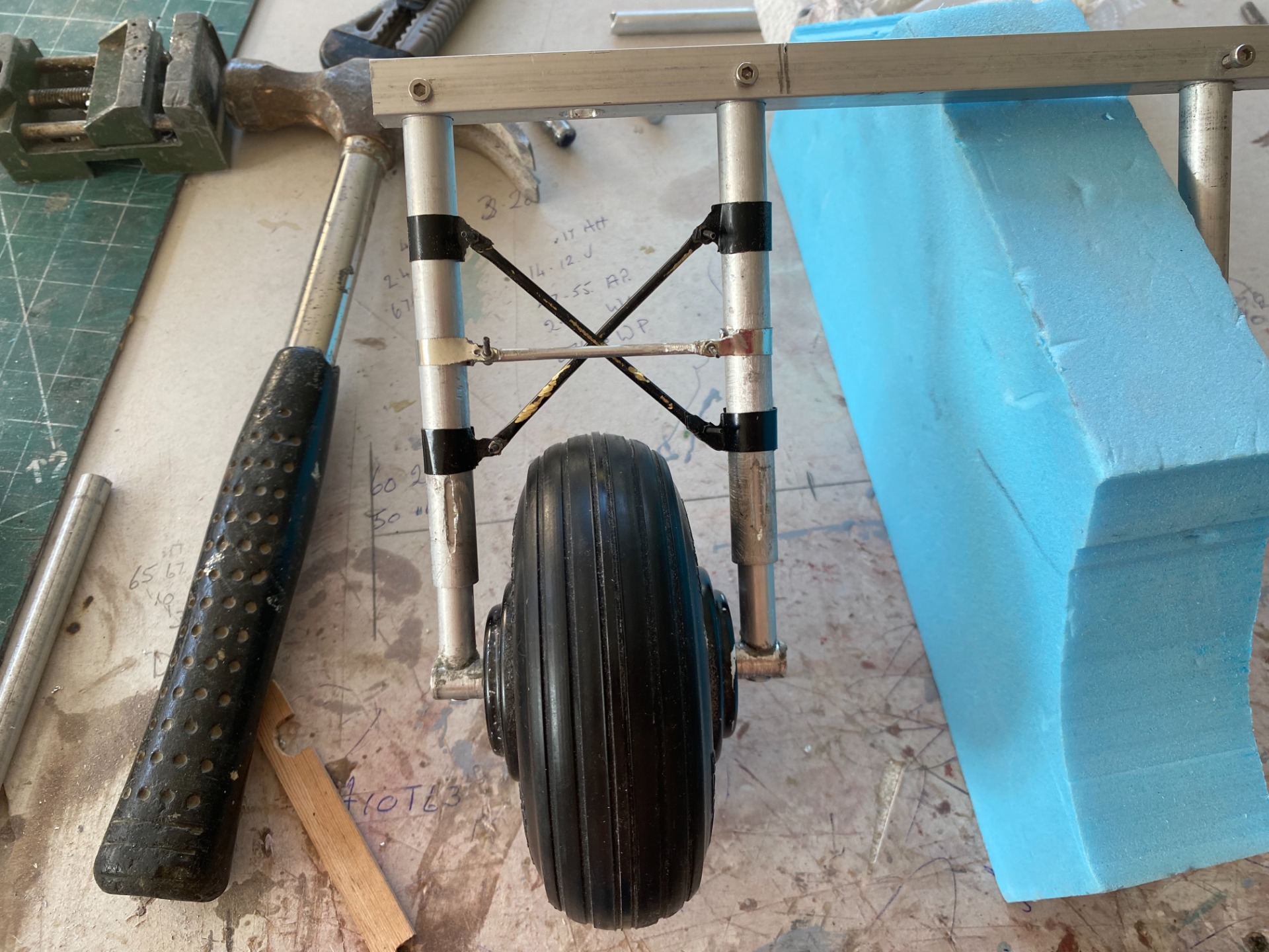

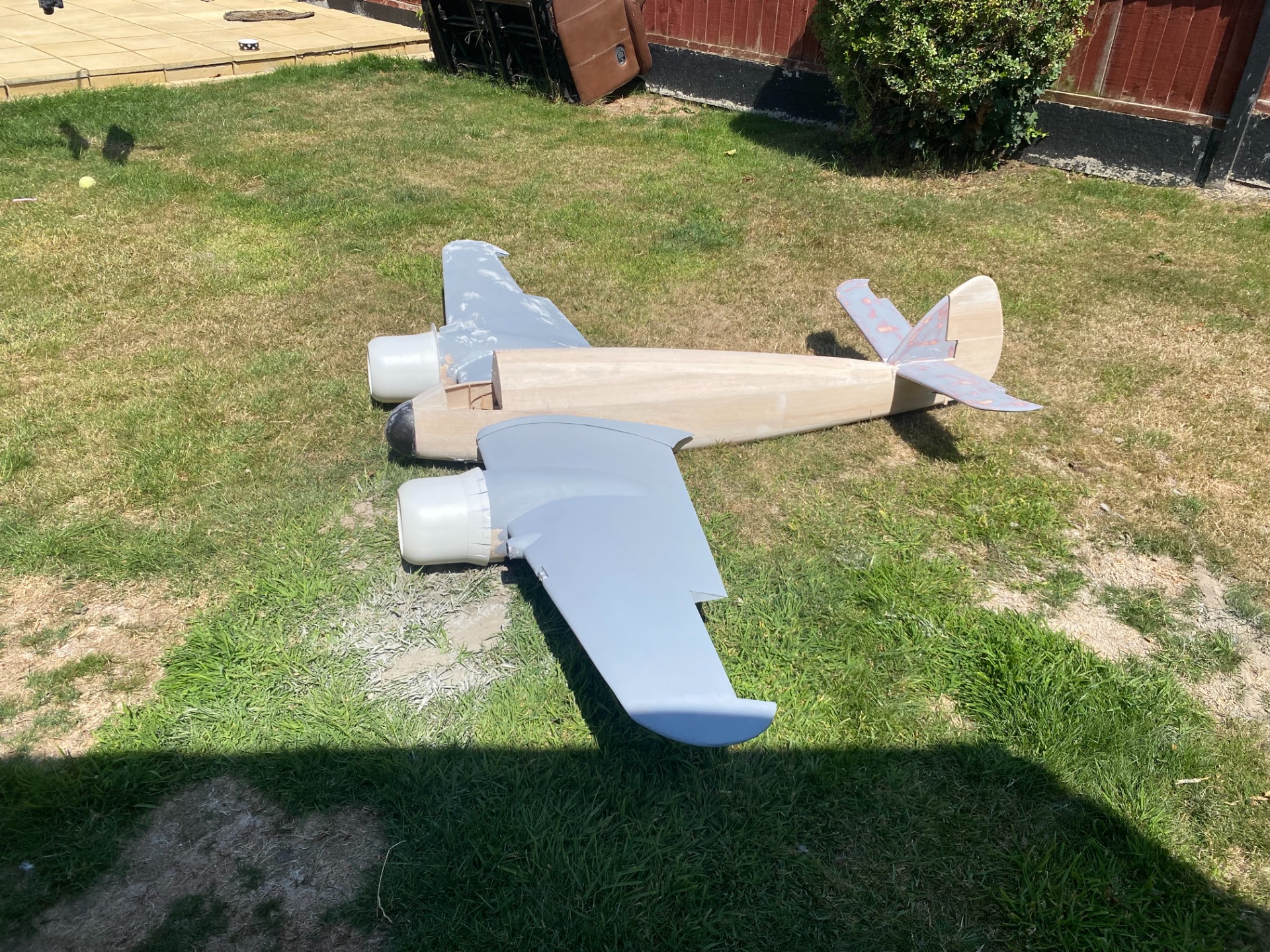

11 Jul 2026 20:32 #179 by THE BLACKBIRD
Took it outside today so i could have a clean up in the shed and bench
And work on the landing gear

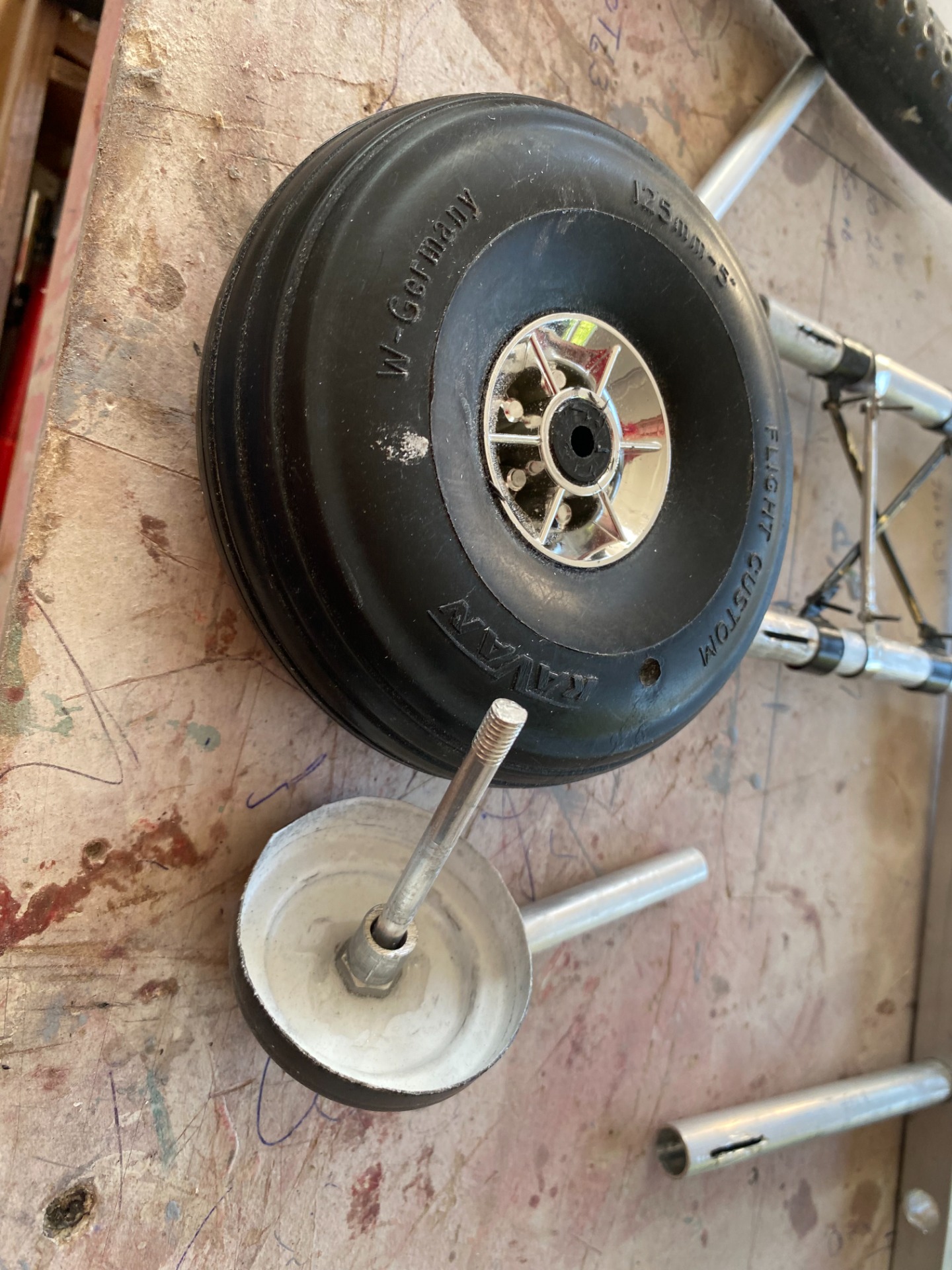

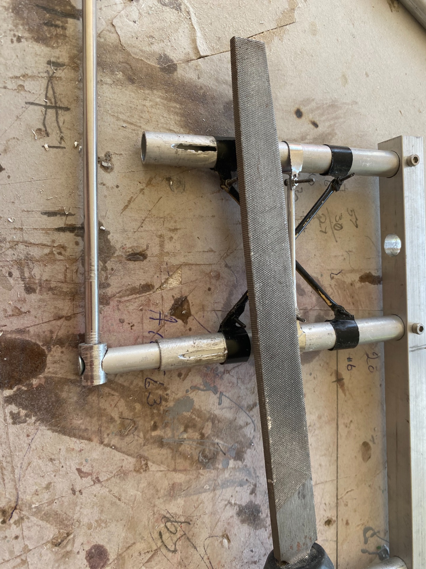

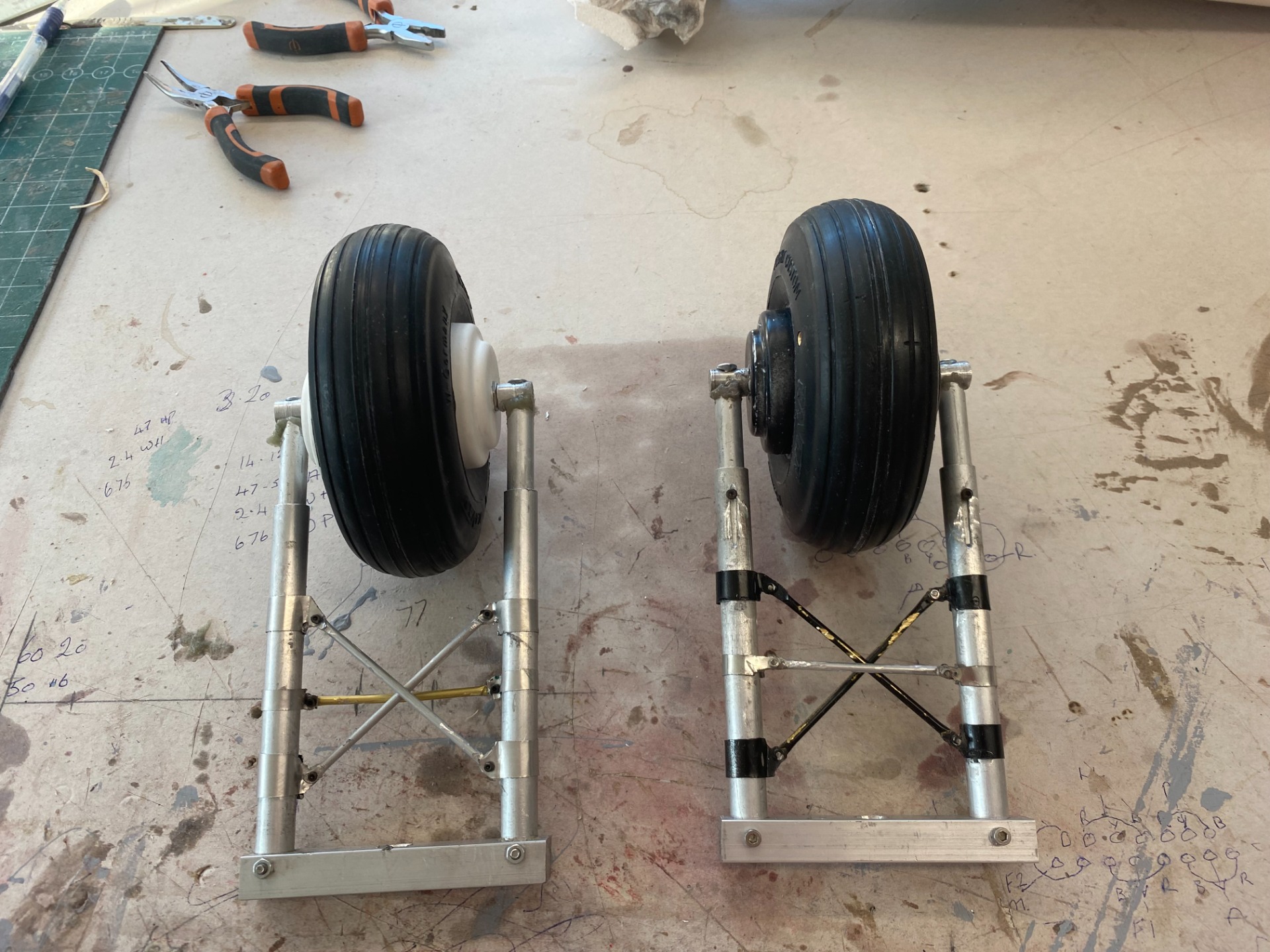

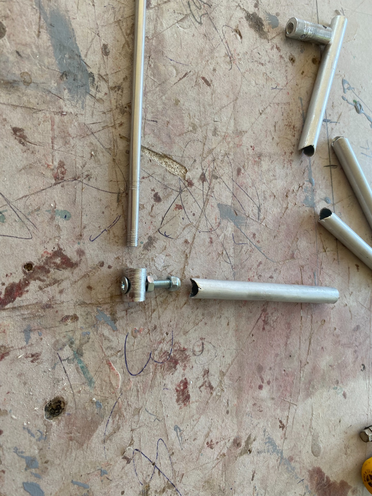

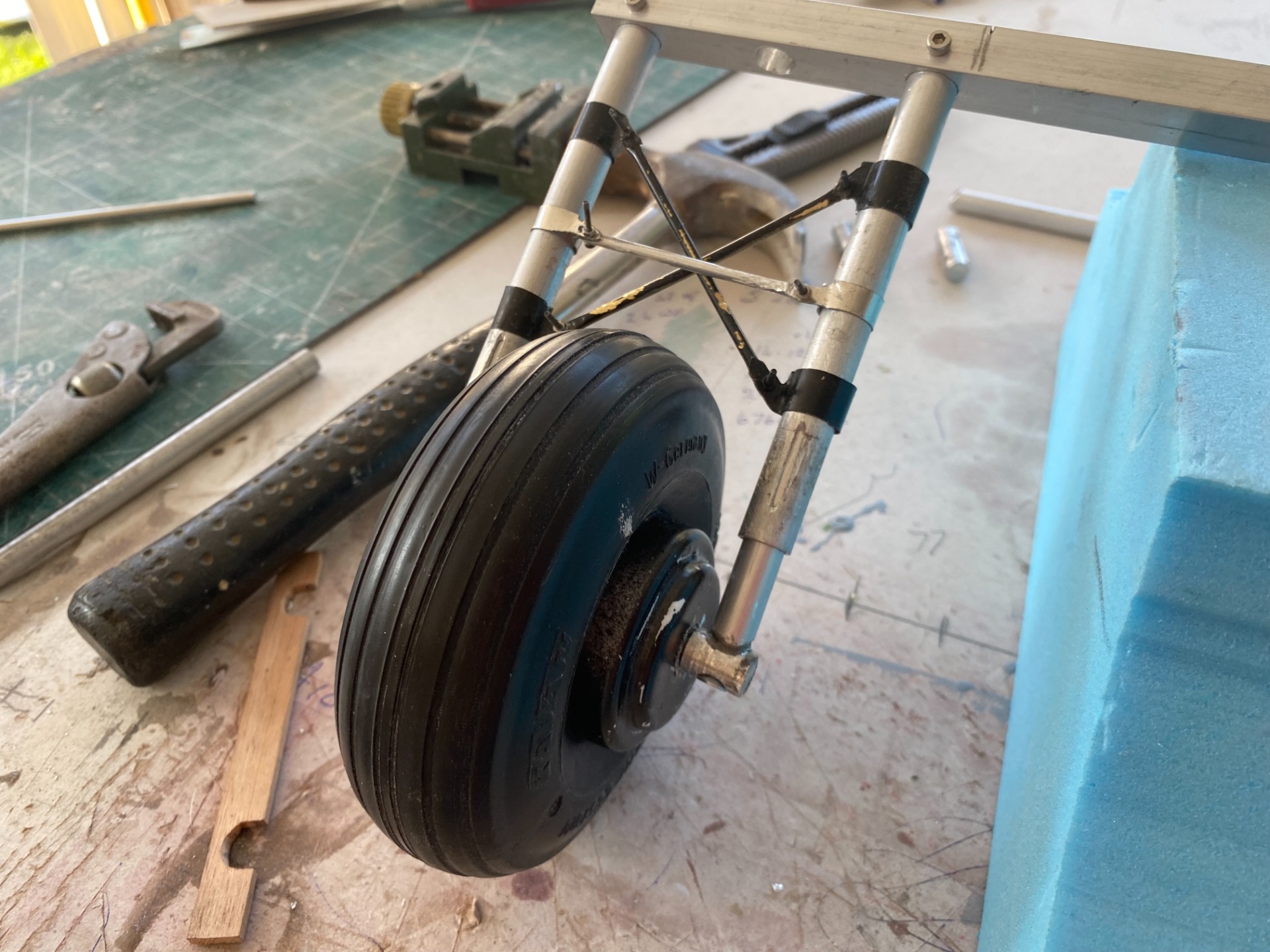

12 Jul 2026 19:28 - 12 Jul 2026 19:30 #180 by THE BLACKBIRD
Hell i cannot believe how many hours its taken to build these
And i have enough ally tube not used because when it came it was not as advertised on ebay, it was either oversized or under sized but i found the right one's in thee end, only the springs came as advertised
