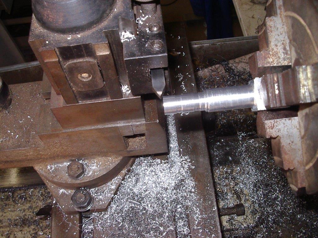

While I have to make one new collar I decided to make 2.
The cutter is ground to 55o. I have finish cut the material to the correct outside diameter of the thread, the undercuts are smaller than the smallest diameter of the thread, this is so I can release the thread feed in fresh air and then wind the cutter back. I have also given myself plenty of room from the chuck, since this machine has a minimum speed of 160rpm.
Drilling the collars 5mm, this is the nominal thickness of the new conrod, after drilling and reaming the conrod hole I will elongate the aperture in the collar, much the same as they do on the Mills.
