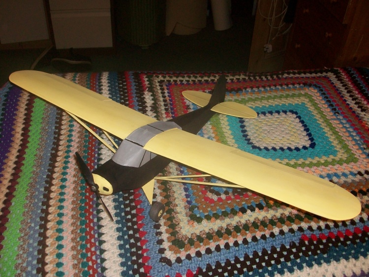

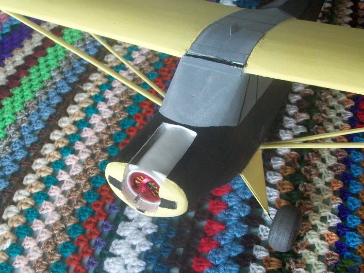

Decided on a contrasting colour scheme!
Still a bit more finishing to do.
As it suffers seriously from motor torque at slow speed I am thinking of changing to a 3s along with a smaller and finer pitch prop (6x3 rather than the current 7x4).

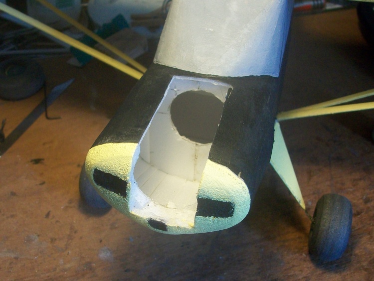

I commented the Super Cub now sounded like it had a gear box so the motor had to come out.
Looks brutal but it is the penalty for a lightweight build it all in technique.
When I took the motor apart and extracted the front bearing you could feel it grating when it was rotated. :woohoo:
Fortunately I have a spare.
I will take the opportunity during the rebuild to add more down thrust.

The new motor tube.
A bit larger diameter this time to give more clearance to the motor bell and flush with the top of the cowl giving about 3 degrees down thrust.
All complete.
And you can hardly see the join! :P
