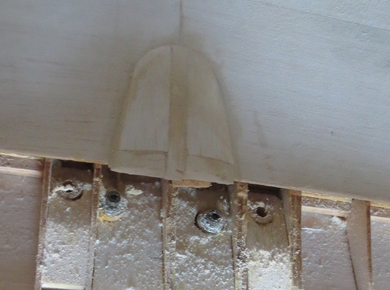

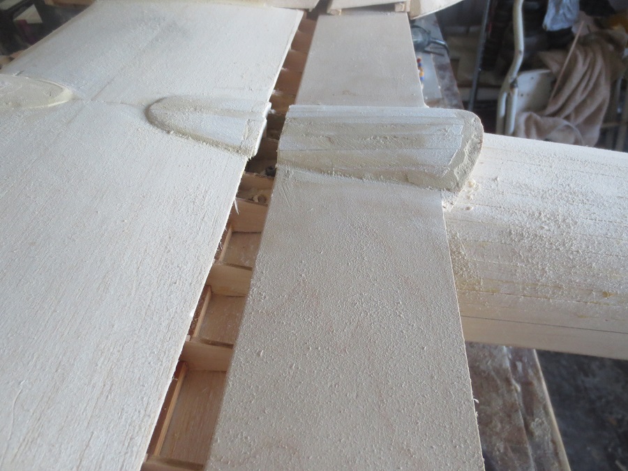

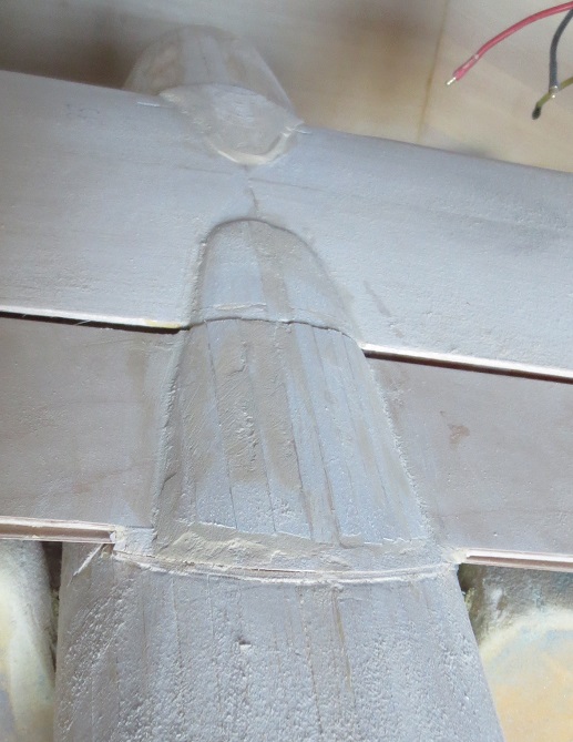

Progress on the nacelles, with the rear profile blocks tacked on, finally found a home for some balsa blocks bought yrs ago,they where shaped, removed and hollowed out, they are a bit rough at the moment, but full sanding will be down later'
The wing undershape was built with a slanting rear edge, to accomadate the flap folding

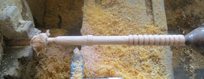

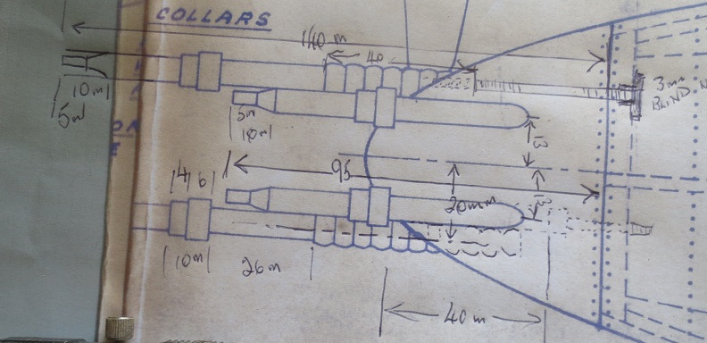

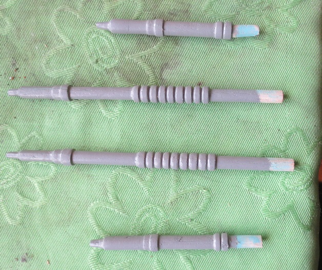

I have been doing a lot of fiddly stuff on the nacelles and fuz with not much to show, but I have managed to "turn down" some 8 mm dowel for the cannons, as one would expect, the first one isn't so hot ( short one) it will be done again, they will be removable via a 3mm bolt and a "blind nut", Hopefully if the model noses over on landing, the nose will pop off due to the magnets :whistle: but I can always replace them if required.
Now the next hard bit is to drill though the nose block square, vertically and horizontally, I have drill press so that will help some

Change of plans:- after playing around with mounting the cannons and nose block, trying to get all the cannons equally distance and all at the correct angle, is just not working, I've decided to make 2 nose blocks:- 1 with the cannons glued in place ( for show ) and the other a blank test flight nose. [badass] :) :) :) :) B)

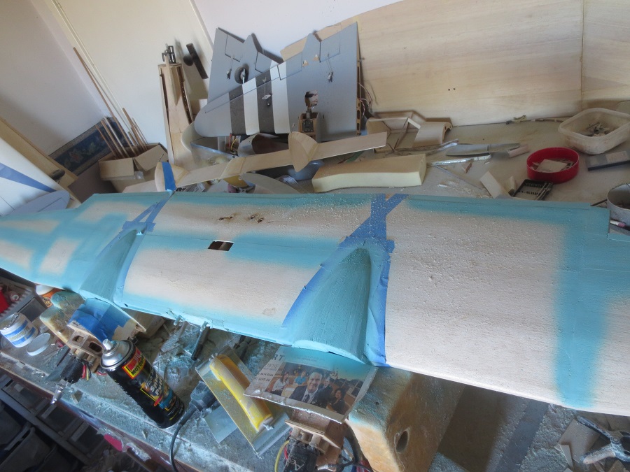

Most of the time spent now is to the finishing of the bird, not a lot to show as sanding, filling and sanding over and over, then the colour. Deluxe Adesives will be used to glue down the thin f/g, and so the process goes on and on :blink:
