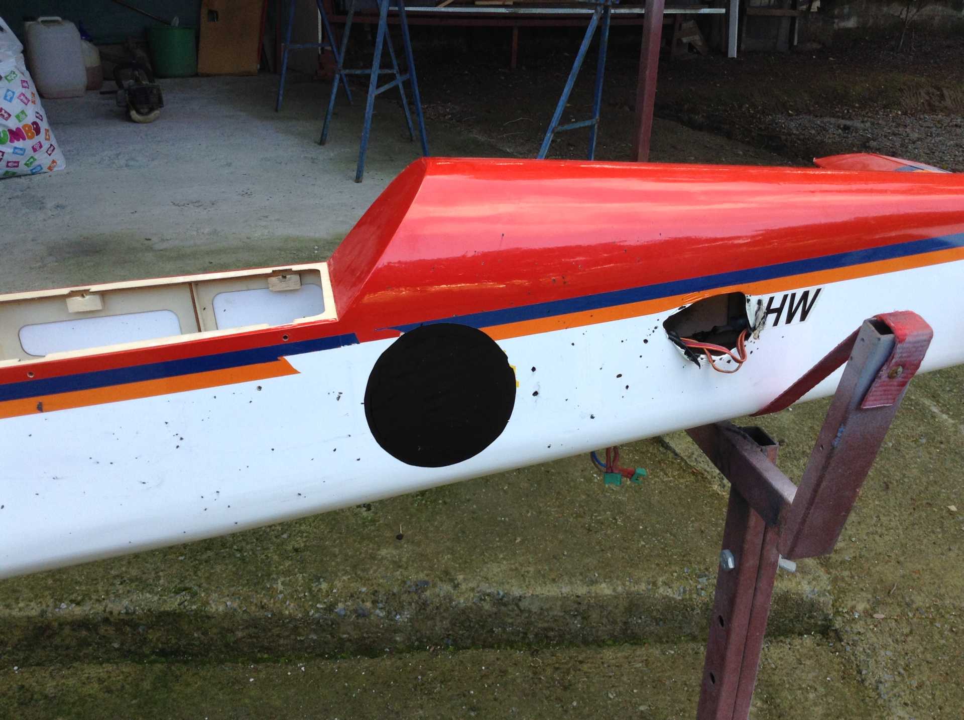

Friday night was another one of my nights without any sleep, so there I was in the little shed working on the F104, and as I was going flying Saturday morning I thought I would top up the lipos in the revolver, could not need much as it had not flown since the last charge
So there I was sat in the chair next to the charger, maybe dozing when all of a sudden this horrible smell brought me to my senses, yes that's right the Lipo had gone up in flames and yes it was in the plane, so I yanked the leads out to break connection and grabbed the fire extinguisher, a co2 one we Ihave for the jets and gave it a good one burst into the fuselage were the lipos are, did not put it out but dowsed it enough for me to whip out the two lipos, they were fairly new ones
This is the result
Good job I was there, and I know I should have taken them out to charge, but I always top them up in situe,

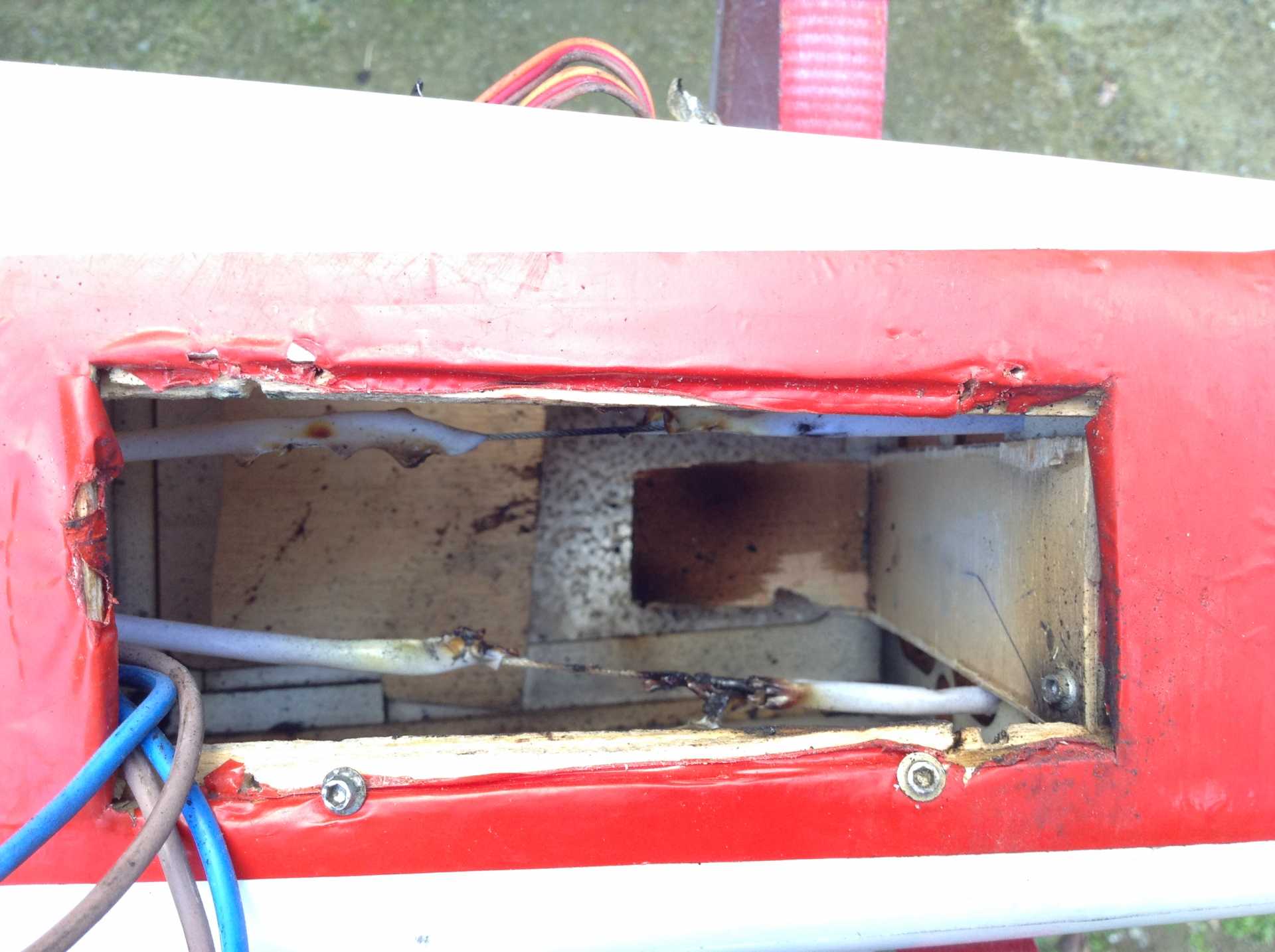

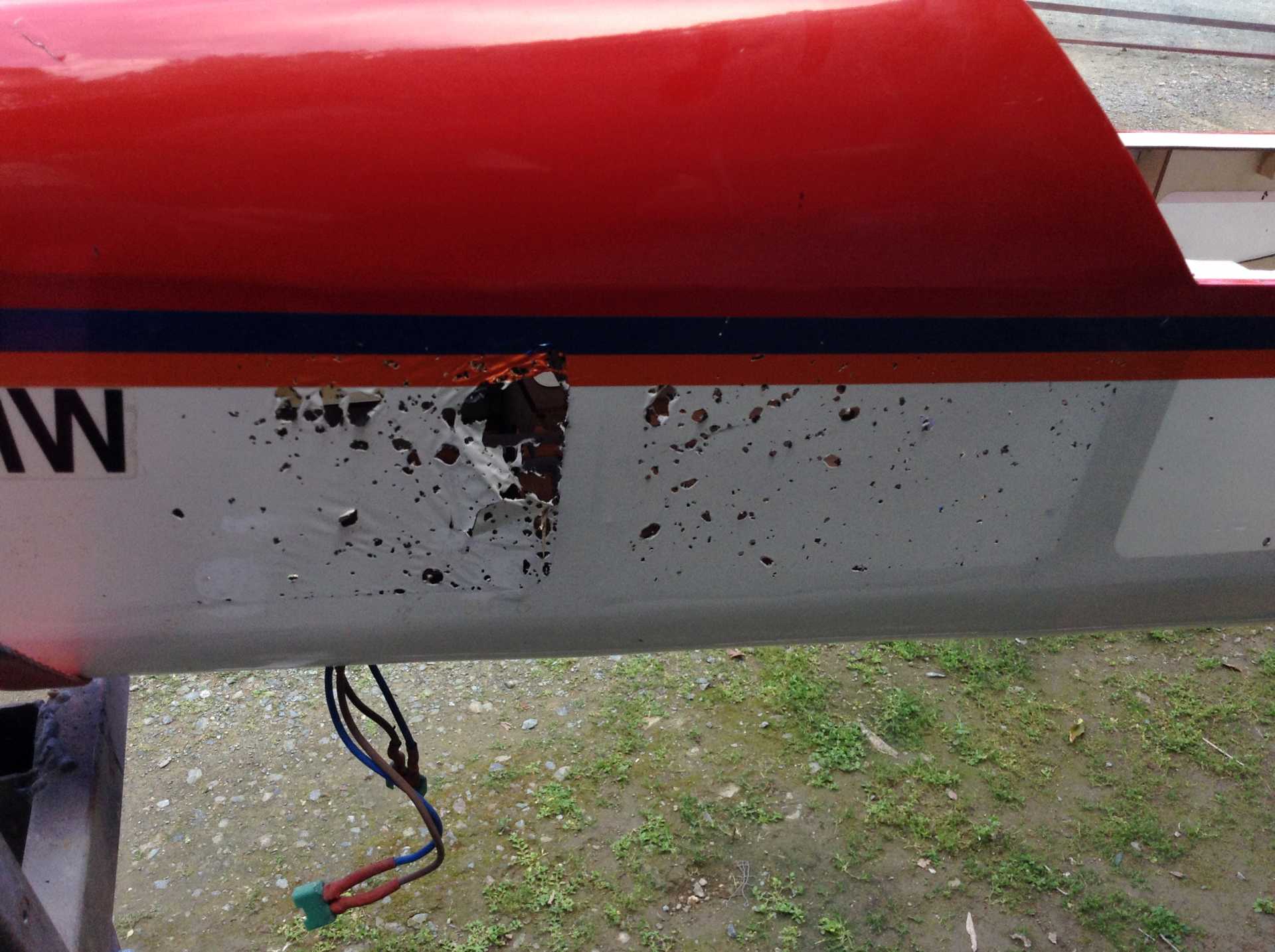

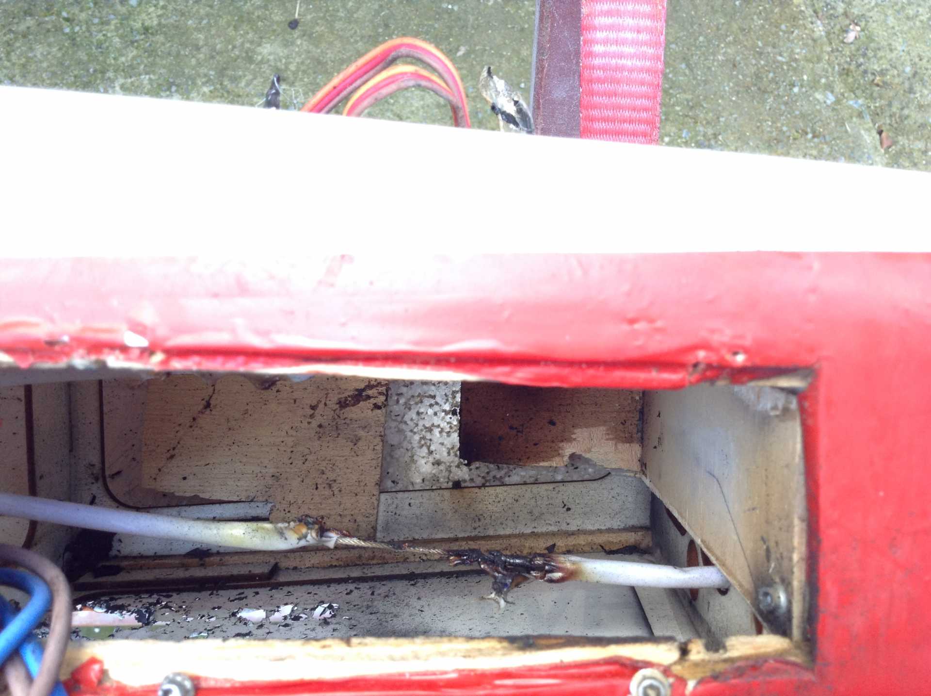

Complacency sets in, when I gave it what for with the extinguisher it blew the burning embers down the fuselage and pinholes all the film, the amazing thing was it burnt completely away the carbon tube that the elevator servo wires run through, and did not harm the wires, the two plastic tubes the pull pull wires run through were melted
Never again :S

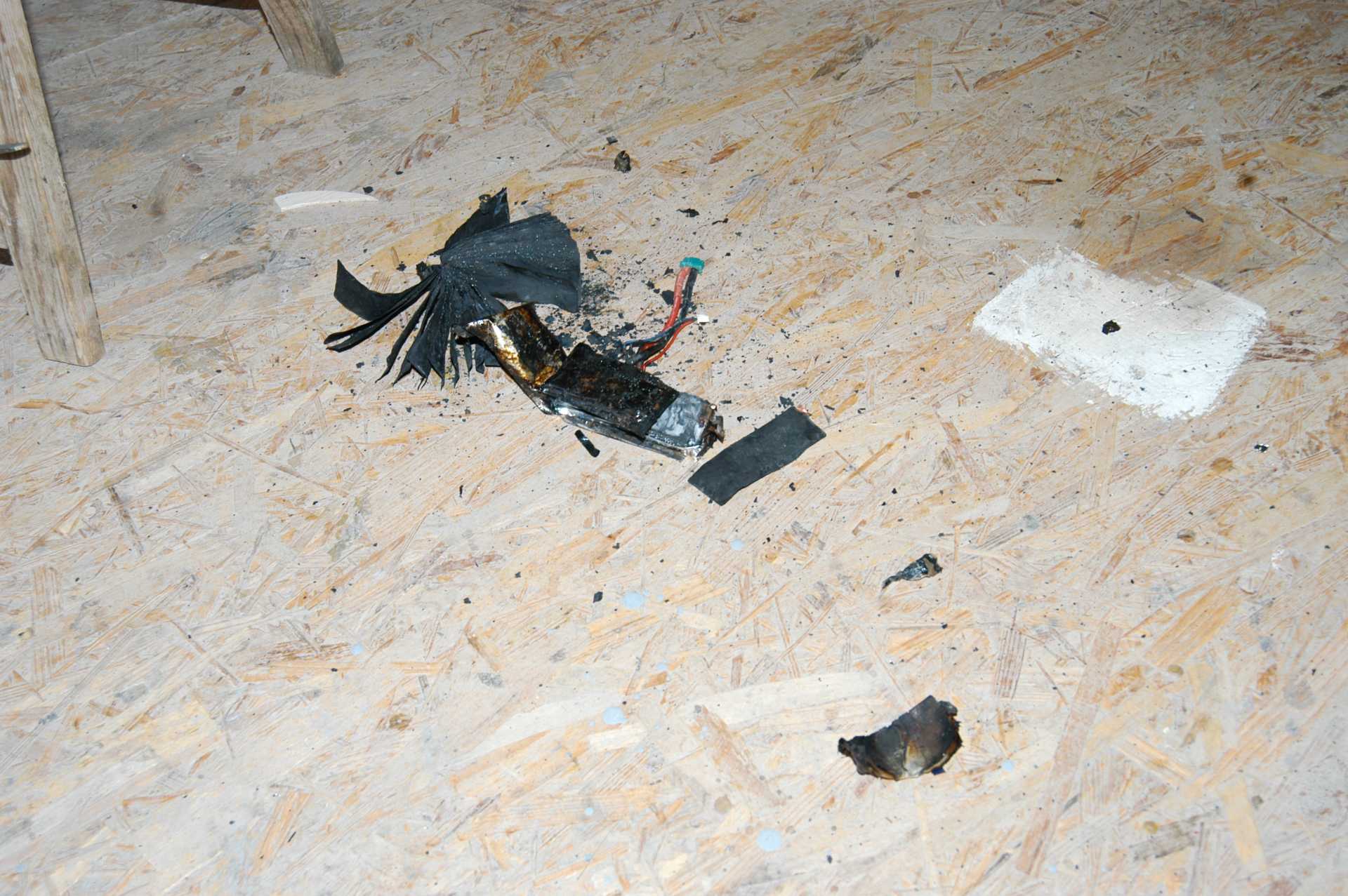

BB - there is no fire extinguisher on this planet that will extinguish a burning lipo. As they burn, they generate their own oxygen, so are impossible to smother.
I suspect - in future - you will charge your lipo's on a concrete block away from anything flammable! (and keep them in a metal box with vent-holes, so if one decides to combust, the expanding gases will not make the container explode!)

I'll reinforce Eric's comment above about CO2 being ineffective against a LiPo fire. I would also add that if you manage to put any fire out with CO2, you'll still need to cool down whatever it is that caught light after you stop applying CO2, otherwise what ever it is will re-ignite. CO2 on its own provides very little cooling, all it does is starve the fire of the oxygen required to support combustion.
And while I'm on my soapbox, LiPo's should be charged outside the model, not inside. ;)

I did not say the co2 PUT OUT THE FIRE I said it doused it enough for me to get it out of the plane
I know it would not kill the Lipo fire but it sure as hell prevented the revolver from burning :angry:

This is the lipo in question, laying on the shed floor where i dropped it after whipping it out of the Revolver, now it looks to me that the blasts i gave it from the extinguisher put it out, as you can see it has not burnt the wood floor more than just a black stain, i just dropped it and concentrated on the burning model then gave the lipo another burst, but you are convinced it could not have put out the lipo
