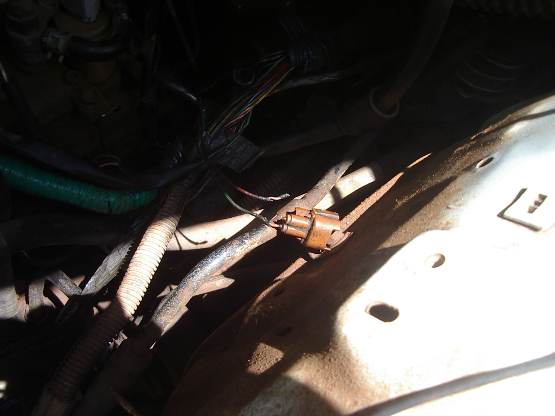

We had rain yesterday so it's a bit cooler today, I decided to attack the wiring of the pump to no avail! Then I tested the continuity from the computer to the pump, I got continuity for all wiring except, you guessed it, the connection from the burned resistor to the pump! Back at the pump I eventually found a connector buried underneath the pump with the correct wire colours on it! One of them was burned off.
I believe it's the connection to the timing solenoid.

15 Jan 2019 07:20 - 15 Jan 2019 07:59 #11 by Klipkopwildlife
I think the resistor is supposed to be a current limiter in the event of a short. I'd rather this than the Landrover solution of fusing everything! Someone in the long forgotten past used a piece of galvanised wired to stop the plug from slipping off the solenoid! Time and vibration did the rest. I might add, this car has obviously been in a number of accidents, I would never have bought it but when our 1990 model Hilux 4x4 was stolen (from outside the Magistrates Court!) I needed a vehicle. This was offered to me by a Tenant as part payment for a loan. I obviously wasn't going to get the money back, (and never did!) So it seemed like a good idea at the time.

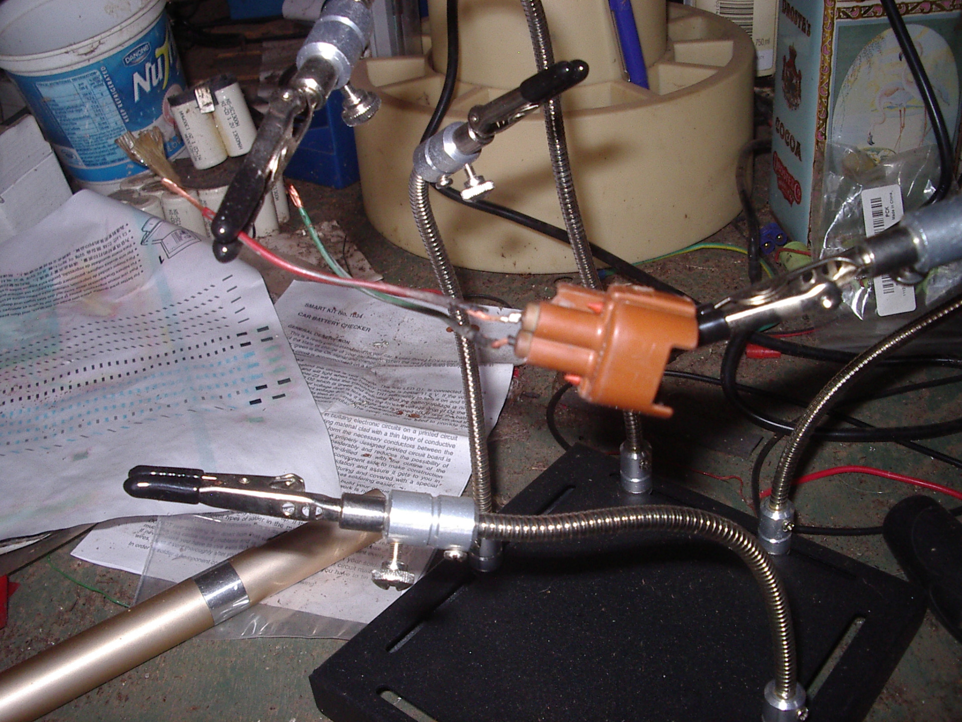

I've managed to strip the insulation back and solder the wire on.
Then I'll put some Heat shrink to give it some support.
I then put the plug on the pump and measured the resistance from the computer end, 11.2ohms, damn, the on line manual says it should be 20ohms. New solenoid on order, only 200pounds!
