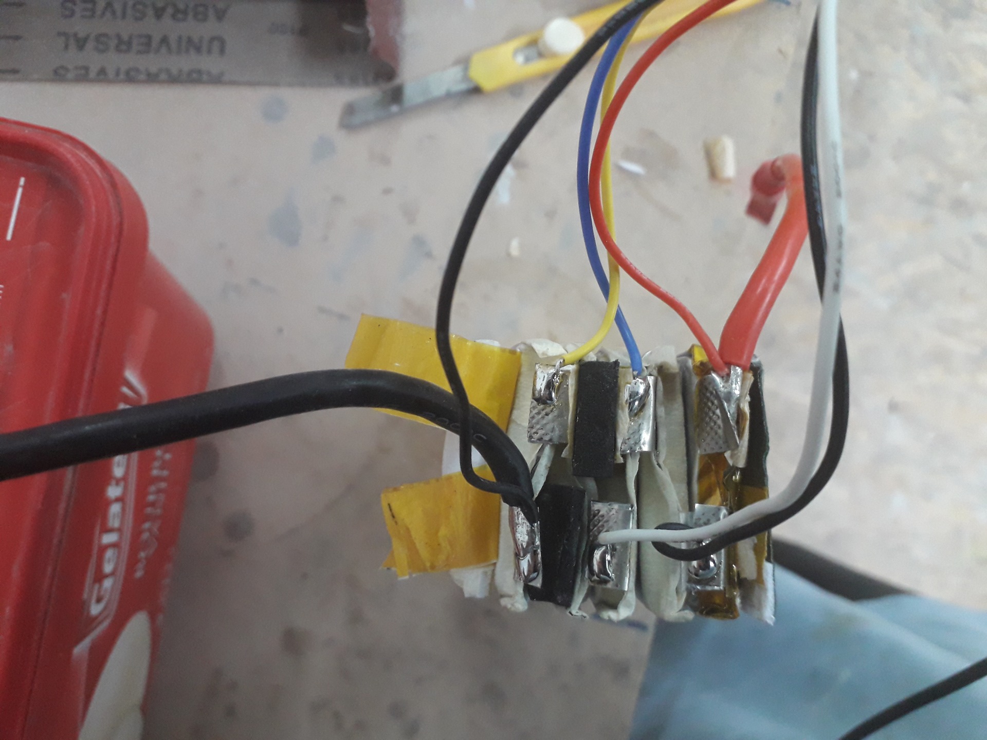

Lipos yuk was created by THE BLACKBIRD

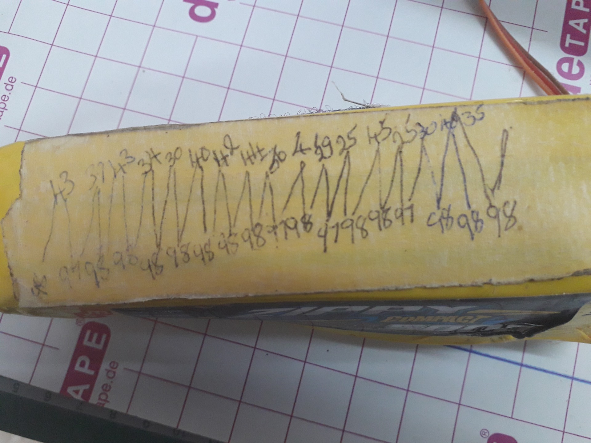

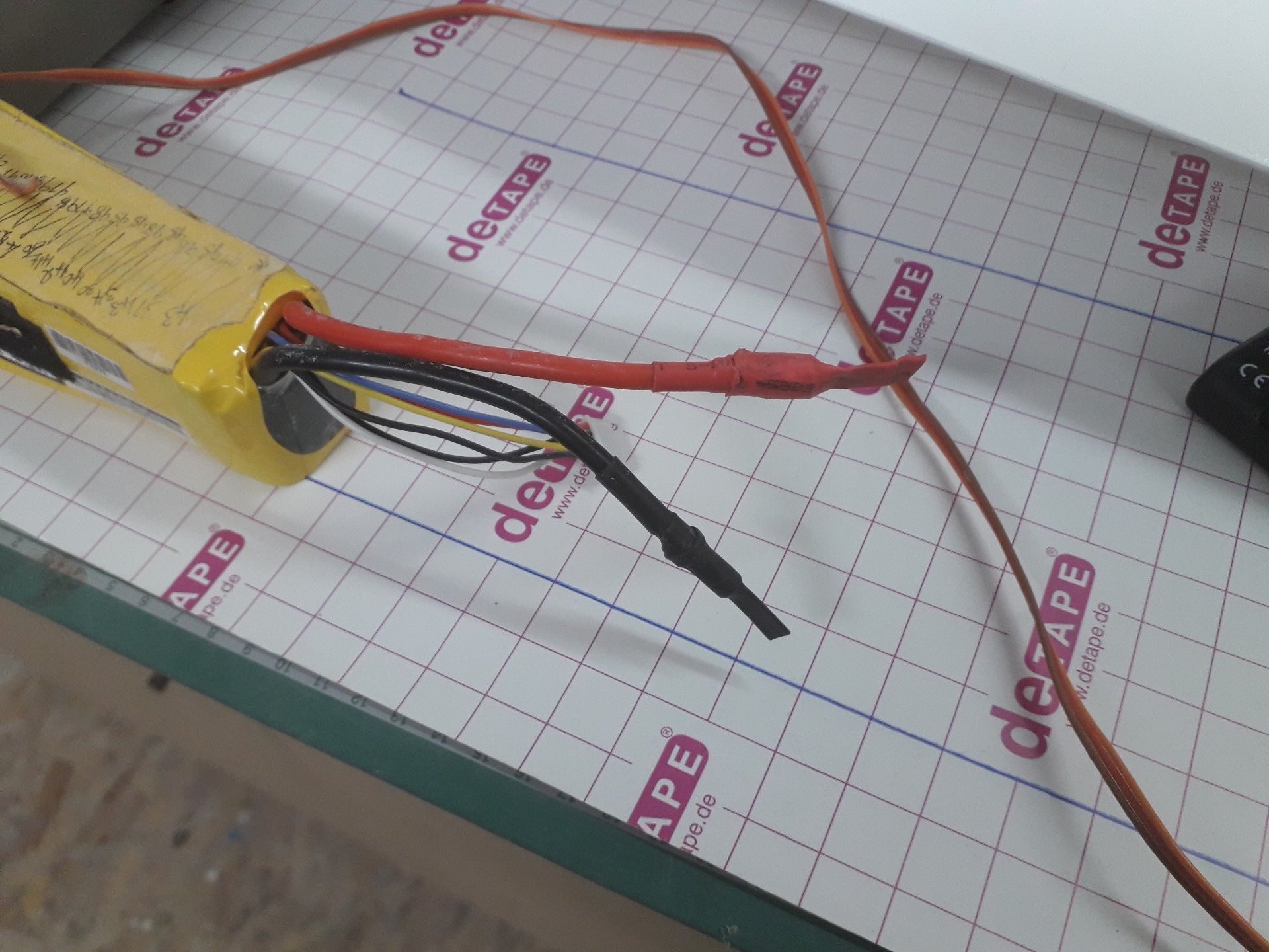

The ends of the leads were all capped off, have been since new, took the caps off to fly then on again until charging then straight back on so no way have have they ever shorted and there is a lining all around the box
:evil: [badass]
And they were never taken below 20% discharge as each flight i timed on the tx

Fine but are there any clues on the one that puffed?
Possibly a fault inside where the leads are soldered on?
