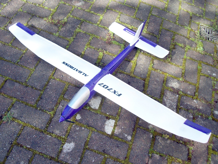

The now restored Flapped one. Pictured this morning.

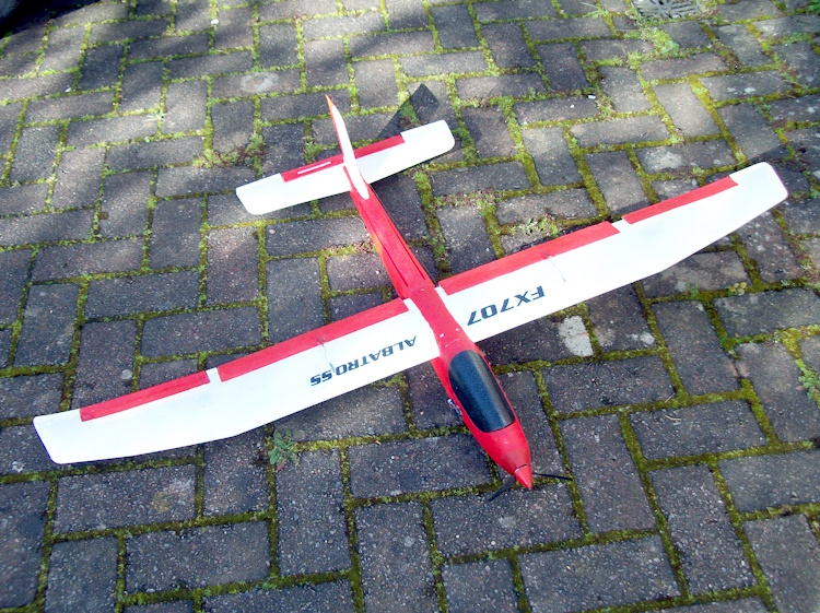

and the basic one with its 850mAh 3s moved forward 5mm. Also taken this morning.
All not entirely satisfactory.
Somewhere during the repair the flapped FX707 ended up tail heavy which after just a few seconds resulted in a rather nose down "arrival"
Some repairs required but mainly as I discovered the glue was not full hard!
I am fairly certain the CG has not moved much but it is possible that when gluing back the tail plane its incidence was changed.
The basic FX707 was rather better but it proved very hard to turn left particularly anywhere near the stall!
Nothing that a bit of wing massage did not cure for the subsequent flights.
The concerning bit is the EPO? foam of the FX707 is rather rubbery so any "massage" effect tends not to permanent.
It has rather small ailerons so its a toss up between making the ailerons longer or adding a functioning rudder.

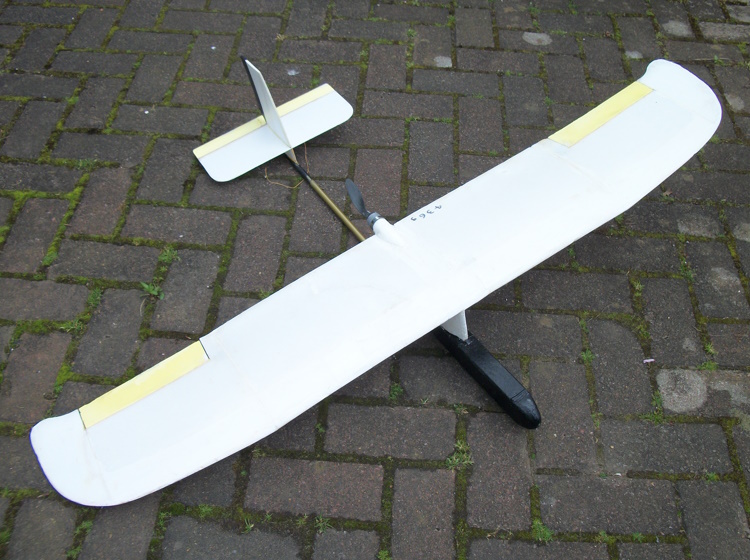

I though the wind was just about gently enough t fly the Depron Seagull after some nose repairs.
It certainly proved to be stronger than it looked at any height and as a result distinctly turbulent low down. Flew for 5 minutes
After the flight inspection showed that it was flying with the elevator at full down trim.   Which with such a short tail moment made the longitudinal stability a bit marginal particularly when being "upset" by turbulence.
After the flight inspection showed the tail plane, such as it is, had developed a noticeable twist giving the equivalent of up elevator thus explaining the significant down elevator trim required.
Easy enough to fix.

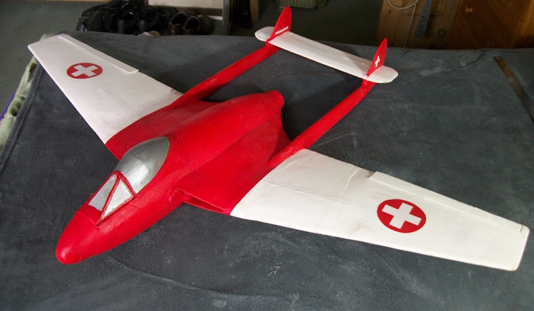

Still sunny, a bit chilly and as forecast the wing was slowly increasing so I flew the Swiss Venom
With a 1400mAh 4s  it really has a lot of power but really needs a throttle/elevator mix as there is a significant trim change with throttle. The only problem is I cant make any sense of the mix parameters on the Hobby King TX6i transmitter. The manual tells you were the various parameters are in the menu but not how they work!
Anyway had a good flight approaching 8 minutes with quite a bit of gliding in the very buoyant air.

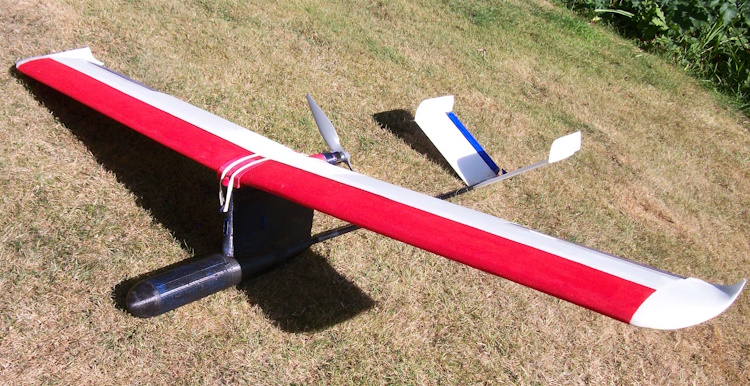

Later as the wind was increasing I had intended to fly the heavy Big Dragon 3 but I found I had charged the battery for the Endurance   so I flew that instead.
Hardly a heavy weight but had a good twenty minutes but slowly the into wind sections of the flight were getting very slow indeed compared to the down dash sections so I stopped before anything got damaged or lost.
21 Apr 2026 07:06 #9027 by Eric
When the wind speed is approaching the model's flying speed, adopt the slope-soaring technique. Imagine that you are the downwind 'back-stop' and DO NOT fly any further downwind than yourself - then if the fan stops for any reason, you are landing on the flat in front of yourself, not in a tree half a mile away!

The secret with throttle/elevator trim is that the trim that you currently have is applied at the throttle centre, so eyeball your elevator trim before applying the mix then, once you apply the mix, re-trim the elevator trim you want at zero throttle. I lost my MPX Mentor because I didn't understand this.

Then the repaired flapped F707 Albatross. That did not go too well ending with another nose plant!
Damage not too serious but it felt like control was simply lost but of course everything still worked tested well before I even got to where it had crashed.
I suspect the previous serious nose plane may have deformed the foam fuselage and reset the wing/tail incidences.
