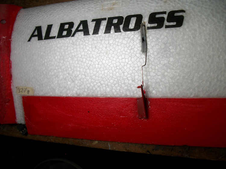

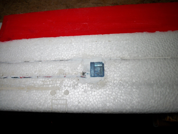

The problem with the flapped FX707 Albatross was a broken tooth but at the extreme end of the servo travel. This meant that if for any reason the servo arm travelled just a tiny bit beyond the normal "up" point the servo motor simple ran free! The motor vibration would then cause the gear to be picked up again and it would travel some way down before returning to the correct position. The rapid return movement would cause the servo to overrun to the missing tooth again and repeat! Whilst it was doing this the servo would not respond to normal inputs.
The new flap servo under & top views.
Virtually indistinguishable from the original installation  but I had forgotten how much I dislike soldering and heat shrinking those tiny 32 AWG servo wires!

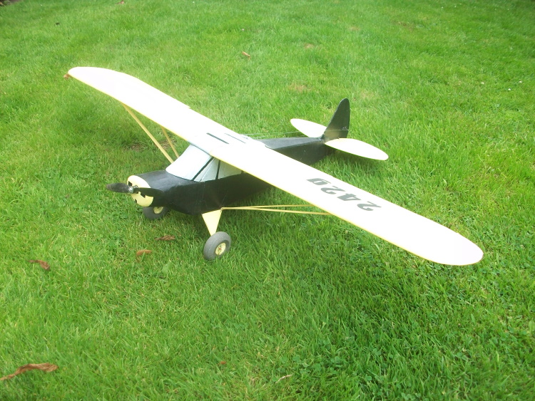

Flat calm this evening at 9pm so I took the opportunity to test fly the sub 250g Super Cub after some significant repairs - fuse split & left wing off. As the sub 250g category is no more I added my OP number to it to comply with the CAA regs.
10 minute 40 second "cruising" flight. Its1000mAh 2s was still showing 4V/cell at the end. Unusually for me it included a takeoff as the field had been cut but more rough gang mowed with a tractor by the council. It still nosed over on landing despite its "Alaska" wheels!

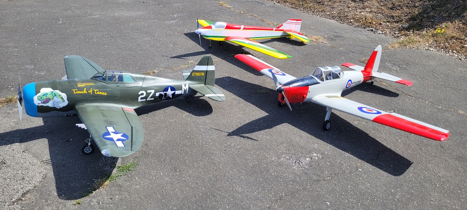

Had a great days flying. Re-maidened the Seagull Meister kit P47 Thunderbolt after some changes - 6S to 8S and new motor. Chipmunk was nice and steady as always and my new build 2nd Curare (which is why i've not done any building on the Firefly!!) flies better than #1 Curare. 3 flights on each.

They all look nice models Ralph
