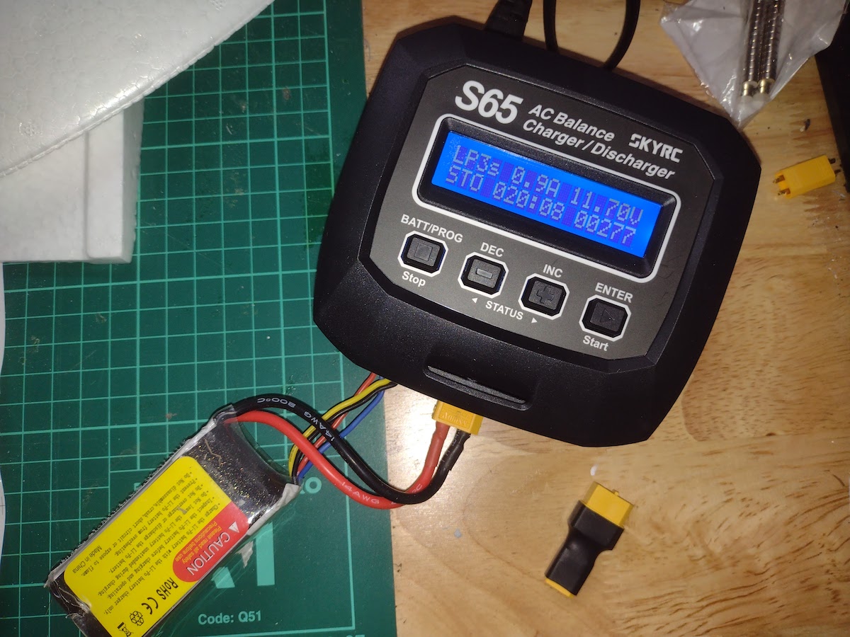

17 Jun 2025 08:36 #43 by jon.in.swansea
Replied by jon.in.swansea on topic Free LiPos
I finally got around to improving the safety of my battery collection by getting a newer balance charger which also does a controlled discharge (rather better than guessing about a 10W bulb to draw it down and way less risk) It also has 'storage' and 'discharge' functions.
Granted it took a couple of YouTube searches to get it working as it kept saying there was a 'cell error'.  Ah, there was a mode of quick-clicking on the buttons which allowed you set the number of cells before the long-press to start the charging.  3rd reading of the manual got me there...
Anyway I balanced charged and then set to 'storage'  the various batteries I had.
Thanks: Klipkopwildlife, Flytilbroke, Quorneng, THE BLACKBIRD
17 Jun 2025 16:58 #44 by Quorneng
Replied by Quorneng on topic Free LiPos
jon
You probably know but if you press the INC button once whilst it is charging or discharging it will display the individual cell voltages.
This can be useful if when you start a charge it shows one cell voltage is well below the others. The charger will ensure that all brought up to the same voltage BUT it is worth noting as it could indicate a weak cell. It could mean that battery is "on the way out" or at the least should not be worked hard so risking over discharging the weak cell.
