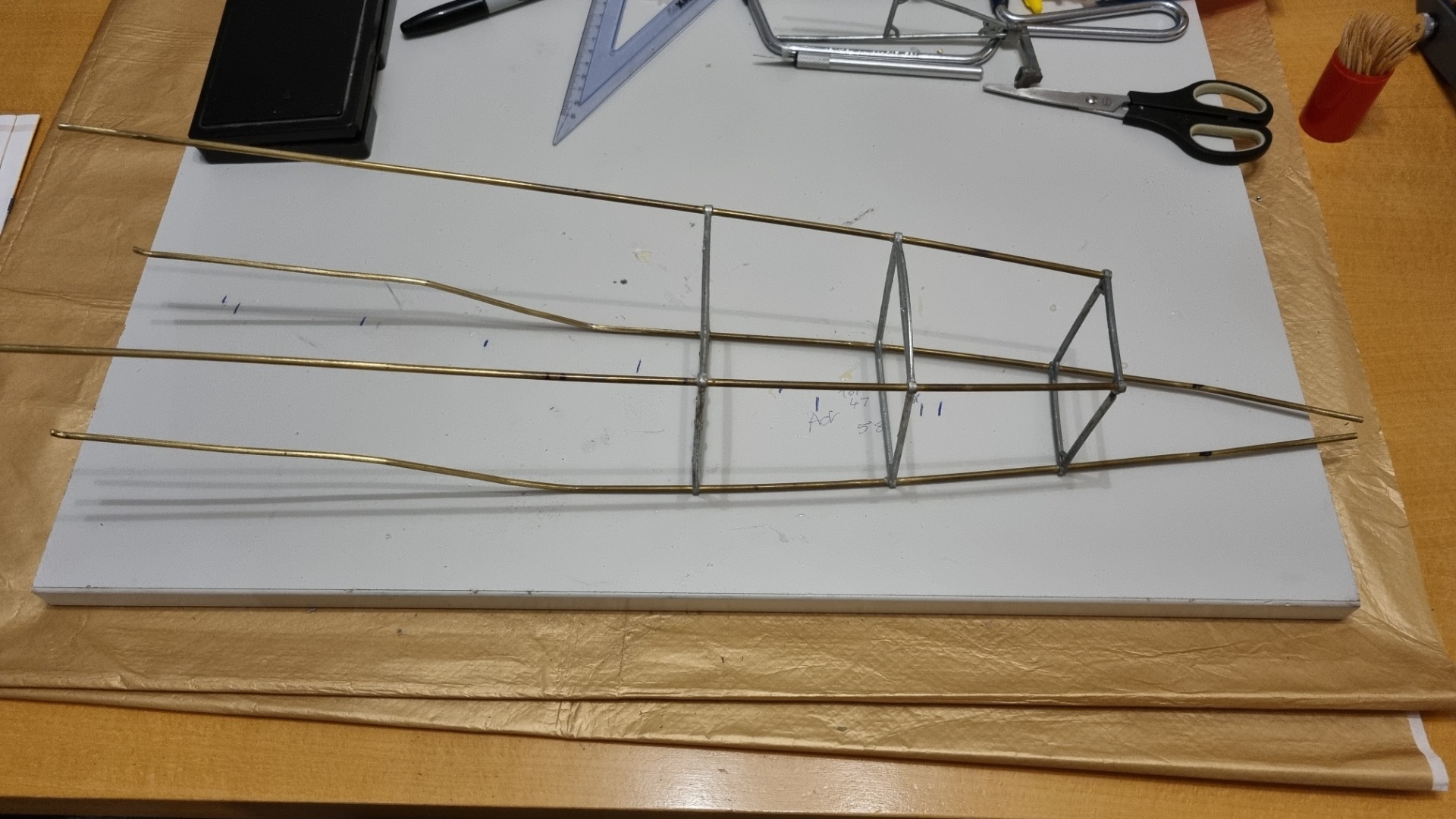

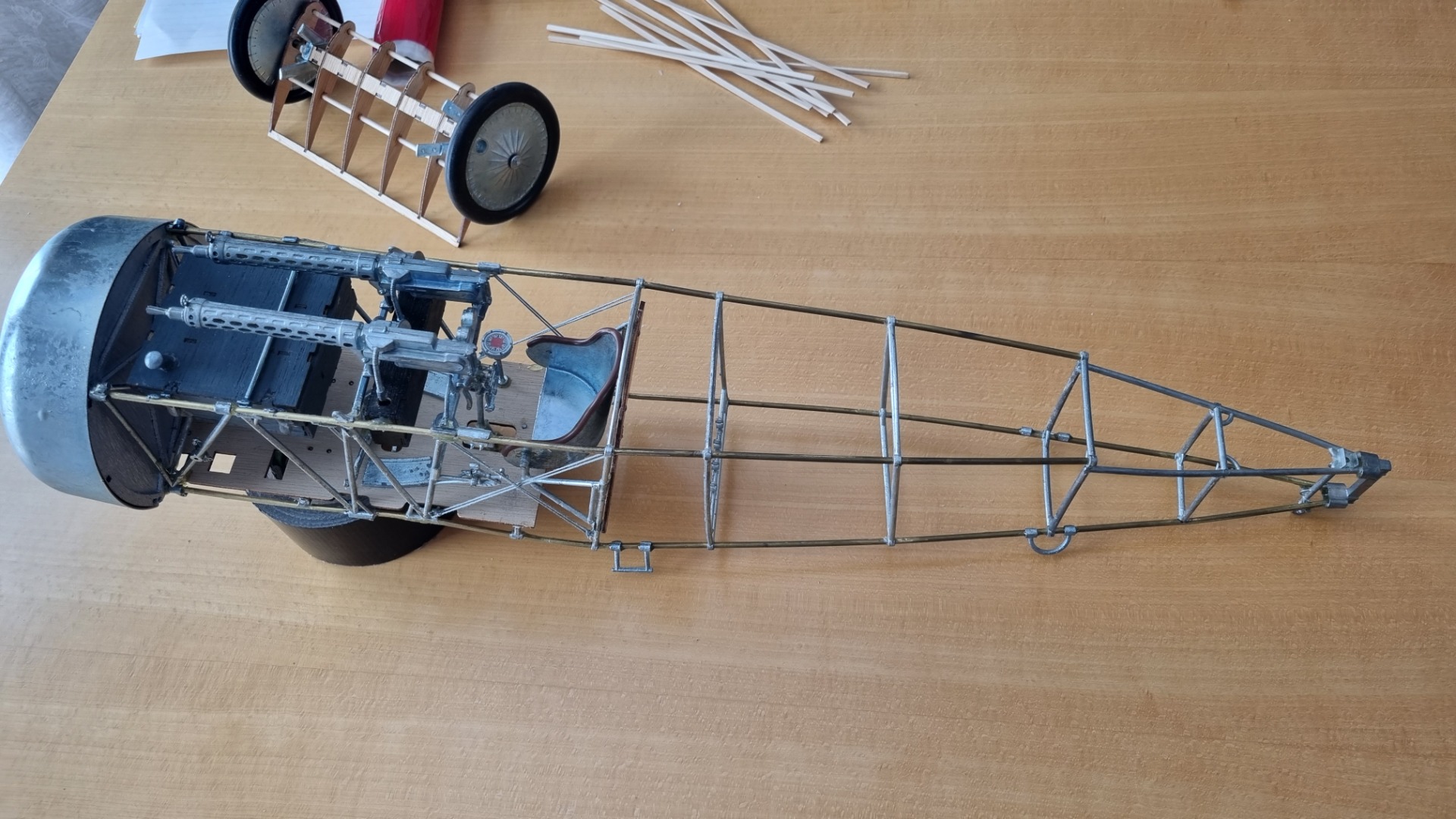

 Hi All, I am in the middle of building a model and need some advice with covering.  I apologise for the fairly lengthy post.  I agreed to finish a model for a lady whose son died before he was able to complete it.  It is a Hachette Red Baron (1/8th scale tri-plane).  It is one of those where the parts are collected with weekly magazines (100 in this case) and is around 20 years old.  It is a bit of a hybrid, in that the wings are normal construction of wooden ribs and spars, but the fuselage is made out of brass rods and cast metal parts.  He had started it but but not got very far and it has suffered over the years with many parts broken which I have repaired and I am nearing the point where I need to cover it.  The covering supplied with the kit is some kind of iron on vinyl, not sure what make as it is not marked.  The bulk of the covering is obviously red, and this has a peal off film covering the adhesive side and when I apply heat, it does adhere to the wooden ribs, but the adhesive appears weak.  I am not sure how well it will adhere to the metal.  The tail/rudder is white and has a small square of covering provided, this however, does not have a peal off film and shows no signs of having any adhesive on it, although the instruction clearly state it is iron on.
So to my question, can I use some kind adhesive with the film, if so what.  My main concern is the white film as this will not adhere without some adhesive, but I am also concerned about how well the red film with adhere to the metal frame.

Welcome to the group, Alan.
First off, I have yet to see any of these magazine 'kits' fly, so I would build it as a looking-at display model, not a flyable one.
As the covering material is 20 years old, it is likely that the - probably inexpensive - heat-activated adhesive has 'died' of old age.
Is there any indication of what it is/was, a brand name, or anything, either on the covering, or in the instructions? There are many on the market, all requiring different treatment.
Bonding it to the metal tubes - you will be very lucky! You would need to thoroughly degrease and clean the metal parts first, possibly with IPA or similar solvents. Any preserving oil or oxides on the surface will weaken the bond!
To get heat-shrink covering to adhere to such a small surface area would be difficult enough for an expert.
What are you using to bond the covering with? (a domestic clothes iron, a hair-dryer, etc?) The temperature is important.
As you are aware, metal is a good heat conductor, so to get the metal hot enough for the covering to bond to it will be a fine art, a shade too cool and it won't stick, a shade too hot, and the film will literally vanish into a molten hole!
Do you have any model-flying skills, yourself? If not, then that is another reason to have this as a display model only, or it will not last very long.
Weight and balance is critical - and with a very short-nosed WW1 aircraft - which was not easy to fly in the first place - getting enough weight forwards - (without adding any!) -  and keeping the back end light, is a common problem. Being partly metal, it will be heavy enough as it is!
If you think of the full-size one, it had a huge iron lump on the front, and the rest of it was air-space held in shape by tiny tubes and sticks.
In the full-size world, covering fabric is stitched onto the airframe, but to do that in model size would be almost impossible.
Whereabouts in the country are you? Don't give away your street name, just the area - and I would advise you to try to find a local to you model flying club, where hopefully someone can give you hands-on guidance and assistance. Have a look on this site - bmfa.justgo.com/clubFinder.html - to see if there is one near you. You can zoom in to your locality.
Please let us know how you get on with it!

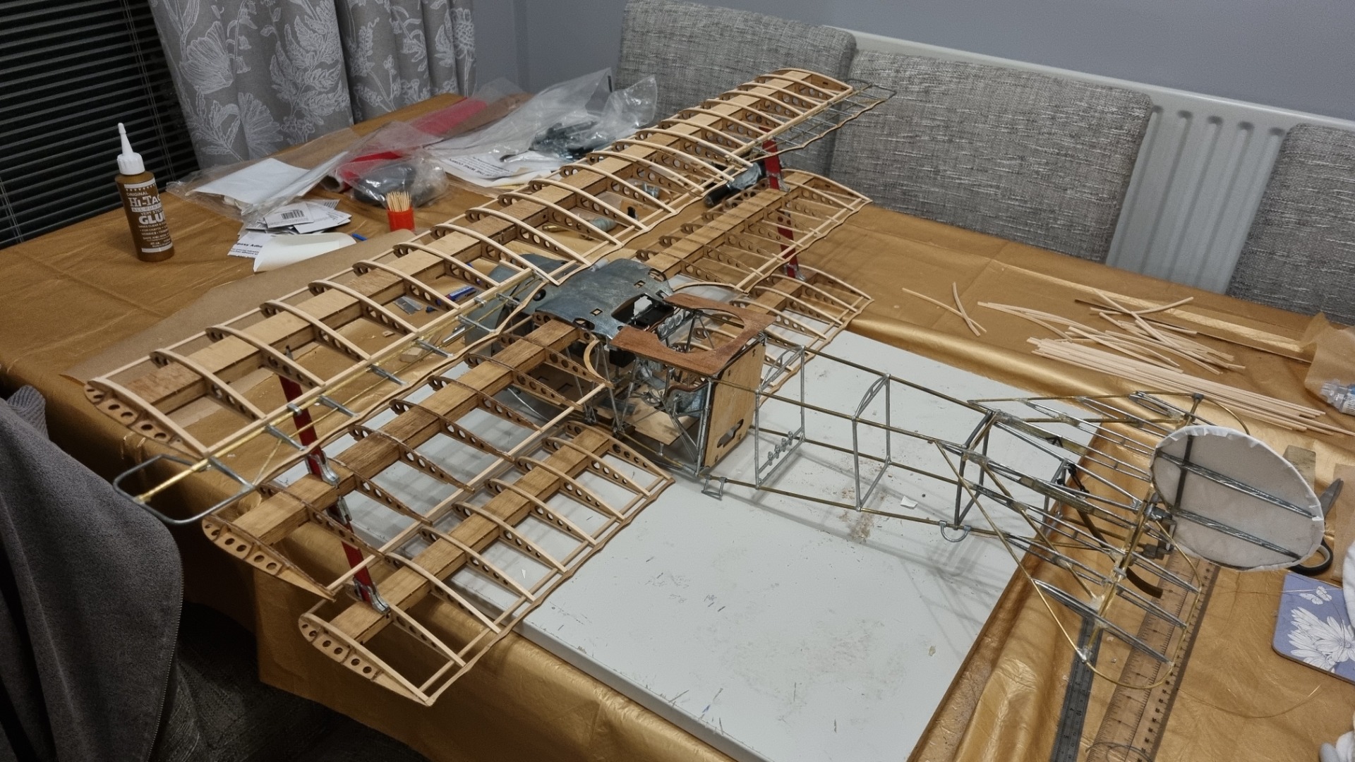

23 Oct 2023 19:56 #7 by Alan
Replied by Alan on topic Help with film covering

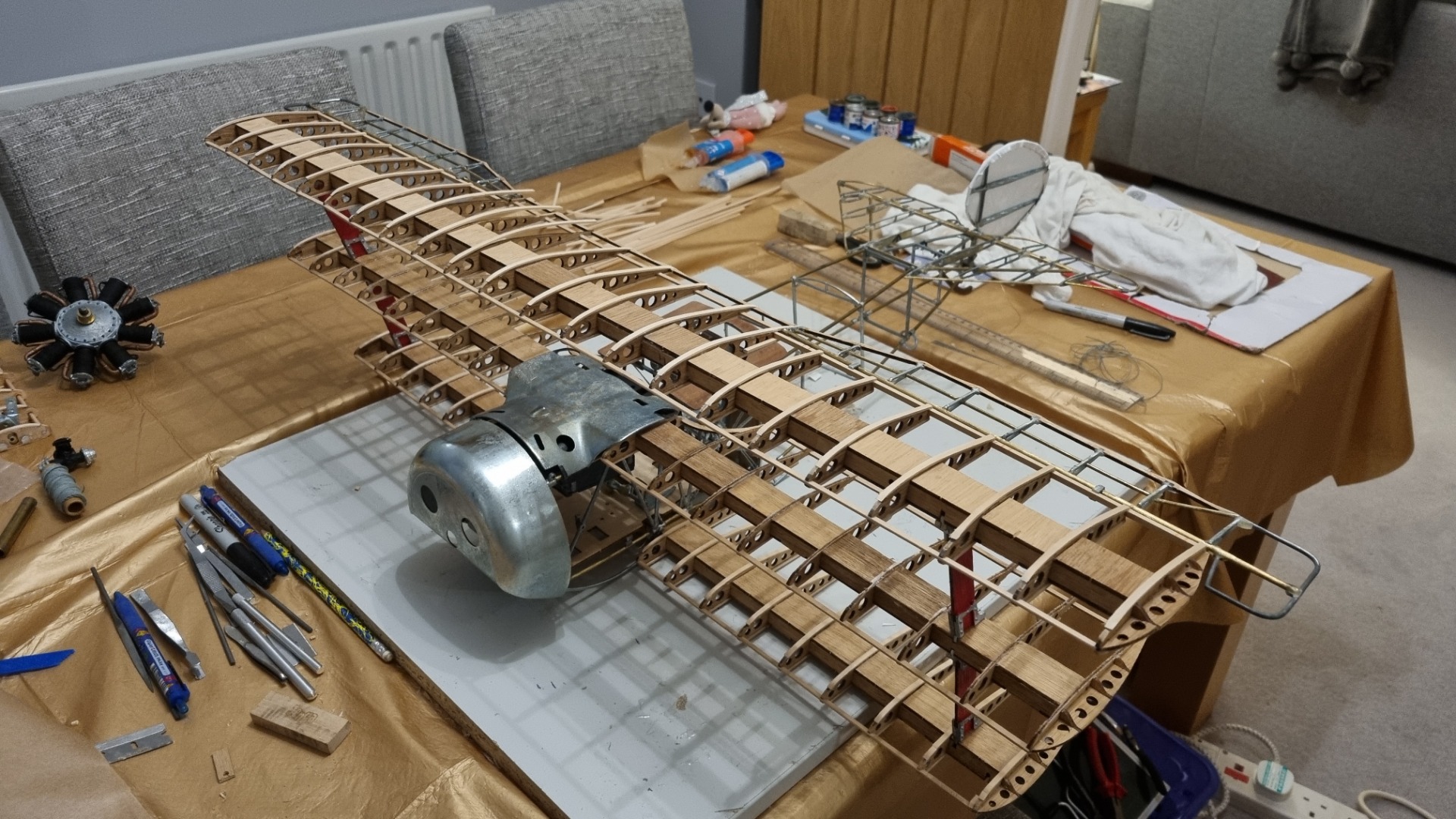

All three wings were already built to a reasonable standard, but unfortunately they misunderstood how the trailing edge was to be fitted and simply glued it to the top of the ribs. I have had to remove the capping from the top of all the ribs and extend the bottom capping. I have therefore bought two copies of the issues that had the wood needed for this, there was also 2 copies of issue 64 and no issue 65, and the spinner was also missing so I have bought these two issues as well. As you say, there are lots of copies still available and I picked these up for £1.50 each. Apart from that, the fuselage was started but something went wrong with their measurements and the it was all out of square with the box sections at various angles. It had also suffered some damage in storage. I have managed to deconstruct the ailerons, tailplane, elevators and rudder and rebuilt them, but again, quite a bit of damage which I have had to repair. This does mean that the airframe has to be covered as it is not pretty with the misplaced parts and repaired damage. I think it will look OK covered and I will post more photos as I go.
31 Oct 2023 13:57 #8 by Alan

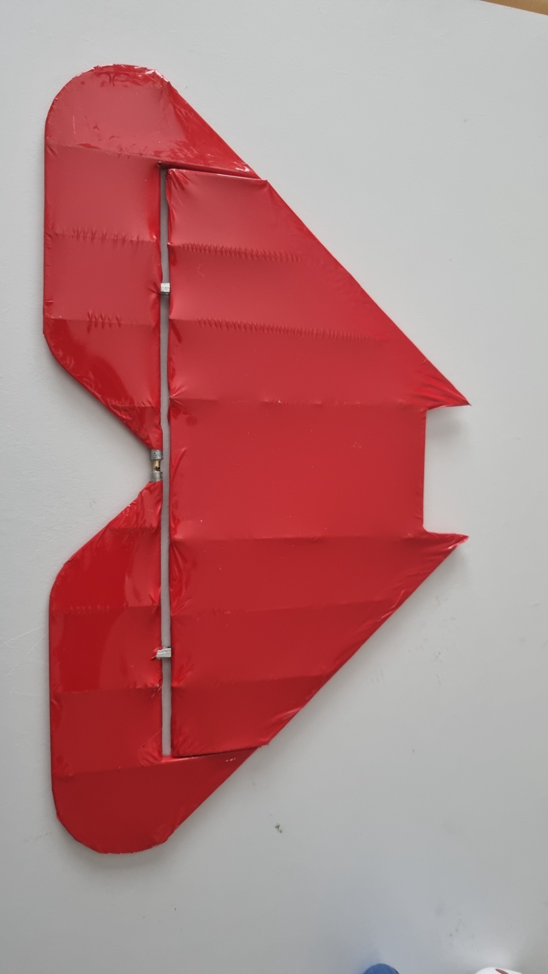

  Well the build is progressing and it is mostly completed and ready for covering. Never having used iron-on film before it is a big learning curve so it's not the neatest job but could be worse.
31 Oct 2023 17:48 - 31 Oct 2023 17:53 #9 by Eric
Replied by Eric on topic Help with film covering
Start on the underside.
The trick is to tack one long edge down first, then gently pull the film tight, to remove any wrinkles, then tack the other edge down.
THEN you can tack one side down, and tease out any remaining wrinkles, tacking that down while you hold it taut with your third or fourth hand!
When all the edges are fixed, tack on the upperside (where you have wrapped the edges round and over.
When the film is firmly attached all the way around - THEN shrink the middle, careful not to heat up the edges again, or get it too hot, or you'll get an instant hole!
THEN you can do the same again, with the top side, doing it this way round means that the wrapped edge is underneath, more or less out of sight.
Radius's are tricky! You have to get a straight edge fixed, somehow, then tack the very edge around the curved surface - but do NOT tack it underneath yet.
When you have the film under control, cut slits in it right up to the curved edge, on the scrap side, then starting at the trailing edge, tack one of the 'triangles' down on the other side, trim almost all the surplus off, then do  the next so it just overlaps, and tack that, - - work all the way around the curve.
It takes patience, determination, and practice!
If the film colour gets noticeably darker as you are doing it, you are on the verge of melting a hole. Either you are keeping the iron on the area too long, or it is too hot - which really amounts to the same thing!

You mentioned that you had to reposition the trailing edge pieces as they had been glued to the top surface of the ribs. On the original the trailing edge was actually a wire which sagged under the tension of the shrinking dope giving the characteristic scalloped effect.
Just a point of detail but the trailing edge of the aileron lined up with the trailing edge of the centre section.
In the photo it looks like you lined it up with the centre section rear spar.

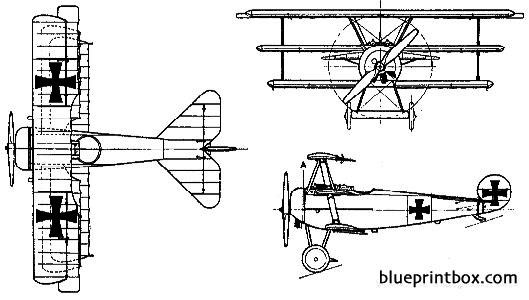

This is a period (1917) photo of the Triplane prototype before Fokker extended the middle wing a bit and added broad interplane struts to counter wing flutter.
It also shows how translucent the plain doped fabric was before the coloured dope was added.

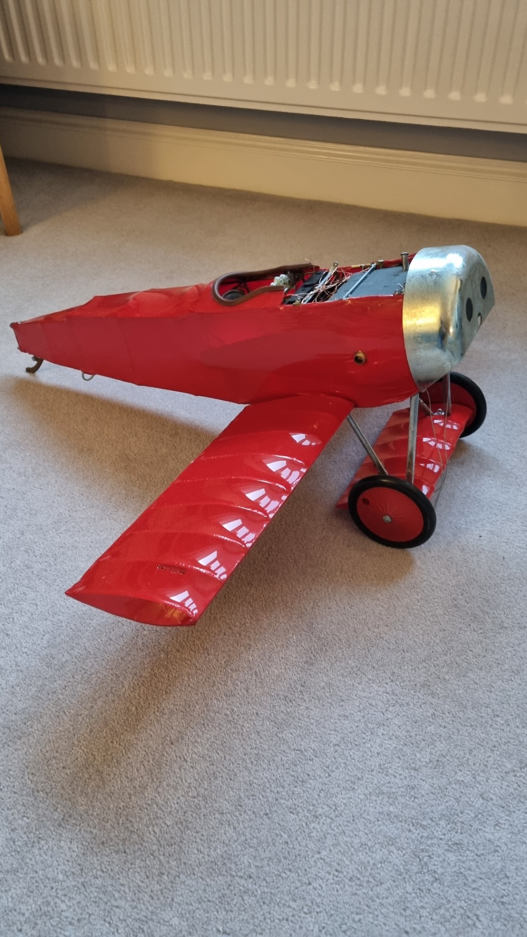

04 Nov 2023 15:43 #12 by Alan

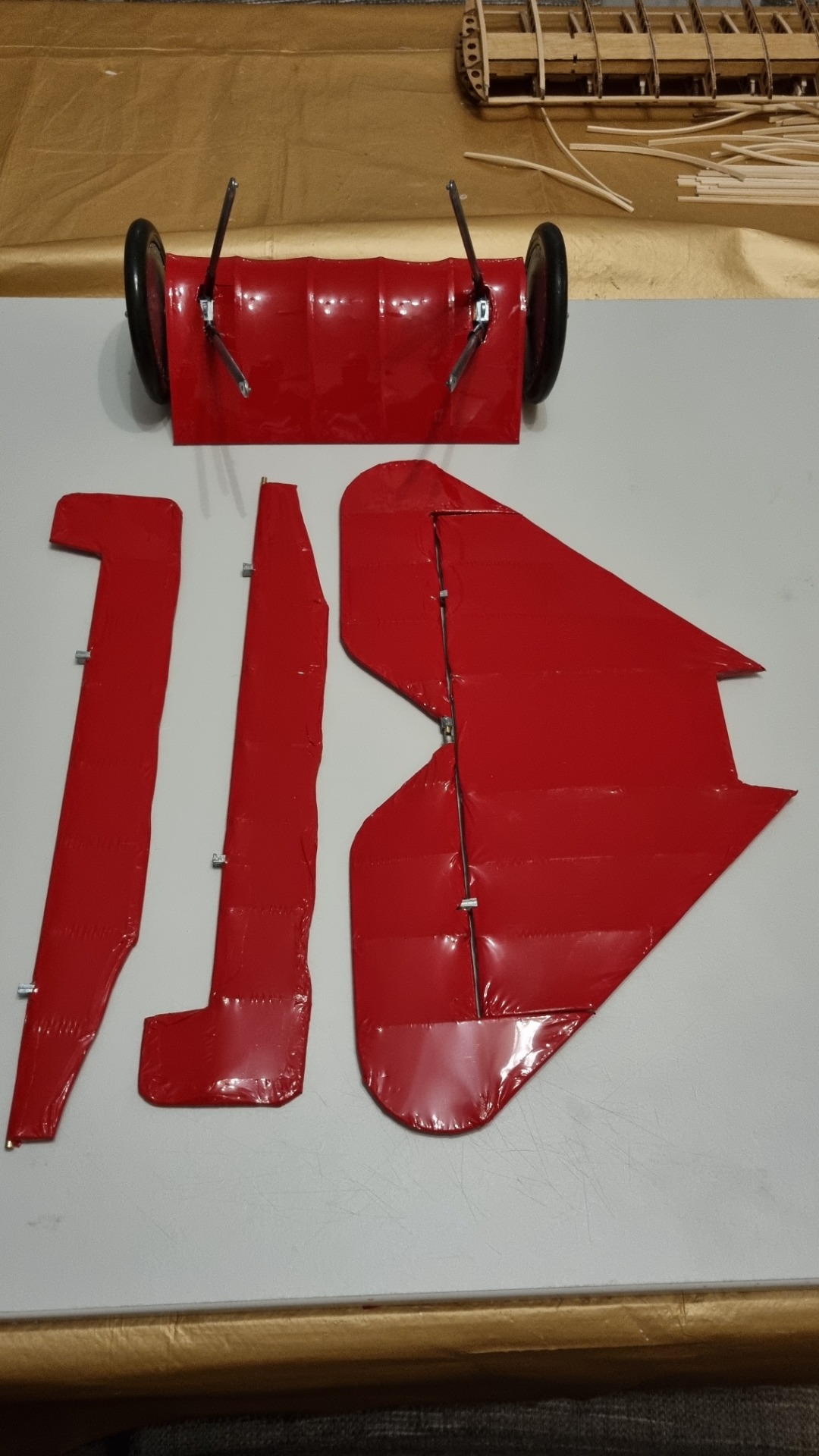

I have tried using Hi-Tack PVA but the results were terrible. I have covered the airframe using the red film and it works fine, I will see if someone can let me have a couple of 6" squares of white film, it will be far easier than trying to make the supplied film work.

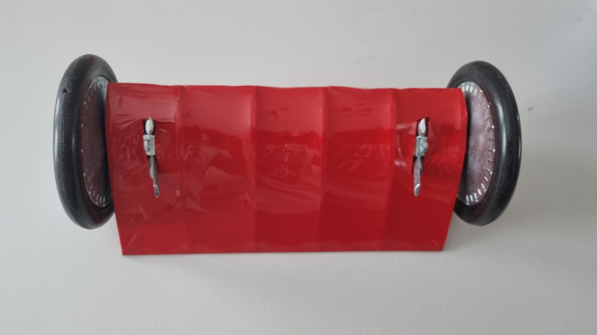

04 Nov 2023 16:39 #14 by Alan
Made some good progress this week.  Covering is going well, probably not up to the standard of modellers on here but I am generally quite pleased with it
04 Nov 2023 20:12 #15 by Quorneng
Replied by Quorneng on topic Help with film covering
That looks very nice and neat.
Probably a bit too glossy for scale but spectacular nonetheless.
The depression of the film between the ribs, particularly over the initial third gives a significant change to the wing section. You can see why Fokker used a rather unusual shaped ply leading edge skin fixed to the top of the spar in an effort to maintain the wing section when the dope covering shrunk.
Keep going.
