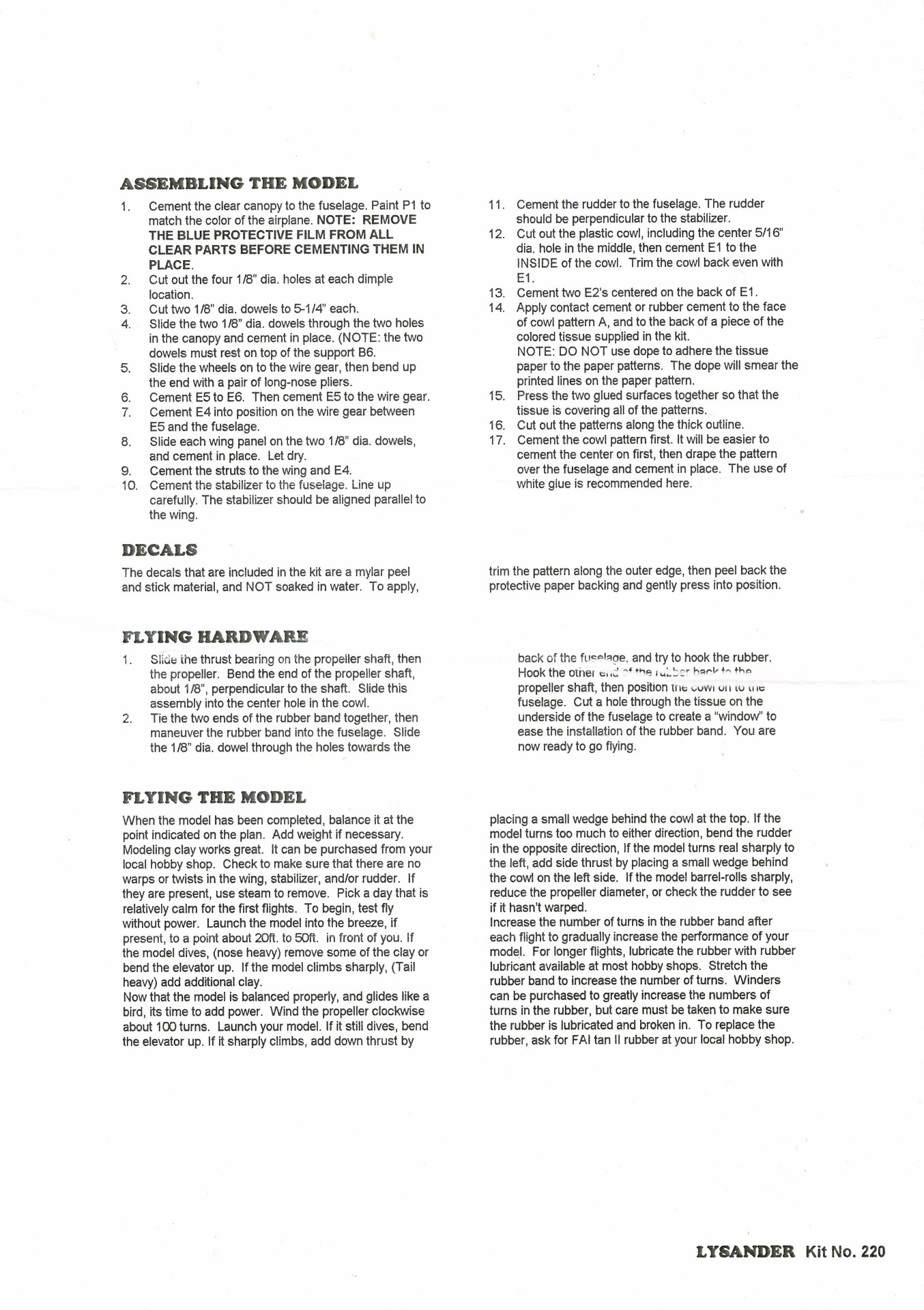

The instructions for the canopy.
Last edit: 13 Nov 2024 15:10 by Magpie.

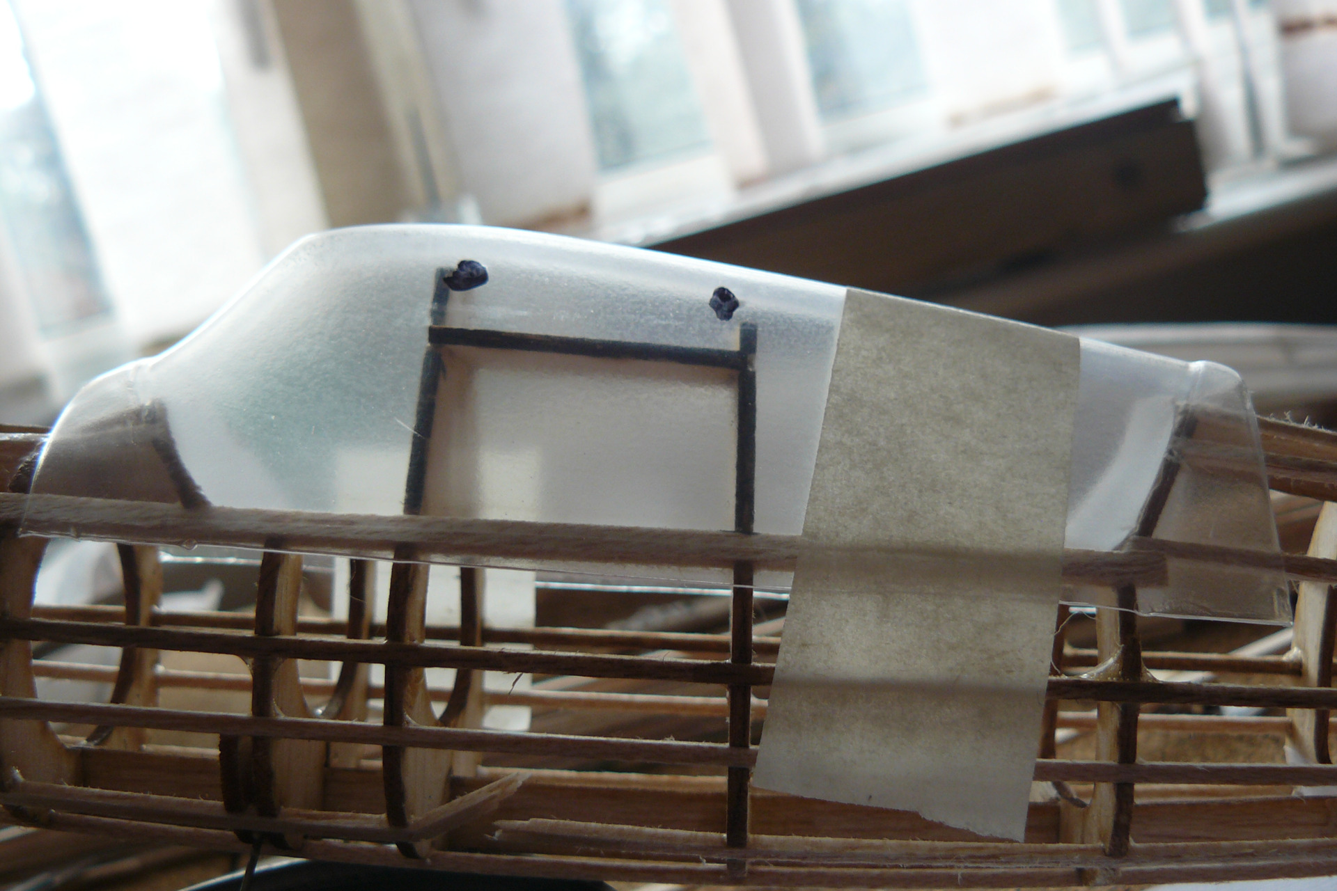

The canopy with two lines drawn on the potential cut lines with a piece of balsa showing how I think the canopy overlaps the stringer.
So that makes the lower black line the cut-line for the sides, then at the front & back initialy I will extend this right round the canopy. Then by trial fitting work out how much to cut back to give some overlap on the frame.

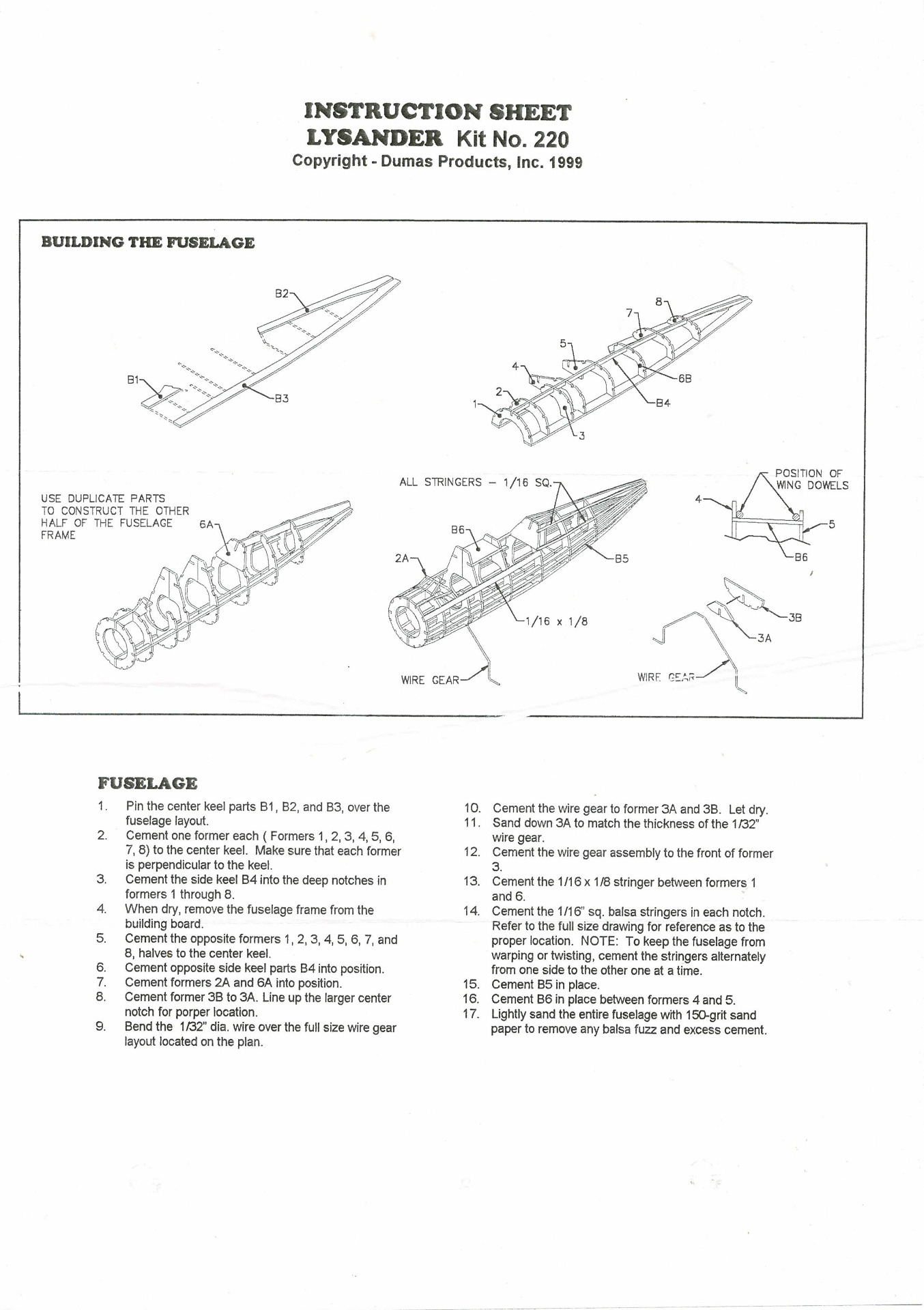

this instruction sheet shows the wing dowels
Last edit: 13 Nov 2024 15:31 by Magpie.

By the way there are no securing bands - the wings are fixed.

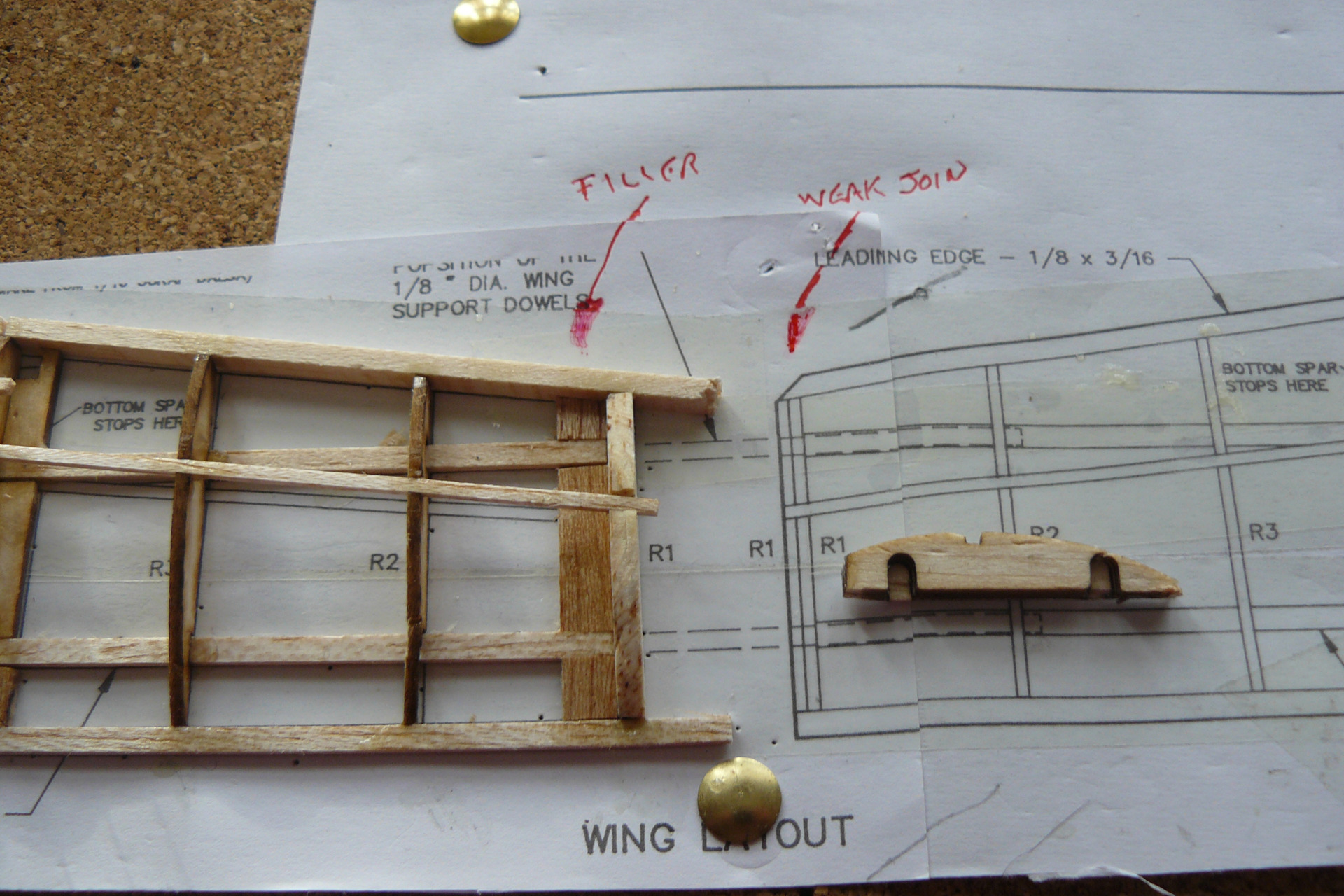

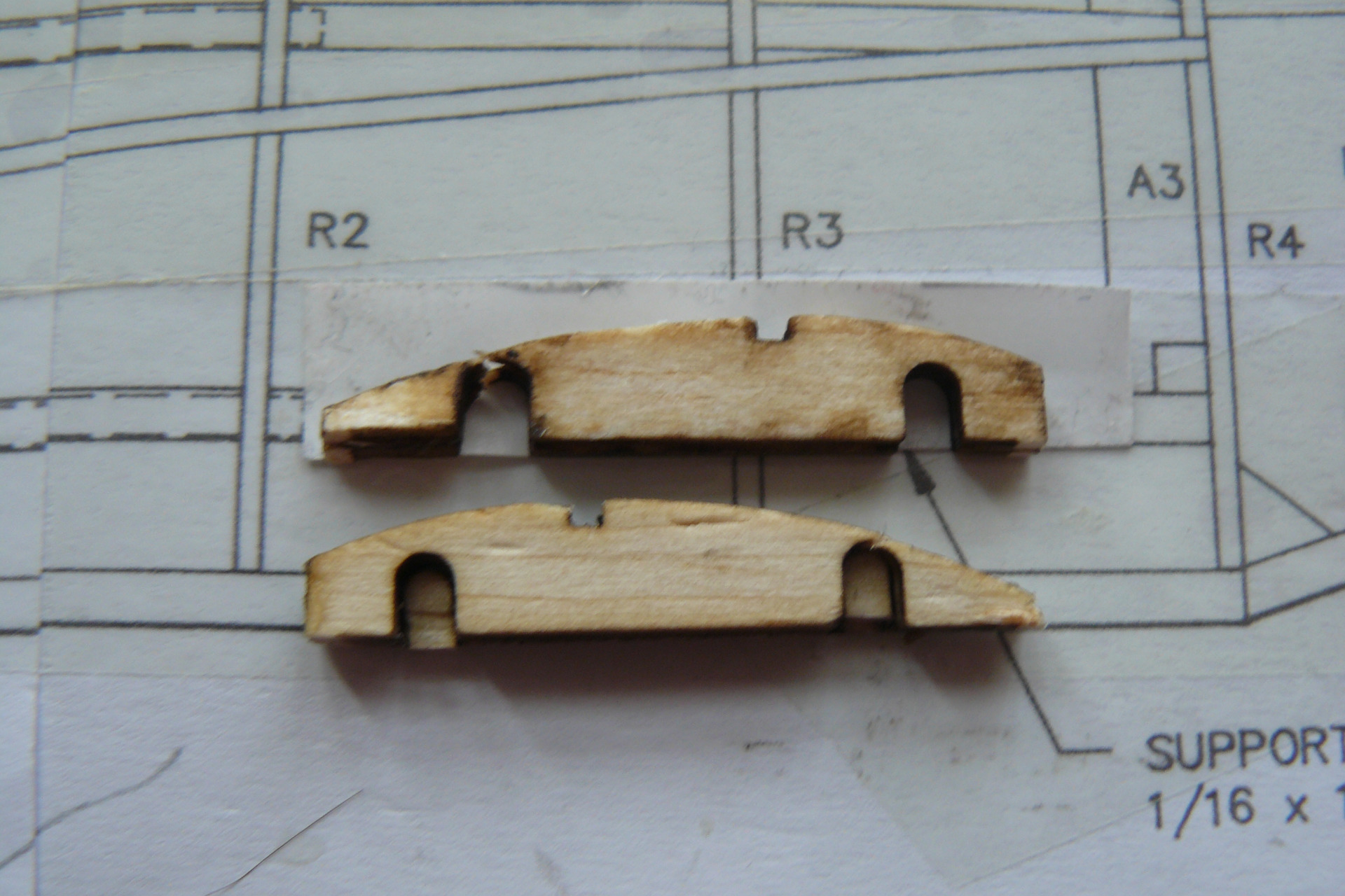

The cut-outs for the dowels on the first wing rib are far too close to the top edge & as soon as they are released from the balsa sheet they just snap. I've used some sticky tape on the back to try to hold them together but they still have no strength & would never support the dowels.
So I've cut new ones out of 1/8th balsa & added a filler to support them.
The top inside corner join would also be too weak.

I've inked the edges of the formers & dotted the dimples which are supposed to mark the positions of the dowels through the canopy.
Once I've got the wings built I'll work out the best way to mount them. I don't think the formers have enough strength either. When the fuselage is covered this will give it more strength & maybe I can glue doublers & the combination of canopy & formers will be enough.
I'll probably fix the wings to the canopy then drop the assemply onto the gluedformers.
