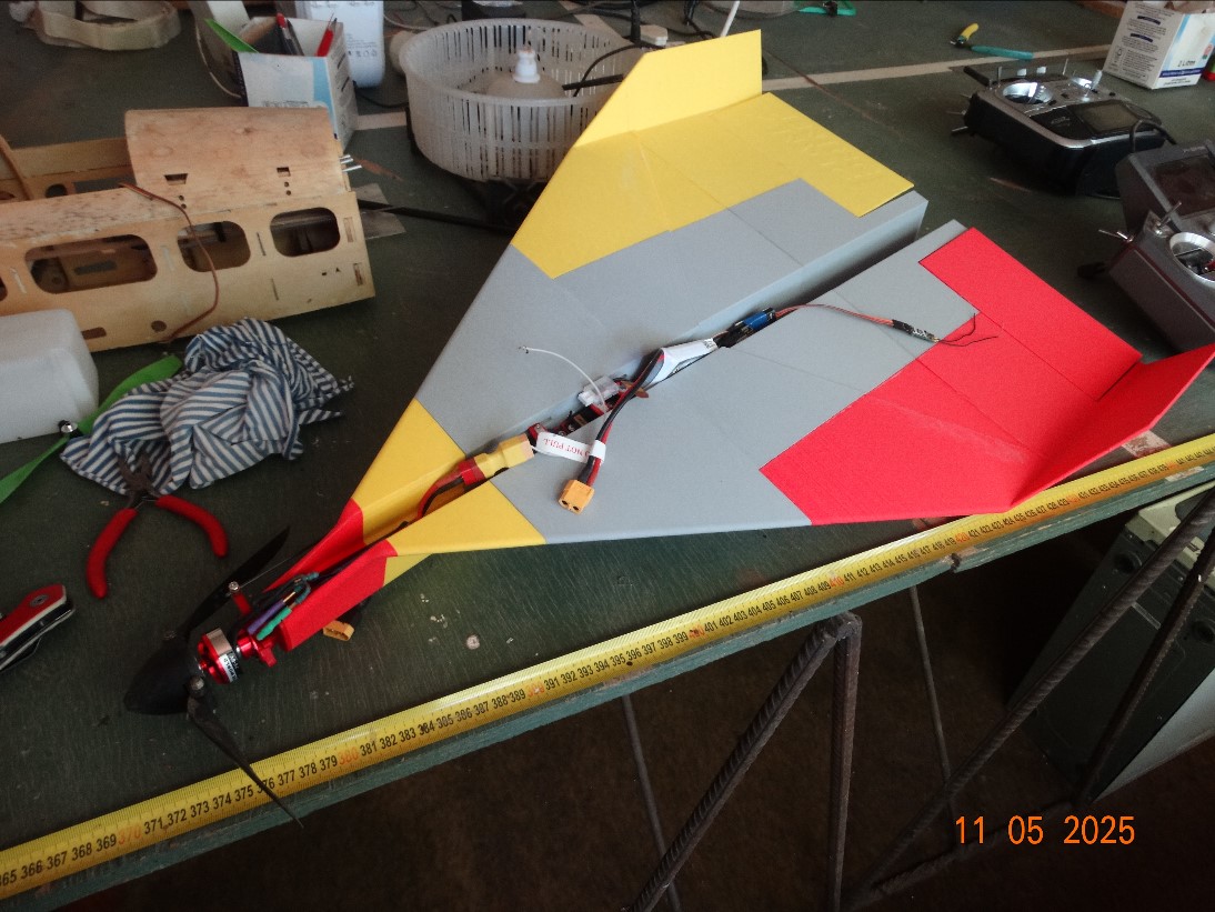

18 May 2025 17:33 #41 by Klipkopwildlife
This is my PP, I decided to use a 9x6 folding prop but with the nuts wound up quite tight so they won't fold in flight but will fold on landing if necessary. 411gm and 115watts on a 2S hopefully that should give me enough grunt.
Thanks: Eric, Flytilbroke, Quorneng, jon.in.swansea
  • jon.in.swansea
19 May 2025 06:59 #42 by jon.in.swansea
Such a colourful beastie.
And something I didn't mention in my build process - I found that the elevons didn't have much clearance and with just a bit of flex in the wing they would bind.  I took a file to the left and right edges of these control surfaces and tried to get a 2mm gap. I also taped across the aft 'V' to limit the flex in the fuse.
I assume that if M was launching there would be no video - that was so valuable in trying to figure out what was happening in the model....
