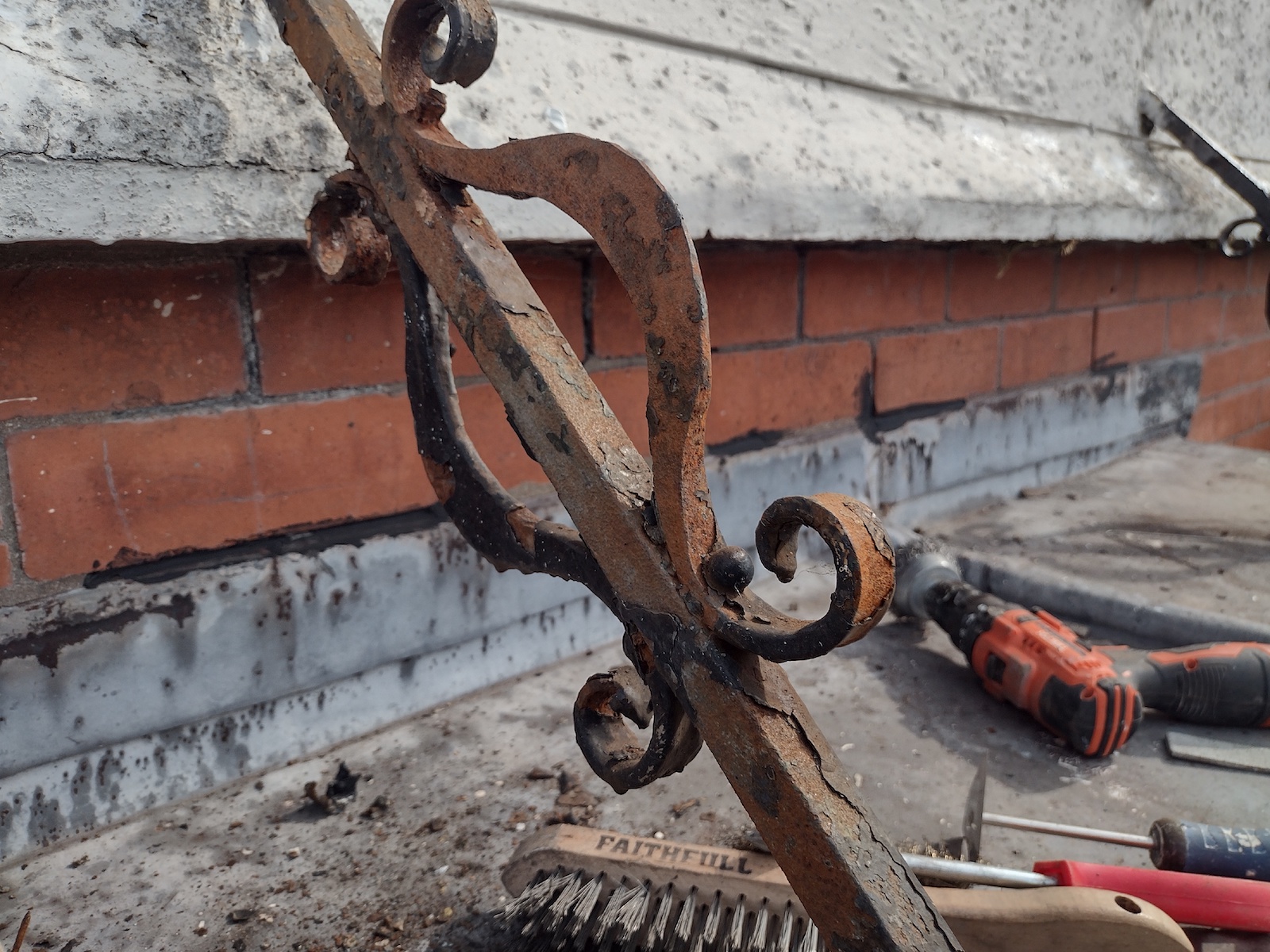

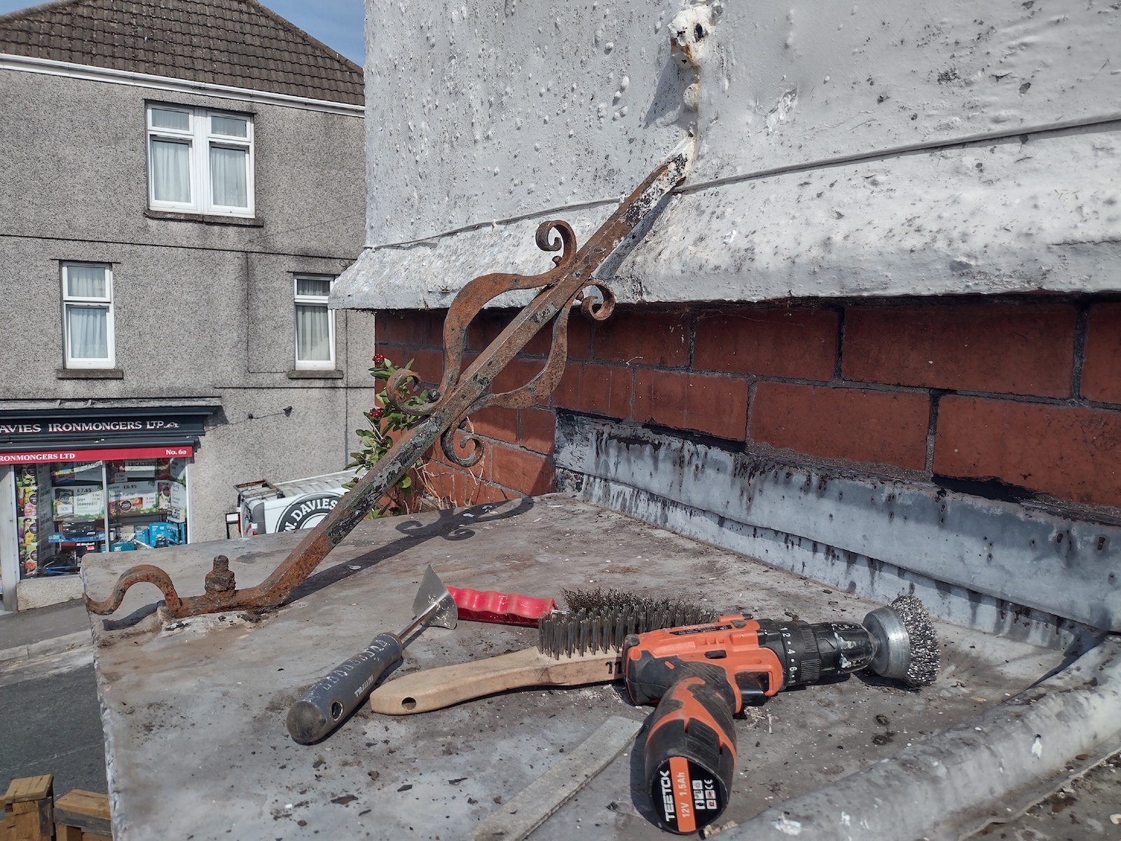

Another Day Job - the entry door projection has iron work from 1916 that was well-rusted. Some of the wood was rotten and needed painting and the flashing had gaps at the brick which seemed suspiciously associated with damp above the door on the inside.So off to the local wood merchant for some trim and then across the street to the best little hardware shop for miles to ask about how to deal with a century of accumulated rust (see image below).  They suggested getting as much of the old cruft off and then painting it with Hammerite KURUST.  So wire brush work finished I put on the KURUST and it duly changed colour to a blue-black, left it for 3 hours and then did a coat of Hammerite black.  Replaced quite a bit of the rotted wood, primed and painted (goodness the cost of oil based paint these days). And the finished entry is a lot better than it was.  We shall see if the flashing correction stands up to the next rains (an increasingly rare thing in Wales these days).
