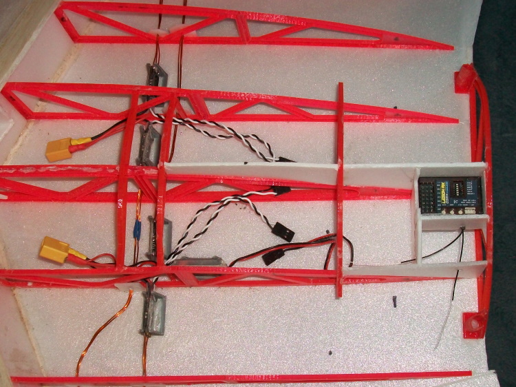

Some actual progress on the Antonov

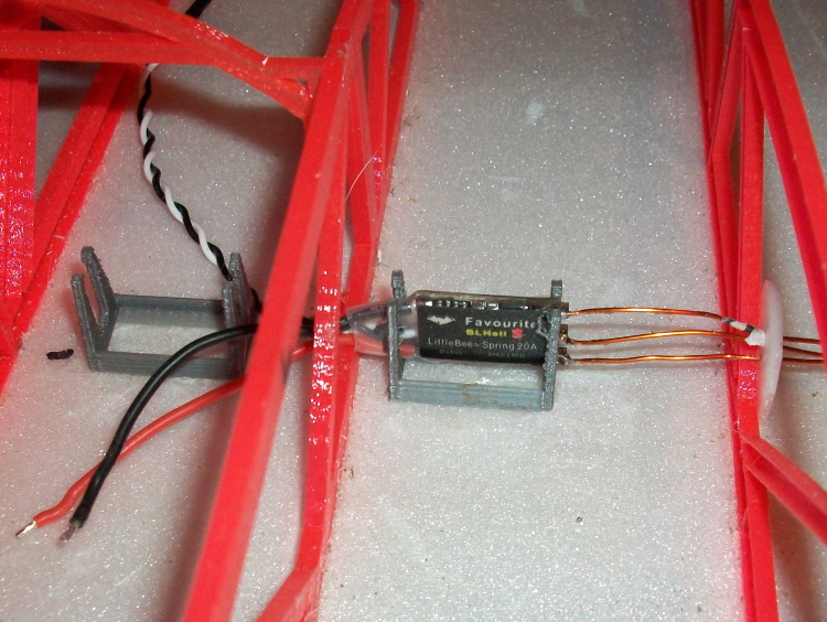

Positioning and starting to wire up the ESCs
Those on the left are for the outboard pair and will connect to the LH battery and vice versa.
Each ESC is held in its own 3D printed mount.
As these are OPTO escs (no BEC) there will be a stand alone UBEC as well.
It may be wise to connect the UBEC to both batteries but through diodes so 'in extremis' it can be powered by either battery on its own.
The final problem is the balance of both the replacement CW motors is actually worse than the one I manually balanced. Doh!
So now I have to think (but very slowly!) about what to do with 4 more drone motors! :woohoo:

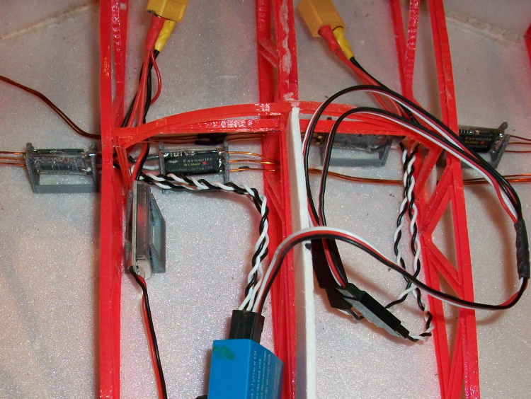

All four ESCs and the UBEC installed and wired up.
Rather than change to my preferred Deans I decided to use XT60 connectors as they were already on the Hobbyking batteries.
A very short video of the first 4 motor run up using the 4s batteries.
I make no apologies for the nervous look. A sudden failure that cut full power from any motor would almost certainly wreck the nacelle.
It makes quite a noise and pulls hard too.
