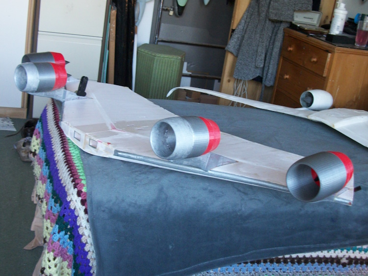

Over the last 4 years unflown my AN124 has acquired some "hanger" damage mainly to the inboard nacelles so I thought it was about time I repaired them.
This is what an undamaged full nacelle looks like.
It is all single wall PLA with a limited infill so it rather easy to damage almost simply by touching it!
And this is what one of the inboard nacelles looks like after the damaged area has been cut away.
The front 46mm will have to be reprinted and glued on.
As a test I will print the new bit in single wall LW-PLA. Although not as strong as PLA the single LW wall is 0.8 mm thick rather than 0.4 and has better filament adhesion so is less less likely to split.
The first LW-PLA nacelle repair.
It certainly feels stiffer.
This is picture shows just how large it is compared to my Clio Estate!
With the removable nose detached it does just fit in with the front passenger seat back as low as possible and the rear seats folded down..
There is just about room for the 3 pieces of the wing too.

The repairs to the rinboard nacelles of the Antonov are complete and painted.
During the repairs it was obvious that the inboard nacelle pylons were also damaged and as a result one had become misaligned. That required some careful glueing and be held in place until the glue became fully hard.
If I ever built another I am pretty sure I could create better strength and stiffness for the weight involved but when constructed nearly 7 years ago it was by far my largest, heaviest & most powerful Depron plane and it still is!
