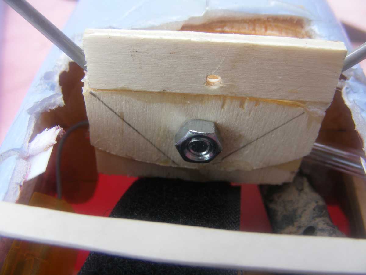

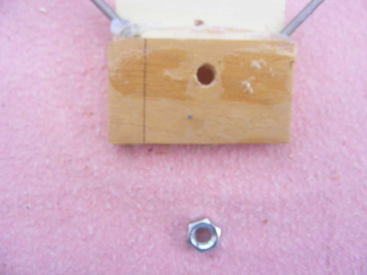

As previously reported, the first landing following the first flight of the Raven saw the F2 shatter, and the wheels fall off!
So - mod number one - make a new former, and stick it in the fuz. - with two differences - one, I used real wood, not spit and cardboard, and two, there's a big bolt in it!
The bolt is a pivot. Next in line is a school eraser. (I won't put rubber, because our American readers think it's a rude word!) Then a ply plate with the wire undercart attached, and finally a nut. (No, I won't fit inside!)
This is the Issigonis hint I referred to in the 'Been Flying' thread. Alec Issigonis used rubber blocks in compression for suspension of his mk 1 Austin mini car.
So, I've done the same thing, rotated 90' to fit, and the mod has survived four landings since, with no problems.
A minor secondary one was that the legs always pivoted over under the take-off torque from the prop, and on any uneven bumps on landing, giving the model a drunken appearance on the ground.
Now I know the rubber block idea works, and the fuz doesn't just break somewhere else, I've UHU POR'ed the block to the woodwork, so it can't twist round.
I used the UHU because it was at hand, and because it stays rubbery itself.

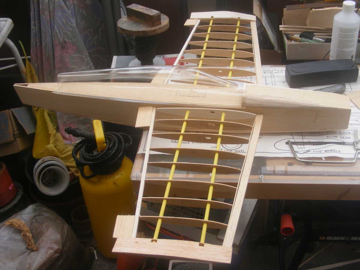

Miss Dara now has begun to sprout a wing. Glass tube spars, the two bits of dowel at the wing-tips are the intended way of setting up matching wing incidence! I think I'll add a sheer web on the leading spar, for about half span. The wing will be fully sheeted.

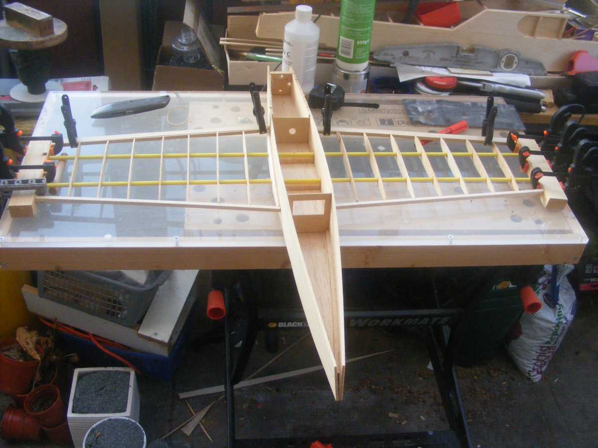

Bit more done - now waiting for the pva to dry!
Have you spotted the deliberate mistake???
I've done a 'Tony', and forgotten to provide holes for the aileron servo wires!
