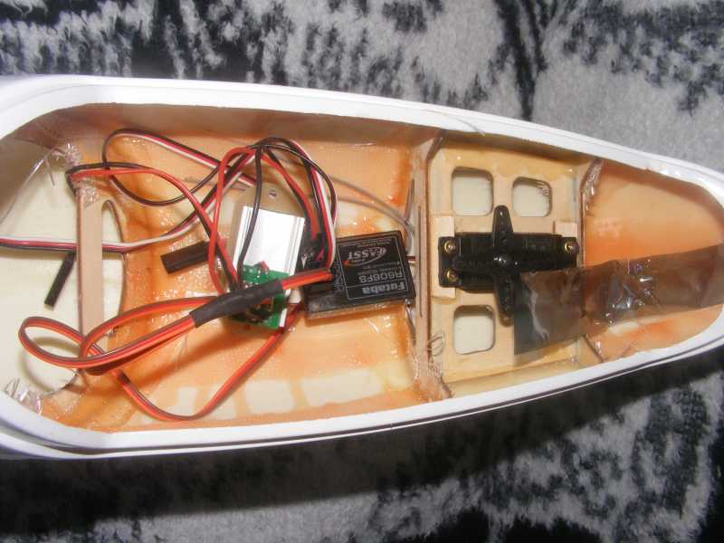

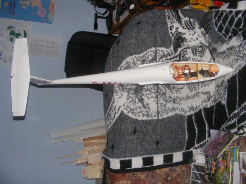

01 Apr 2012 00:41 - 01 Apr 2012 00:43 #4 by Eric
Replied by Eric on topic Re: Eric's build blog
Discus cz artf. Glass fuz, built-up wings. The pinkish bits in the fuz are extra glass and resin I've added, as the fuz is a bit flimsy.
note! The radio gear isn't installed, just plugged together while I centre up the servos!
You can see the wing tips behind the chair, leaning against the wall

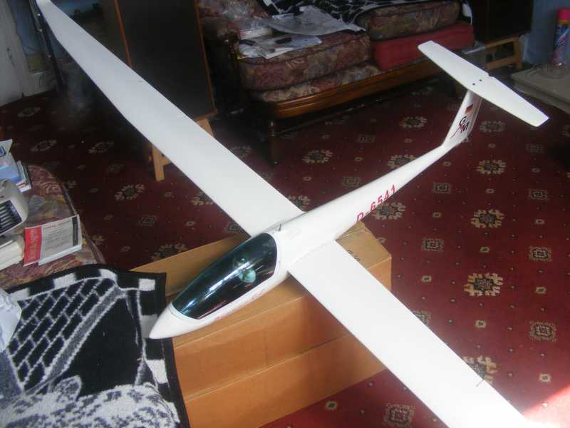

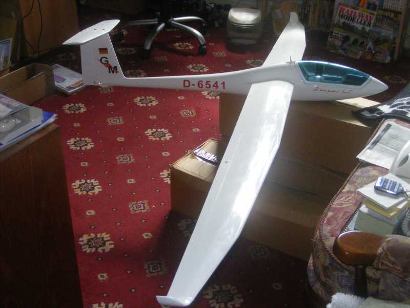

15 May 2012 23:23 #7 by Eric
One Discus, waiting to be test crashed.
It weighs in at 3lb 6oz, and has 9oz of lead in the nose to get the balance forward.
Span is 9 feet, or 108 inches or 274 of those foreign centipede things.

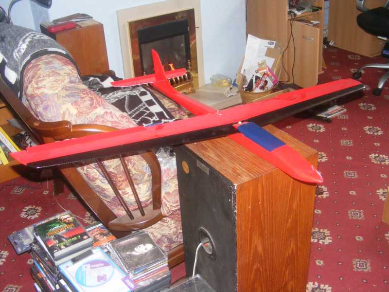

The 'one pound' glider is nearly done - (pics later) Just needs the wing bolt trimming a bit, as it's an eighth too long, and has 'bottomed' on the lower cross frame. It needs a fairing over the wing centre, and the control horns fitted, then it's ready to go.
It's also looking as though it will be a one lb glider, too, as it weighs in at 13.5 oz, with four AA batteries in the nose!

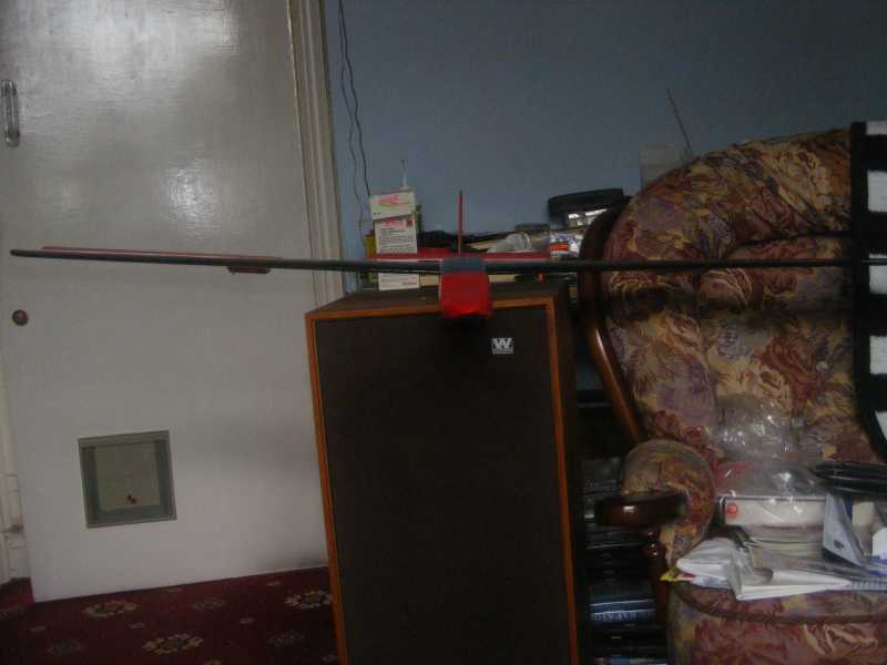

19 May 2012 20:58 - 19 May 2012 20:59 #11 by Eric
That one's a bit dark, but you can see there's not much of a head-on profile!
The servos aren't connected to the surfaces, yet, to save someone commenting!
Last edit: 19 May 2012 20:59 by Eric. Reason: added a comment

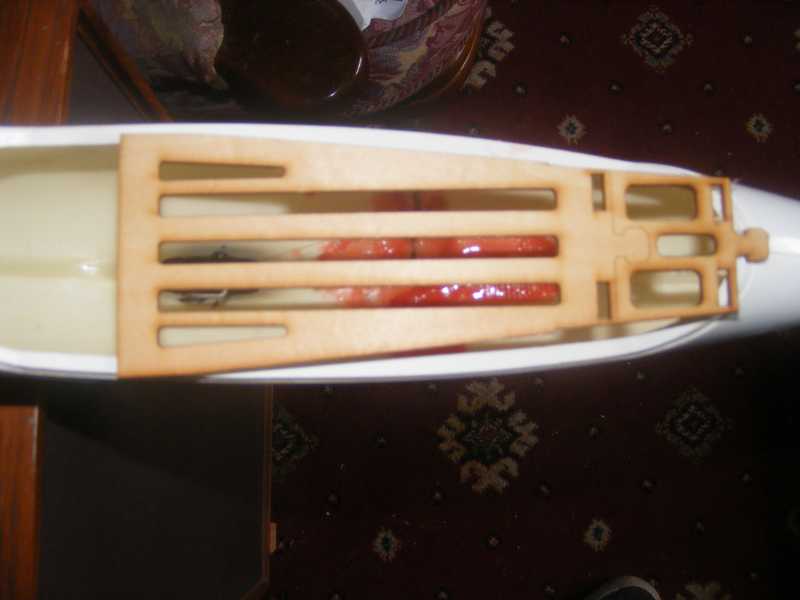

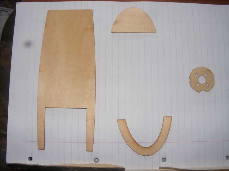

20 May 2012 20:30 #14 by Eric
Cockpit floor and motor mounting plate
other ply bits
This looks like the battery tray, but it's the wrong shape for the fuz!
