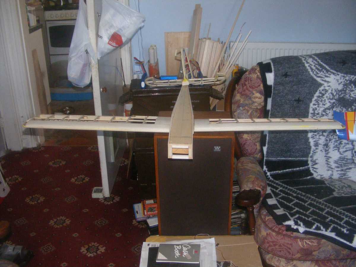

I need to sand Dara's nose down, before I fit the motor, so it doesn't get full of dust -
BUT -
I need to put the motor in before I can fit the triangular fillets, so I can sand it to shape - - - :S

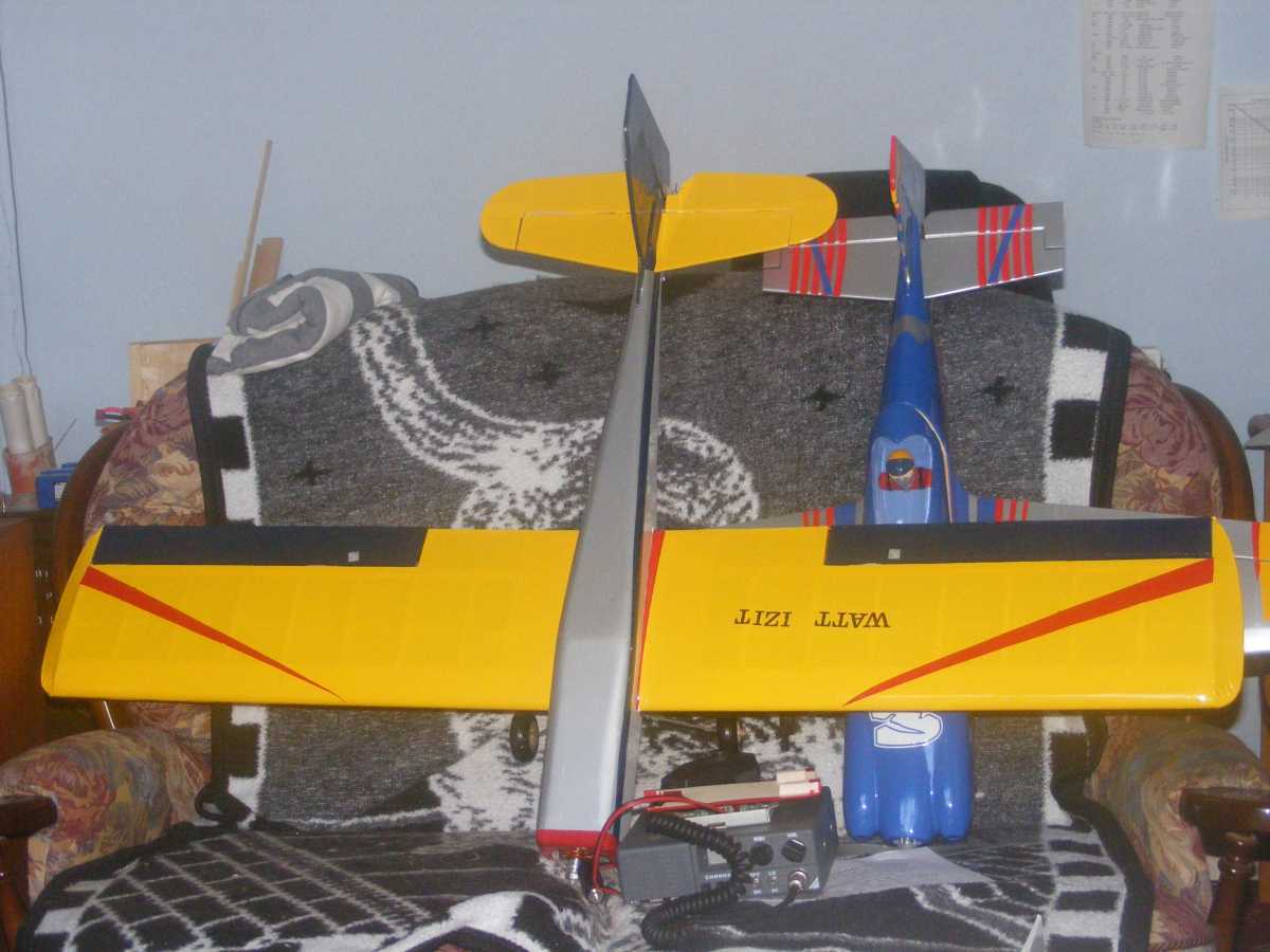

The latest 'thingy' my Watt Izit.
Thanks: Klipkopwildlife, Quorneng, THE BLACKBIRD, blue123, old fart
20 Jul 2014 19:27 #141 by Eric
Replied by Eric on topic Eric's build blog
It flies - after a few fraught moments while I got the trims sorted, in a rather blustery wind, it proved to be one of those models that puts a silly smile onto your face! :woohoo:

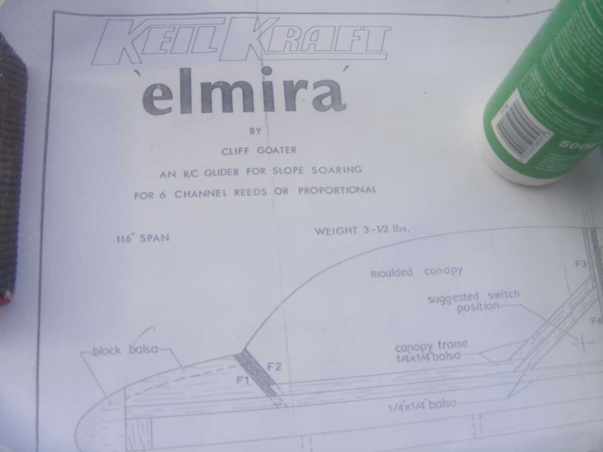

For one of these -
It's a little bit tricky trying to build that on a three-foot board! :P

Eirc, you prob know the problems the Elmira has, it just dont turn, it even struggled with the bigger rudder i made for it, it needs ailerons, but, it does look superb in the air, got anywhere to get that HUGE cockpit from?
27 Jul 2014 10:57 - 27 Jul 2014 11:02 #146 by Eric
Thanks, Alan, I was aware of that, and said, in the chat-room, I think, that I was intending to fit up-only ailerons, using a clever three-way external mixer I've had for years, made by Robbe.
It has one input (ie rudder), but three outputs, the central one being for the rudder servo, and the two outers for the ailerons, BUT they only deflect up, not down, thus putting the drag on the same side as the down-going wing. (ie 100% differential!)
I've also got electric spoilers I was thinking of fitting, too.
