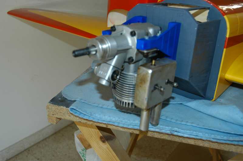

Took the cap 232 for its maiden flight this morning and the Moki would not keep running after i took the glow stick thingy off, came home checked everything it was ok, late this afternoon i put a four stroke plug in it ,an OS F plug and it works now. ?? but will not run on a OS 8 glow plug
so ill try again in the morning.

I think its got to be a mixture problem, just been sat having a coffee and it just clicked.
to rich a mixture and it is putting the glow out, sooo its the slow running screw i have to adjust !!!!
i think.
And the needle valve

The Moki would not keep running again, all the experts form the club were at it for two hours and still they could not get it to run, as soon as we took the glow stick thingy off it stopped :S:S

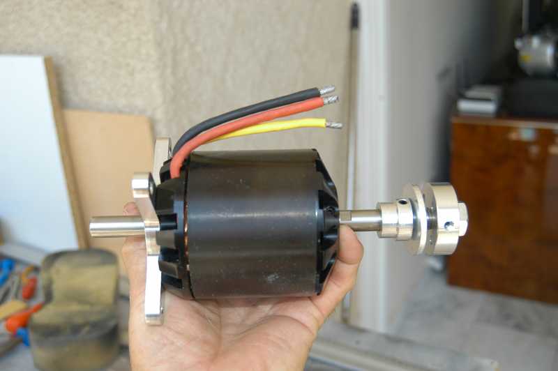

Think ill change this
For this
on 12s it is equal to 100cc so on 6s maybe 40cc two 6s 5000 would give me 10,000 should be good for 10minutes +, Either Eric or Klippy will no dout disagree

Try a different plug in the Moki, BB. It could be a dud one where the fire goes out when you take the volts off.
Either that, or you are running it WAY too rich, and it is drowning the plug.
Try turning the model upside down, so the engine has the cylinder up, and see what happens.

That's gotta be a duff plug that ... or as Eric says, too rich.
Does it just pack up on idle or will it still stop when you take the glow lead off even if it's doing a fair RPM?
If it only stops on idle, you could try a plug with an idle bar.

It stops on any throttle opening, we tried loads of different plugs,we turned it every which way but loose, i had it running at home Friday without the cowl on, the tank is spot on centre of the valve close as i can get to the engine,all the pipes are good, i think it has to be the mixture,
That i think is why the guy sold it ( on the other forum ) its the first time i have bought second hand and it is the last time, had i known better at the time i would have gone for petrol, i think i will buy a petrol engine for it anyway and stick the moki in the bring and buy at the nats.
I will see what happens tomorrow when i try again, dont like to think something is going to get the better of me, i want to get it running ok then get rid of it.

Hang on a sec' .... have you tried a different fuel? .... the laws of physics don't go wrong, if you have a fuel / air mixture under compression & you stick a glow plug or a spark there .... IT WILL GO BANG!
This stinks of some really basic thing being overlooked.... the engine design works .... they've sold thousands .... they work on the suggested glow plug .... they run on the suggested fuel ... Where do you think the fault may be ?..... I don't mean that disrespectfully.
