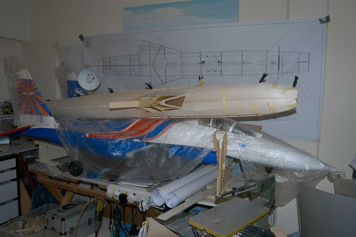

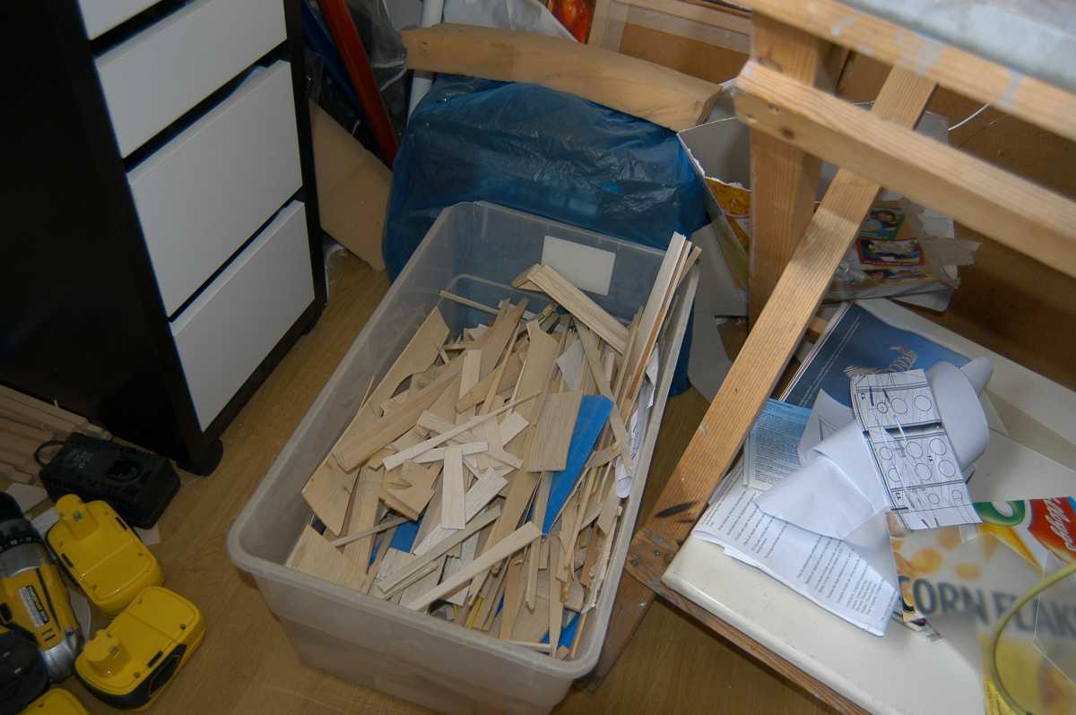

I have the ply, the balsa a scrap box and a plan
I need to push on and get it flying

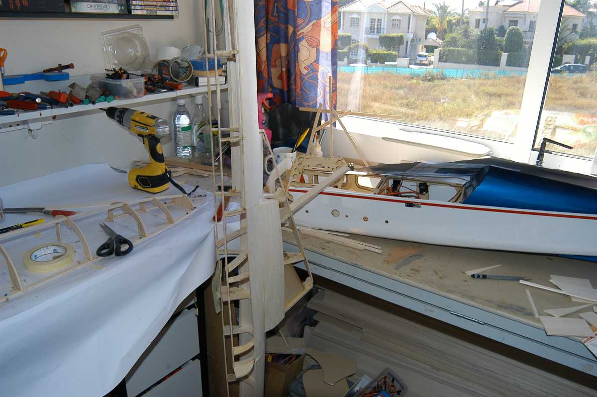

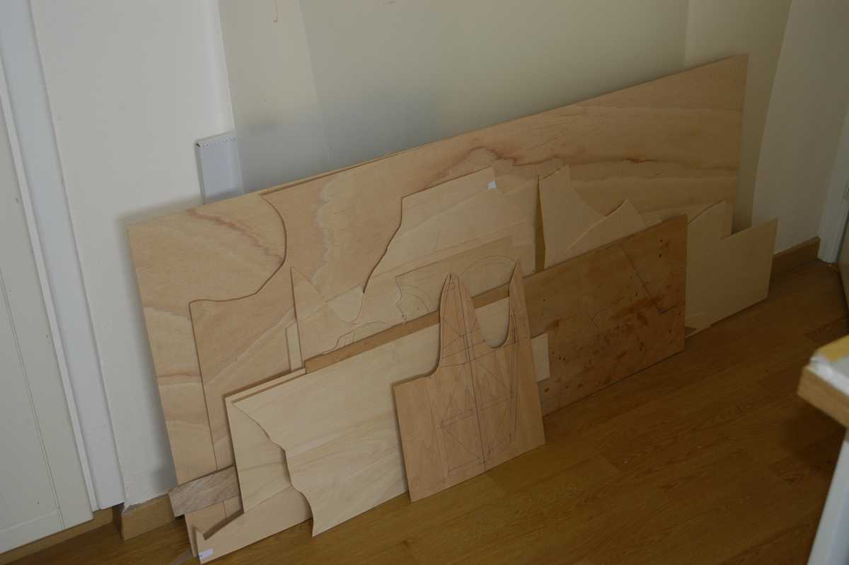

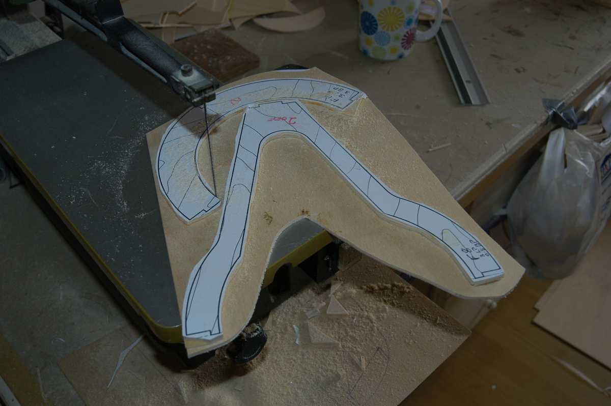

27 May 2013 11:20 #11 by THE BLACKBIRD
Replied by THE BLACKBIRD on topic THE CYPRUS HUNTER
Useing the spare plans i copied to make the paterns for the formers, they are all in 3mm and 6mm ply, i need four of most as they are laminated from light and birch ply
the vertical crutch is nearly 96" long so its out of 1200mm sheets 3mm ply
My trusty laser cutter :)

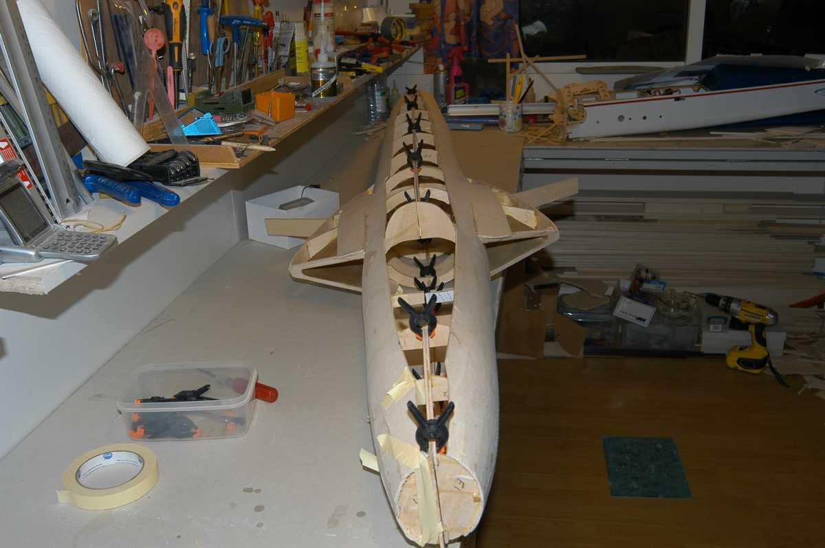

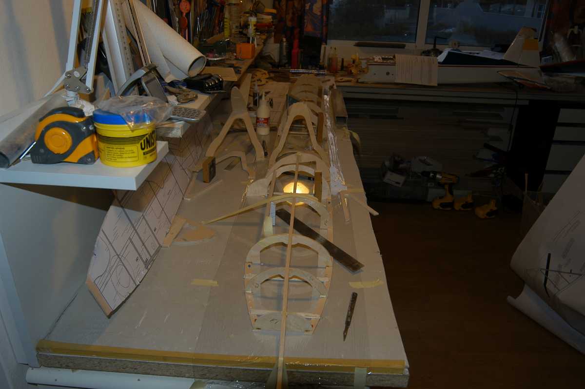

27 May 2013 11:25 #12 by THE BLACKBIRD
Crutch laid out and formers being erected

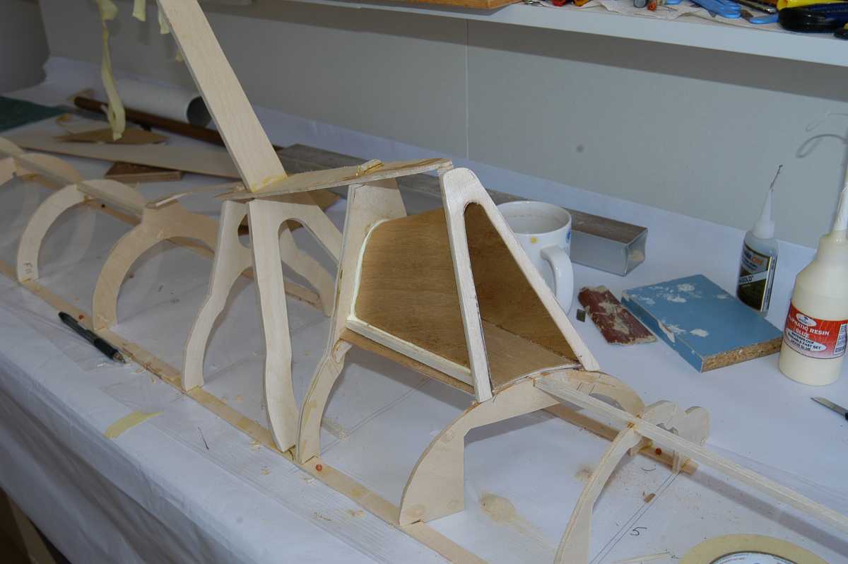

27 May 2013 22:57 #13 by THE BLACKBIRD
The air intake i made with rolled ply so it needs little doing to it before painting
I planked as much as i could with the fuse half pinned to the bench to keep it straight
First half done second being built
Both now clamped together
and put on the shelf to dry
Thanks: , Eric, Klipkopwildlife, Ex-Member, Quorneng, blue123, old fart

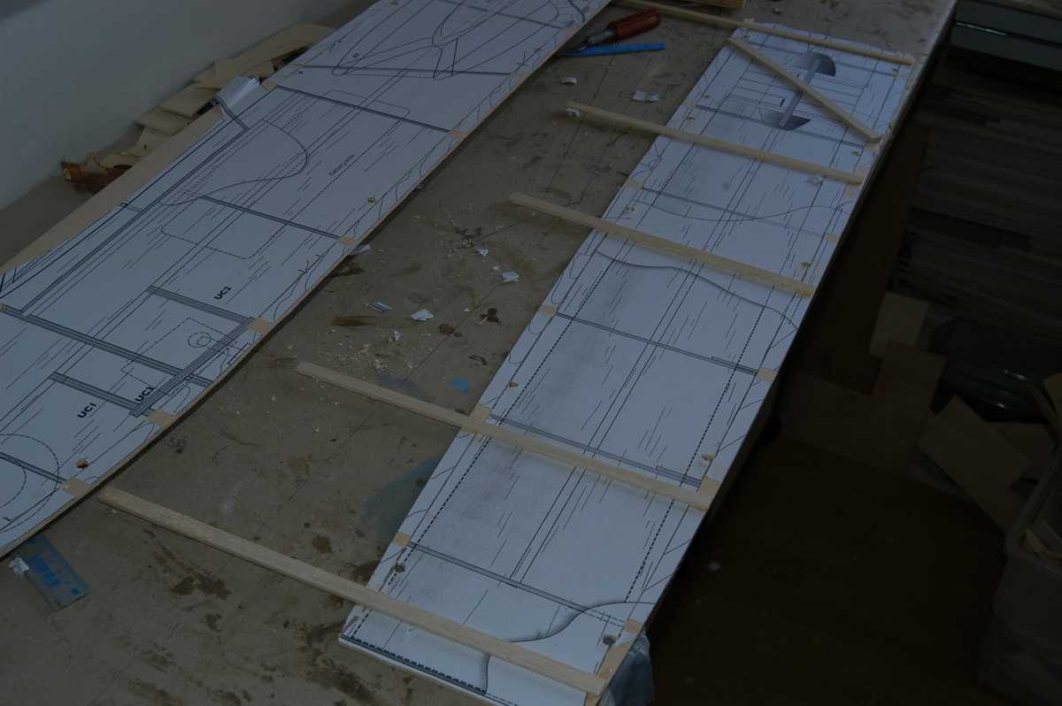

28 May 2013 18:04 #15 by THE BLACKBIRD
Good stuff Eric thanks, the plans are from Traplet and they are not to good to be honest,certainly not as good as RCM&E
I am just going to rough it in for a start and see if it flys and only then maybe detail it, like stick a wire undercarage on it rather than spend on retracts,
