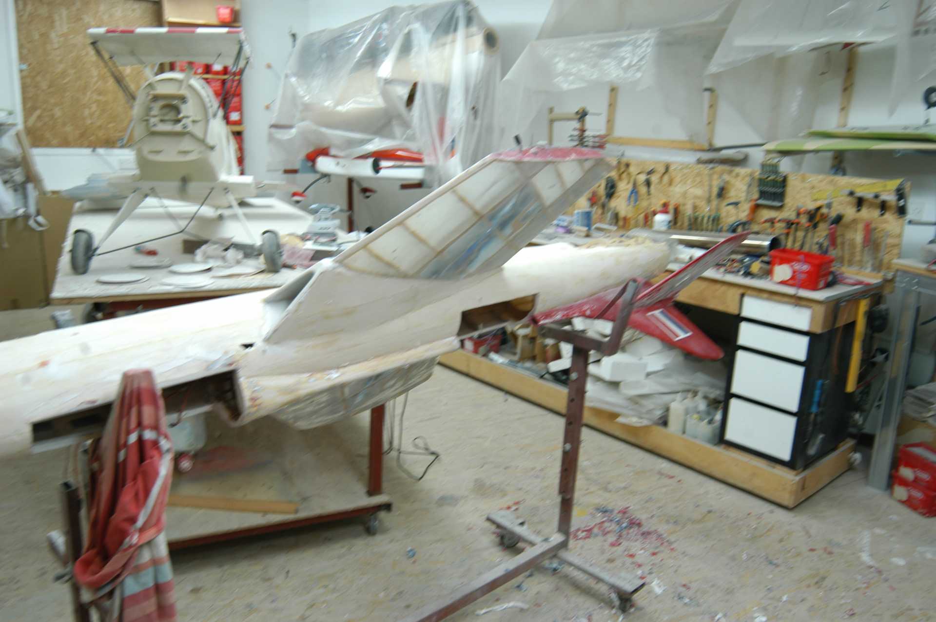

21 Nov 2017 20:16 - 21 Nov 2017 20:21 #296 by THE BLACKBIRD
Replied by THE BLACKBIRD on topic THE CYPRUS HUNTER
Today with nothing better to do i thought i would clean up the hanger rash on the Hunter
[attachment:1]DSC_0002.JPG[/attachment
Think i got carried away :P
Never did like the finish on it, just was not good enough, and the rear end was the wrong shape as it was designed for EDF
Sooo i thought i would do a job on it as it flew well, but i need to shed some weight from the rear so i can get rid of some lead in the front, then it will fly even better
Stripped the planking off the rear bottom to reshape it and get at the formers inside as although to plan there is far to much wood in them
I will move the turbine forward as much as i can
Need to get some paint stripper to get the paint off
The glassing on the fuselage peels off there is no key to the balsa at all :S so ill strip it all off and redo it
Stripped all the air tanks, fuel tank and everything else out, see if i can get it right this time,

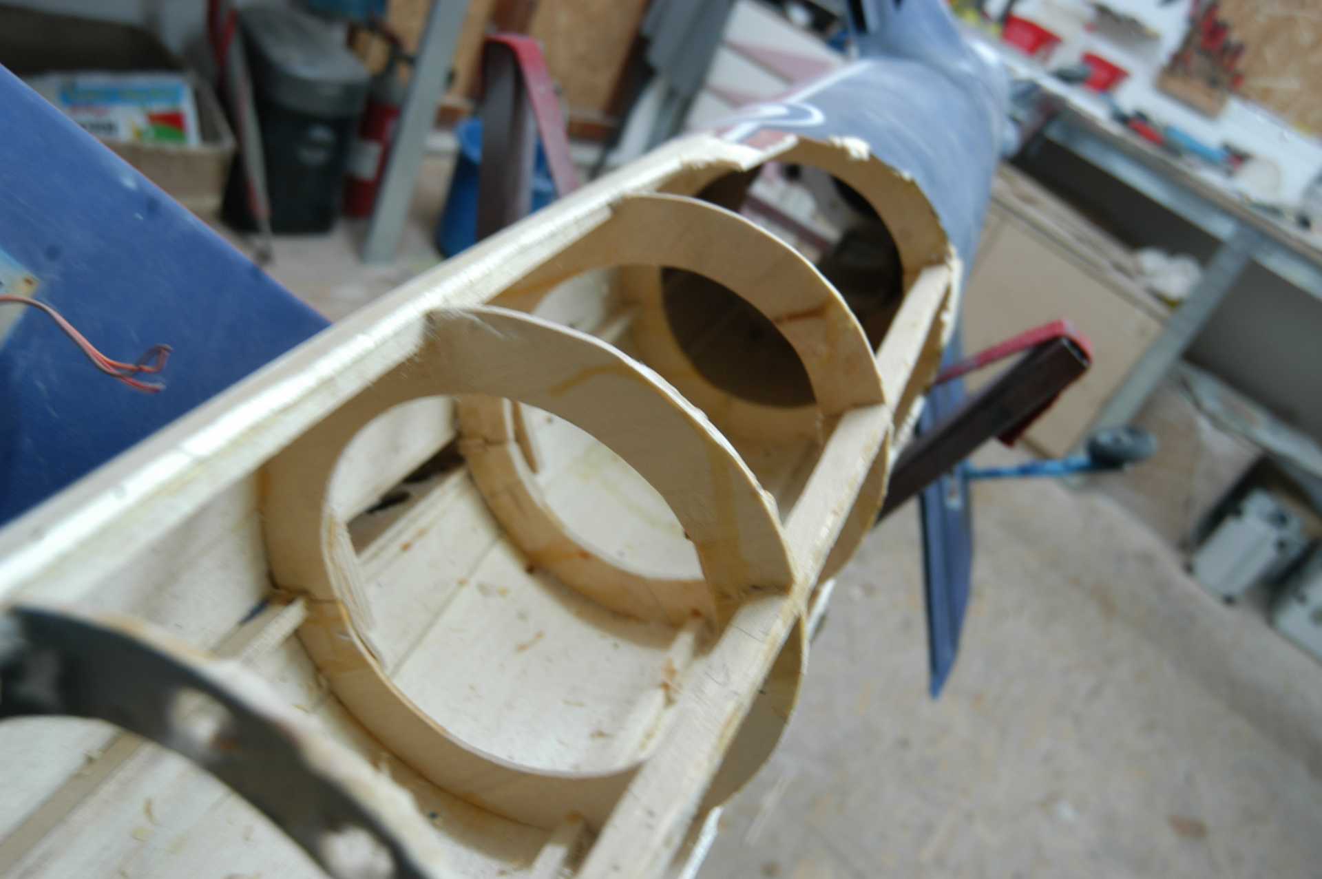

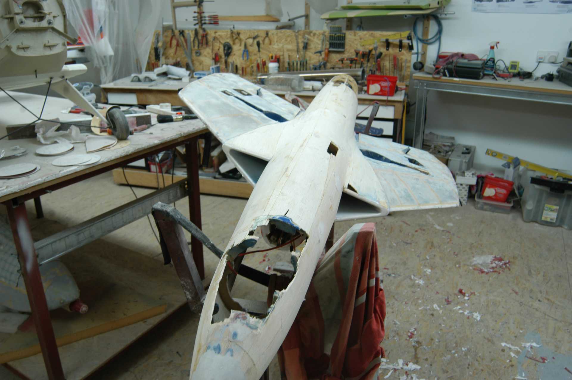

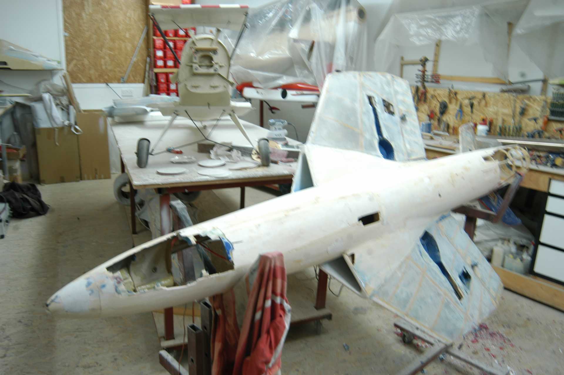

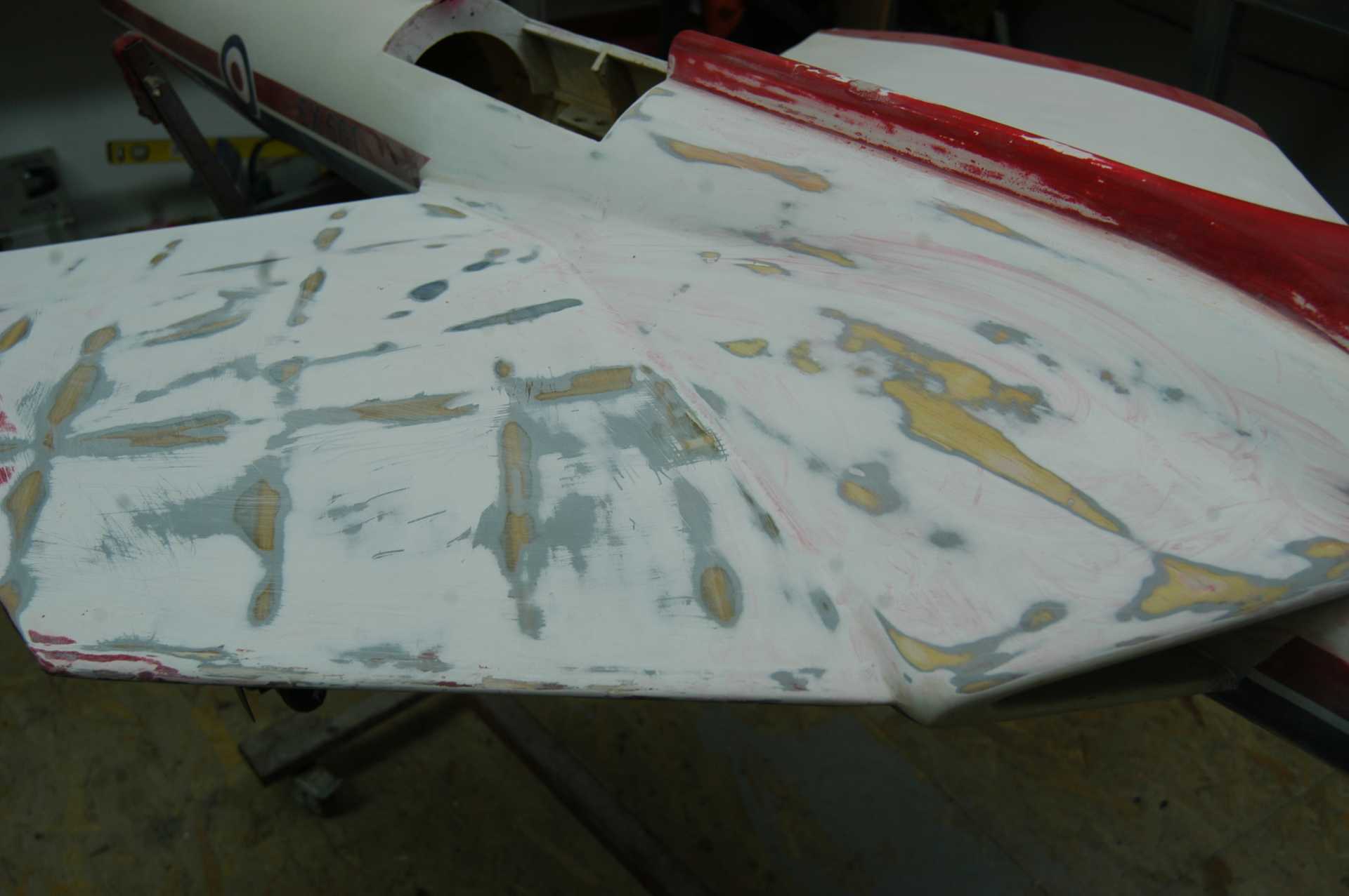

23 Nov 2017 20:53 - 23 Nov 2017 20:58 #298 by THE BLACKBIRD
What have i started :S a lot of the fibre glass came off willingly but a lot was stuck very well and had to be forced off
And the paint is very hard, paint stripper hardly has any effect on it and sanding is really hard going, but im getting there
took all the retracts out and will replace with electric ones, also the former's at the front that held the nose wheel so i have a big hole there now, good job the wings were done in Pro - Skin with the pressure im puting on it to get the paint off
