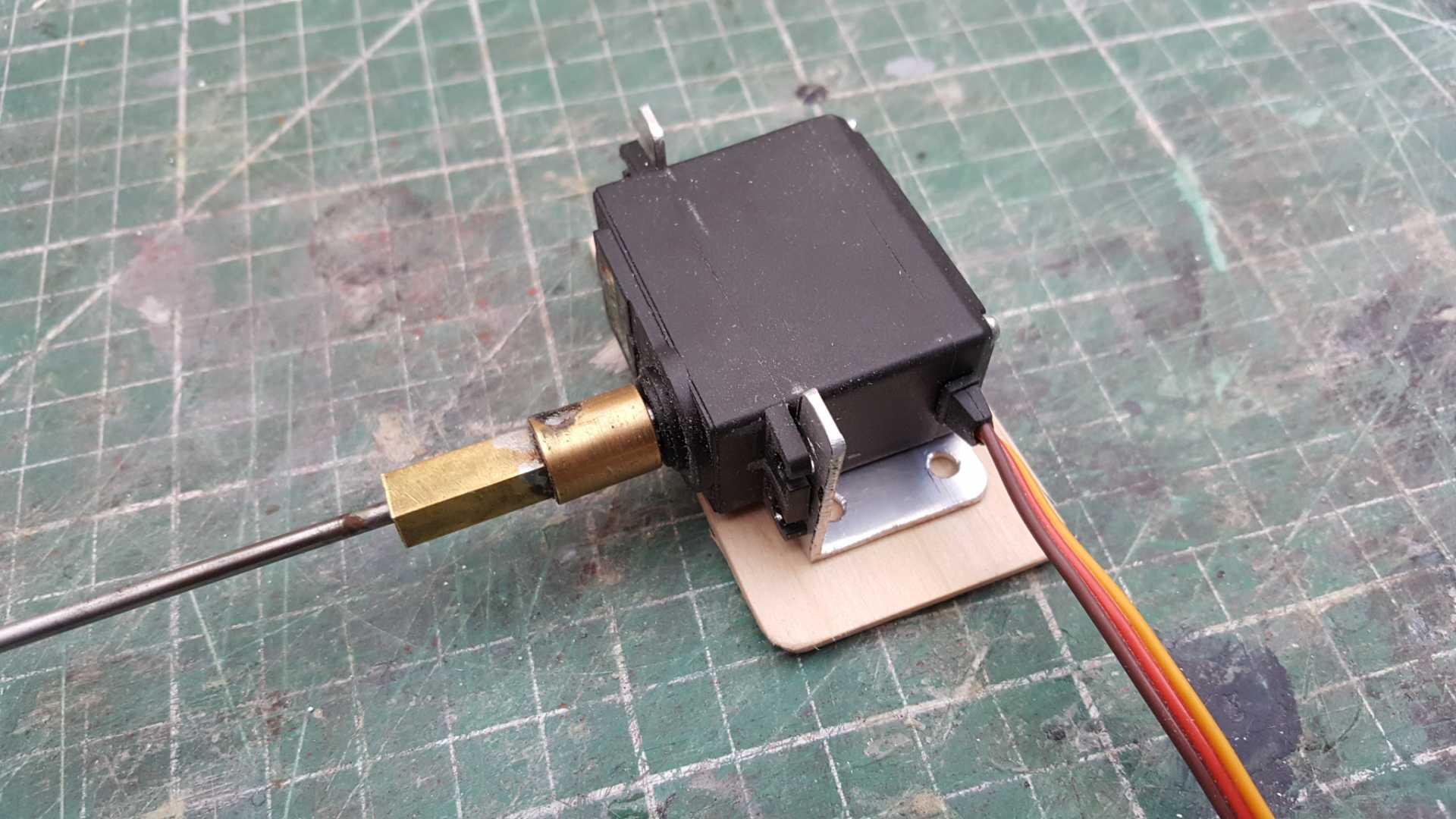

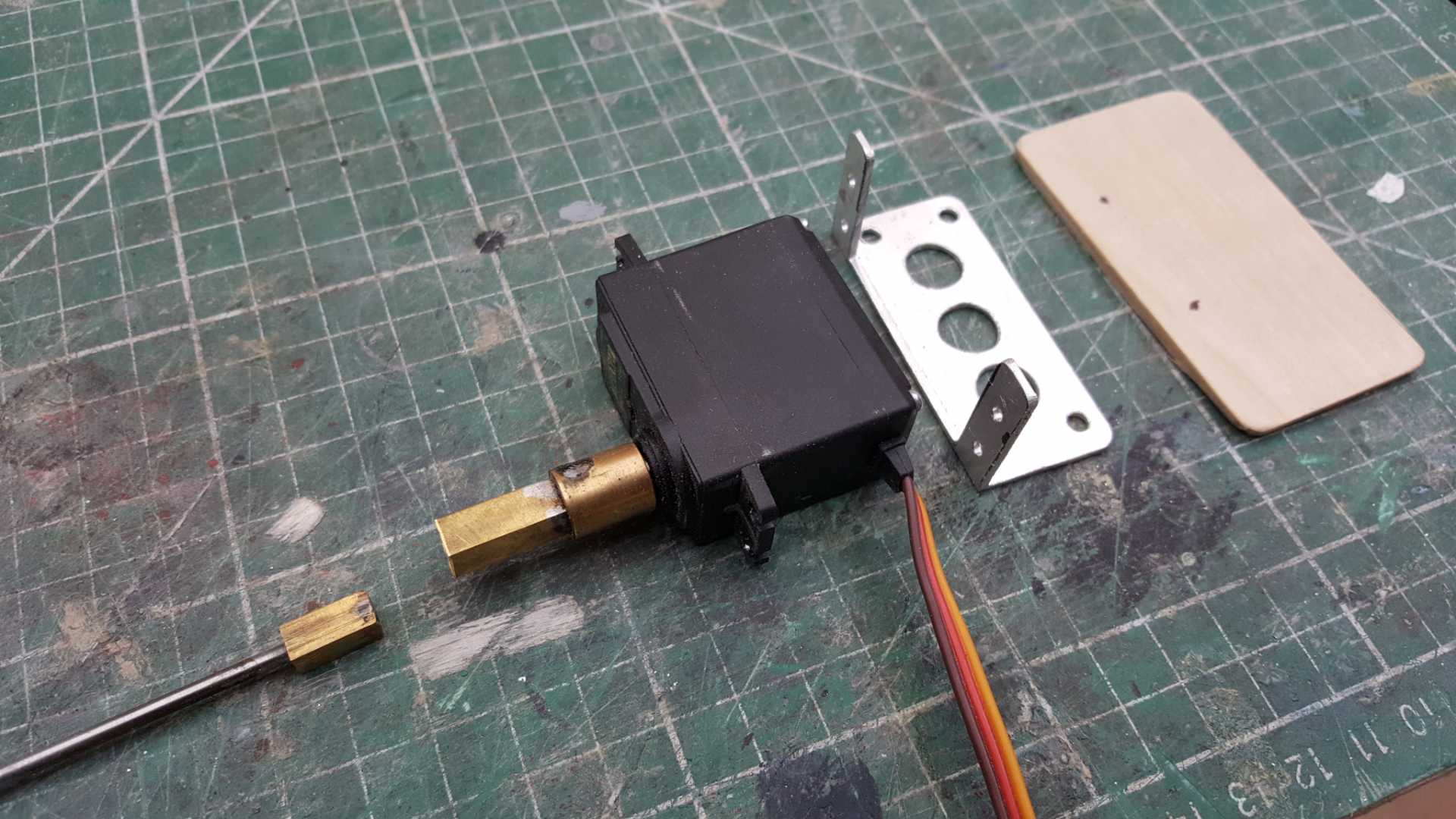

Managed to get some time in on the Gannet today. Made the three RDS servo mounts, 2 for ailerons and one for the rudder.
The ply plate will be glued to the airframe (captive nuts not shown) then the ally servo mount is screwed to the ply plate. This allows me to remove the servo by sliding the ally plate backwards and up away from the RDS rod which will be trapped in the control surface.

Rudder RDS is installed and working. Really pleased with it considering it is my first RDS system. Once I have cleaned up the rear formers and longerons I will sheet the rear part of the fuselage. Access to the rudder servo will be via a fibreglass hatch that I will mold off the sheeted section. The hatch will be held on by magnets. :woohoo:

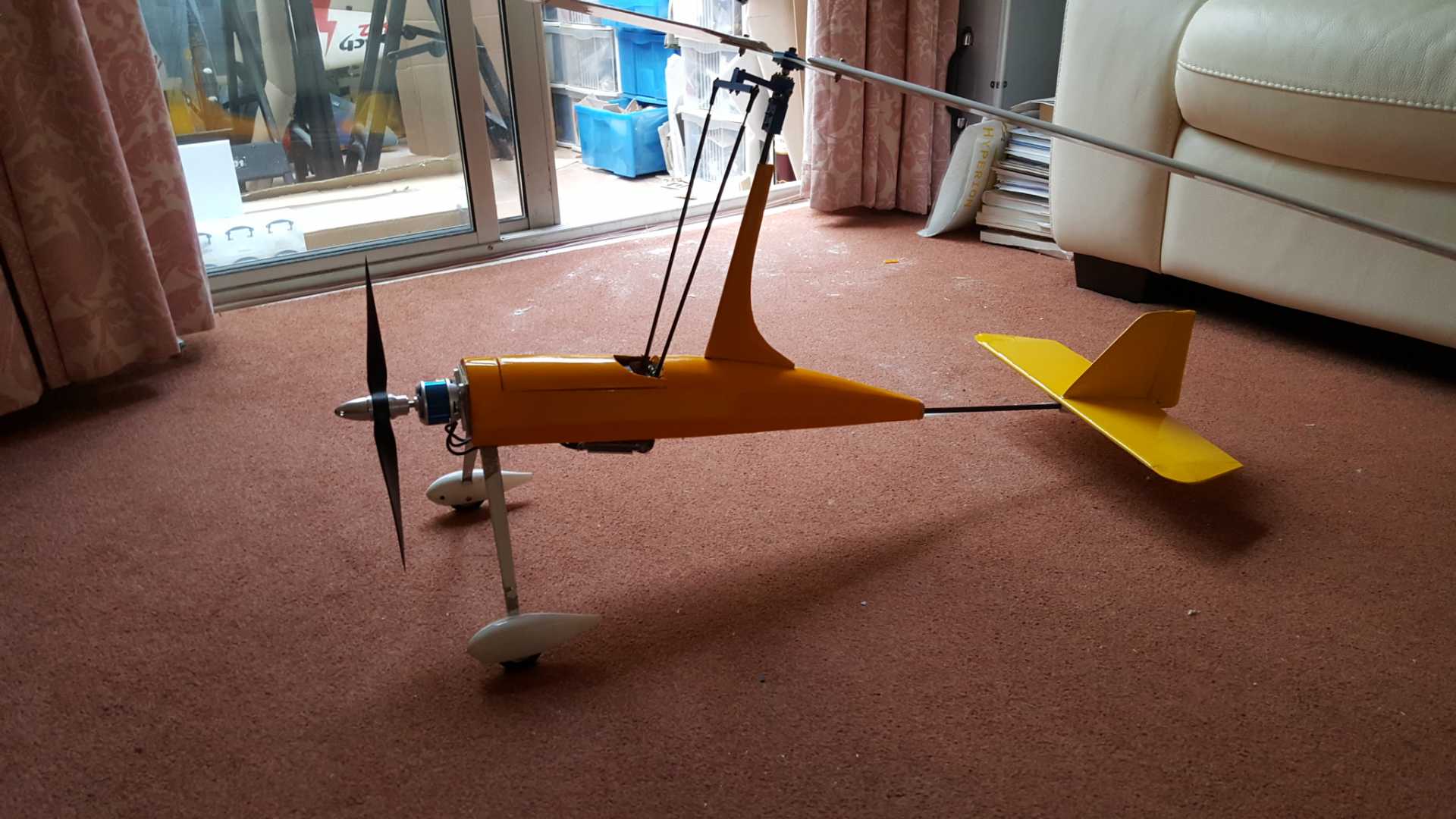

Oh! the autogyro flew beautifully on its maiden on Thursday evening. Minor trim changes and she was away. I think i'm getting the hang of the aero modelling lark!! [badass]

Looking good on the Gannet! Happy to hear the AG flew! One of the things that helped me the most with orientation was to put a contrasting color on the bottom of the horizontal stabs. I used a neon pink! It doesn't detract from the overall colour scheme and tells you instantly which way it's banked. Helps with my tired eyes.

Thanks Don. To be honest I wasn't expecting the AG to last long so didn't bother with trim on the blades. :sick: Now it looks like a keeper i've put yellow on the top and black on the bottom of the blades.

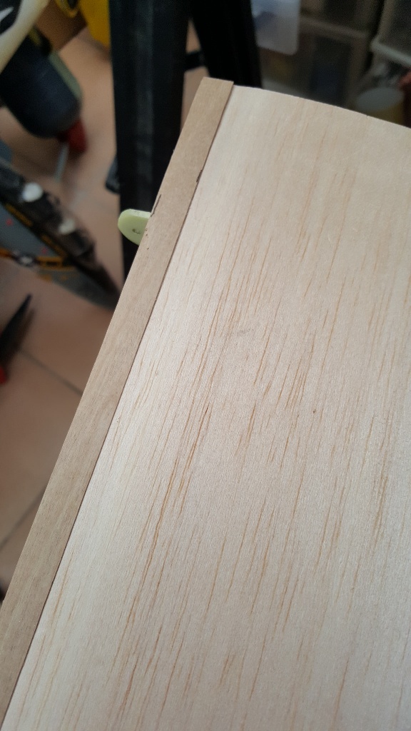

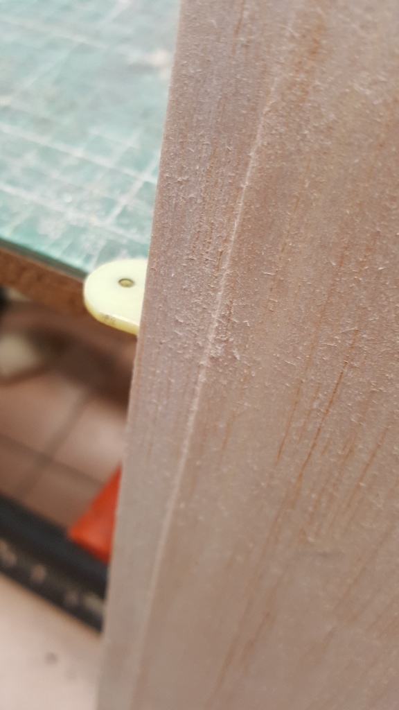

Well I just went to start covering the tailplane and realised I hadn't let in a 1/64th ply edge trim to stop the balsa curling up at the tailplane / elevator edge. So I made up a sanding block with an edge guide to give me an accurate width all the way down the tailplane edge. The photo makes it clearer. Then I will inlay the 1/64th ply. So its looks like a job for tomorrow unless its good enough to go flying in which case its going to be a job for evenings in the week. a good days progress. [badass]

21 May 2016 23:25 #146 by Quorneng
Replied by Quorneng on topic Fairey Gannet AEW3
I assume even the 1/64 is 3 ply.
If it is and you are trying to stop 'curl' shouldn't that ply go with the grain the other way?
  • Ralpharr2001
21 May 2016 23:58 #147 by Ralpharr2001
Replied by Ralpharr2001 on topic Fairey Gannet AEW3
You are correct except this is an odd piece of two ply. I got it from a furniture restorers who use it for inlays and the like. This piece was actually used for a guitar. Underneath this edge are the ends of the ribs which also support the edge so i'm not too worried.

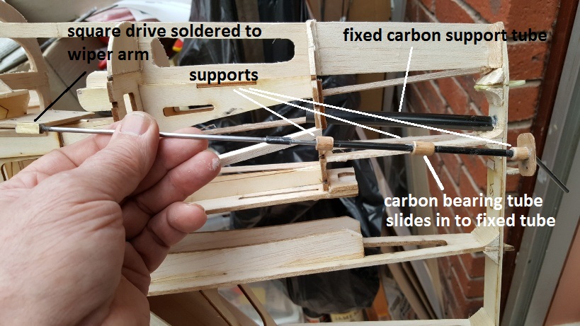

Up early this morning and got a bit more done before I went flying. I wasn't to comfortable about the long length of the rudder RDS wiper arm so made a support tube with a bearing tube that slides in/out of it. The support tube had to be big enough for the drive that slides into the servo to pass through if I wanted to maintain it. The bearing tube slides in and is kept in place by a small flange that is screwed to the rudder post. Sounds complicated but a photo saves a thousand words. The whole bearing system only weights a few grams so quite pleased and my mind is settled now. Also added another part of the fuselage sheeting.

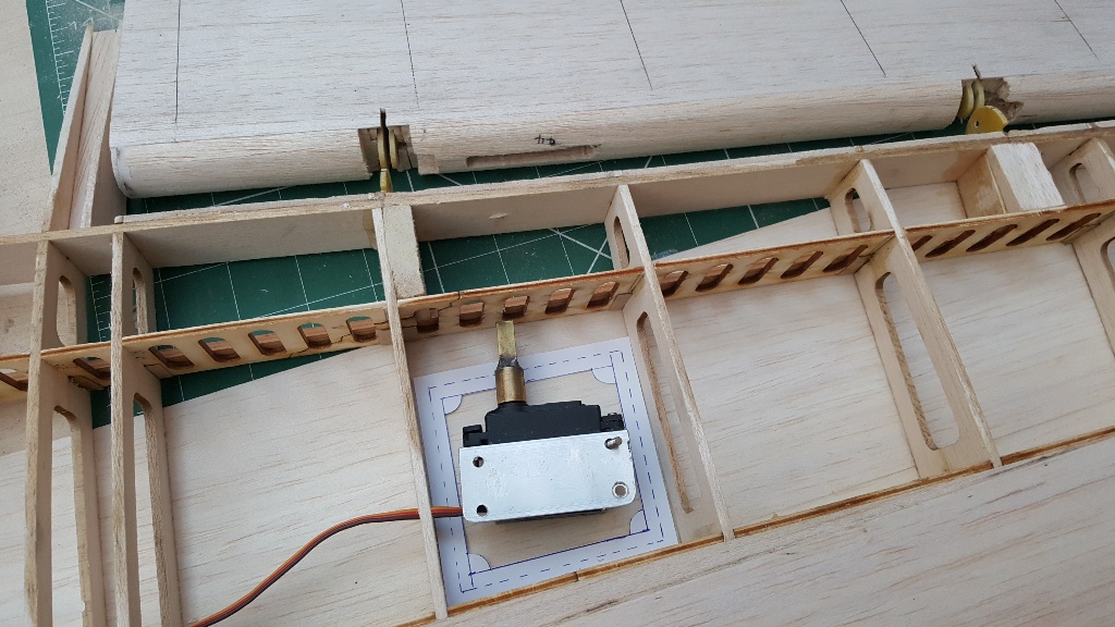

Its been a while ;) and now the weather has changed so not much flying to be had so its back to the Gannet build over the winter. Todays job was to sort out the aileron installation to allow the RDS to work and permit the servo to be removed if needed. The picture shows the template for the hatch support frame. The dotted line represents the hatch to be cut out of the lower wing skin. Once this is done i can install the mounting plate into the top wing skin. Not much but another bit done.
