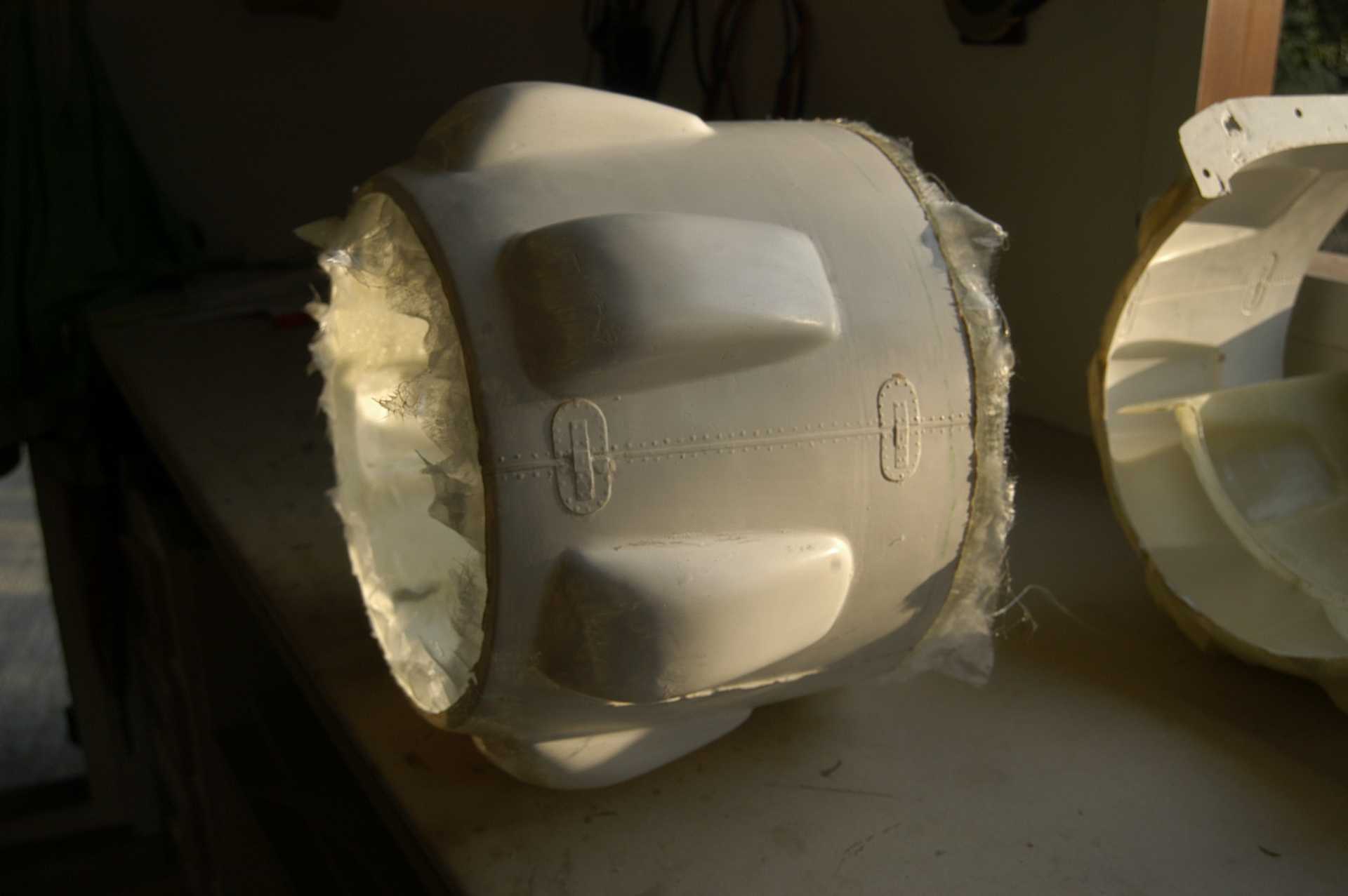

20 Jul 2016 19:15 #108 by THE BLACKBIRD
Laid up the cowl this morning, took 240ml of resin to lay the three layers of cloth, I cut for four layers but will see how strong it comes out, and it took just over two hours to do it, not easy working inside the cowl

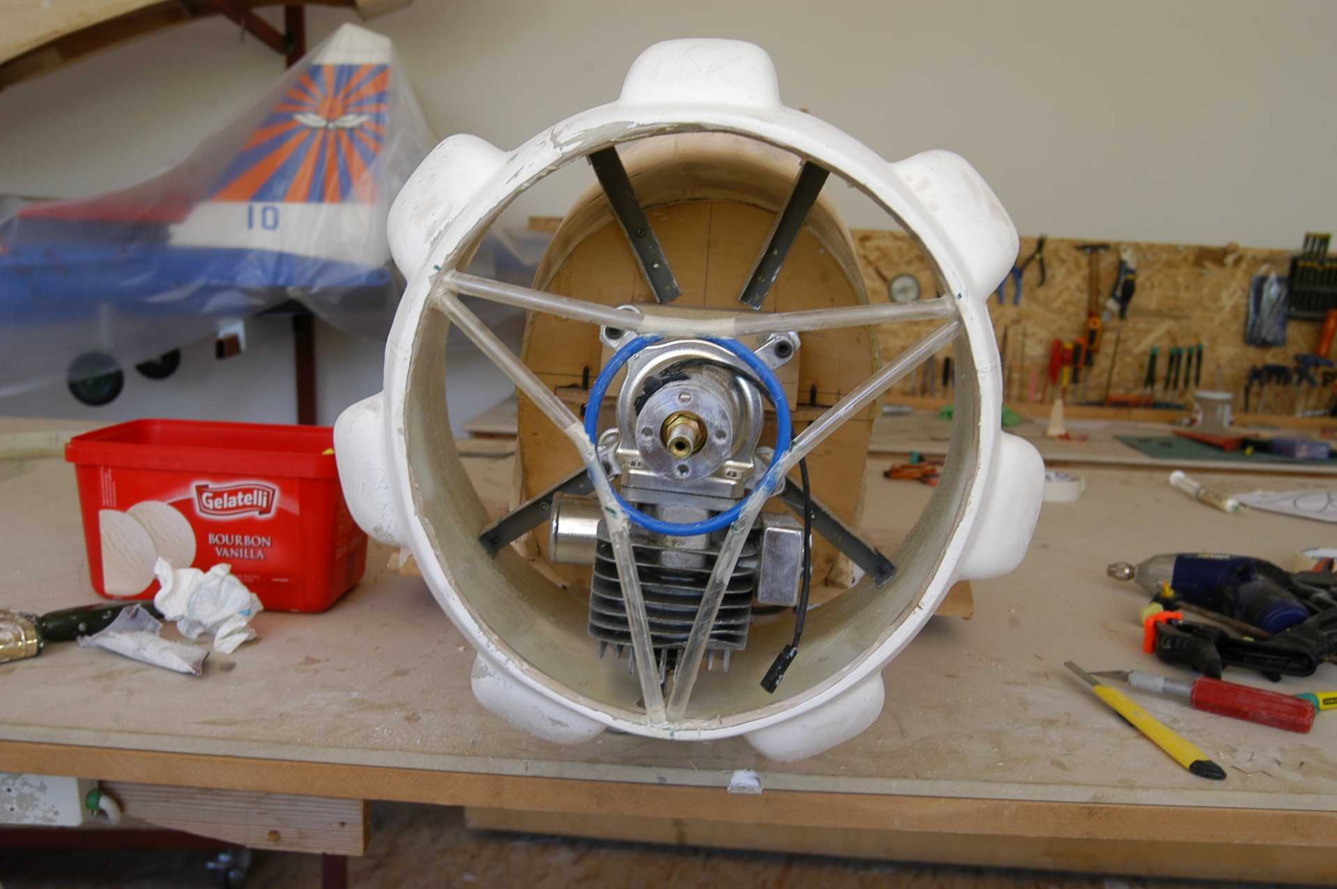

21 Jul 2016 20:55 - 21 Jul 2016 21:09 #109 by THE BLACKBIRD
Been a cowl of a day today, :whistle: spent all my modelling time today working on the cowl
Came out of the mould ok, quite pleased with the result
Cleaned it up
And decided to fit it
Made up some better brackets than i used on the old one

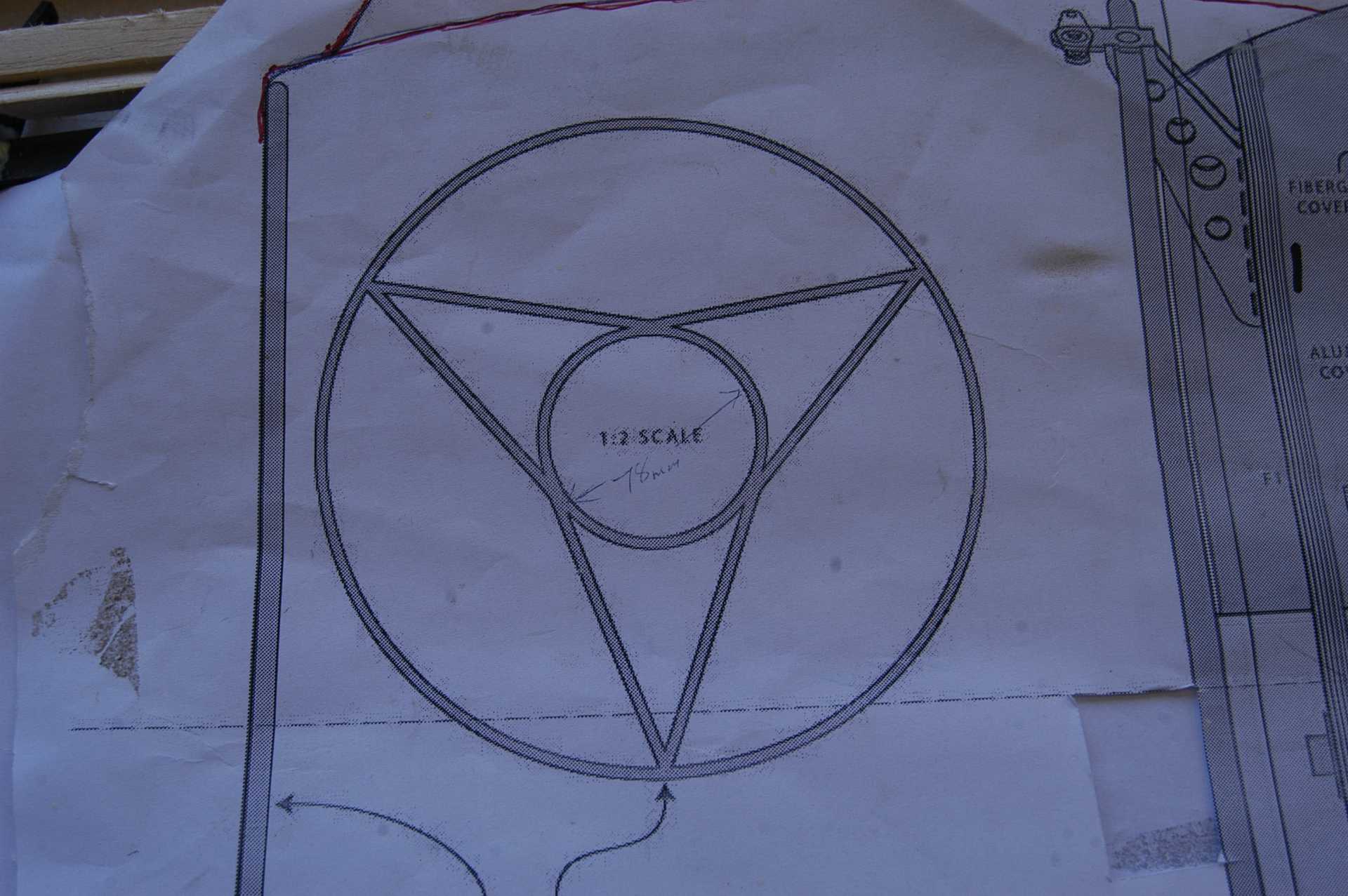

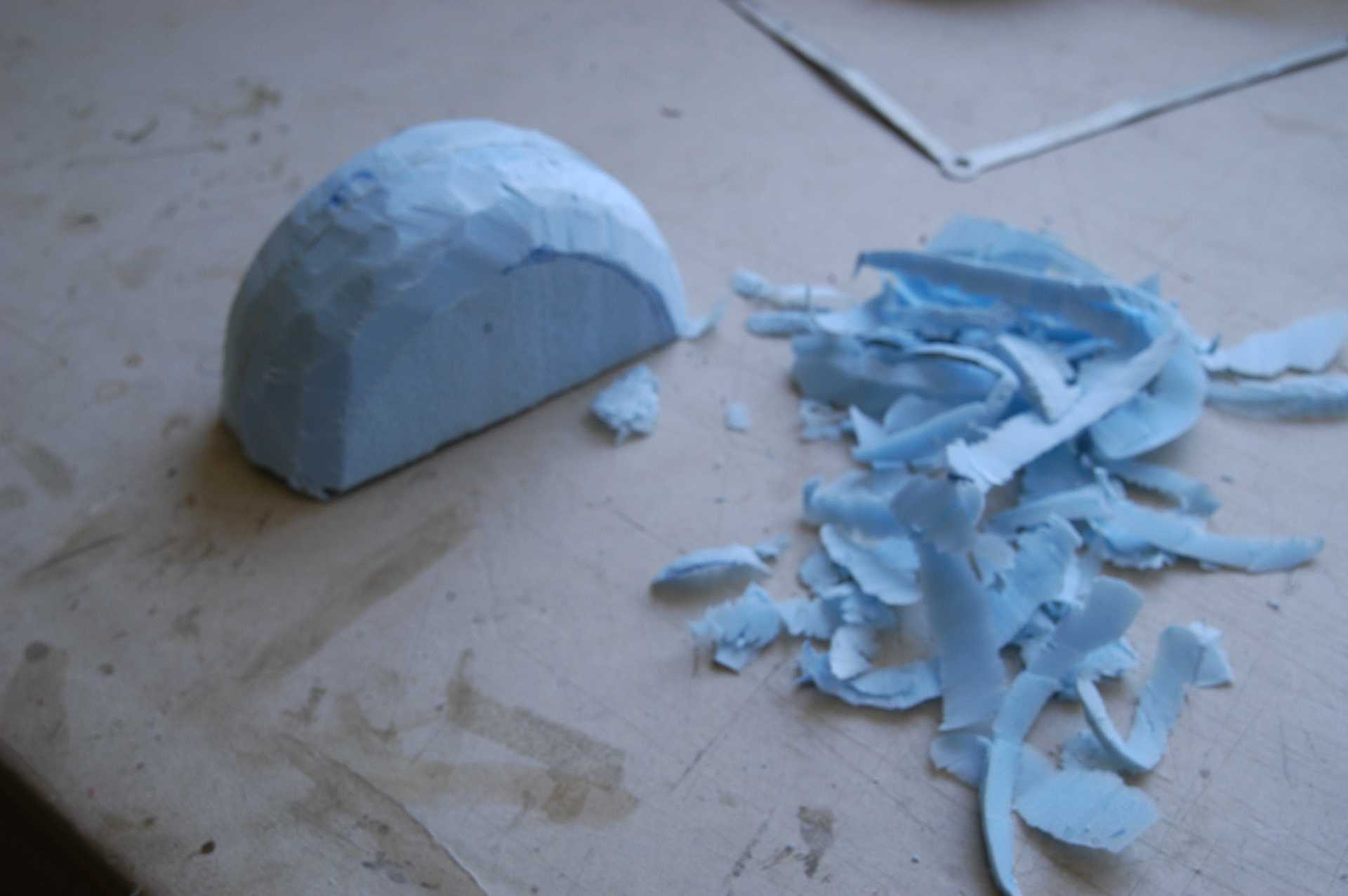

21 Jul 2016 21:16 #110 by THE BLACKBIRD
Then thought how can i make this , it is in the front of the cowl

22 Jul 2016 19:35 #111 by THE BLACKBIRD
Did it sort of , think it will be ok once its rubbed down and painted

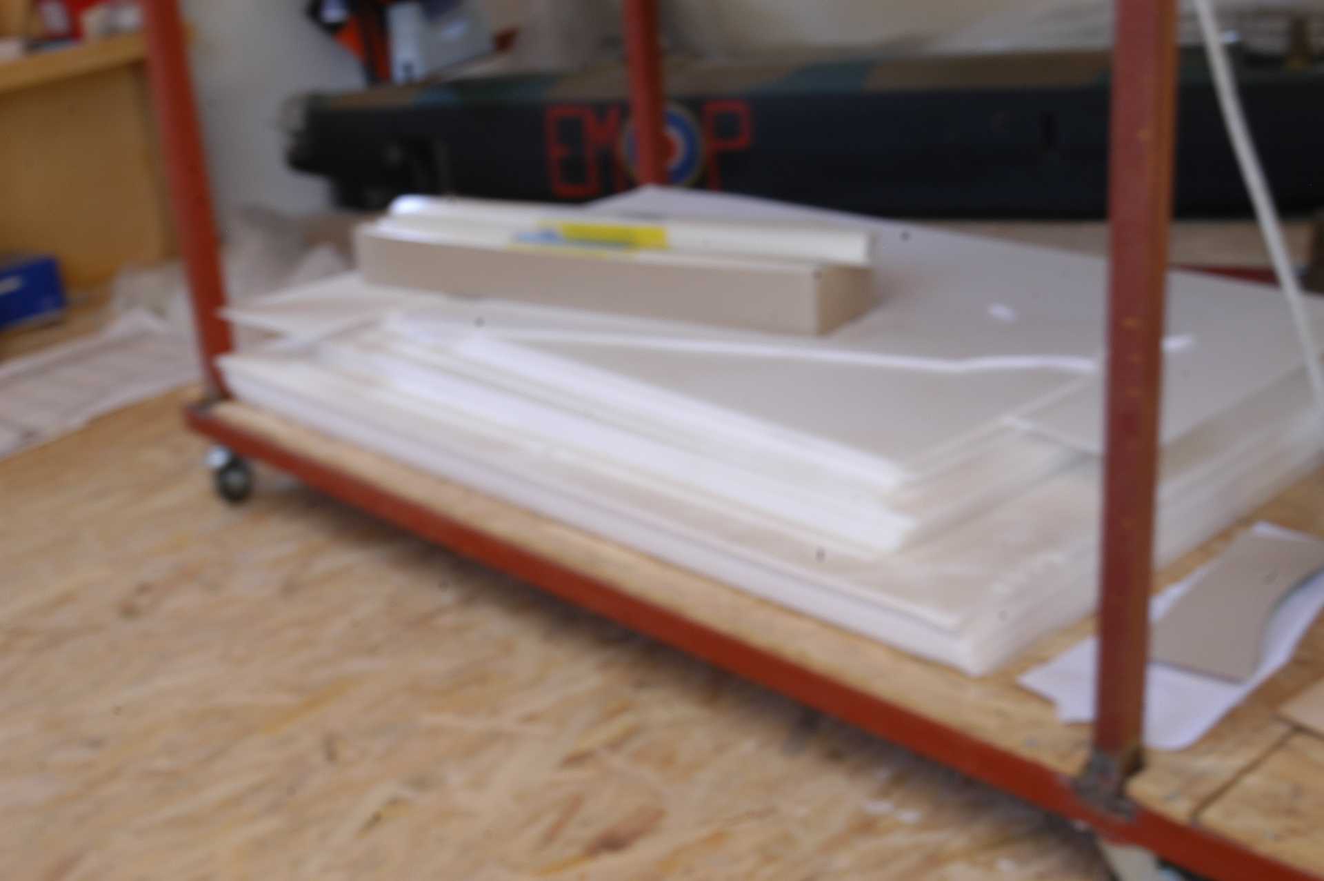

If I could get this lot over to you free of charge Tony you could have it, 40 sheets of 3mm and 6mm aero Depron

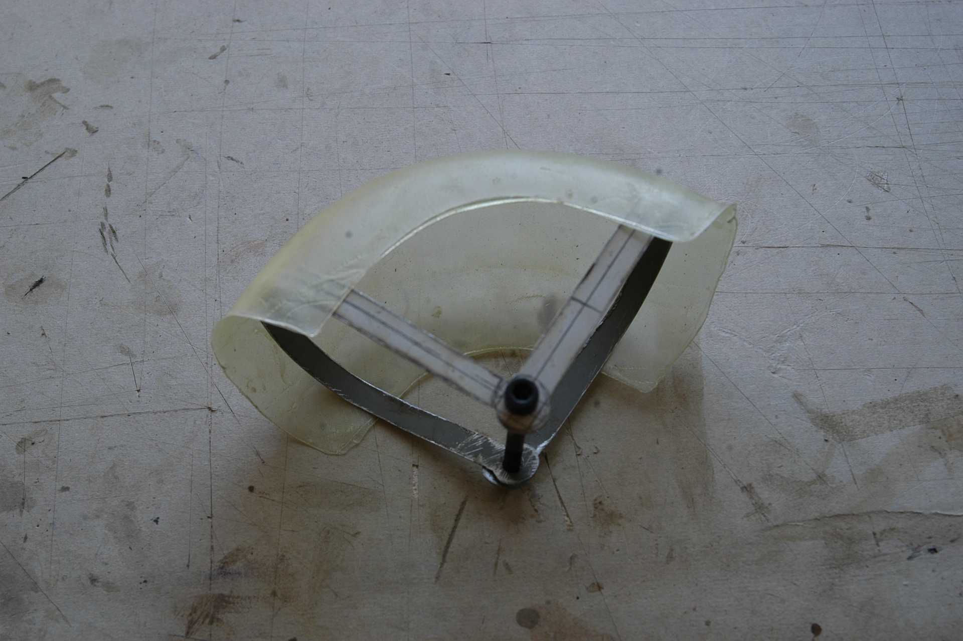

25 Jul 2016 20:19 - 25 Jul 2016 20:20 #112 by THE BLACKBIRD

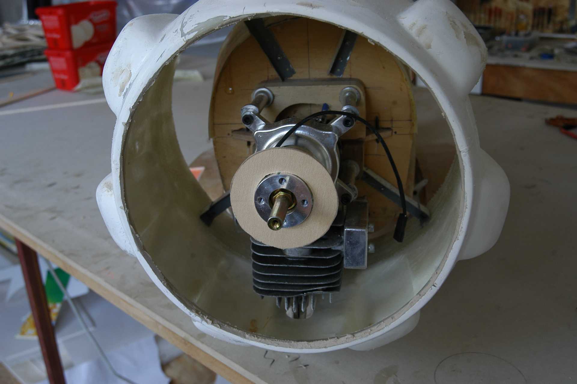

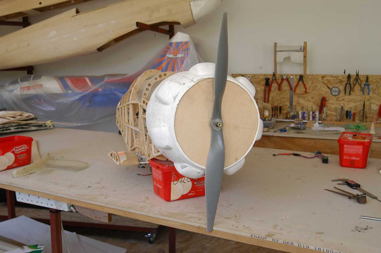

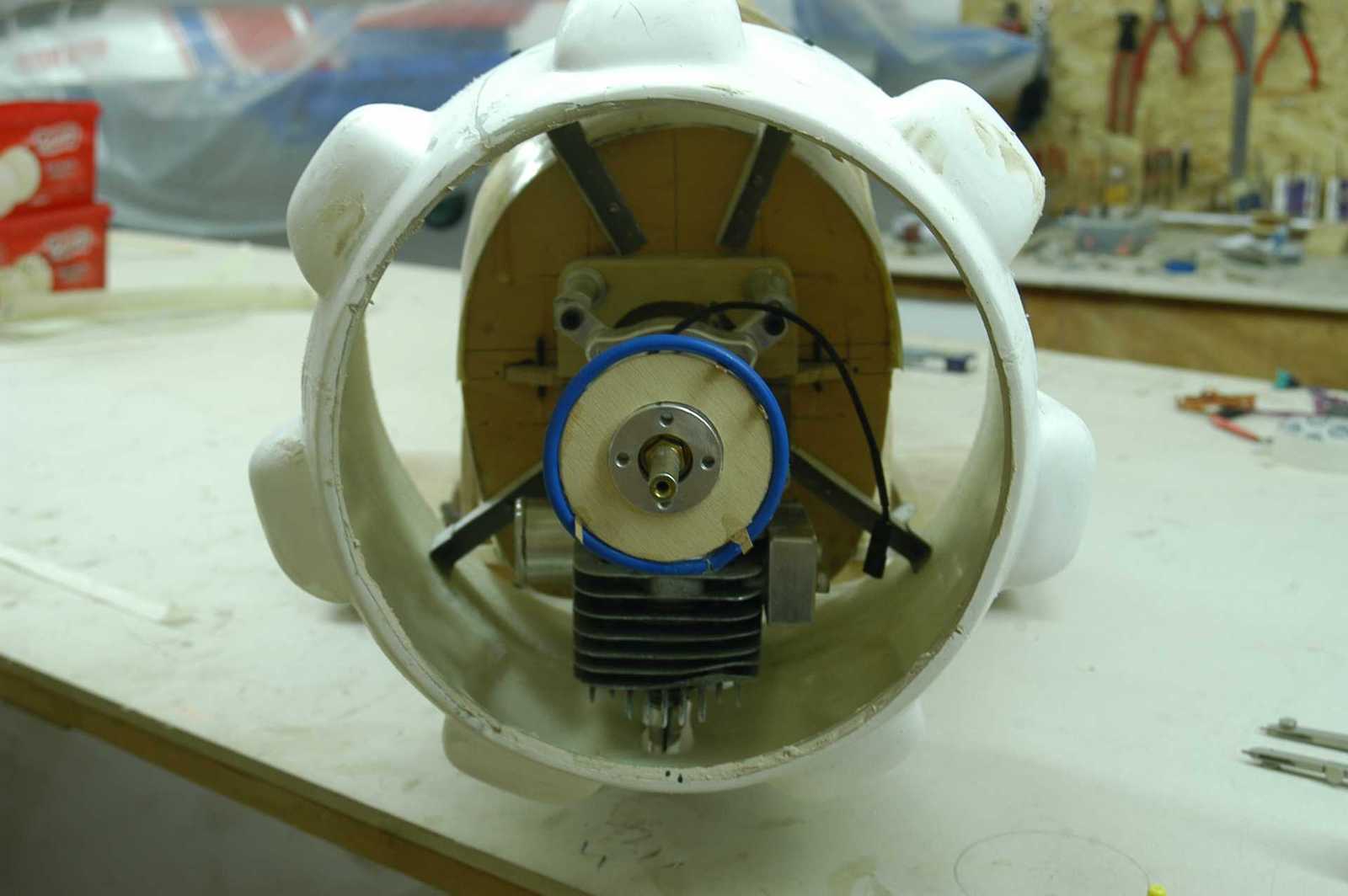

Could not get the cowl off the airframe now that the frame at the front is on, so I have to remove the prop shaft to get it off
So I made a tool to make it easy and quick to whip the shaft off
Rubbed the cowl down and gave it a coat of primer inside and out
Pleased with the outcome

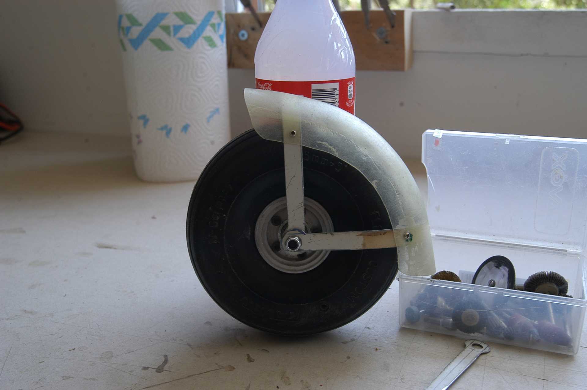

02 Aug 2016 20:37 #113 by THE BLACKBIRD
Thought I would do a bit more on this today, so I got a lid off the old water cylinder casing to make the bracket for the mudguard
Cut the bracket out
And folded it up
Trial fit
Cut it to shape and bolted the bracket to the guard
Thanks: Phil Wood, Klipkopwildlife, boz
02 Aug 2016 20:47 - 02 Aug 2016 20:59 #114 by THE BLACKBIRD
Weighed the fuselage today as I was weighing the Hunter
In it's present state it is 4.2 Kg
[attachment:1]DSC_0020.JPG[/attachment ]
Decided the mudguard did not look right so started again
With a couple of layers on the plug

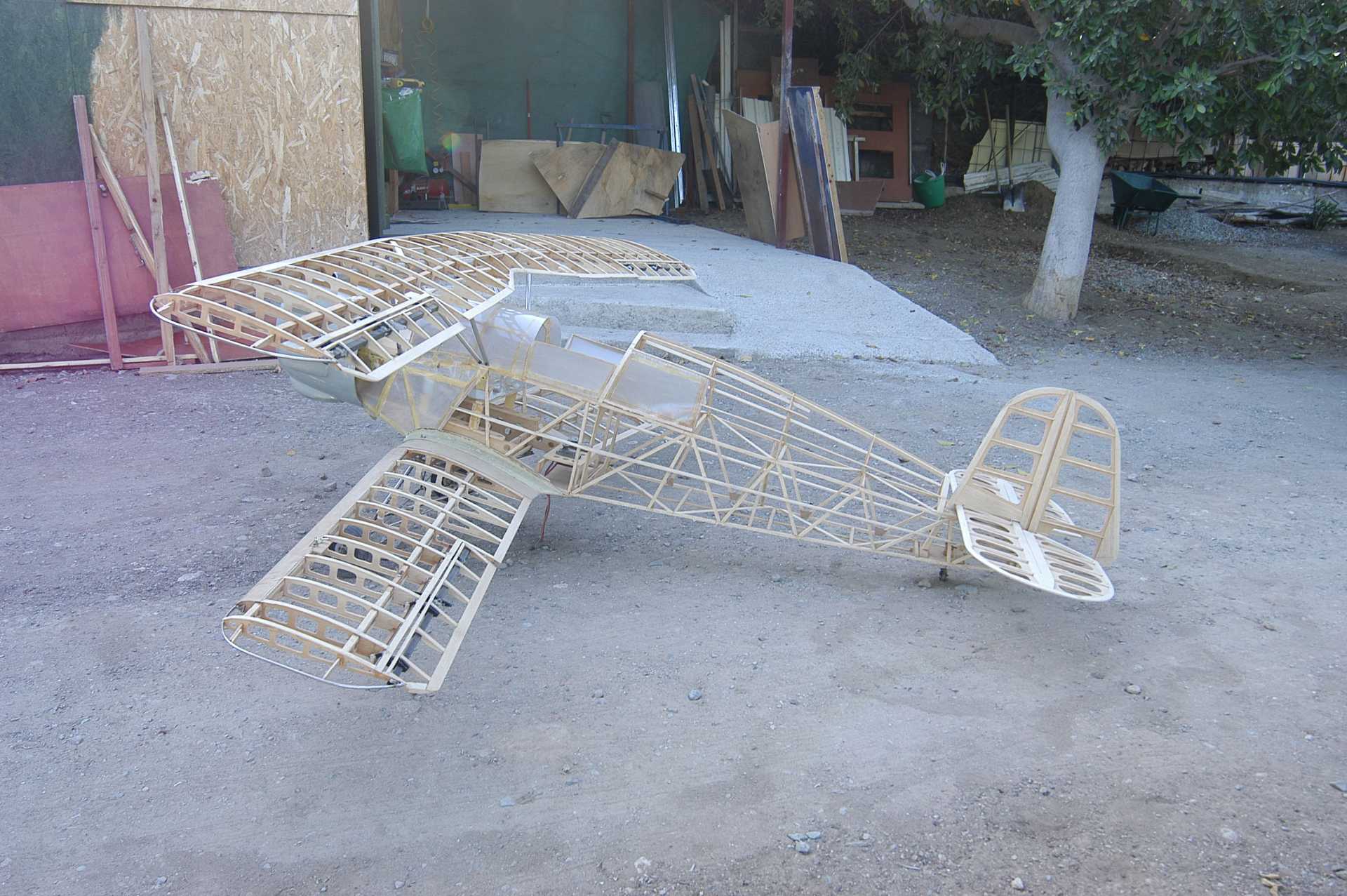

29 Oct 2016 19:29 - 29 Oct 2016 20:34 #115 by THE BLACKBIRD
Thought I would bring this one up to date, not done much at it since July
This last week iv been trying my hand at silver soldering for the first time, did the under carriage in stainless steel tube and 6mm bolts as axles for the 5" wheels

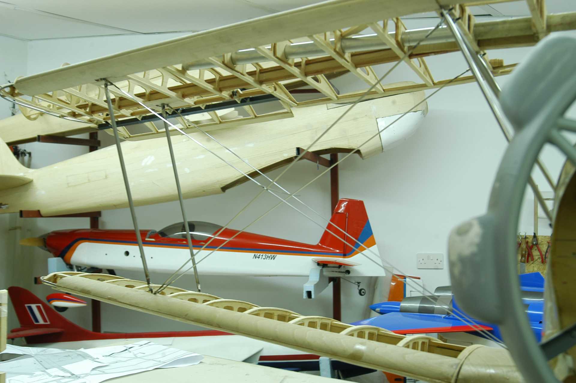

02 Nov 2016 19:56 #119 by THE BLACKBIRD
Got all the rigging wires fitted now, been a fiddly job with all the small fork ends to silver solder on each end of the wires
Four separate little parts to each fork end
connected the ailerons together with steel wire and ends soldered on, each pair operated by one servo as per scale
Was going to make fibre glass covers between tail plane and fin,
But then I changed my mind ill do it with balsa block hollow, think it will be sronger
Thanks: Phil Wood, Klipkopwildlife, Quorneng, Fly-Navy, martynk, boz, Septic
