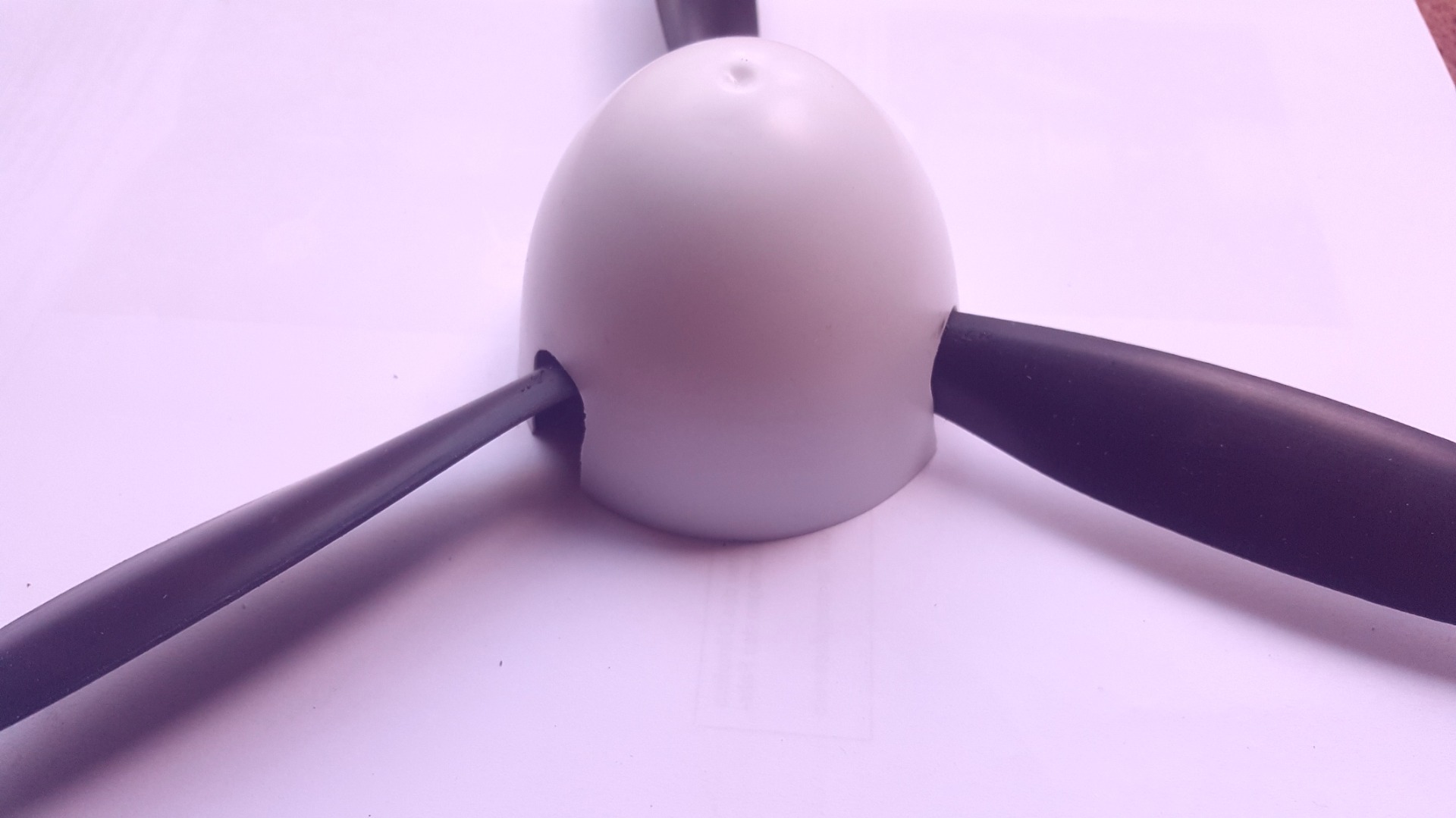

Spent a pleasant morning making the spinners, all 4 of them!
As i'm using Christian Ramoser's Varioprop the hub does not lend itself to adding a scale spinner, well not easily. So I had to come up with a back plate to mount the spinner onto. After several designs I came up with this.
A large penny washer, skimmed in the centre on the lathe to remove the thickness from the contact patch with the hub. This allows more of the hub nut to bite on the 8mm thread. I then designed a 'cup' that would attach to the washer with 3 countersunk 2mm screws and hang past the blades so I could fix the actual spinner onto the skirt of the back plate. I used small screws, 0 size, from Model Fixings to attach the spinner to the back plate. Looks quite scale. This was printed on my Creality 3D printer. All good fun.

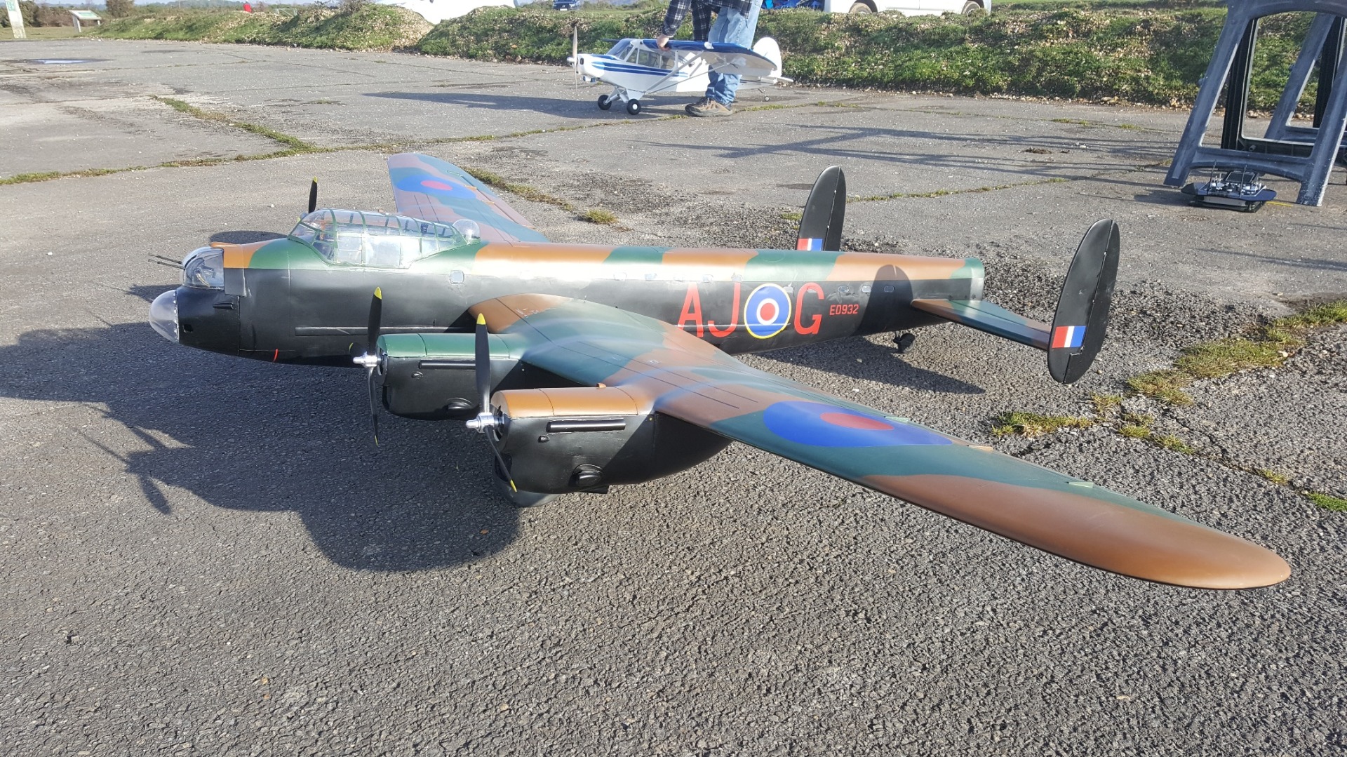

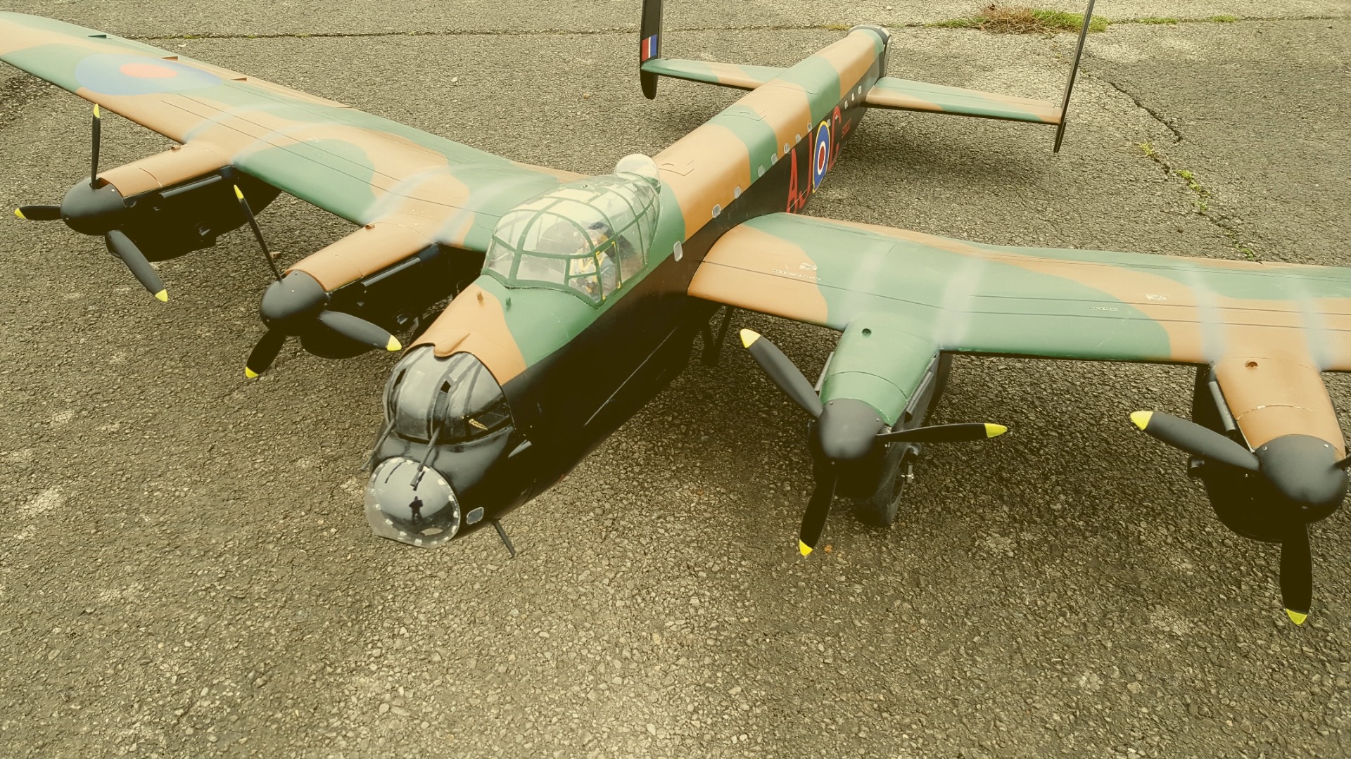

11 Jan 2020 16:05 - 11 Jan 2020 16:11 #150 by Ralpharr2001
Replied by Ralpharr2001 on topic Avro Lancaster 102" Dambuster
Well not good news. The Lanc is no more. :( :(

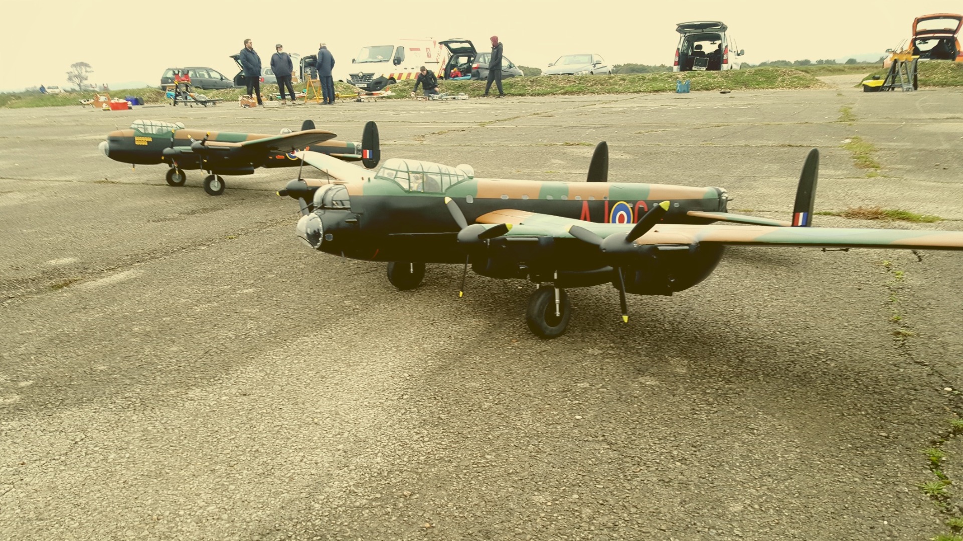

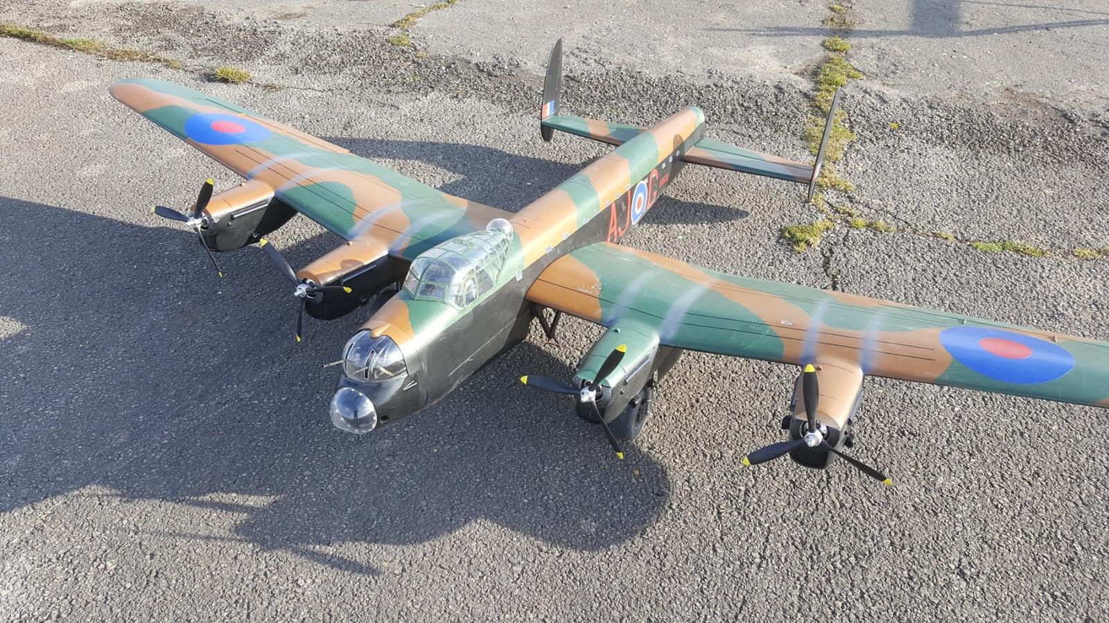

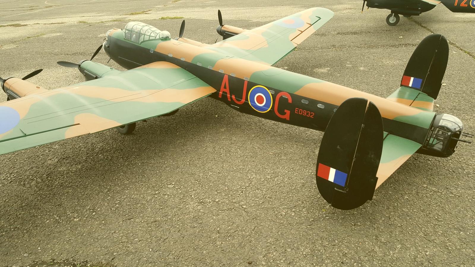

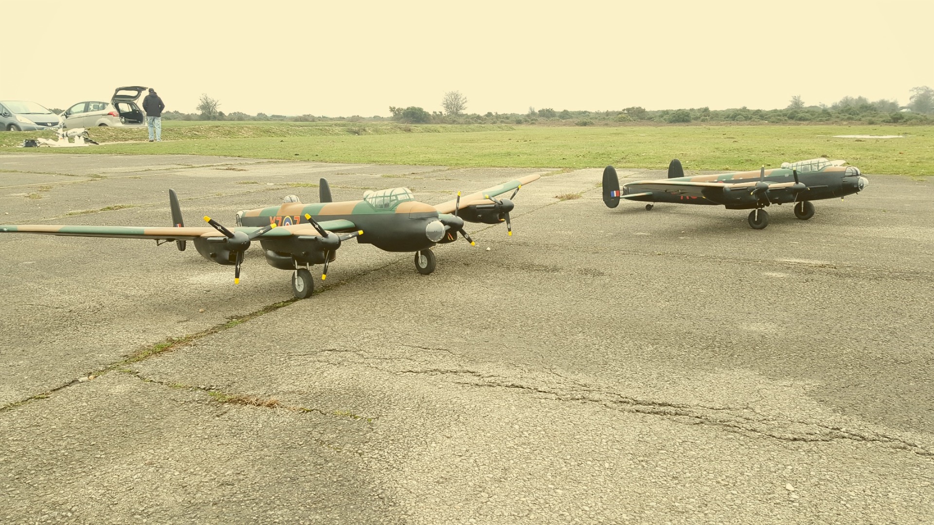

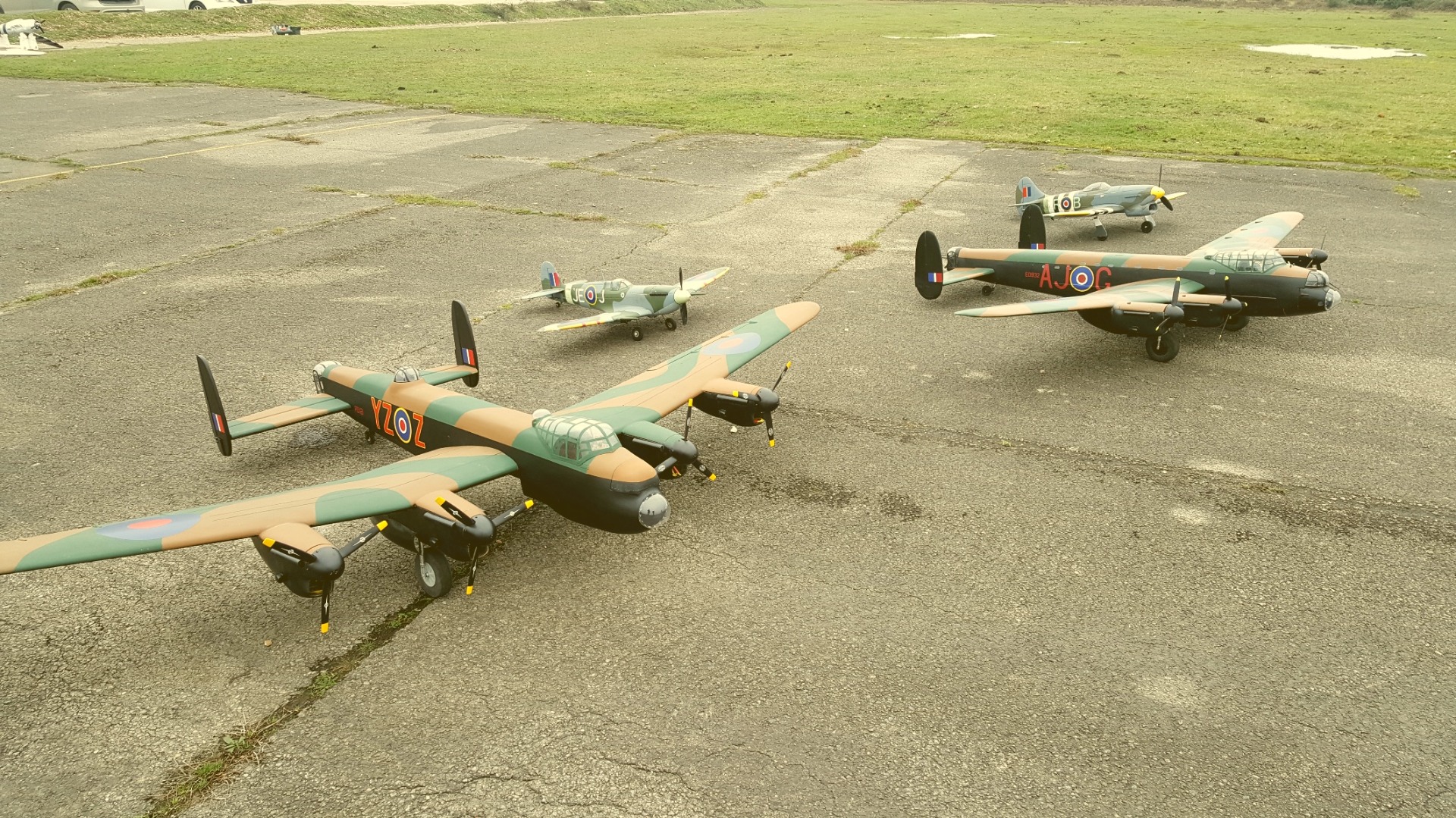

The maiden did not go well. On initial taxi trials a few weeks age she lifted off level and climbed slowly so I set her down again. On the day of the maiden she lifted off and banked severely to the right. Unfortunately I wasn't able to correct the situation and she went in nose first from about 10 feet. Not sure what the issue was but I suspect pilot error in that I let her lift off too early and she tip stalled. :oops:
The damage is quite significant. Only the fuselage from the wing trailing edge back and port wing remain intact. The starboard wing broke in two but is possibly repairable. I would need to remake the fuselage from the trailing edge forwards.
Its only a toy plane and no one died! ;) At the moment I'm not making a decision whether to scrap or rebuild it. I shall leave it a few weeks before making the decision.
So here are a few pictures of the maiden. Two Lancs were built and maidened on the same day. My Dambuster and one by a flying buddy, his was the Tallboy version. Annoyingly his flew beautifully.
Last edit: 11 Jan 2020 16:11 by Ralpharr2001.
