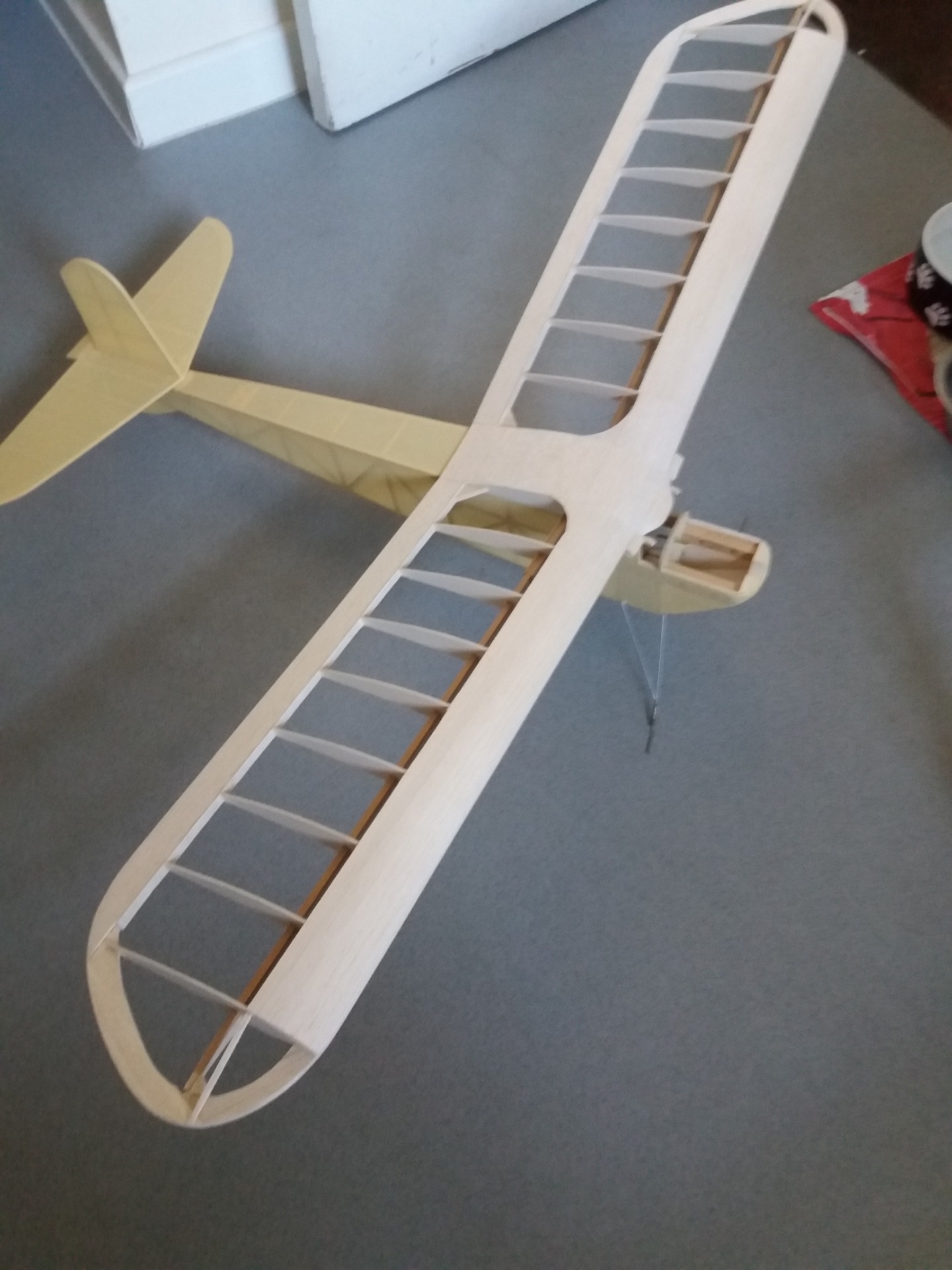

laid up the wing main spars this Morning, plan called for 3/16 x 9/16ths hard balsa, I've used 3/16x3/8 balsa laminated to a piece of 3/16ths square spruce, balsa will be at the top in compression, spruce at the bottom in extension.
If the original j60 had a fault it's that the wings could potentially "clap hands" this mod along with the ply dihedral brace should help.
The ribs only 16th quarter grain sheet with a sheet trailing edge and shear webs, a rather weedy 18th square sub spar with a sheeted (top only) leading edge.

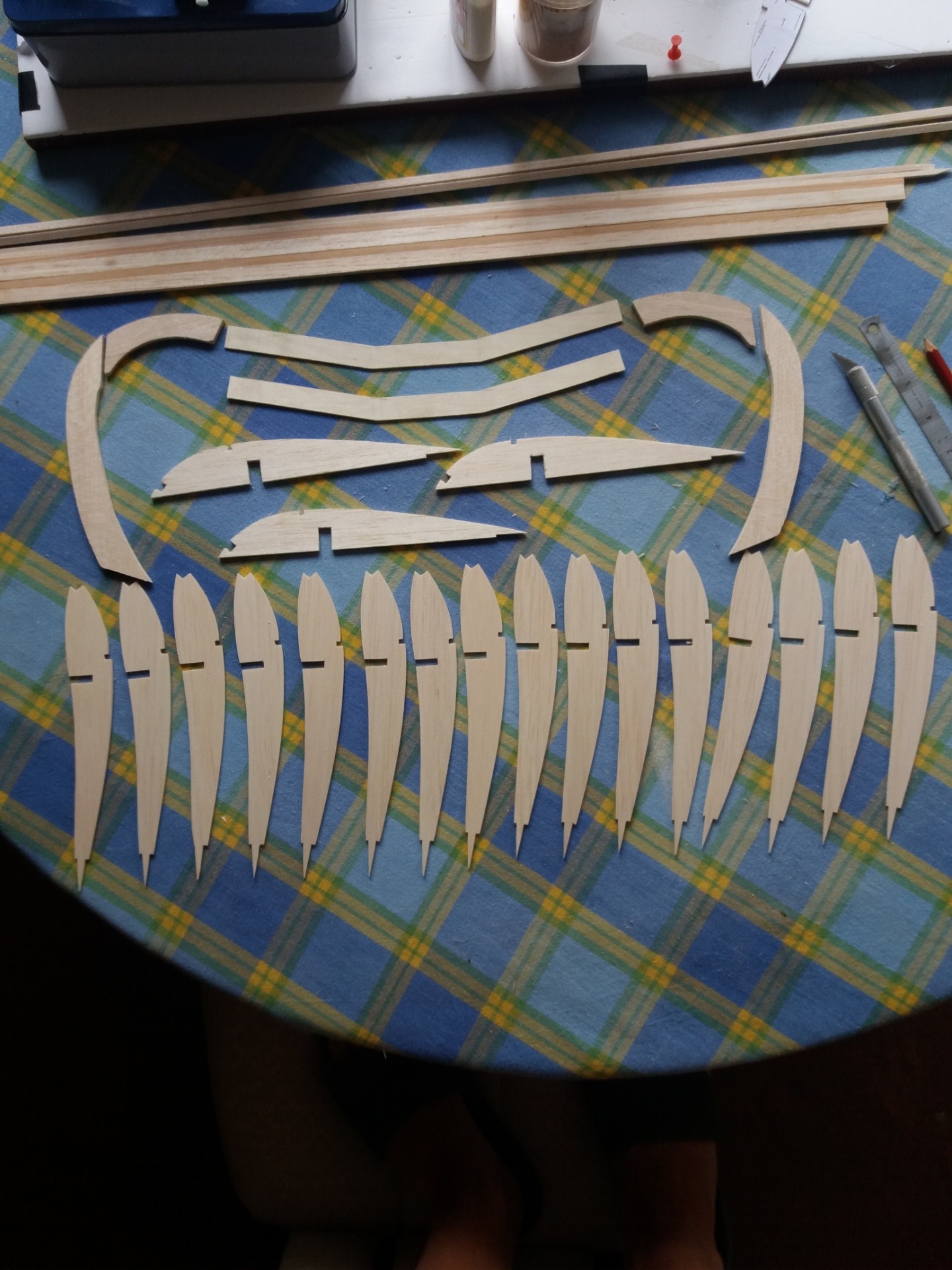

A bit of further progress on this project, wings are now complete except for shaping the root fairing, after Q's comment I made up a test spar and found with the spruce cap strip up it was marginally stronger.

That's better! kit of parts above.

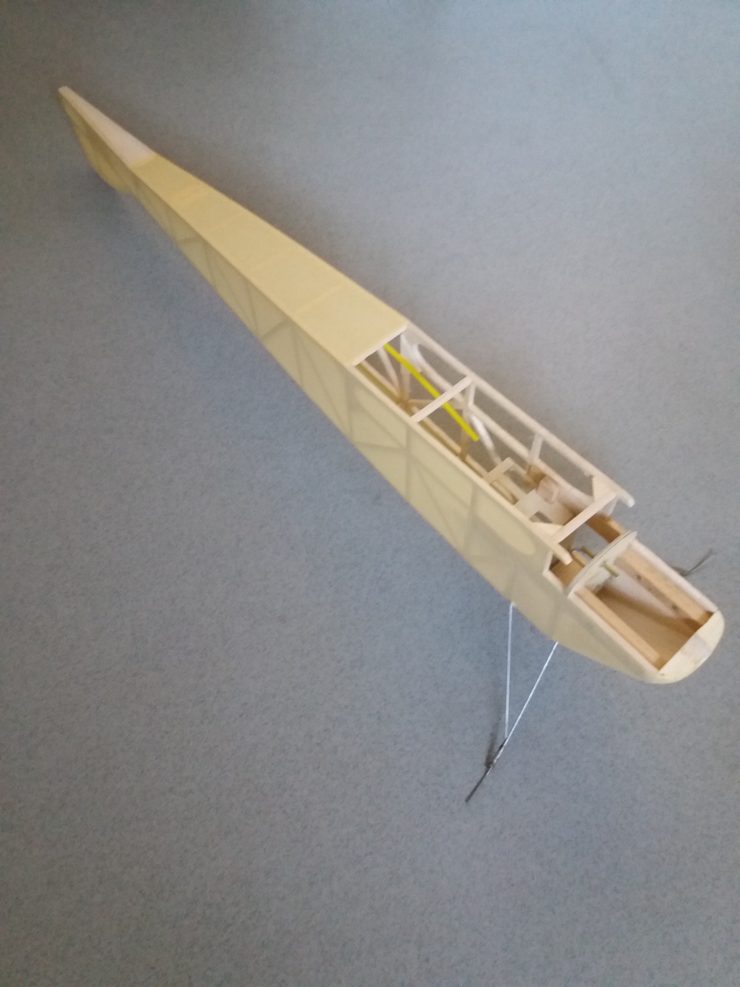

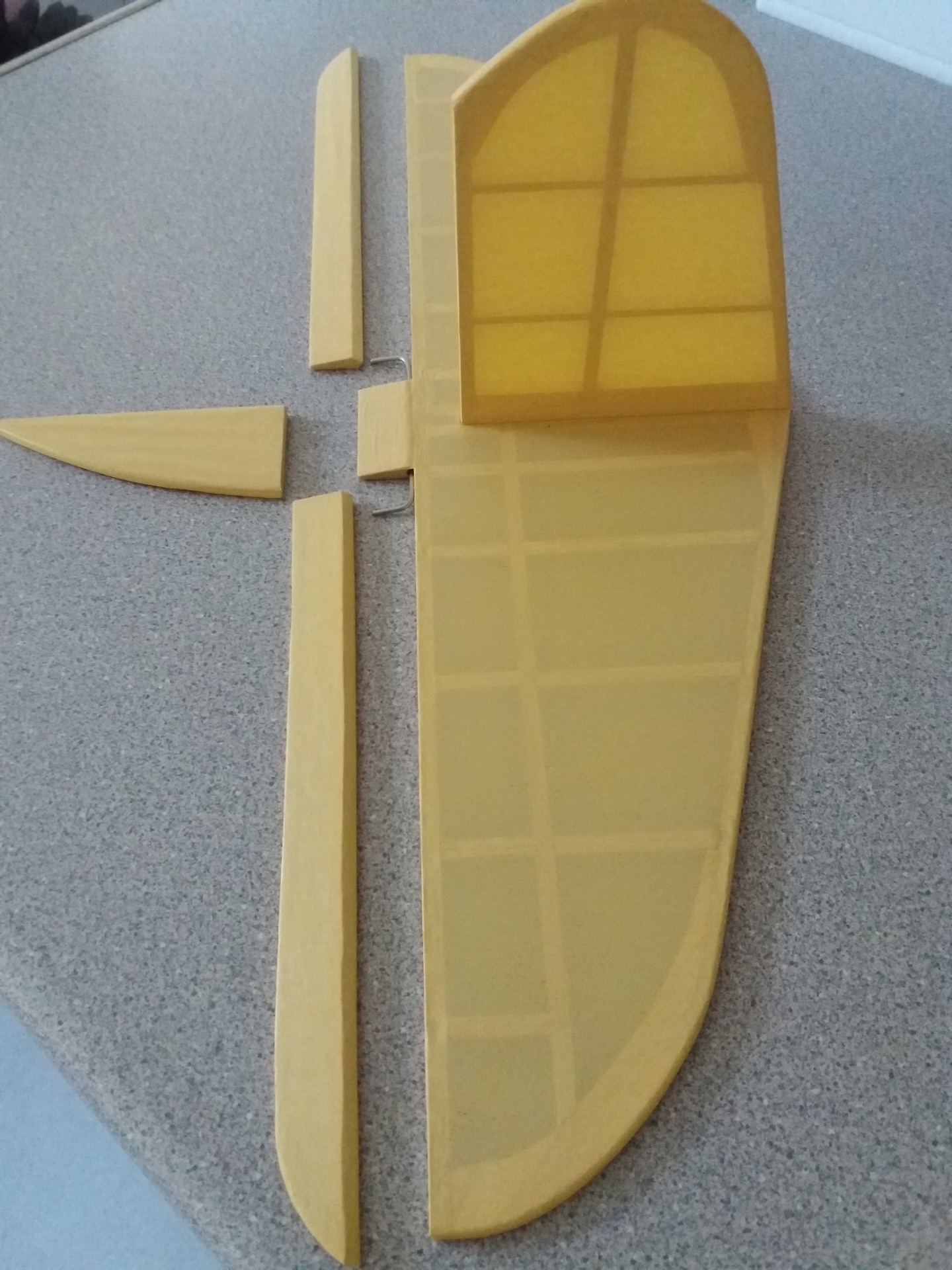

Tail feathers covered and awaiting the hinges.
made a start on covering the fuselage, it's easier to cover the whole side then cut out the window appeture etc.

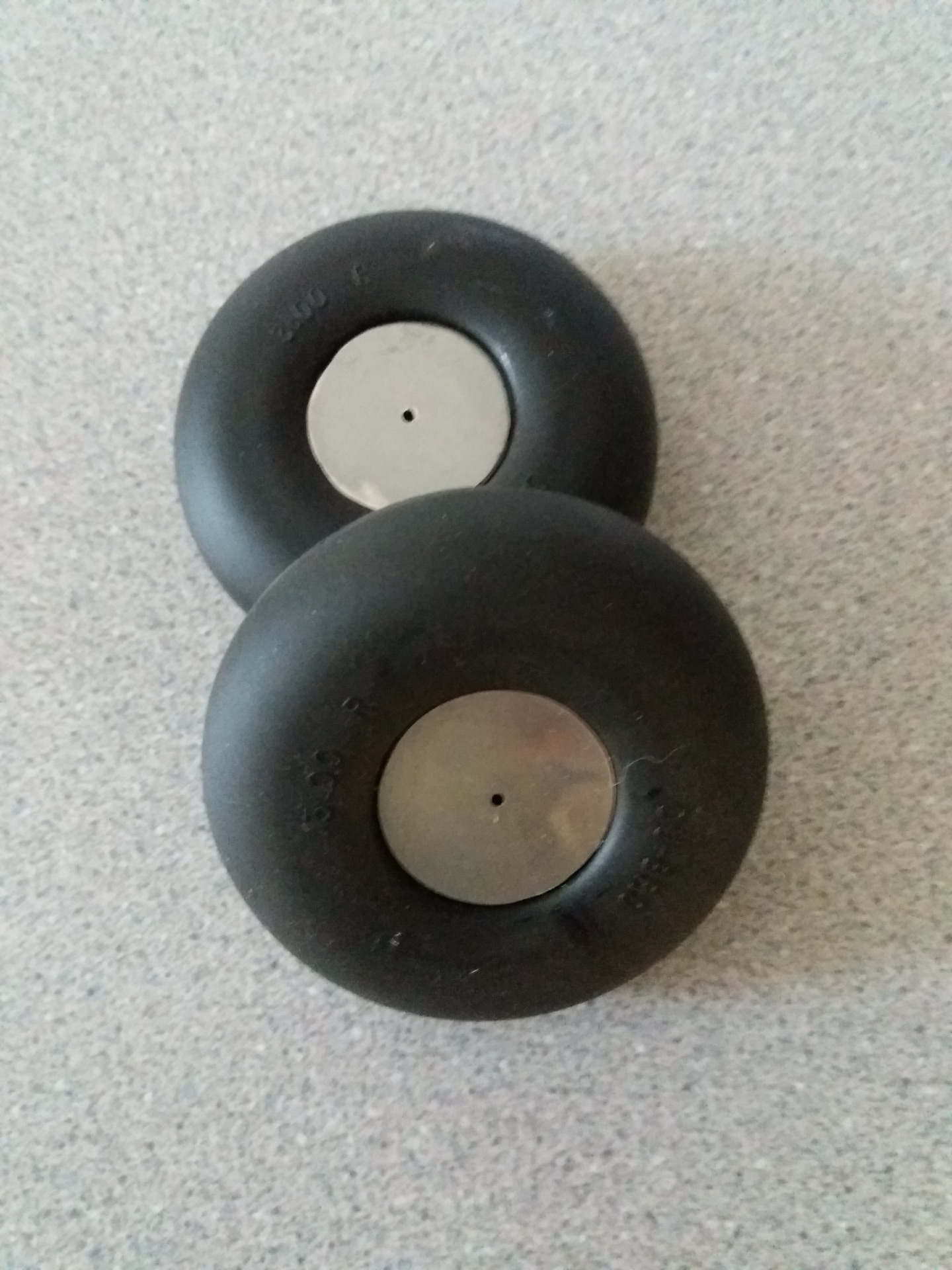

finally I've bushed the wheels to suit and made up the aluminium hub caps.
