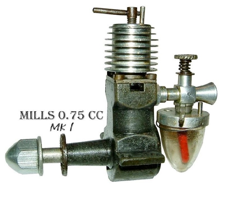

My humble Mills 75 had a air inlet slide on the fuel inlet just below the venturi so it killed the suction.
Not mine (it is a mk2) but the fuel cut off mechanism is the same. You pulled the lever to the stop and two holes lined up to let air in.

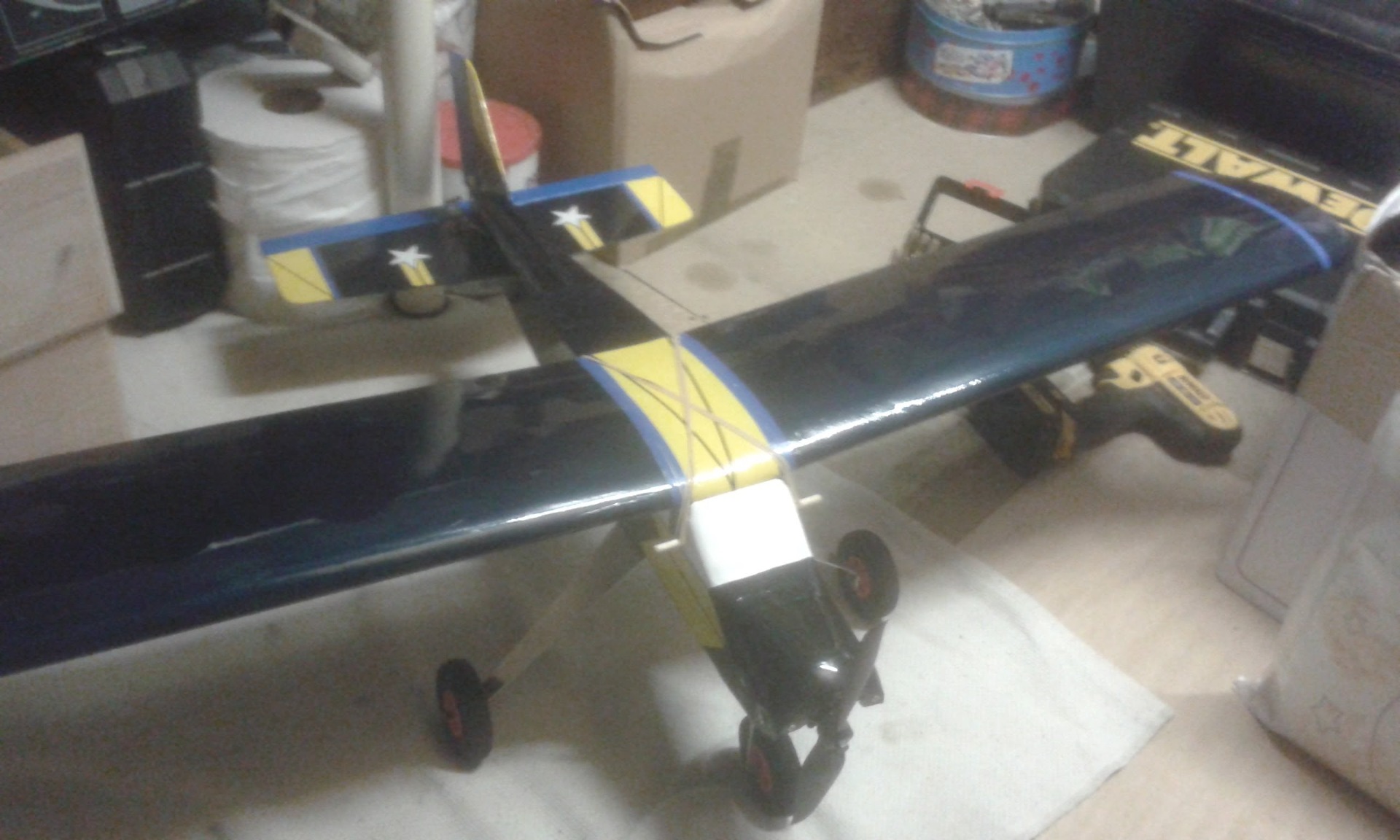

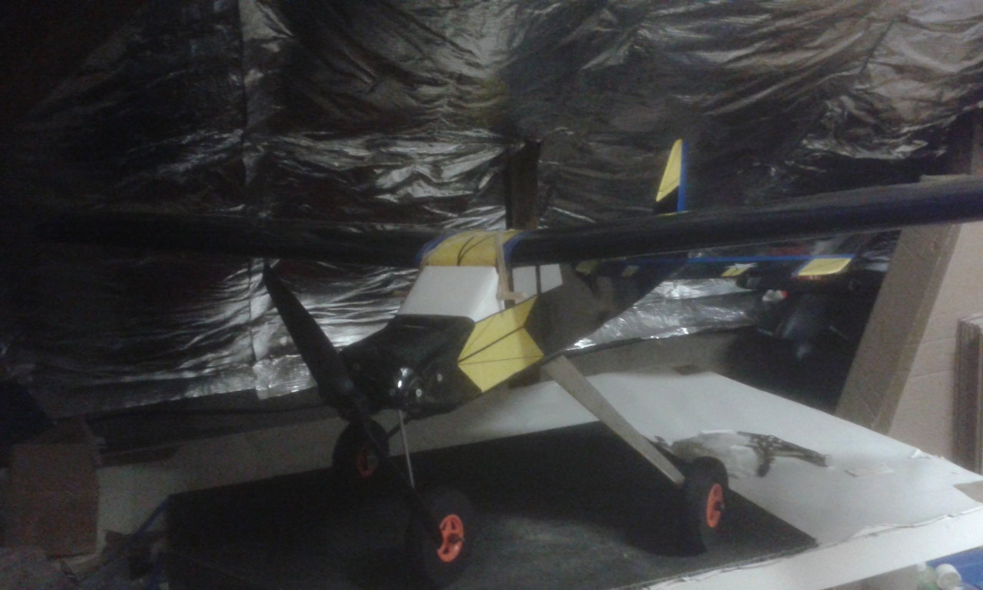

Can't believe it I have an Elf 3 ch trainer I converted it to Electric about 24 months ago. One of the first of my models to fly when I got back into the hobby, sadly it wasn't as easy to fly as when it was an IC model, twist in the fuzz so pulled left quite a bit and motor thrust needed to be sort out. So at the time it was beyond my ability to fly as it was a bit wild and un predictable.
It sadly got cannibalised for parts recently, although I have ordered a replacement motor for it. So when it comes I will rebuild it back to its former glory.
If I get a chance I will find some pictures and post them.
07 Oct 2020 01:45 #7 by Iant90
Replied by Iant90 on topic Winter build
Not sure if this is the same model
you where discussing, but Elf is definately the name on the kit I bought many years ago. Although the model does look somewhat different these days due to mods etc that I carried out.

Ian's model looks more like the KK Mini-Super.

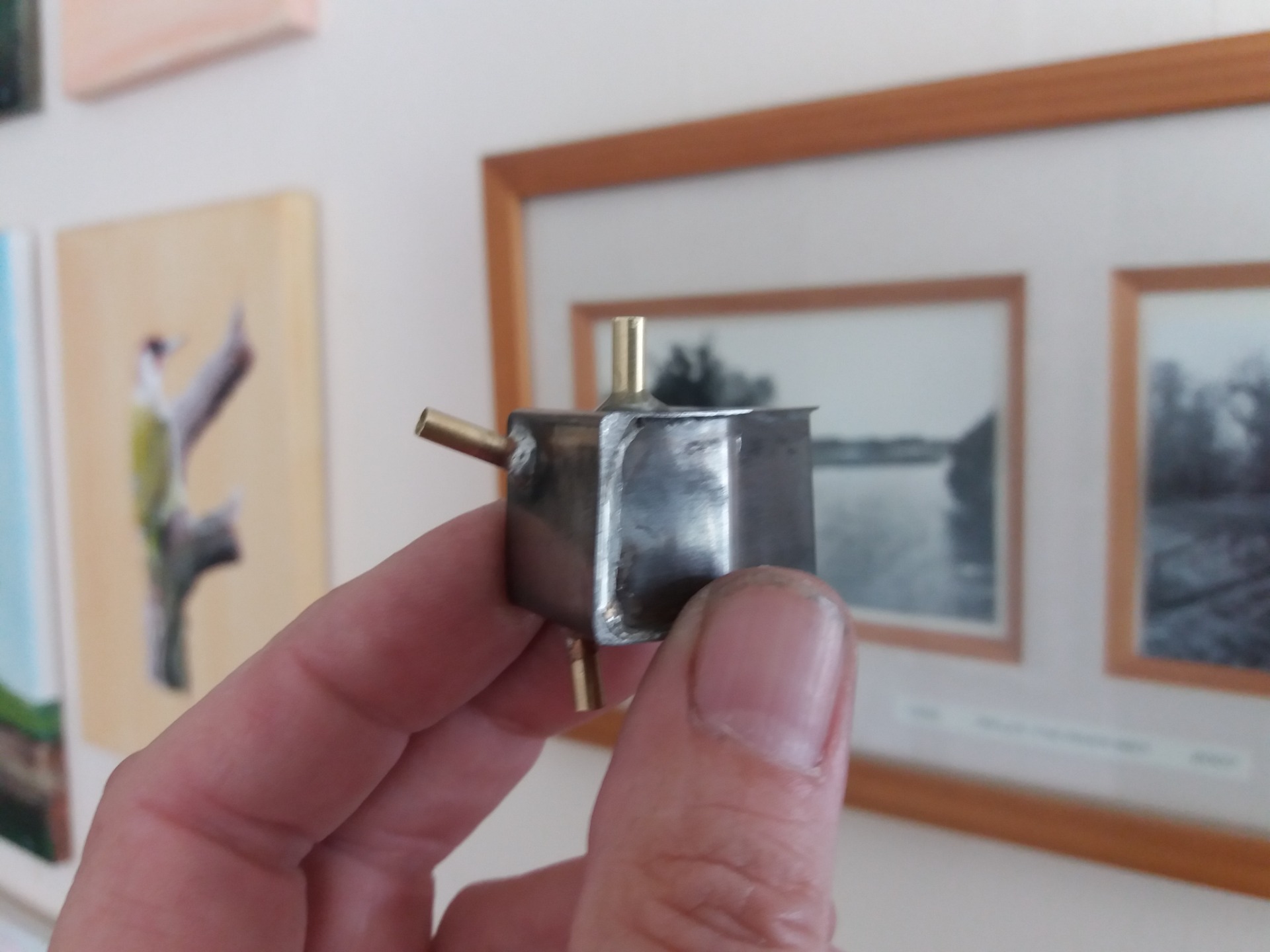

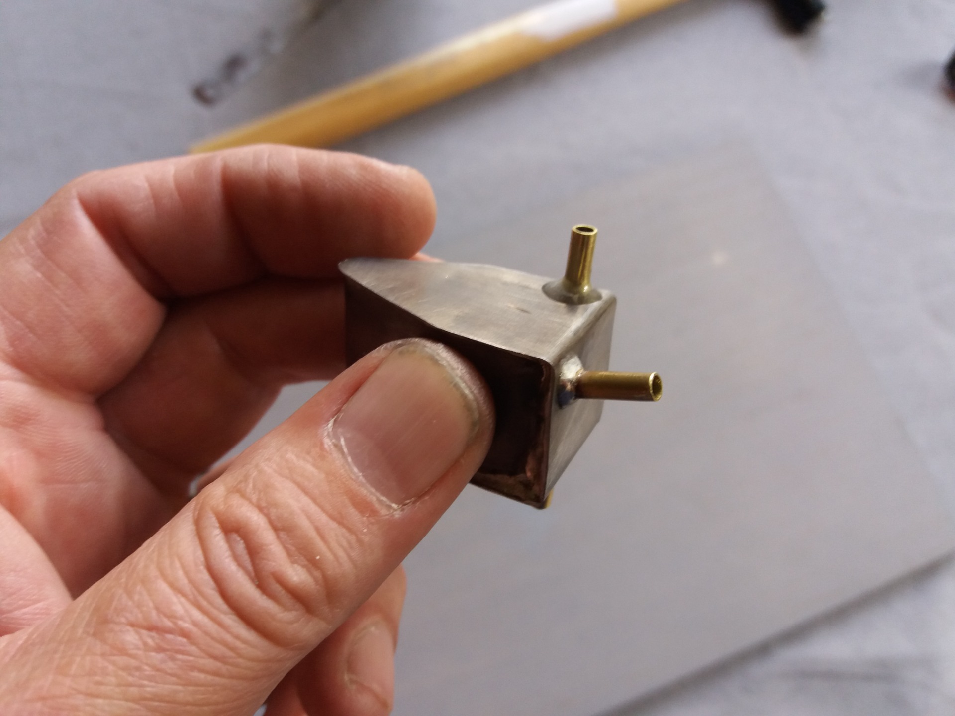

Made the tank today, 10cc, the feed pipe goes to the bottom of the triangular rear, hopefully the climb out will be quite steep so this should give a nice "clean" cut.
I'll time it on the test stand to see what sort of run time it gives as now I've made it it looks to big...

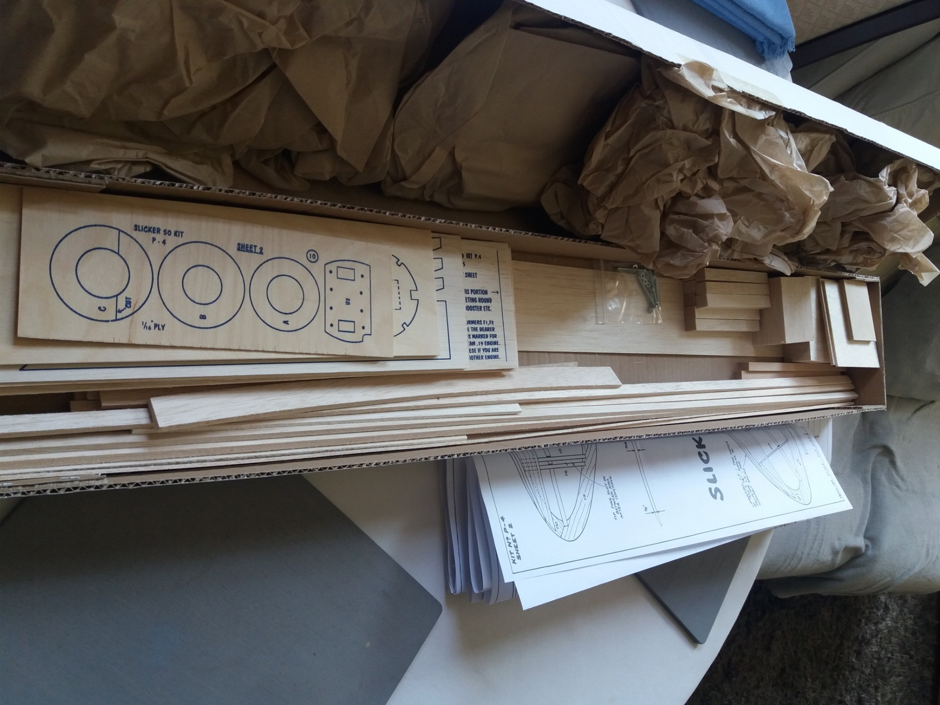

My 'latest' winter build - I've dug another E-glider out of the accumulated pile, and had a look at the box contents.
It's a 100" built-up artf, with the expensive bits like motor, prop, speedo, servos - missing. If I could read Chinese it might say what size motor is expected to go in, but - - the servo's - I'll see what I've got that fit the holes!
The transmutilation of the instructions is a laugh - it's a good job I've an idea what goes where, but I'm totally baffled by some of the words - for example, what's a 'zoster'? And why does an electric model need a plug-spanner and a carburettor?
or -
Tight the stabilizer (vertical fin) and elevating (rodder) rudder with the hinge, Elevating (rodder) rudder can move for free. Otherwise, you would not control the model and may have accidental during the flying.
