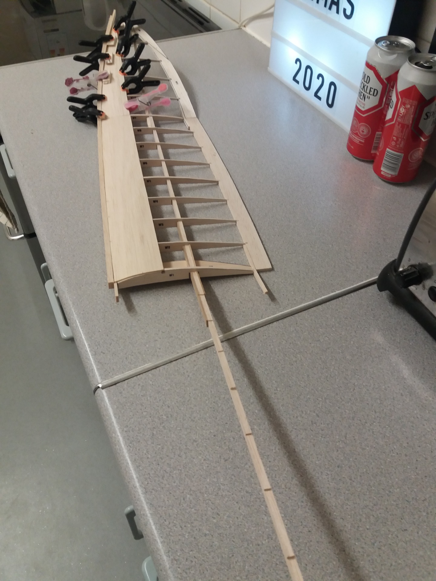

ok it looks a little rough and it's not even half built but there's at least something to show, I didn't mention before but it's actually a one piece wing, no building separate panels then joining them, I've discovered a long tapering multi angled spar isn't the easiest thing to work with! the centre panels taper on the top surface only but the out panels taper both sides....and have a little washout and it's all undercambered!
glad the interlocking design allows it to be dry fitted before committing to the glue.
when it's finished I'll take some close ups to show the details a little better.

What sort of problems were you having with the spar Paul?

Main problem is knocking it while working on the other end, took a age to make!

I'd be interested in the process when you have the time?

I think Paul did mention that it was a composite spar, as recommended by Andy Sephton. The way I see it, if you're going to have a twist in the spar to get your washout, the only way to be sure of its integrity is to build up the spar (ie composite). I'm also very interested to know how you did it Paul.

Firstly let me mention the plan doesn't call for washout but I've incorporated it after witnessing the effect of it with my caprice glider ( once the motor stops it is after all a glider!) The caprice would, got made a stupid offer for it so I've now sold It, fly at ridiculously slow air speed.
The way I've done it is to attach the ribs with the spar "in the air" before propping the inner panel up at the appropriate angle and packing the root rib of the tip (at the spar only) to 3/16 , this allowed the tip of the spar to just touch the board, I then moistened the spar and attached the trailing edge, again that's notched into the ribs, with 3/32 packing under the t/e of the last rib and it's l/e on the board it allowed the spar to gently twist, with the laminated leading edge glued and pinned into place it effectively locks in the twist.
Apparently when flown as free flight it was quite common to incorporate wash out on one panel and wash IN on the other to encourage the model to climb in a spiral!
