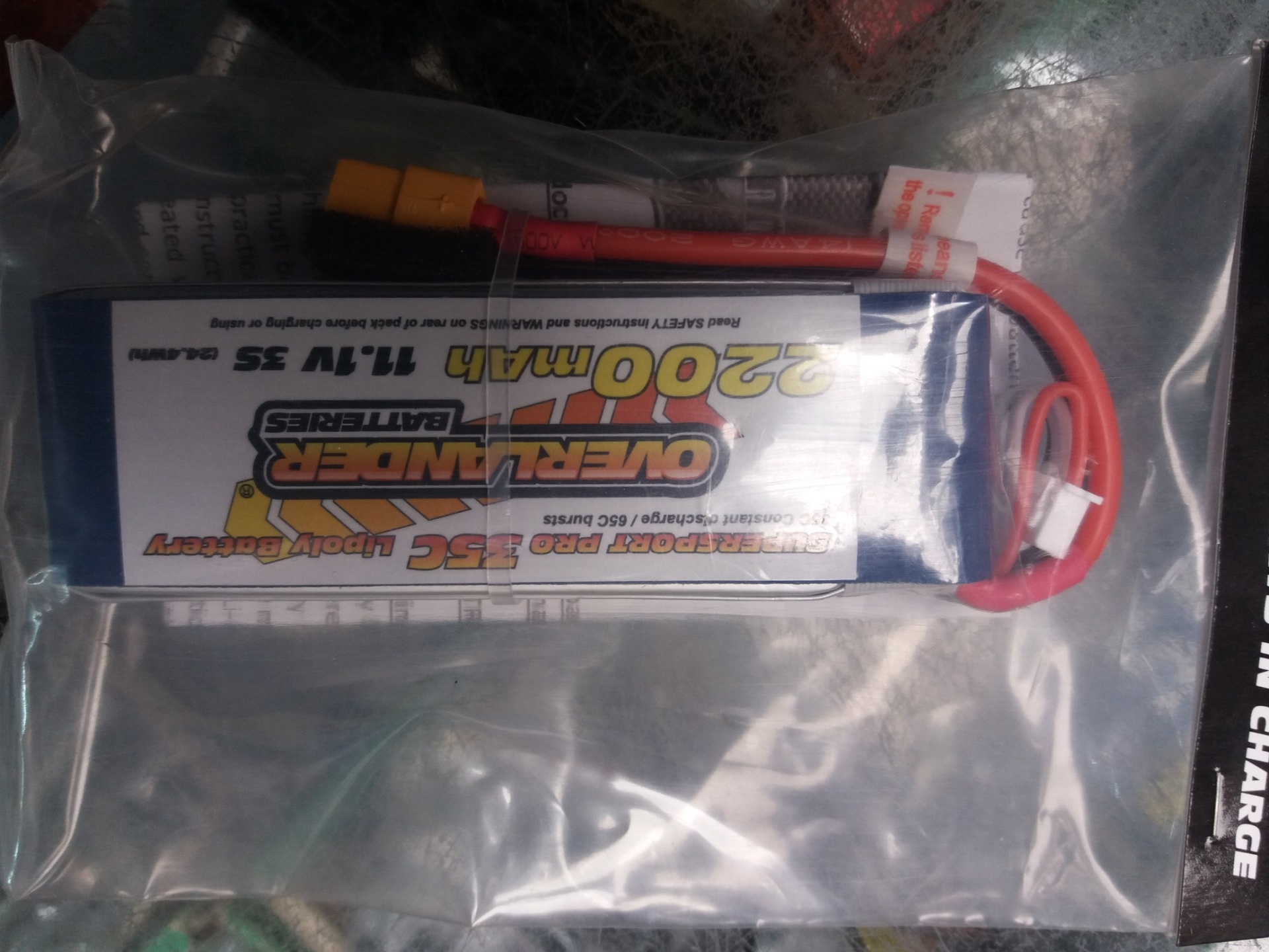

Eric, would you like me to check in the shop today? fairly sure "we've" got 3s in stock??
  • paul d
24 Oct 2020 09:46 #21 by paul d
Replied by paul d on topic Winter build
yup! got three.

I do like that Overlander stuff.

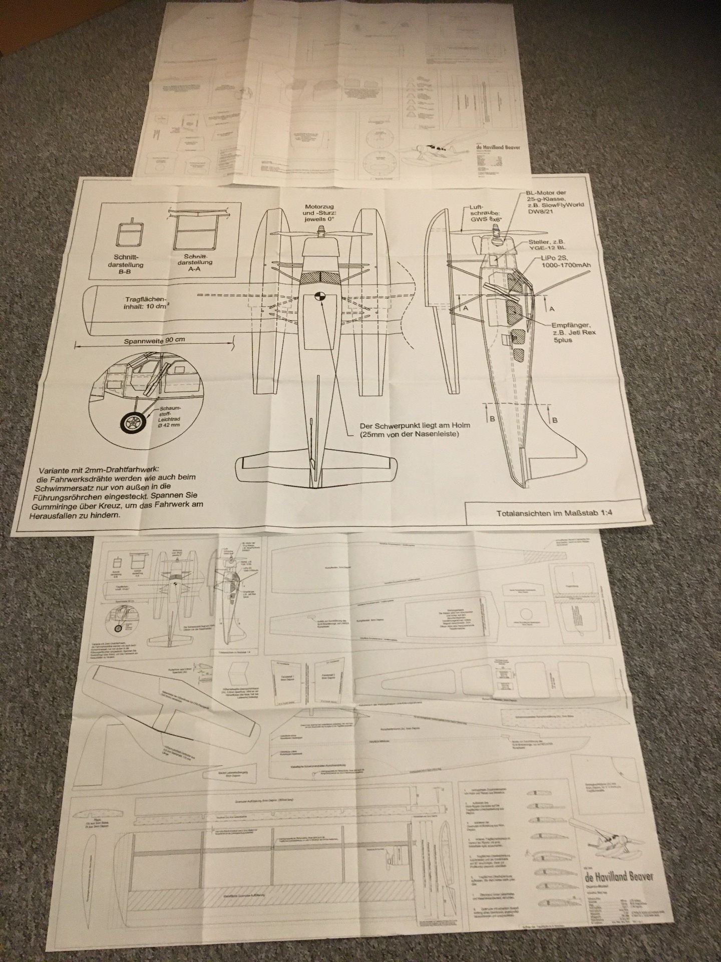

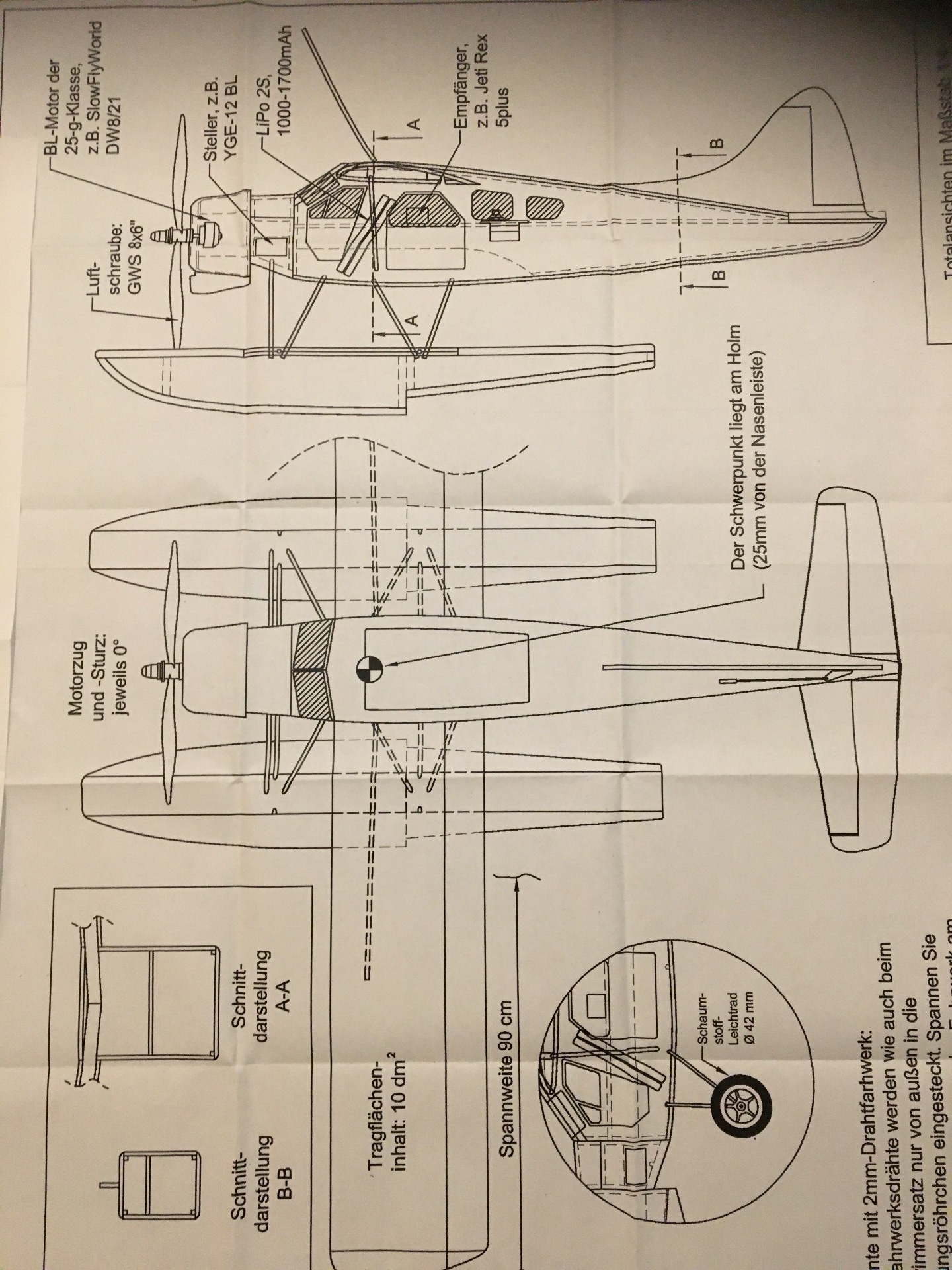

I bought a box of mixed motors & ESC's for a very reasonable price last weekend. In amongst all the paperwork that came with, I found this.
I think I might have found my winter build. I will have to scale it up a bit, & working to plans is going to be a novelty !:whistle:

Ah, DH Beaver, the flying truck!
If you can get it in, it can carry it! (the full-size, that is!)
