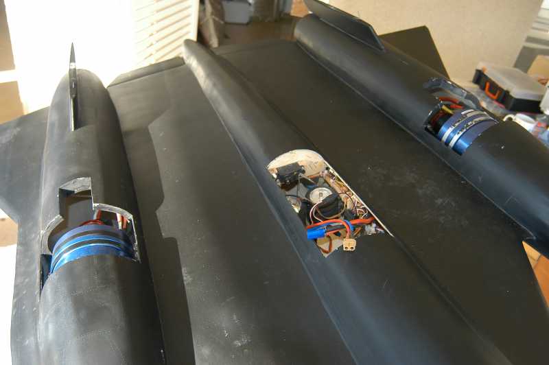

19 Sep 2012 00:30 #202 by THE BLACKBIRD
Replied by THE BLACKBIRD on topic Re: SR71 BUILD - The Blackbird.

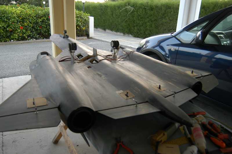

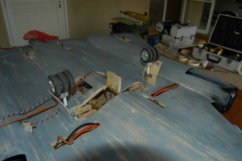

Well i have got it back on the bench to make a start
I found that one of the snakes to the aileron has snaped off where it joins the quick link
So that has decided me to fit the servo's into the wing and get over the problem of not being able to hide them inside the wing
Been fitting the second fan /motor and esc, renewed the silicon wire with 8 gauge and am changing all the connectors
I ran both engines together for the first time but only on 6s 5000 lipo's each everything was ok
So to push on and get it to a flying state

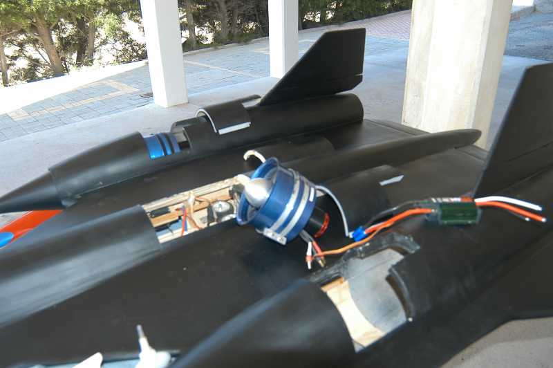

22 Sep 2012 01:59 - 22 Sep 2012 02:02 #203 by THE BLACKBIRD

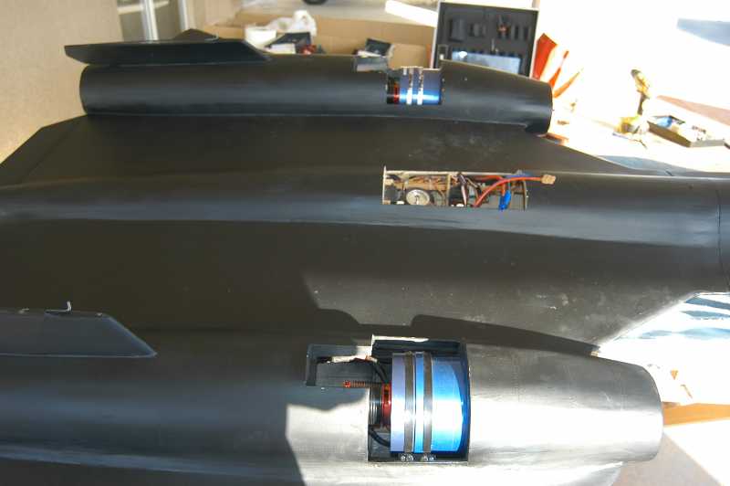

Spent the morning rewiring the run from the lipo's in the fuse to the esc's in the thrust tubes,and makeing the connections to join the lipo's to make 12s.
Then this afternoon i ran the motors at full throttle (had the fire extiquisher ready) on 12s
it was pulling 13.7 kg,
The motors were very warm, the esc's were cold and the lipo's were warm, but very please with
the outcome, fist time i have run both motors in there on 12 s :P

24 Sep 2012 23:43 #204 by THE BLACKBIRD
Got to work on the SR today moved the servo's near the controls so now have short pushrods and no flutter :P

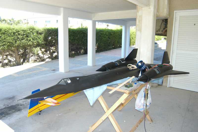

26 Sep 2012 23:31 - 26 Sep 2012 23:32 #205 by THE BLACKBIRD
Off flying in the morning, taking the jet, my fun fly thingy, a heli and the SR71 been working on it all day and i believe it is ready to fly :unsure: :huh: :dry: :S :whistle:
Dont intend to fly it just to have some ground trails with both engines and to see what speed it will reach, i think it is going to need to be fast on the take off run to get it unstuck, who knows it may do a hop.

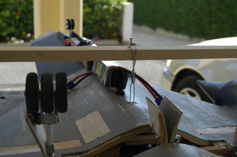

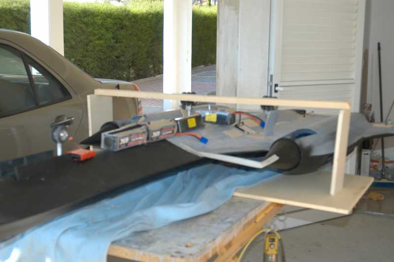

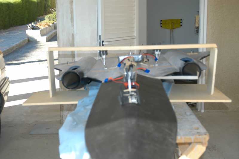

I balanced it as near as i could but the wind was catching it, i came up with a simple balance rig
Very pleased with the balance of it came out about where i wanted it to,only because i move the servo's to the back, it balanced laterally as well, just got to jiggle the receiver battery to get the balance right
Going to have to rethink the undercarrage secondery doors, they work but i want better so they will be done if it flys

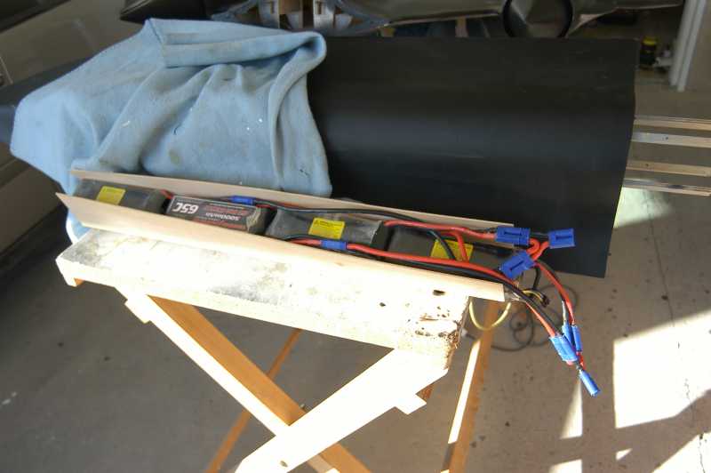

26 Sep 2012 23:41 - 27 Sep 2012 17:12 #206 by THE BLACKBIRD

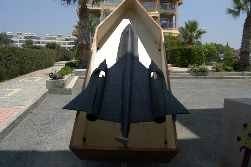

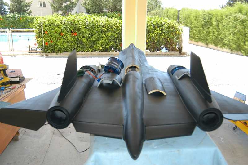

Made a tempory lipo box for itso i can slid the 4 6s 5000 65c lipo'sinto it one after the other through the hatch for the receiver and other gear
Then Natalia thought we should have some pic's before it go's to the feild, dont think she is very confident it is coming back, IN ONE PIECE. :P :P :P

28 Sep 2012 00:31 #207 by THE BLACKBIRD

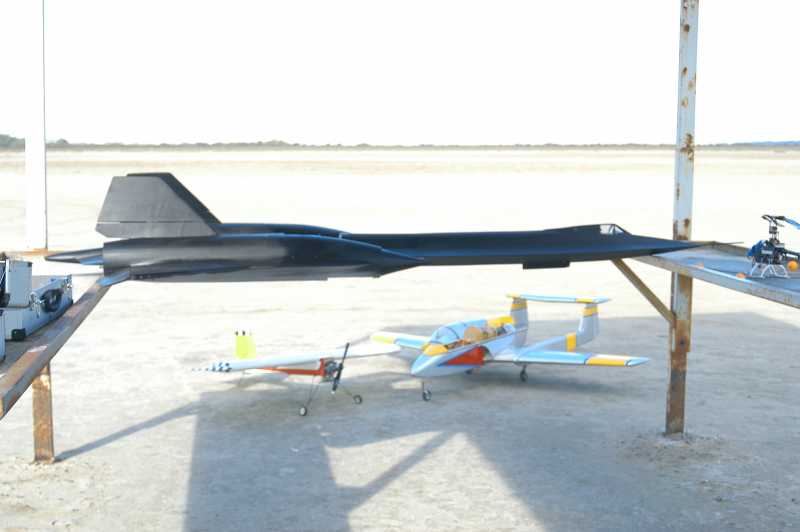

Gave the Blackbird some ground trials today, fired it up on both motors and had three quick runs across the sand then gave it full throttle and then full up elevator and it stuck to the ground like glue !!!! i know i have to mix in the ailerons with the elevator for lift off, but thought it might lift it's nose.
I also have to alter the nose leg make it longer somehow, i think its lower at the nose so the faster it go;s the more downthrust effect it has,
It seemed to have good speed so get the angle of attack sorted it should lift. :unsure: :unsure:
It also needs some better wheels on the nose leg, while filming i lost some control and swerved it and the tyres came off
I was on my own but filmed it while trying to control it not a good idea, if i can find a way to load them on the comp ill post them

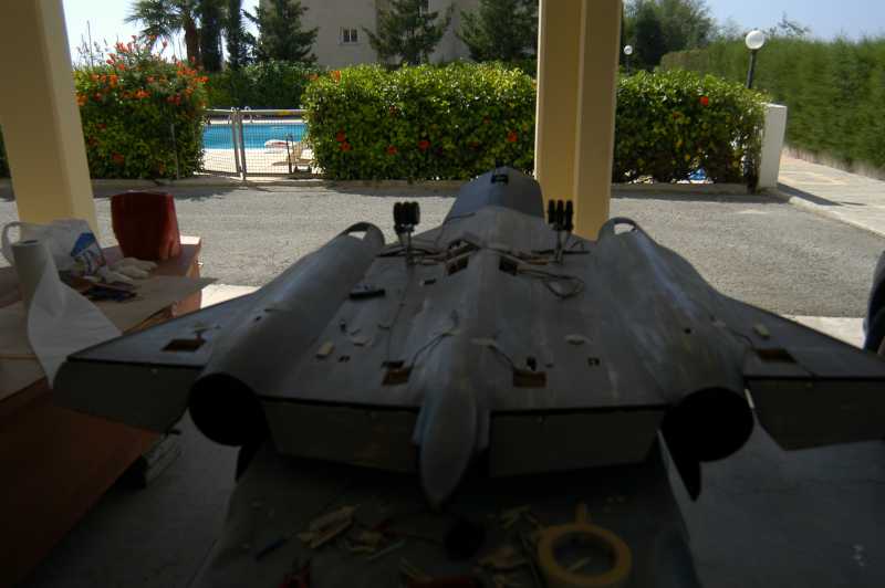

A couple of stills
