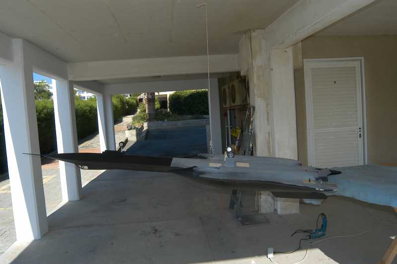

22 Nov 2012 00:47 - 22 Nov 2012 00:48 #236 by THE BLACKBIRD
Replied by THE BLACKBIRD on topic Re: SR71 BUILD - The Blackbird.
Also checked the ballance again
Tail heavy before the lipo's go in
With the lipo's sitting on the underside of the fuselage in the position they go in it balanced spot on
also lateral balance as well

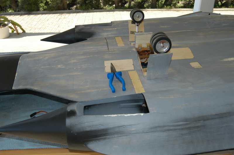

22 Nov 2012 12:47 #238 by Klipkopwildlife
Replied by Klipkopwildlife on topic Re: SR71 BUILD - The Blackbird.
Just a thought Tony, that CoG looks very far forward to me. Knowing you it'll be spot on in terms of the plan! Have you tried a recalculation on one of the better CoG calculators?
Awesome work though, rock on!
22 Nov 2012 12:51 #239 by THE BLACKBIRD
Only if im competing, i told the guy's in the control line aerobatics that i would come back next year and kick there arses :P
But maybe a 40 year absence is to much, Mmmmmmmmm still think i could do it though :lol: :lol:
22 Nov 2012 12:58 - 22 Nov 2012 12:58 #240 by THE BLACKBIRD
Hi Klipy it is spot on with the plan but the plan has had so many errors in it i dont know
The C/G on the plan is where the main wheels should be if true scale
Where i have placed the pliers is where the C/G is and that is where the wheel should be they were moved back on the plan for better ground handling
It would deffinately take off better with the wheels on the C/G
Last edit: 22 Nov 2012 12:58 by THE BLACKBIRD.
