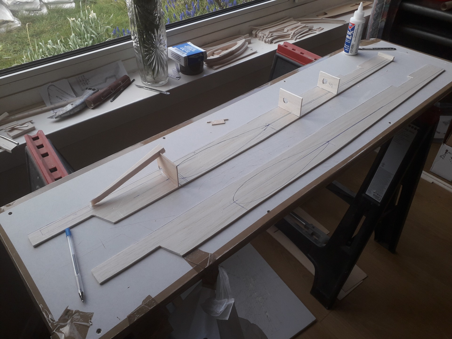

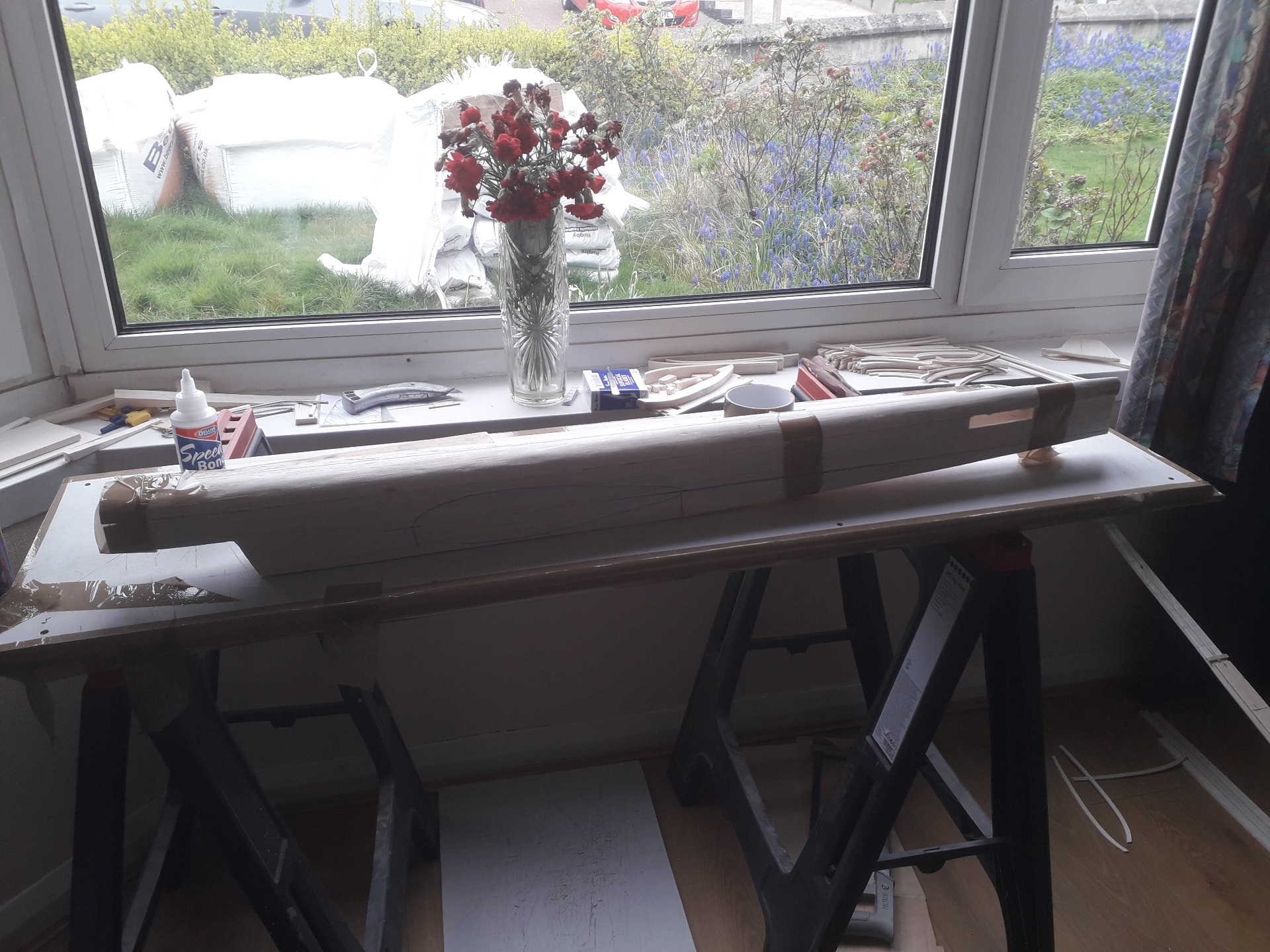

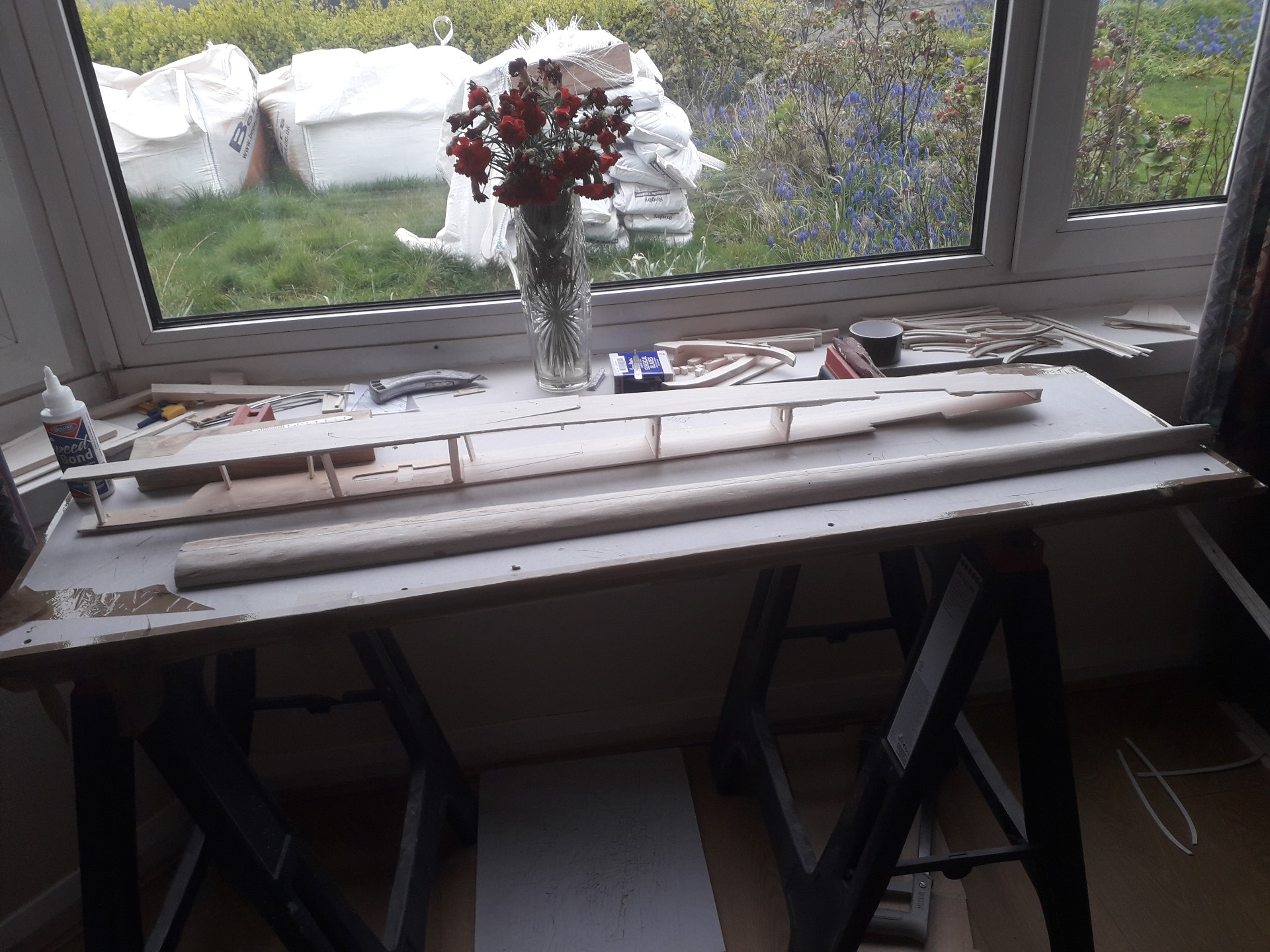

Cut out fuselage sides from 3mm balsa with 2mm ply doublers
Added the 3 formers
Built the tail feathers, they need sanding to shape
Added the top block, again needs sanding
