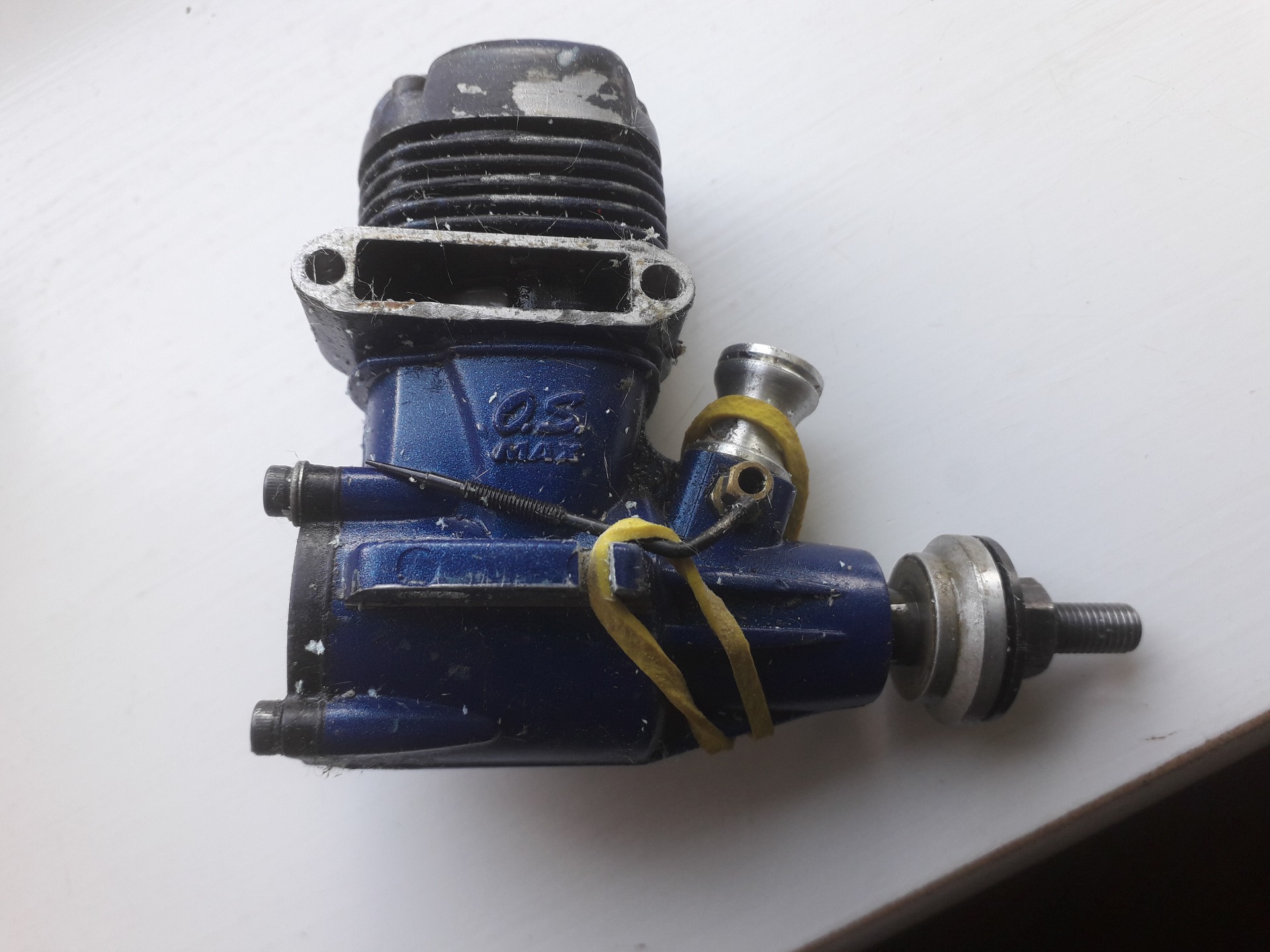

Had this turn up this morning
It came from a stunt flyer who i used to compete against 50 years ago, he has flown iin stunt comps all these years, still enters the Nats
He gave it to me, thanks mate

What a pretty engine.
