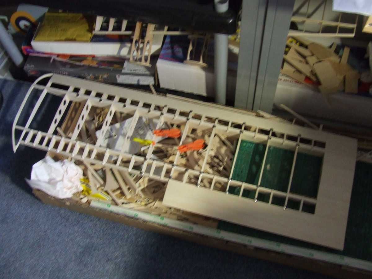

well had a good day but not much to show for it.
riblets all done on both wings.
inner sheeting done on the tops of both wings and leading edge sheeting done on the top of one wing.
need to do the l/e sheeting on the underside of the first wing tomorrow and then start the sheeting on wing two.

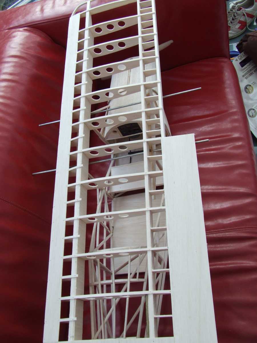

Bit more sheeting going on, slow job though.

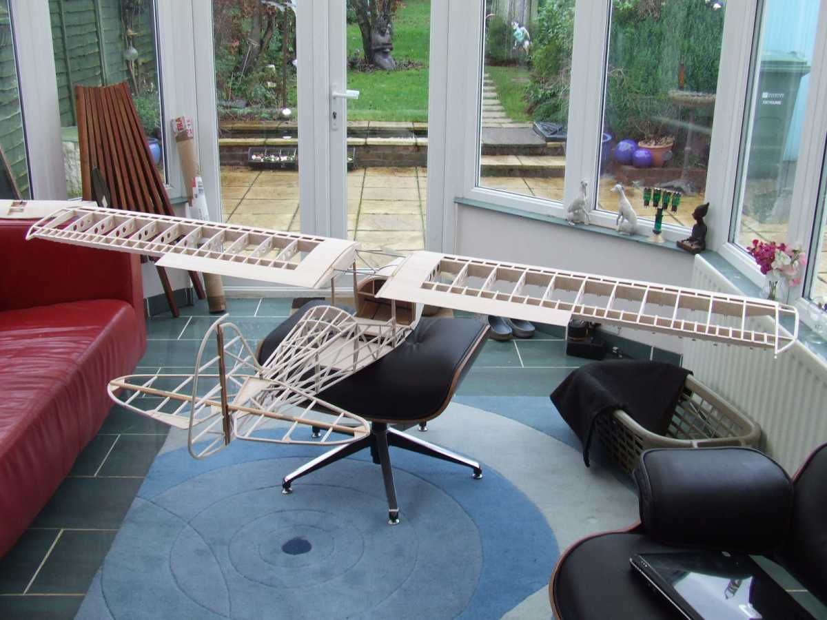

42" for each wing panel. so about 93" wingspan.
yes not a small indoor model.

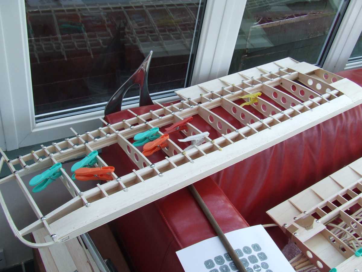

still doing cap strips. :P

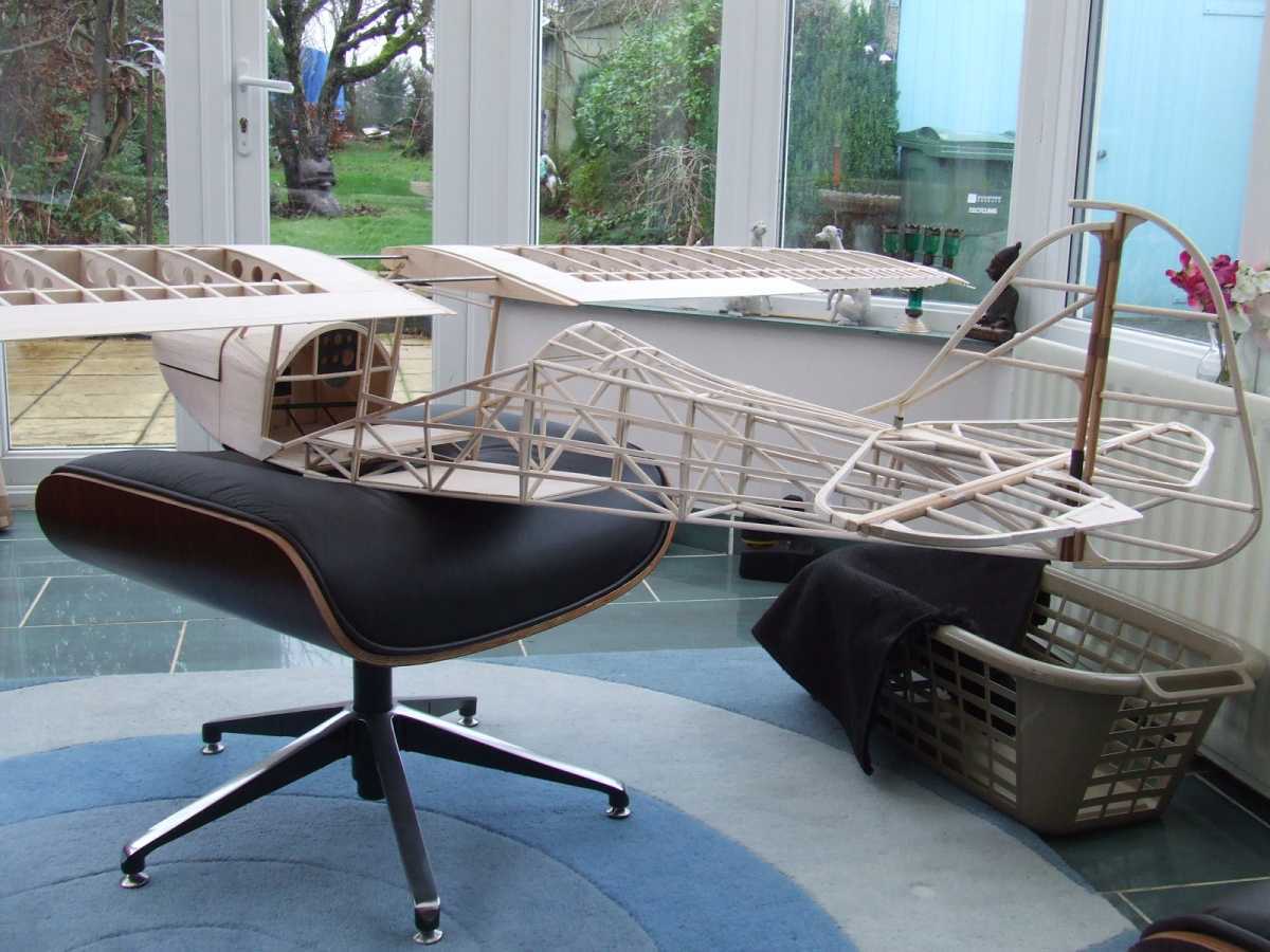

23 Jan 2014 13:50 #252 by Quorneng
Replied by Quorneng on topic Auster mk5
Tony
That is a very impressive model.
I appreciate it is only placed together at the moment but in that last picture the fuselage looks terrifyingly weak just behind the wing. ;)
23 Jan 2014 15:44 #253 by Ex-Member
Replied by Ex-Member on topic Auster mk5
it is at the moment, it wont be once the piano wire bracing goes across the back,top and front.
it should all tie in quite strong then.
thats the next job over the weekend.
