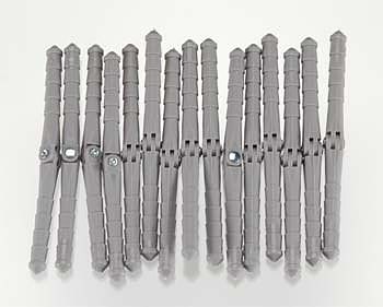

29 May 2014 14:34 - 29 May 2014 14:44 #165 by Bizjet tech
Replied by Bizjet tech on topic avro shackleton mk111
Tony,
if I remember correctly, there were 2 hinges comprising big bolts. the middle "hinge" is in fact the operating rods for the Balance tab and Trim tab. can't remember which was which, though logic says the top ones are trim, but then logic doesn't sit well with the Shack!!
have a look at these hinges www.hobbylinc.com/htm/rob/rob310.htm . they'll carry the load easily
Last edit: 29 May 2014 14:44 by Bizjet tech.
