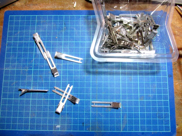

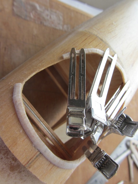

Hairdressers 'Curl Clips' make excellent clamps for holding fragile joints:

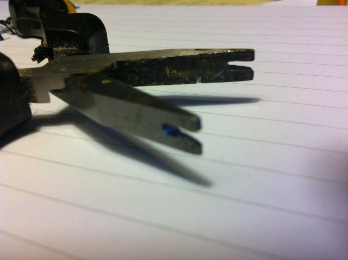

On a more serious note, I saw this on You Tube.
Get a cheap pair of flat blunt pliers - mine cost a £1 off the market - and then using a Dremel with cutting disk cut a couple of slots as shown. don't cut the slots centrally. (mine were too central despite being asymmetric).
These make a fine pair of pliers for bending 'z' shapes etc. and are a fraction of the cost of commercial benders. More than adequate for piano wire to 16swg
Thanks: Klipkopwildlife, old fart, Ex-Member
