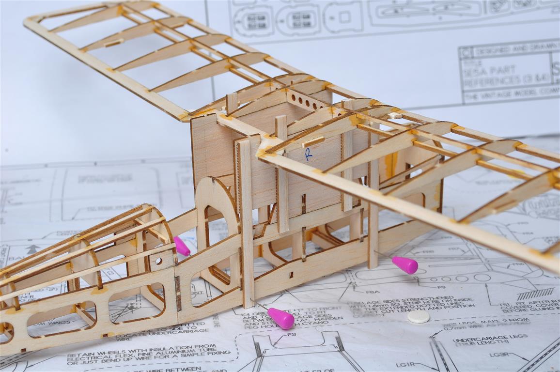

14 Apr 2016 09:33 #21 by Septic
Replied by Septic on topic Vintage Model Co Se5a
Only had a very brief few minutes in the workshop yesterday following some hectic days at work. But managed to get the cabane struts shaped and attached. I think I am going to try attaching the tissue onto the pre doped framework using thinners, on the basis I have thinners. Though a 50/50 mix of pva sounded do-able too.....
Anyway couldn't resist the all time modellers favorite pastime, dry assembly over a cup of tea and a rich tea biccy :)
Cheers
Danny
tap - tap.......rivet

14 Apr 2016 09:40 #22 by Ex-Member
Replied by Ex-Member on topic Vintage Model Co Se5a
What a lovely model and so well put together as well.
must be something in the Free Flight malarkey. :P
  • Septic
  • Septic's Avatar Topic Author
14 Apr 2016 09:53 #23 by Septic
Not sure a more relaxing way to build than with one of these kits, still feels like cheating! Not sure I could have cut out the parts :( a real dark art.....
14 Apr 2016 15:49 #24 by Ex-Member
Wow! The mark of a 'good' model is that it looks the part when dry assembled pre-covering....and this one really does look the part!
Nicely done Septic!
