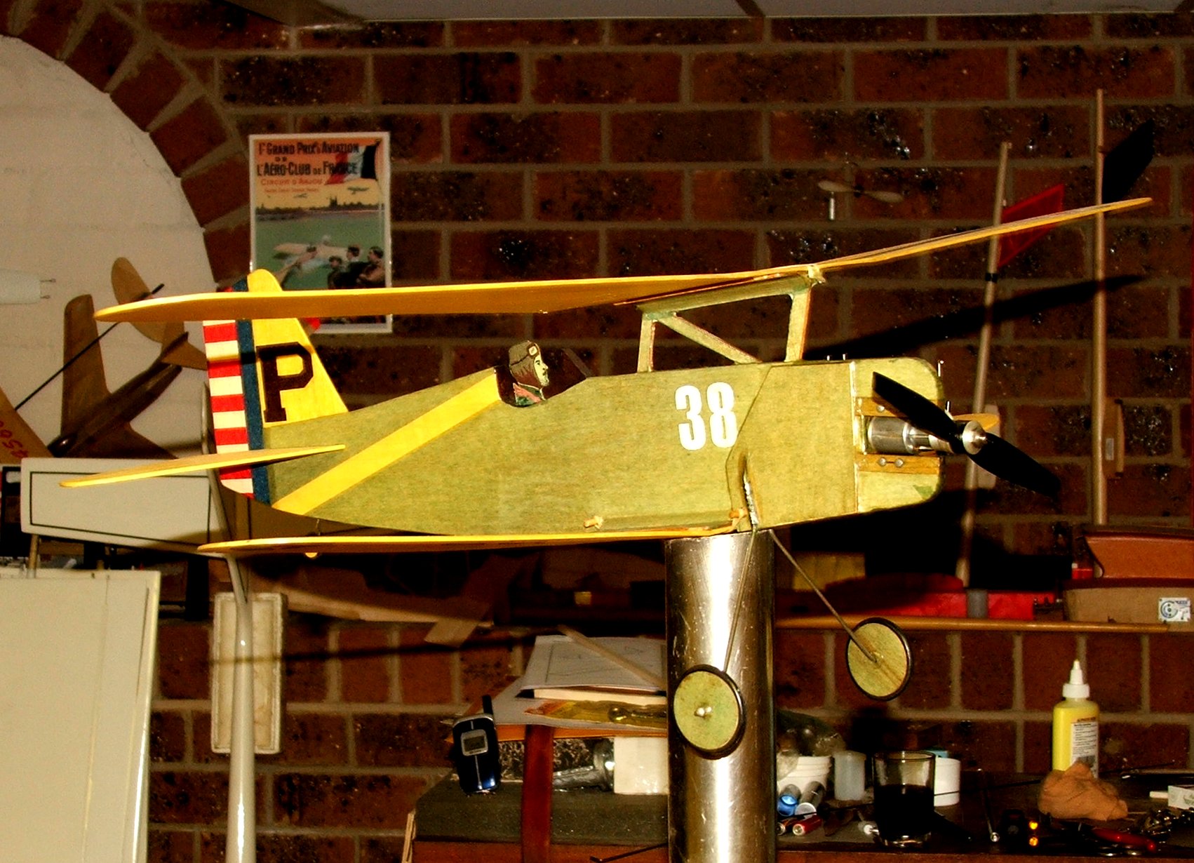

Of all my Ebenezers, the hottest performer is the Vespaneezer.
I built one as a kid which flew quite well so when I eventually enlarged a 3-view from an ancient Aeromodeller magazine I built another. Colouring is tissue fuel proofed with clear K&B epoxy.
With the Cox Pee-Wee screaming away on it's 4x2 APC prop and a healthy dose of nitromethane in the fuel it is remarkably stable as it climbs rapidly and then gently comes down in big spirals. Definitely requires a large paddock with not much wind.

Very nicely finished Vespanezer Danny. Hopefully the paddock is empty when you fly...looks like a great horse scaring device ;)

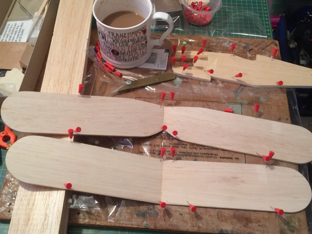

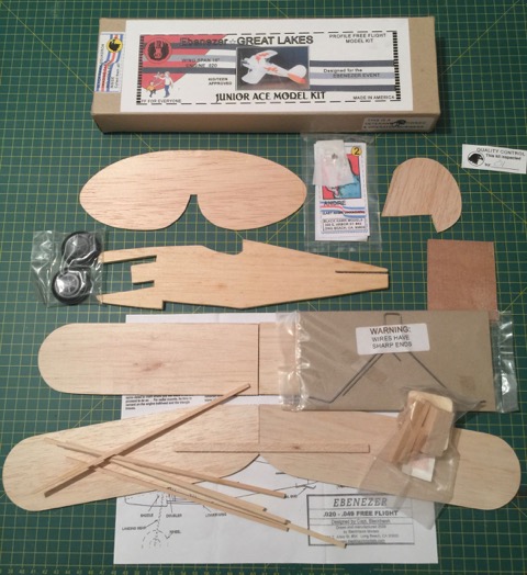

I've started the next Ebenezer, a kit I won at my Club's Christmas quiz evening last December. It's the first and only Ebenezer kit I've seen, so it should be an interesting and quick build. Hopefully, it'll be ready for the ModelAir Ebenezer event at Old Warden on 13th May.
Here's the kit:
A test fit of the Redfin 0.020 cu ins diesel
and the wings being joined. The plan shows no dihedral, but with experience of these models, a liberal dose of such is essential for lateral stability! ;) ;)

I think this is the plan for the same model .Also on other plan sites too www.pinterest.co.uk/pin/558798266238353317/
