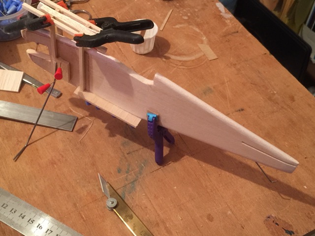

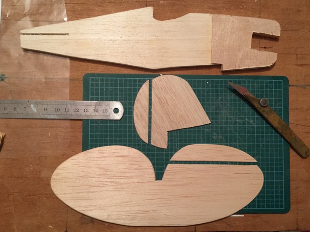

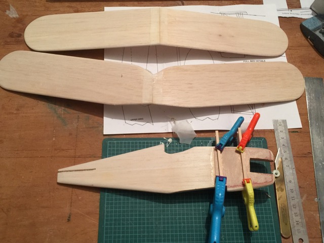

I've sanded the empennage and cut some trim tabs, plus added doublers to the fuselage side:
The wings has been sanded and the joins reinforced, the fuselage doublers have been cut to size, the whole sanded and the uprights to the pylon added:

I've added some wing supports to the centre section strut and a wing seat to the bottom fuselage. Front and rear landing gear has also been added, the front being bound where it joins the fuselage. Doublers have also been added behind the lower wing for a wing-band retaining peg.
Wood sealing next.....
