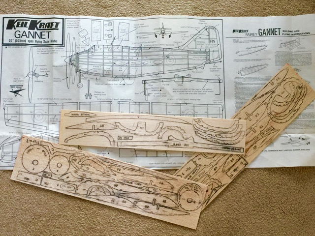

First off, I copied the print wood, blew it up by 150%, cut and pasted (literally, not digitally!) it to fit on 3" and 4" wide balsa, copied the result at my local library, then transferred the result onto balsa:
I've also blown up the plans by 150%, but no pics of that just yet.
......to be continued!

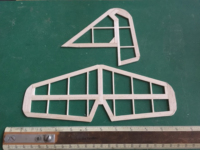

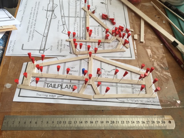

I've started on the tail end of the model by laying down the outlines for the tailplane/elevators and fin/rudder. I'm making all of the control surfaces movable to help with any trimming issues.
18 Jul 2016 07:19 #9 by Ex-Member
Replied by Ex-Member on topic 150% KK Fairey Gannet for FF Rubber Power
We're going way off topic here, so in an attempt to get it back on track, here's the current status:
The empennage basic construction is complete. It needs gussets and tidying. Fuselage next.

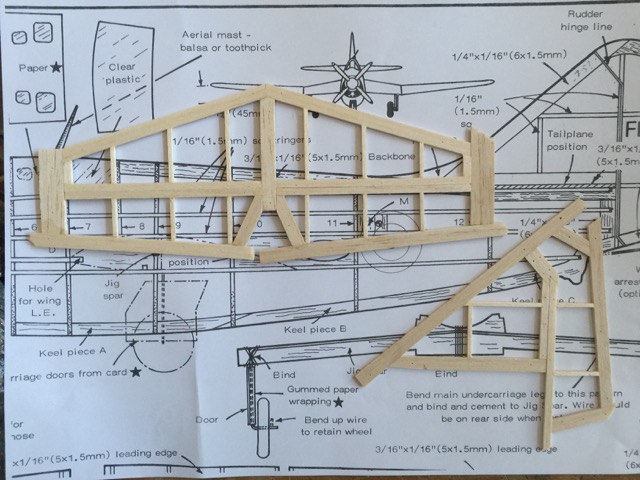

19 Jul 2016 06:40 #10 by Ex-Member
one tenor wrote: ........ I think the empennage looks a little on the meaty side........
Fair comment John, but the reasons for the beefy construction are both aesthetic and practical.
I intend to compete in kit scale events with the model and as such, it should reflect the sizes of wood shown on the plan. The wood sizes used in the tailplane and fin are 'scale'.
More practically, it's a free flight model of 30" span that will weigh around 150gm when ready for flight. The tailplane will need to withstand a hard arrival or cartwheel on rough grass. I believe the wood size and weight used will be adequate.

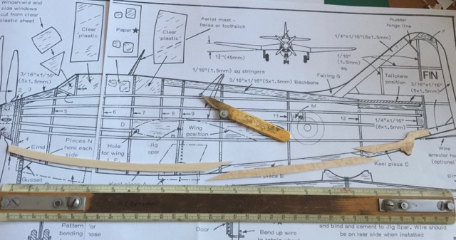

I've tidied up the empennage and added a few gussets, the parts are now ready for sanding:
I've also started cutting wood for the fuselage:
PS: I've gone back to Imperial Units and dug out my old 18" scale ruler! [badass] [badass]
20 Jul 2016 23:34 #11 by Quorneng
Replied by Quorneng on topic 150% KK Fairey Gannet for FF Rubber Power
Whilst I fully appreciate the logic for 'scale size wood' for a scale competition I am a bit surprised that the actual construction of your tail feathers does not follow the plan exactly although obviously it will be of a more scale appearance.
Just me being a bit picky. :P
21 Jul 2016 06:48 - 21 Jul 2016 06:49 #12 by Ex-Member
[quote="Quorneng" post=75796..... I am a bit surprised that the actual construction of your tail feathers does not follow the plan exactly although obviously it will be of a more scale appearance. ...[/quote]
The answer to your comment is in post no 10 Q, and as far as I'm concerned, be as picky as you like, it makes for an interesting thread!
Andy Sephton wrote: ...... I'm making all of the control surfaces movable to help with any trimming issues......
The rules and judging for the type of competition this model may be entered in are a bit vague. What I'm attempting to do is maintain the look of the original model, but in a larger airframe. Modifications are allowed in some competitions, but not in others. The proof of the pudding will be in the eating, however, and the whim of any judges that might look at it! :lol: :lol:
