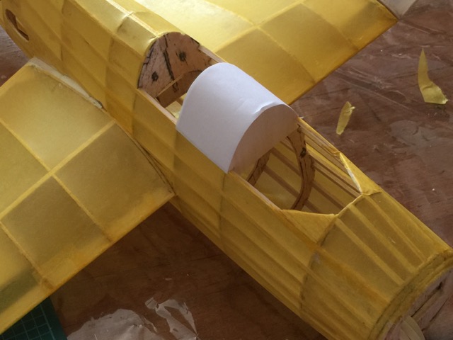

Although ready for test, the weather hasn't been wholly suitable over the last few days, so I've decided to continue with the paint job to have it ready for the Old Warden Scale weekend in 10 or so days time.
Canopies are now off, I've patched some of the bare wood with tissue and EzeDoped the result:
15 Jul 2017 10:15 #79 by Ex-Member
Replied by Ex-Member on topic 150% KK Fairey Gannet for FF Rubber Power
Hmmmmmm... well that didn't work as planned! ;) ;)
15 Jul 2017 10:41 - 15 Jul 2017 10:42 #80 by Squirrelnet
Replied by Squirrelnet on topic 150% KK Fairey Gannet for FF Rubber Power
I had a similar experience when covering the nose of my Piper . In the end I stuck the tissue to the paper/card with Pritstick before fitting it to the model and didn't dope it. Pre shrinking the paper as for painting by wetting it and then taping it flat to a board first may work too.

15 Jul 2017 11:58 - 15 Jul 2017 11:58 #81 by Quorneng
Replied by Quorneng on topic 150% KK Fairey Gannet for FF Rubber Power
Andy
Was that the result of Easydope? Which is water based.
You can dope paper/thin card with the acetate stuff or 'impregnate' it with thin CA.
The paper exhaust tube of my Venom was done like that after it was fixed in the air frame.
Once dry it almost becomes a paper reinforced plastic.
Last edit: 15 Jul 2017 11:58 by Quorneng.

15 Jul 2017 14:51 #82 by Ex-Member
Thanks for the input chaps. The above was really to see what effect the EzeDope would have on unprepared paper, the medium stated on the plan for that particular area of the model...and as you can see, it was not a very good one!
I would normally use pre-doped airmail paper, of which I keep a few sq feet on the stock shelf. However, the area between the cockpits has some glazing, so I'm going to cover it with thin acetate and spray silver over all leaving the small glazed areas clear. The acetate will be stuck on the model this evening as I'm busy CADing the Lacey print wood this afternoon..... Spraying is now planned for tomorrow.

17 Jul 2017 06:53 #85 by Ex-Member
Firewood wrote: Hi Andy I might be teaching my grandad to suck eggs but when you use paper for comings do you tape it to a board wet it and then cut it to shape and glue in place?
When I normally use paper, it will have been taped to a board, pre-shrunk and pre-doped before use. However, cellulose dope can sometimes be used on raw paper, but in this case, I wanted to see what EzeDope would do...
The paper has been replaced with thin acetate, cut to the shape recommended on the plan:
17 Jul 2017 17:08 #86 by boz
I think the acetate looks better, and probably easier. :) coming together very nice andy. :)
